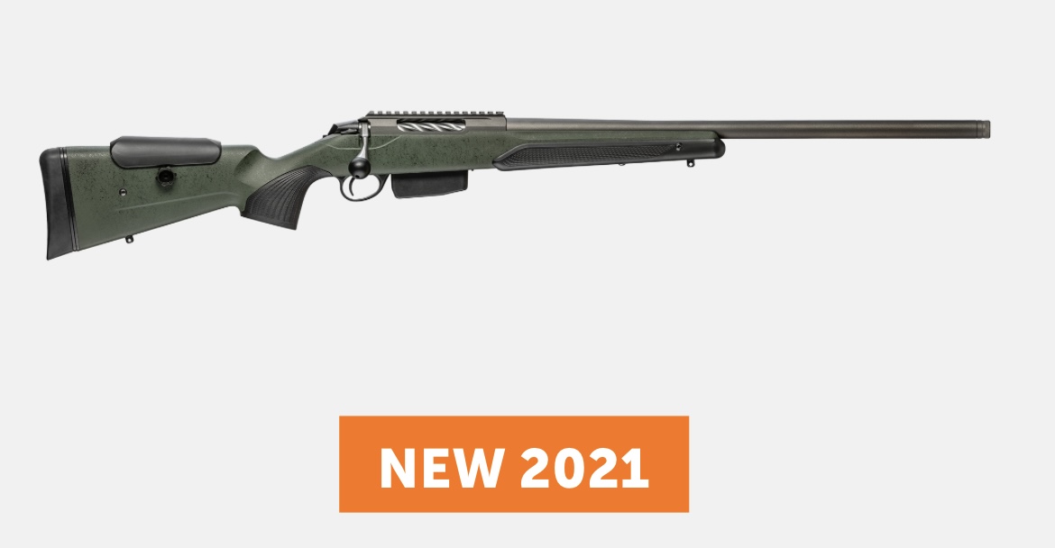

I was debating buying either the CTR or ordering the new Super varmint in 6.5 CM, the super varmint is about $500 more. I would eventually drop whichever into an MDT chassis. Can anyone confirm that the super varmint has a stainless barrel underneath the cerakote? Any other input is appreciated as this is my first long range rifle!

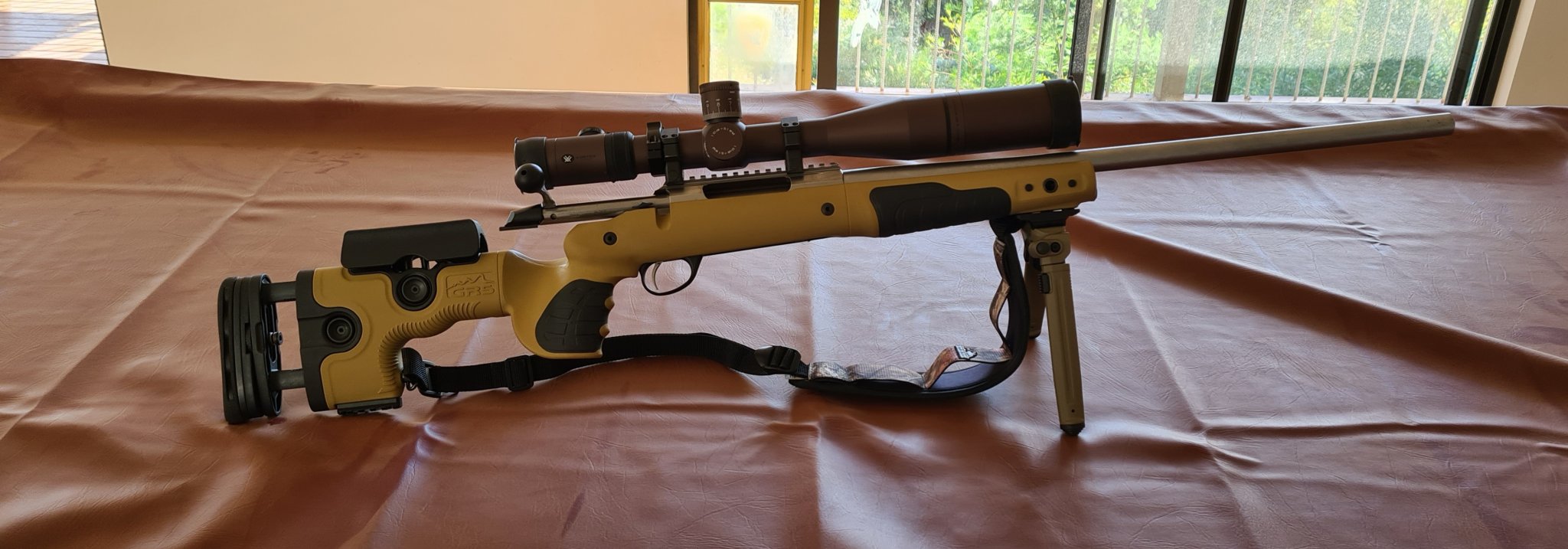

I have a Tikka Super Varmint in 6.5 Creedmoor.
Love it.
I put it into a GRS Bifrost, and with my handloads, it's very accurate.
The new Cerakote versions are stainless, I believe.

I believe the super varmint will have a thicker barrel profile compared to the CTR. Or did when I owned them.
So if your changing the stock, doing away with the pricey tikka CTR mags. Then super varmint all the way for a range range rifle. If you’re hunting / carrying it the CTR might be worth while.
My CTR used to walk off after shot strings of 10.
I got to handle the new T3x supervarmint today.
Lovely rifle and it is all stainless under the cerakote.
