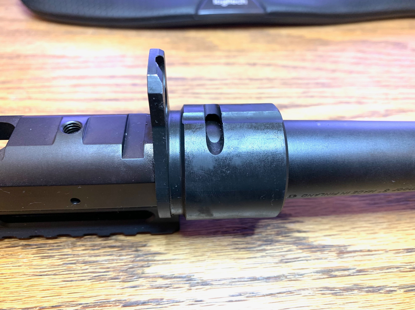

    Disassembled down to the action, and preparing to remove the barrel ... but can't figure out how to get off this round housing gizmo (just down-barrel from the recoil lug) that holds the handguard screws. Anybody know how I remove this? Does it screw off? Come off some other way? Or do I barrel vise it and take it off when the action is removed? Anybody have experience with this?
    It's been awhile since I changed the chassis out on mine, but is it held on with that screw that anchors into the scope base/top rail?
    Edit-a vice was not at all needed to remove any of the parts of the chassis when I did it.
    Reactions: trob and spife7980
    That was the secret. Pulled that screw and the ring and recoil lug (connected) popped right off. THANKS!

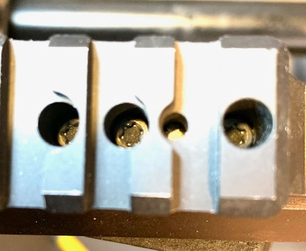

    Hit one more snag I could use some help on. I'm using the Northland Shooters Supply external action wrench, and it's obvious this won't work without the scope rail removed. The scope rail screws are sufficiently recessed, and they're the "star" (torx) variety, so none of my screw heads are long enough and skinny enough to reach the screws. It looks like a Torx 8 or 9 ... but does someone out there know for sure what allen size I need to find to remove those scope rail screws?

    There's a pin, but it popped out when I had all the screws removed after a few tap-tap-taps with a small hammer. The screws were loctited in and were VERY hard to remove, but I got them out. I just don't get why everything on this Tikka is constructed to never be able to take it apart.
    Most TAC A1 guys that I've met never take off its specialized pic rail. I ended up just buying a 30 moa mount instead of dropping $90 on a rail for it.
    Reactions: Johnerz
    Interesting ... it was a pain, but not all that hard. Getting enough leverage on the tiny torx allen wrench was the hardest part. After I got it off, I made sure I could get it back one ... no issues. Needed it off to use the NSS external action wrench ... which ultimately failed, but when I took off the pic-rail, I was so hopeful and optimistic. Then I failed miserably ...
