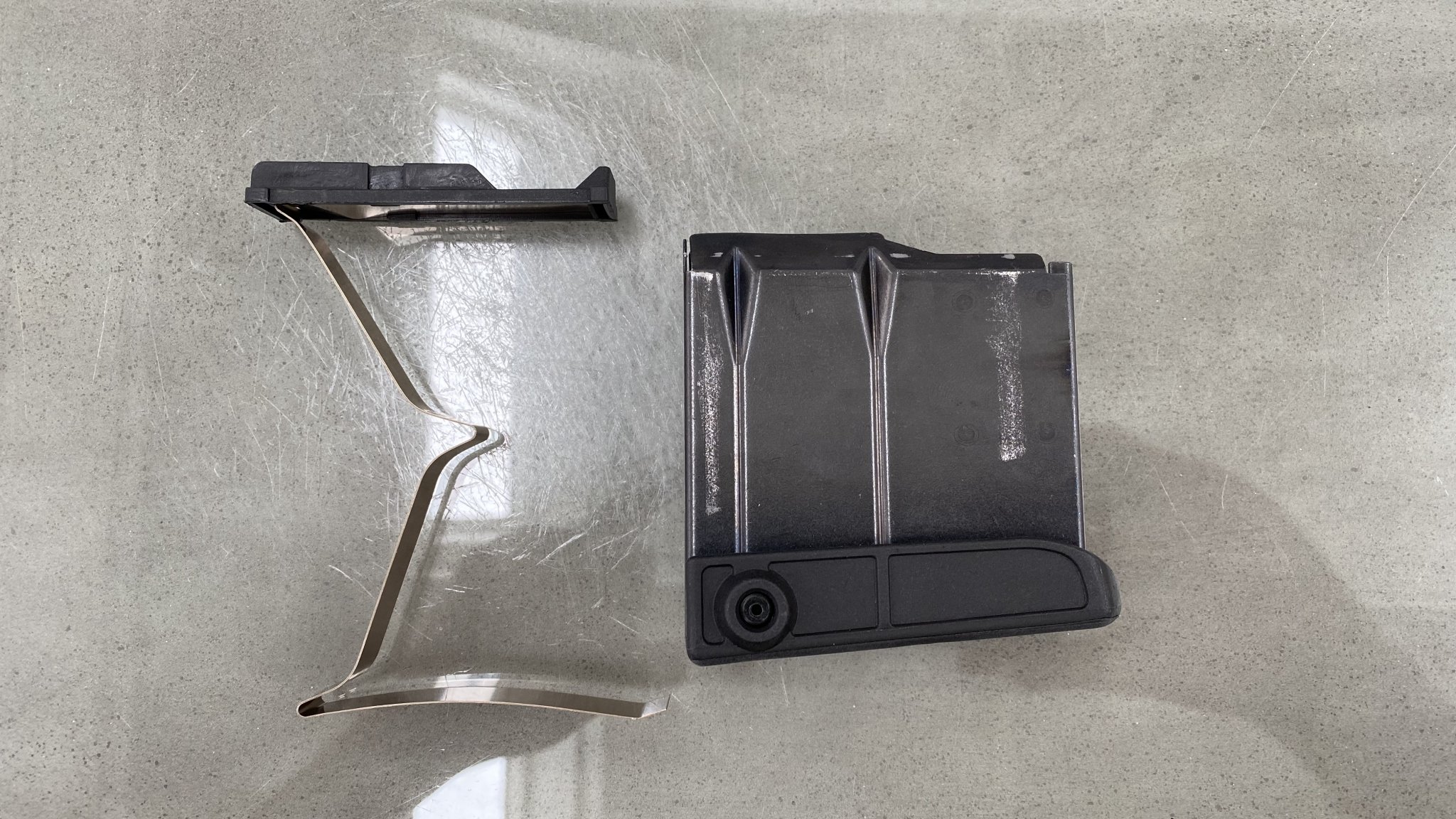

After a little modification this is what it now looks like, will give it a try, hopefully there are no more feeding issues on the last round and I will then do the same to the other 4 magazines I have. Will be so happy if this actually resolves the issue, the thought of having to send my rifle out for repair and being without it for a month plus makes me want to cry - lol

never_summer Thank you so much for the info and direction, did exactly what was described in the link and the problem seems to have been sorted. It seems the springs are just not precisely adjusted from the factory to allow for smooth feeding particularly for the last round but this fix gets everything working and all 5 of my mags are now operating as they should be. If anyone one else is having this issue just do exactly as described and you should be good to go, main thing to note is for the spring to be stretched out and ensuring the top and bottom are parallel to one another as the spring is too compressed and not at all parallel from the factory causing too little tension and uneven pressure which causes the issues described. Thank you again for giving me the info to rectify this problem myself and not have to deal with the headache of sending my rifle in for service, greatly appreciated :)

I can confirm that the fix mentioned above definitely works. Since I did that to all my Tac A1 magazines I haven't had a failure to feed.
