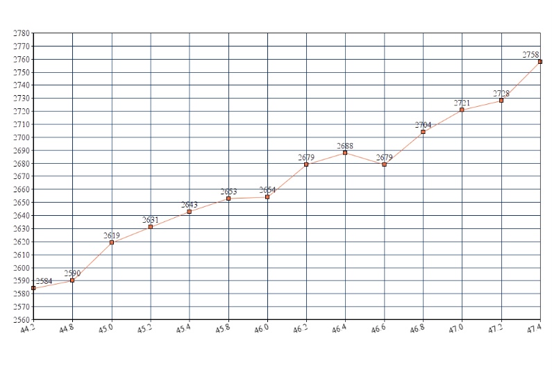

This was my ladder test graph. I’ve tested a lot of different seating depths probably 50-60 different lengths.

From the velocity test I would try some different charge weights around 45.8gr. (i.e. 45.5, 45.8, 46.1)
..... did you skip some charge weights on purpose?
Would you mind posting the results of seating depth testing?

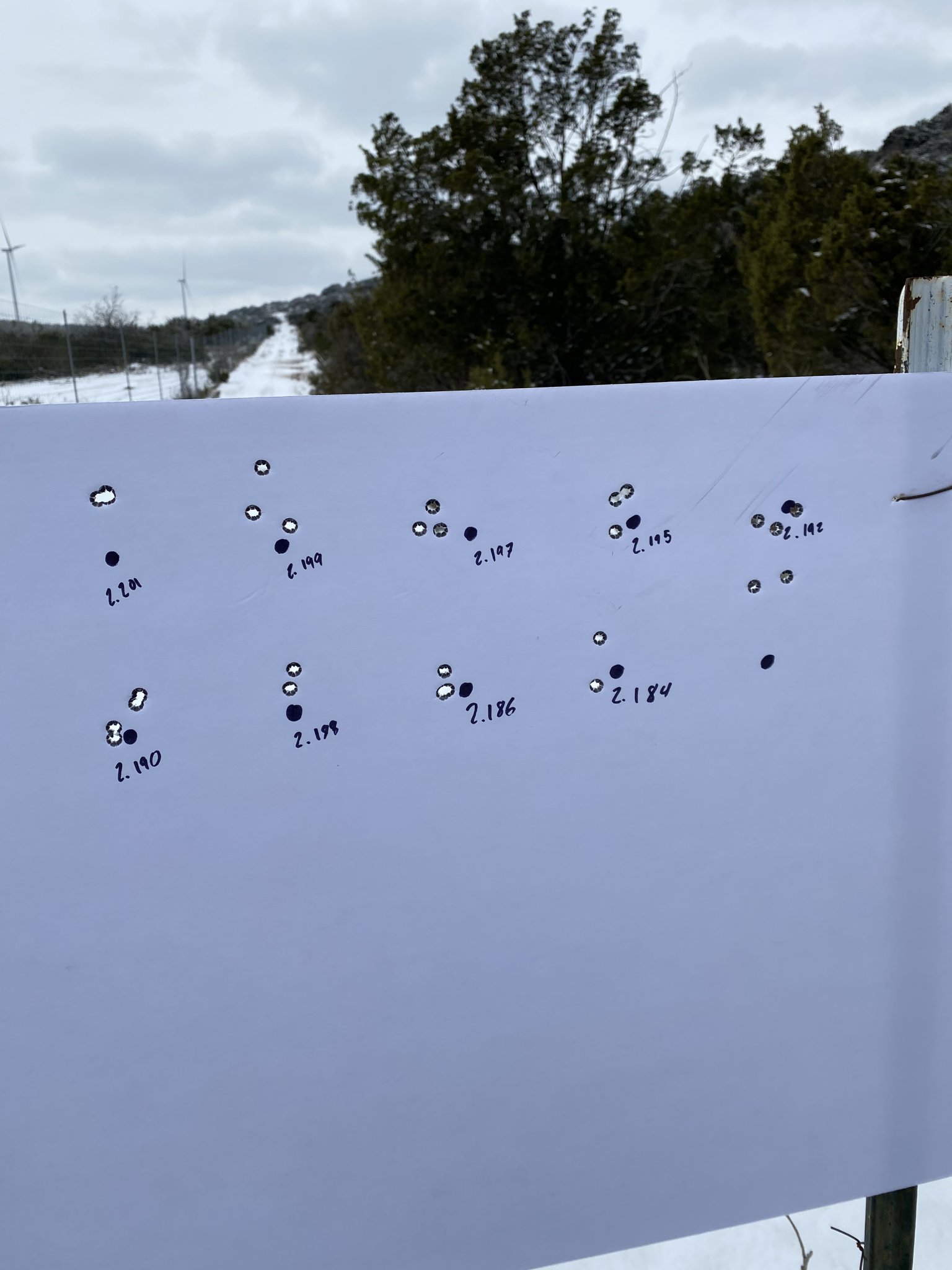

I did 2 different ladder tests this was the only one that had a node. Here’s a pic of the seat depth test shots. I found that according to Berger I should do big jumps then fine tune after. this is the fine tuning. The top left group was what I thought to be the backside of a node and I shot some depths in front of it on another occasion but they were all over 3/4 inch.

What’s crazy about it? I never saw pressure signs and it fits in the case.
Because 44.5 grains is max under a 175SMK loaded to 2.800”. The 175SMK is a much shorter bullet. So even tho you’re running a long coal, it doesn’t justify a 2.5 grain powder increase because your bullet is longer by .100”.
It’s a Berger vld it lets me seat them a lot further out in the case
Your vld is a longer bullet than the smk. You seating them out farther is negated by the fact they are longer. 2.5 grains over max is insane.
