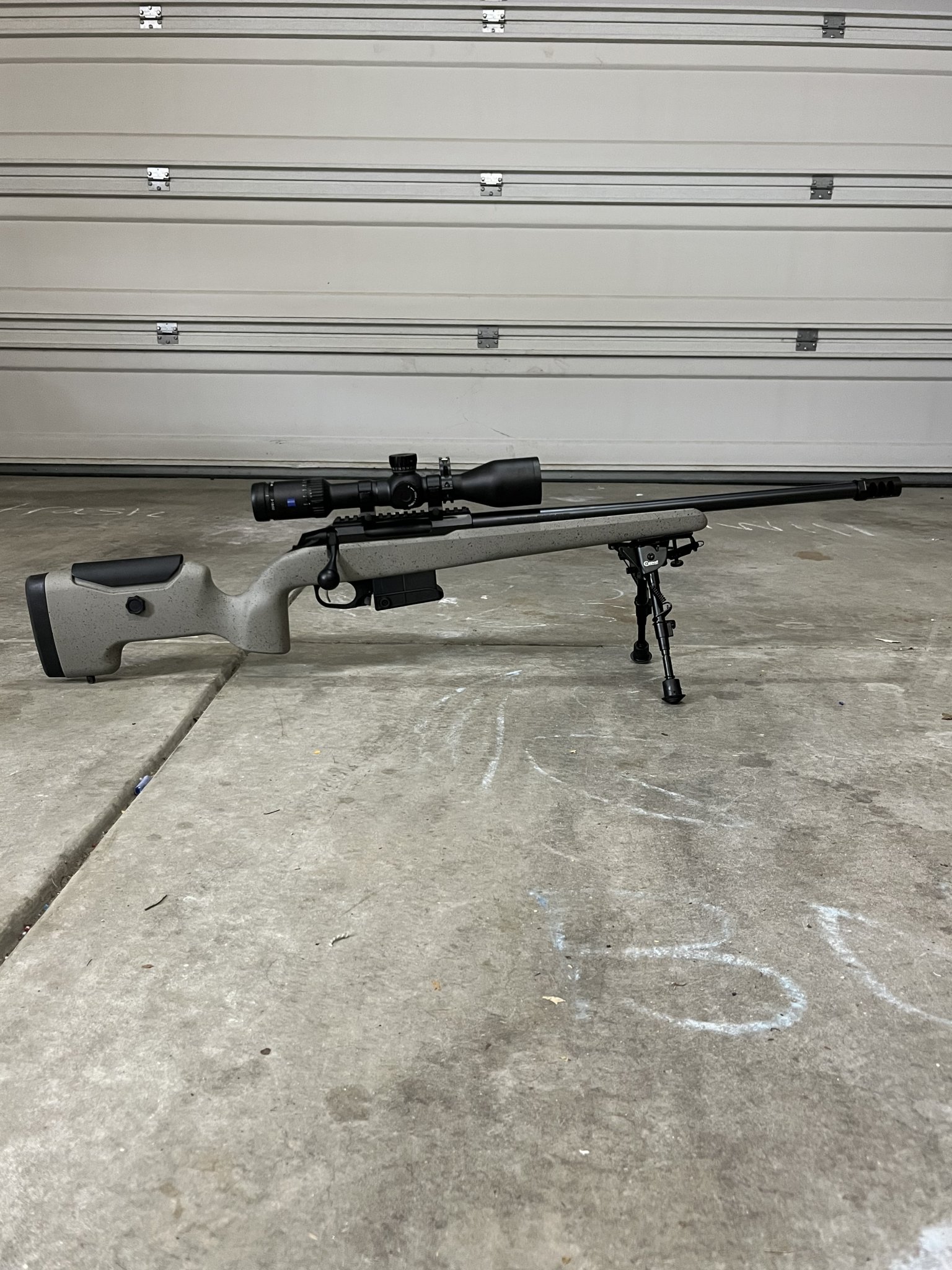

Had one of these come in for a paint job, never handled one before. The line down the middle that bisects the stock is different than anything I’ve seen before. Is this typical of Tikka / Sako composite stocks? Is it strong, stable enough?
Other than the curious construction it’s pretty stiff and light for an adjustable stock. 29oz as it sits….
The cheek piece is all plastic construction and I don’t believe it would fare well if subjected to much of an impact.

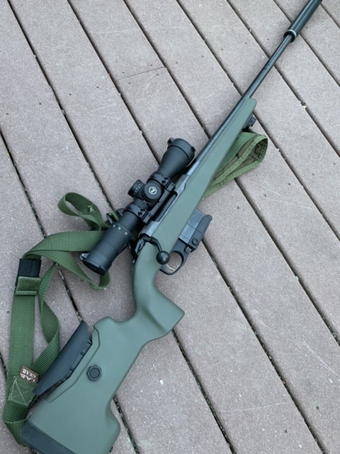

I got my UPR in and honestly, finish looks pretty good as is. Stock is great and a certain upgrade to the plastic CTR stock.

Each side of the stock is molded individually, then bonded together. It's not typical of Tikka stocks - most are fiber reinforced injection/compression molded. The UPR design adds rigidity and strength.
