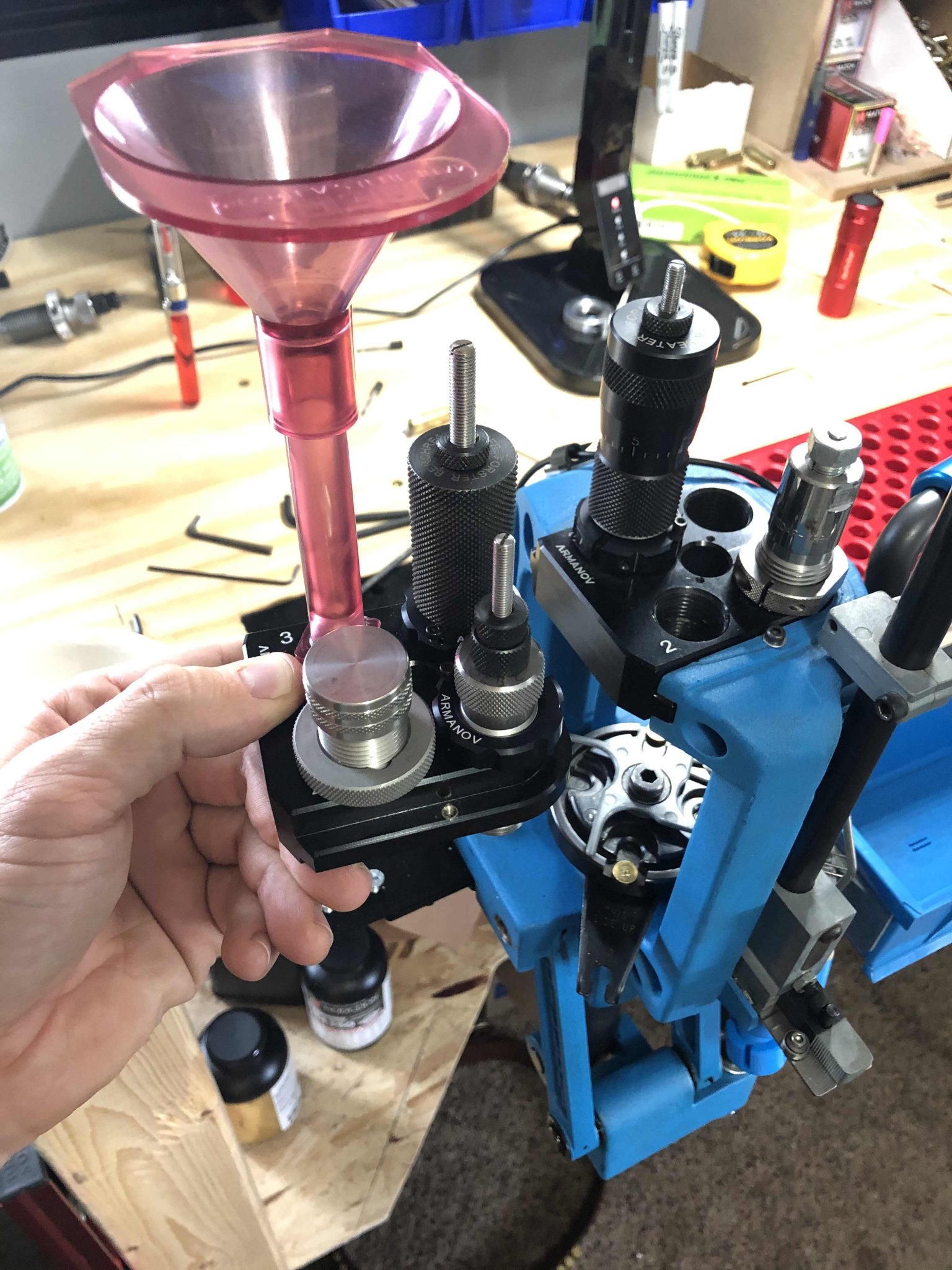

    Here's my basic setup on my 550...

    Que the fuds..." You caint load precision ammo on a progressive...my pappy told me so back in 1974..." Comments
    Seriously though...I load everything but 338LM and can't wait to get a second so I have one machine dedicated to large primers and the other dedicated to small
    Am I seeing a bullet seater in both tool heads?
    Well, ya....but they're different calibers. I load precision 6.5cm, 223, and 223AI on my 550 using Armanov clamped toolheads w/ floating dies.
    The toolhead on the left, I'm experimenting with doing it all in one step with my 6.5. Tumble my fired cases for an hour, load em in trays of 50 and spray em down with One Shot and load:
    Station 1: deprime/size/prime
    Station 2: Mandrel to set neck tension to 2thou
    Station 3: Manually drop powder
    Station 4: Seat.
    I loaded up 200 a week or two ago and I'll get to the range later this week to see if they're as consistent as the two toolhead setup
    So do you tumble the loaded rounds?
    So far no, I just put 50 on a towel and roll em around and wipe em down. But this is the first 200rnds I've done all in one toolhead like this. Normally I do two toolheads, so I would tumble the cases after brass prep.
    I don't think I'd have an issue tumbling loaded rounds as long as there weren't a lot. It only takes about 10 or so minutes in fresh polishing media to take off the lube.
    That explains it.. I'm using two tool heads for 308. one for prep and one for powder and seating.
    I would normally, but I'm trying a one toolhead setup to see whether it works, and if I prefer it. The two toolhead setup is pretty efficient, and not sure if I really like the one toolhead. Trying to jam too much into one operation sometimes has its drawbacks
