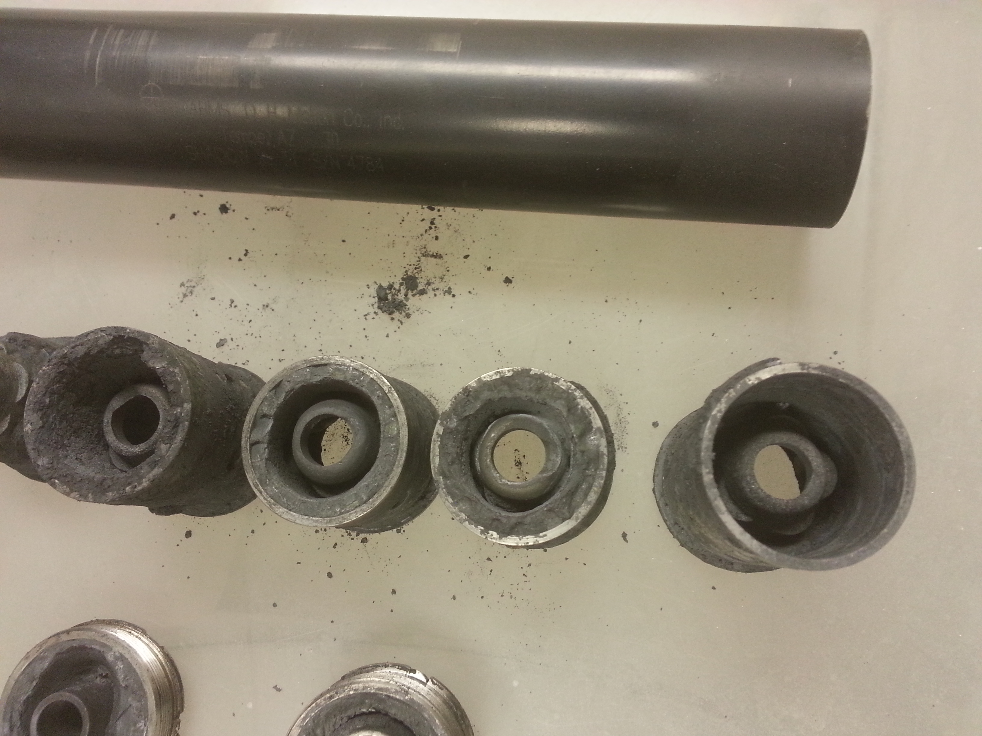

    This is what 8oz of carbon looks like from a self cleaning suppressor. Dont ever let it get to this point.

    XTRTITAN, are you able to share what can those baffles are from? That shit is crazy. I've never seen anything like it. I figured a user-serviceable can would have enough give between the baffles to allow the carbon build up to break off with the pressure of the muzzle blast. But I guess not. Nuts...
    That can started life as a sealed unserviceable can from one of the top manufactures. (retail $1275) after being unable to remove the carbon and finding out what it was gonna cost to have it professionally cleaned annually,(6000 centerfire and less than 1500 rimfire plugged it up that bad) I decided to just have it repaired by putting a user serviceable core in it from Lane Silencer Llc. Now cleaning is as easy as giving it a bath.

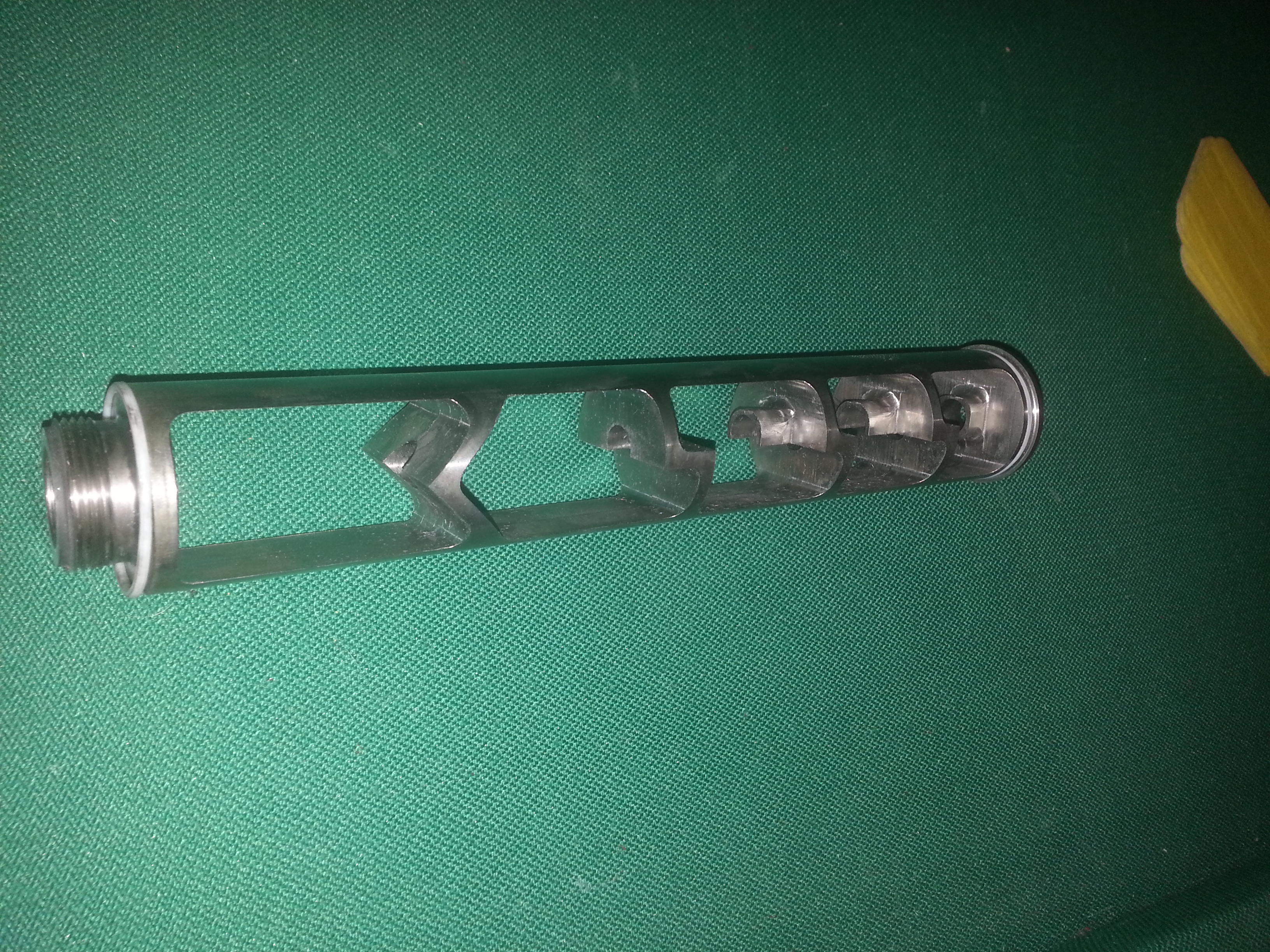

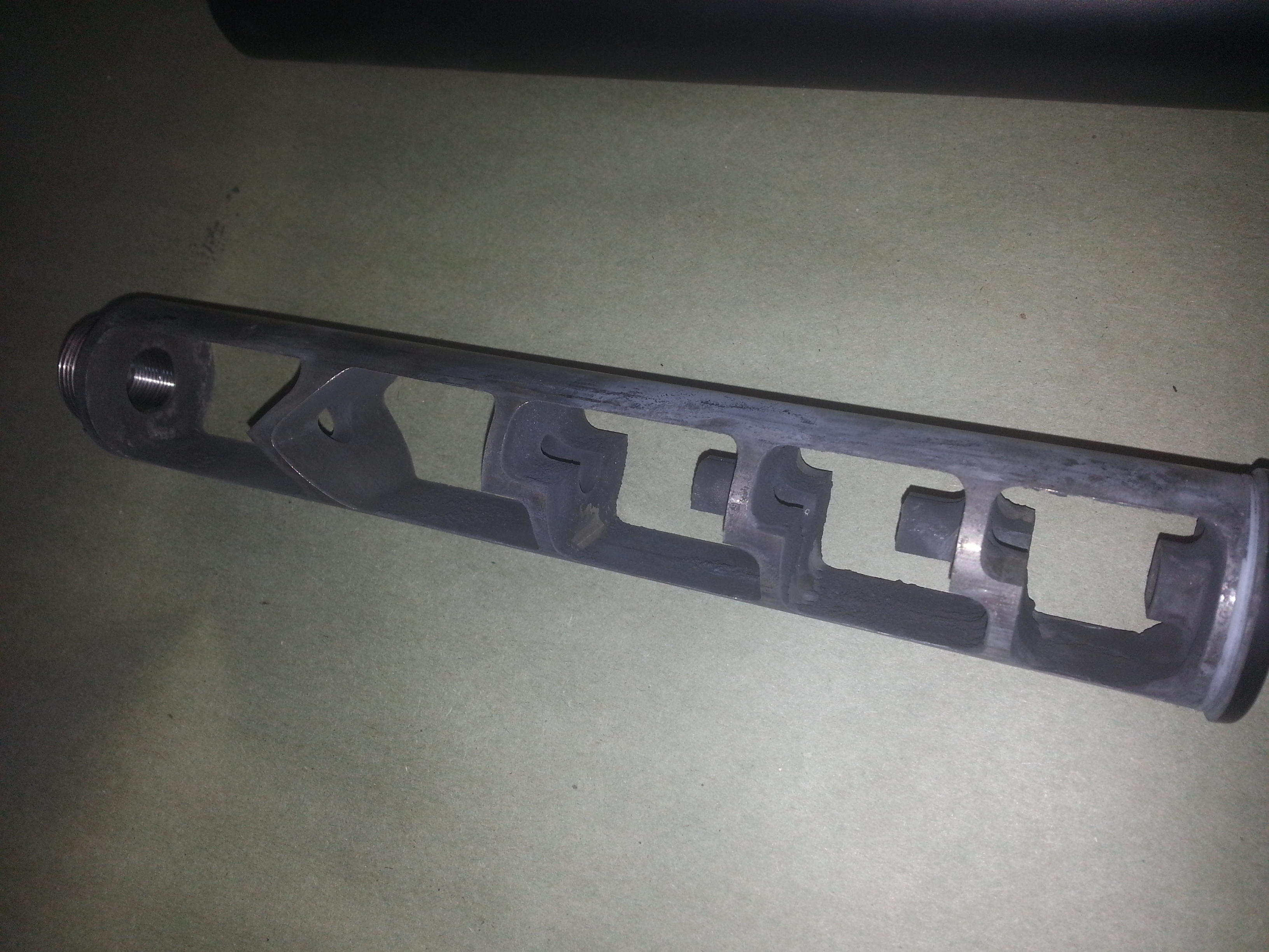

    this is the new core with 350 rds after testing and competing in the RMSQ and the other pic is after spending 1hr in the hornady sonic cleaner and returning it to factory weight preparing for the next match.

    I am just using the hornady one shot solution. it seems to work good on the core. Put it in for 30 min, pick a couple chunks of with a screw driver, put it in for another 30 min and it is clean.
