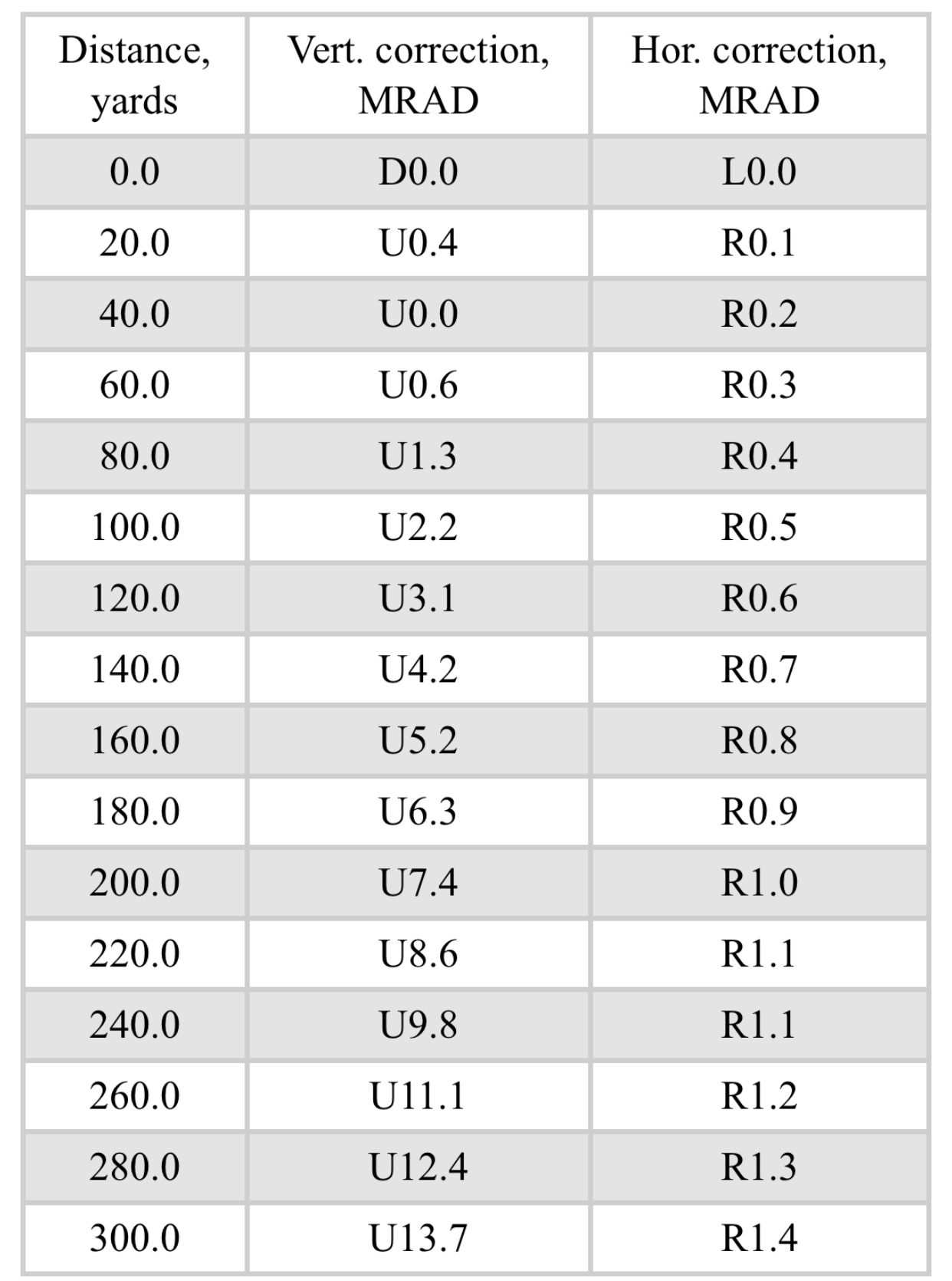

    What’s the point of going out to 50 after you already have a 20yd zero?
    There’s really no reason not to just use your 20yd zero and run with that in your software. Unless you’re shooting something like 50yd benchrest and want to be sure you are absolutely dead on.

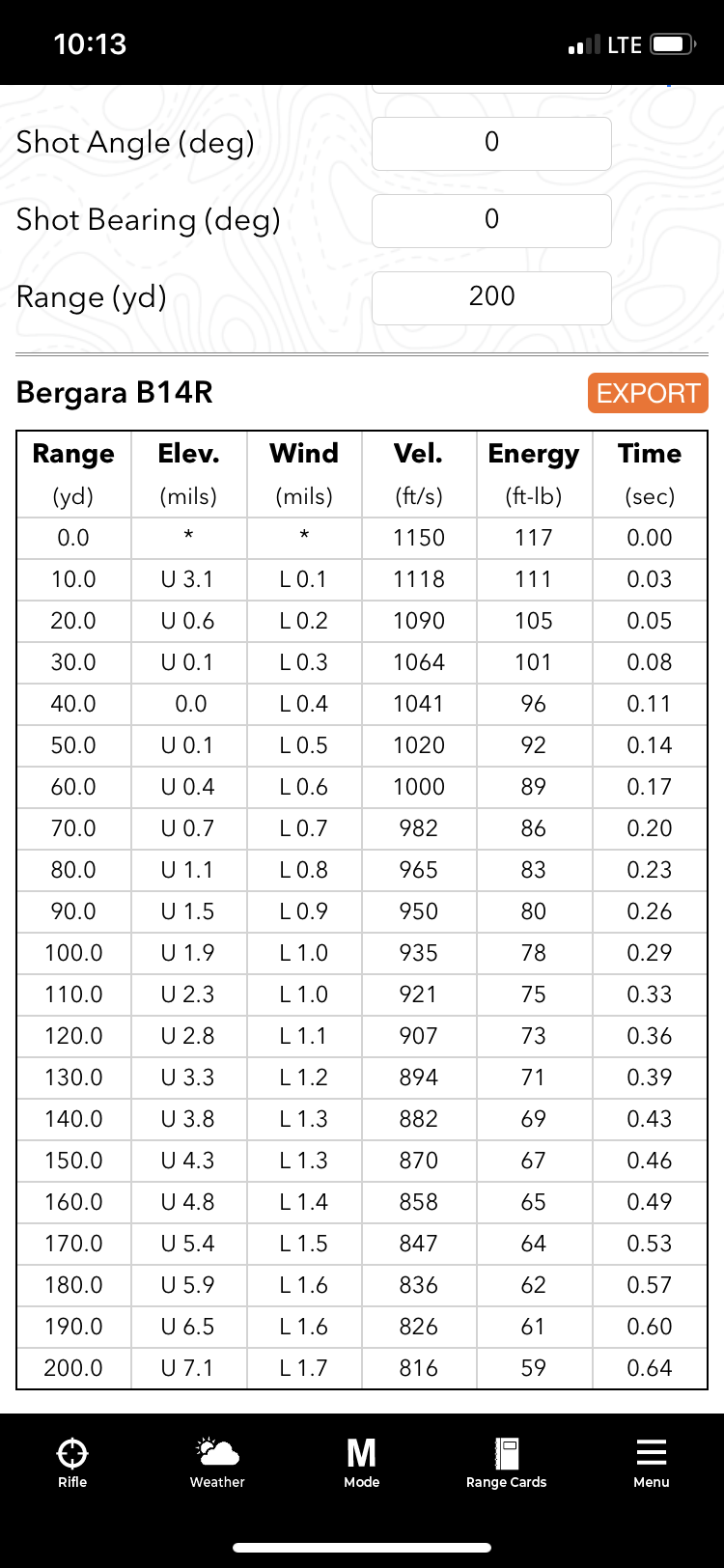

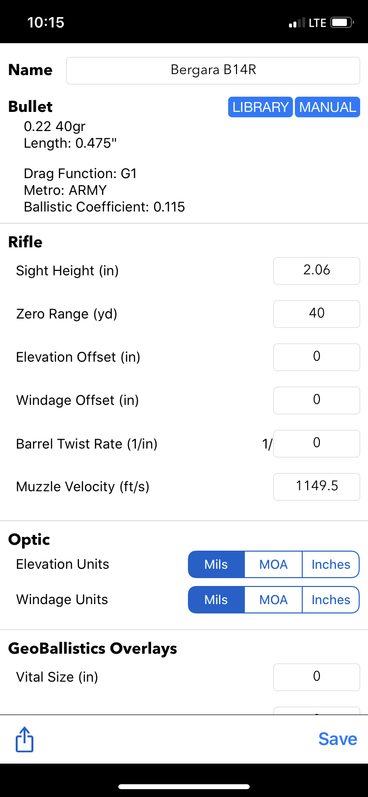

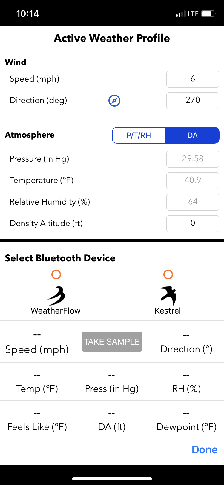

    Trying to wrap my head around this and also have it relate to what “mph” RF I have, like for my CF. Playing with the numbers, like you said @Dthomas3523, this is what I came up with.
    With a 40y zero, everything is up in elevation. And with adding a 6mph full value wind, starting at 10y, for every 10 yards (up to 100y), I need a tenth wind. So, if think of this as a “6mph” gun, it’s easy to remember, as my 6.5CM is a “6mph” gun. Add a tenth for every 10y on RF....add a tenth for every 100y on CF. Easy-peazy.

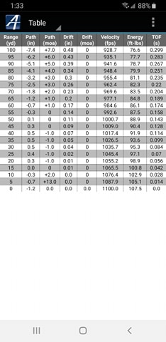

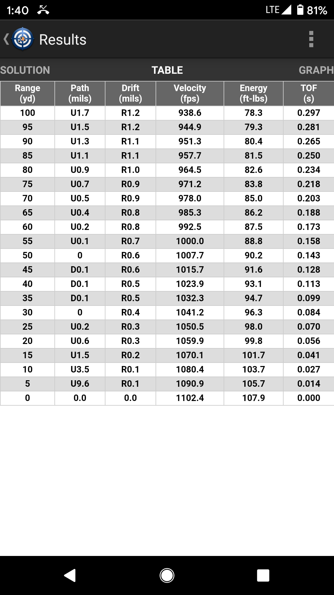

    Good stuff.
    Have you run numbers at closer zero like 25 or 30?
    As you can see, you’re gaining .1 every 10yds for that 6mph. So, the closer you can get your zero, the less likely you’ll have wind built into it.

    A 50 yard zero makes the dope for a 22lr equal about 1/4 that of a 308. It's not perfect at shorter distances, but it works out pretty well, when I tried to get them line up. I didn't really try another zero, there might be an optimal one, especially when trying to get 22lr to match up to 6.5CM or something else.
    I inherently like longer distance zeros since there are more 'degrees of freedom' on where the bullet lands and the clicks on the scope. With out the detrimental aspects of a longer zero.
    At least, that is where my head is, now.
    Yeah. At 35 or 40 yard zero, everything from 10y and out, is all UP. But at 30y zero, 35 and 40y is a tenth down.
    Since a common yardage for nrl22 stages seems to be 35y (particularly paper stages), a 35 or 40y zero works perfect.

    I zero at 25yards for a couple reasons:
    My 25 yard is my 50 yard zero. Both common distances in nrl22.
    I'm up 1mil between 75-80 yards, another common distances
    1.7 to 100 etc.
    A 25 yard zero with great in nrl22

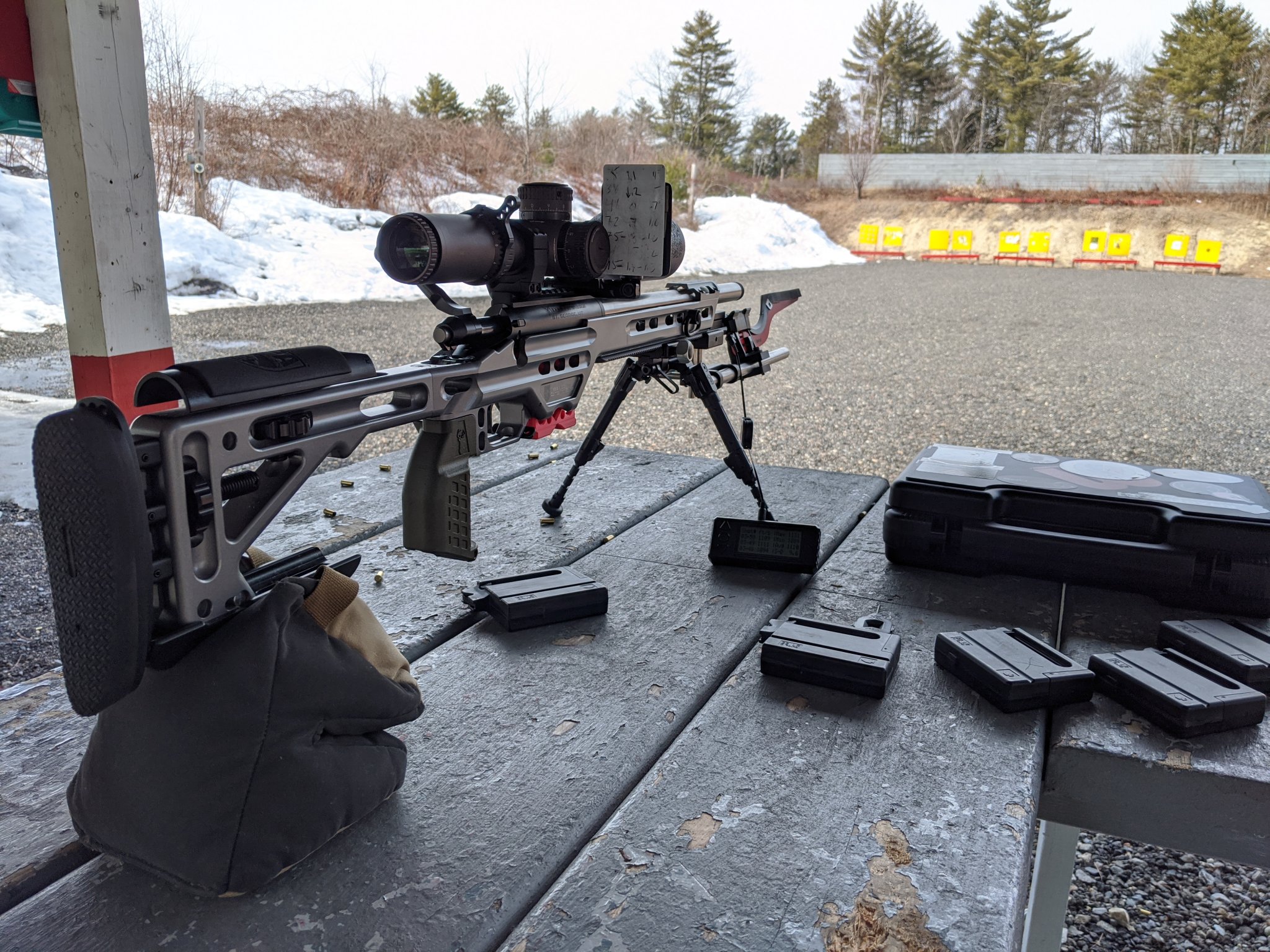

    My Anschutz sits in an MDT LSS chassis with a 20 MOA base and Burris Signature rings with another 40 MOA added for mom and the kids.
    The scope height is 2.1 inches.
    Using the JBM application reveals that with a 50 yard zero the bullet's path crosses the 27 yard line at the zero point as well.
    I zero the rifle at 50 yards because the range that I shoot at has a 50 and 100 yard target frame. No intermediary distances are permitted.
    I try to zero all my .22LR rifles at a time when the winds are calm. The range that I frequent is also enclosed on all four sides by hills and trees, which provide a nice windbreak.

    The zero range won't chage the MPH of the gun. For my RF, it goes in increments of 10y. See 3rd image in Post #15. Just like a CF, there is a point where it starts spreading. CF's seem to be 8-900y and again around 12-1300y. My RF starts to drift from the norm of .1/10y around 120y.

    So the question here is what range increment to base a rimfire "mph" on? For centerfire, it lines up nicely that we use 100 yard increments and a 100 yard zero. It makes the math easy and convenient. With a rimfire zeroed at 25, do you start at 25 yards and work in increments of your zero range (like a centerfire), or do you work in increments of 10 yards, starting at 10 yards? Or do you do something different? One thing that can throw this off too is close range. Because of the way angles work, things inside 30 yards don't like to line up very linearly like they tend to at hundreds of yards. Wind holds at those distances would be a moot point, but it's something to consider when working out what mph gun you have. You almost need to ignore the holds under 30 yards, and find the trend at 50-100 yards to determine mph.
    Looks like 10yds is the spot. But if things scale linearly from centerfire, we might be able to do 20 or 25yds.

    For me per geoballistics within all reasonable atmospherics, my 25 yard hold is .15-.25 up from my 50. Which equates to .135-.225 inches. Not huge but bigger than I expected. Regardless that's an amount I can hold.
    However the next time I am a range I can shoot at 25 yards I will test and work to correct any left to right issues in my zero. This might covence me to change over, but having to dial for my most common range sorta sucks. And based on fiddling with geoballistics it makes me have to dial even more extreme numbers for the up close shots on squirrels in the back yard (6-20 yards)
    One additional advantage I can see is less vertical dispersion from ES at 25. I can see holes at 50 and when I know it broke clean but the shot is .75 low I precieve it's the ammo.

    That's accurate, I'm -.1mil at 35 and -.2 mil at 40. Back to zero or a butt hair high at 50.
    Reactions: A&8's
    Just checked my kestrel with my true data.
    I can make 4 and 5mph wind work in 20 and 25yd increments respectively.
    10yd increments didn’t seem to work out.
    So, at the moment, I’d say you have to add an extra step from centerfire. You will need to play with wind speed AND distance interval for your particular rifle. But it’s pretty easy.
