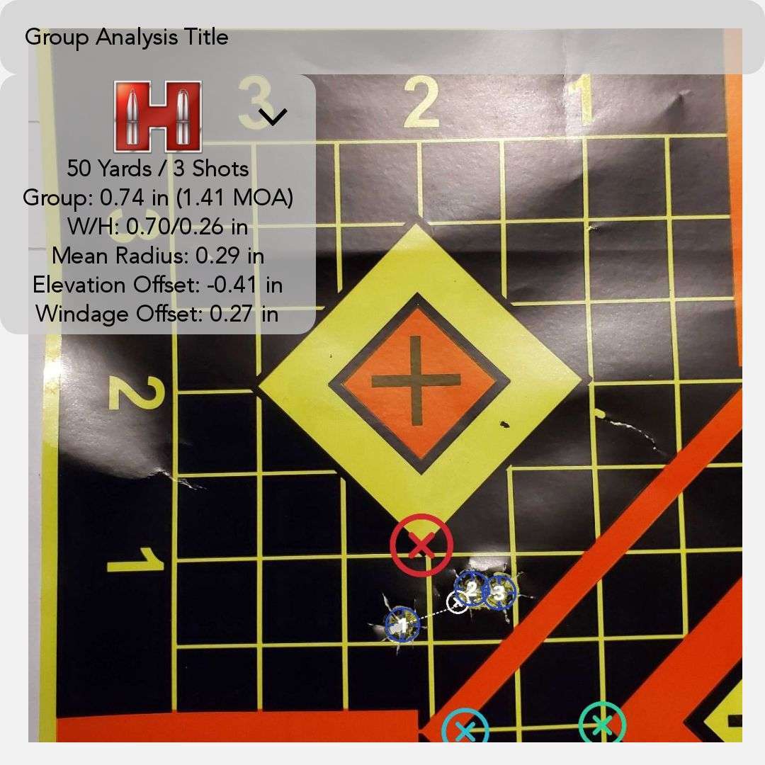

Tonight's range visit went much better than the previous one. I could locate my hits and adjust my zero after two shots. I shot another 3-round group at 50, then a 3-round and a 5-round at 100y. Now I just need to get skills :ROFLMAO:
50 Yards after adjusting based on my first shot on paper.
100 yards with the zero from 50 yards.
100 yards with a hold based on the last 3 round group.
