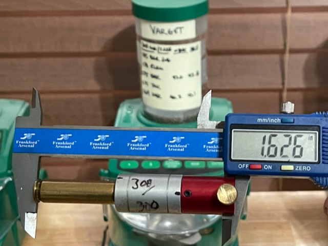

Do you have a Hornady headspace comparator tool kit or similar tool and dial calipers? If so, use bushing D400 measure the case head to shoulder datum of your fired brass (remove spent primer first) and post the number. If not and you plan on reloading then that tool or something similar is a must have.
If it’s closing on the “no-go” but not closing on the field gauge, I suspect your chamber’s headspace is prob 1.636-1.640 which is on the higher side of saami 308 win / 7.62 nato.
ETA: Here’s the tool im referring to:

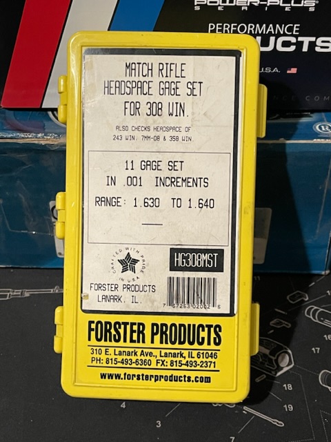

If you shoot a lot of .308 across multiple rifles and fairly regularly acquire new 308s it may be worth investing in a headspace gauge set like shown below, especially if you cant get reamer prints for any of the rifles…
