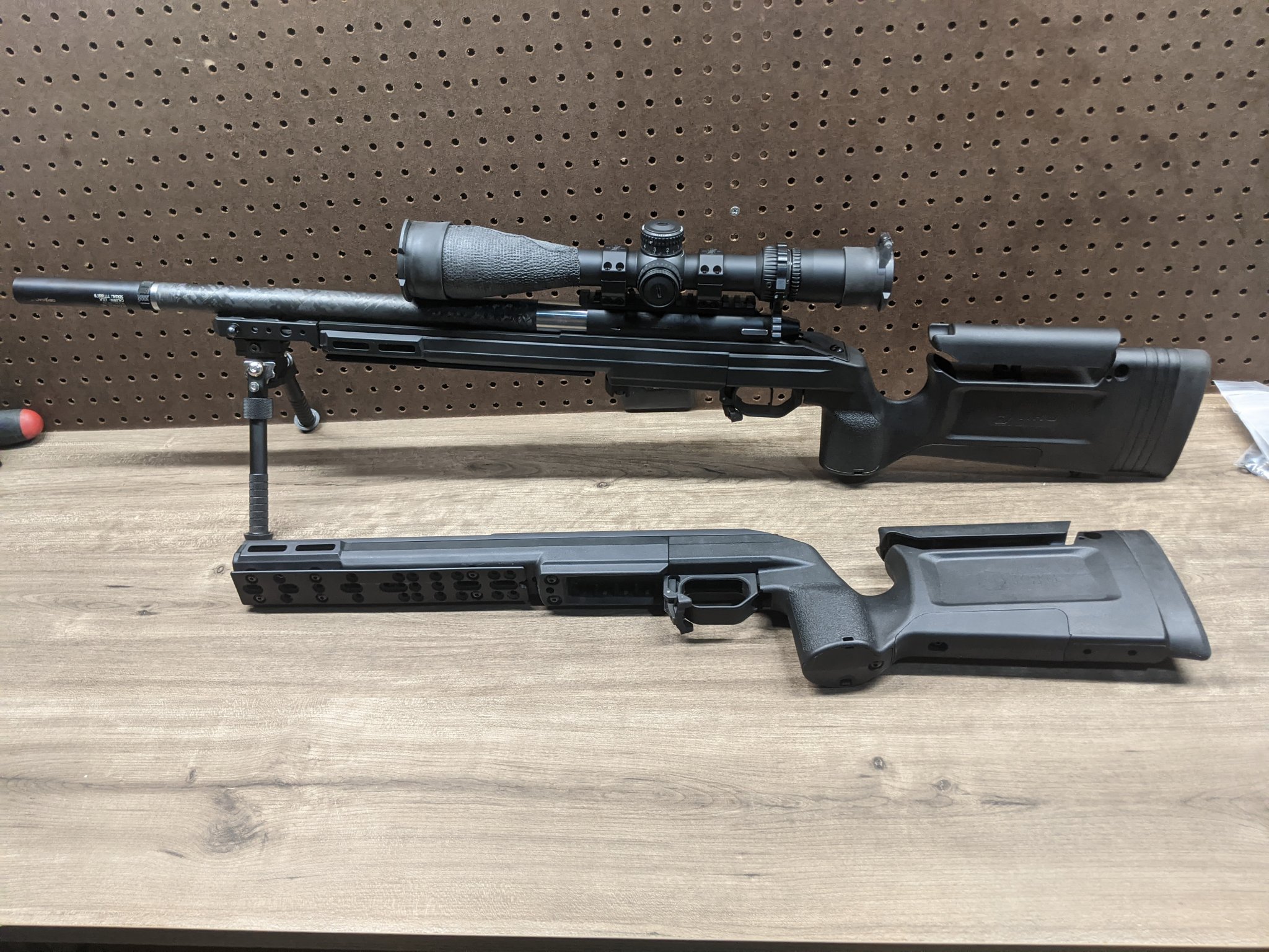

Building my first bolt gun for PRS. I'm looking at either a Bighorn TL3 to somewhat clone my RimX I just built or a Impact 737R. It's going in a KRG bravo so I know with the Impact I will have to modify the chassis some. What's good or bad between the 2?
Hard to have a preference when I've never built anything other than that RimX. 😏
