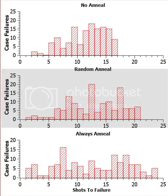

How many extra firings depends on several factors (e.g. size of brass; how brass is sized; how hot the cartridges are loaded . . .just to name some). But the info below should at least give you some kind of idea:

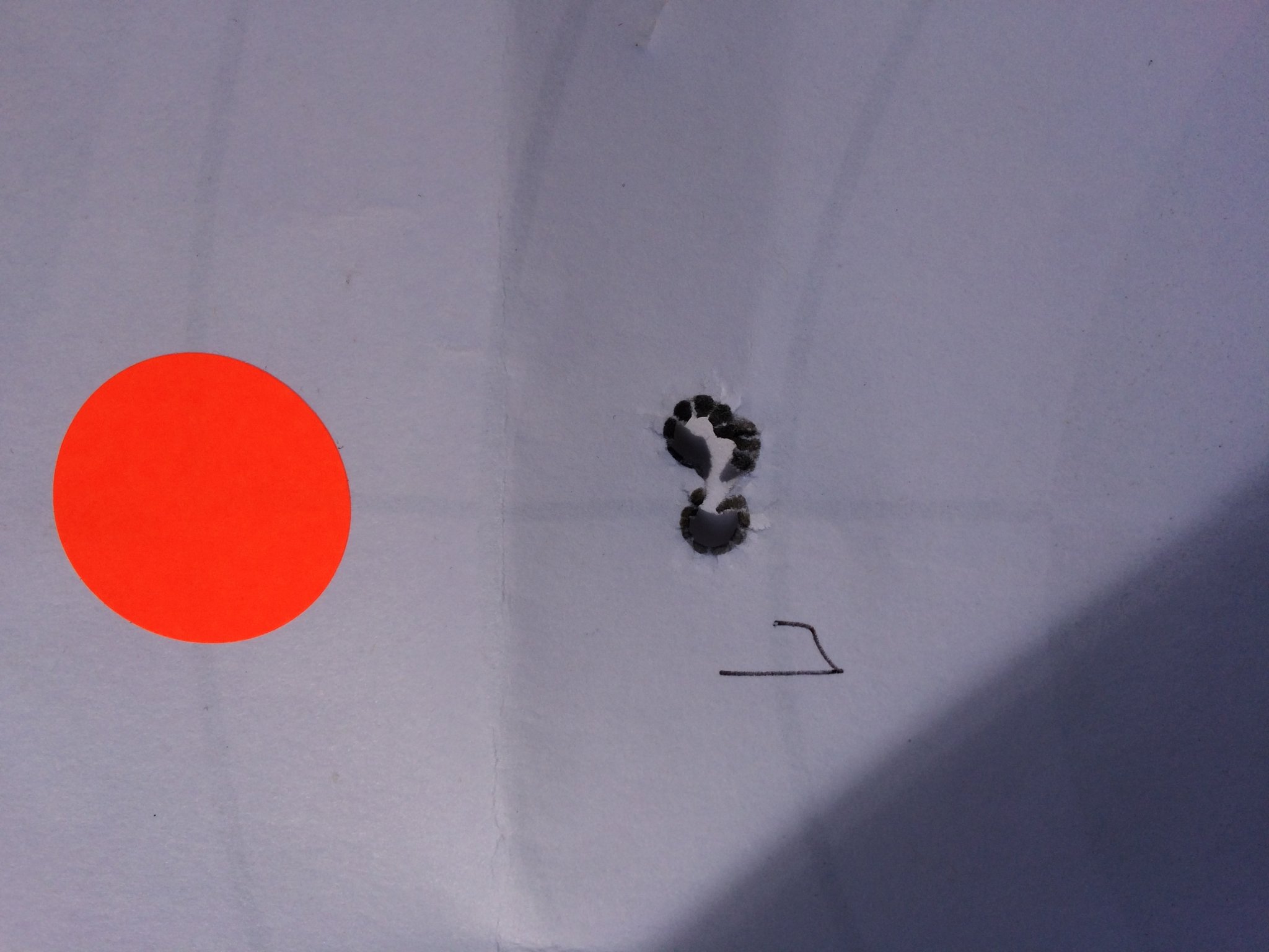

5 shot group @100 yds via 6.5 SAUM. Brass annealed in my fingers over a torch. Brass reloaded 7x.
Not sayin AMP is not the shiznit, just saying that it can be done.

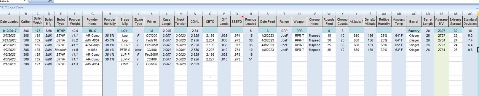

I use an Annealeez. Here's what I get over long strings:
What kind of numbers are you getting now?
Reactions: Baron23
