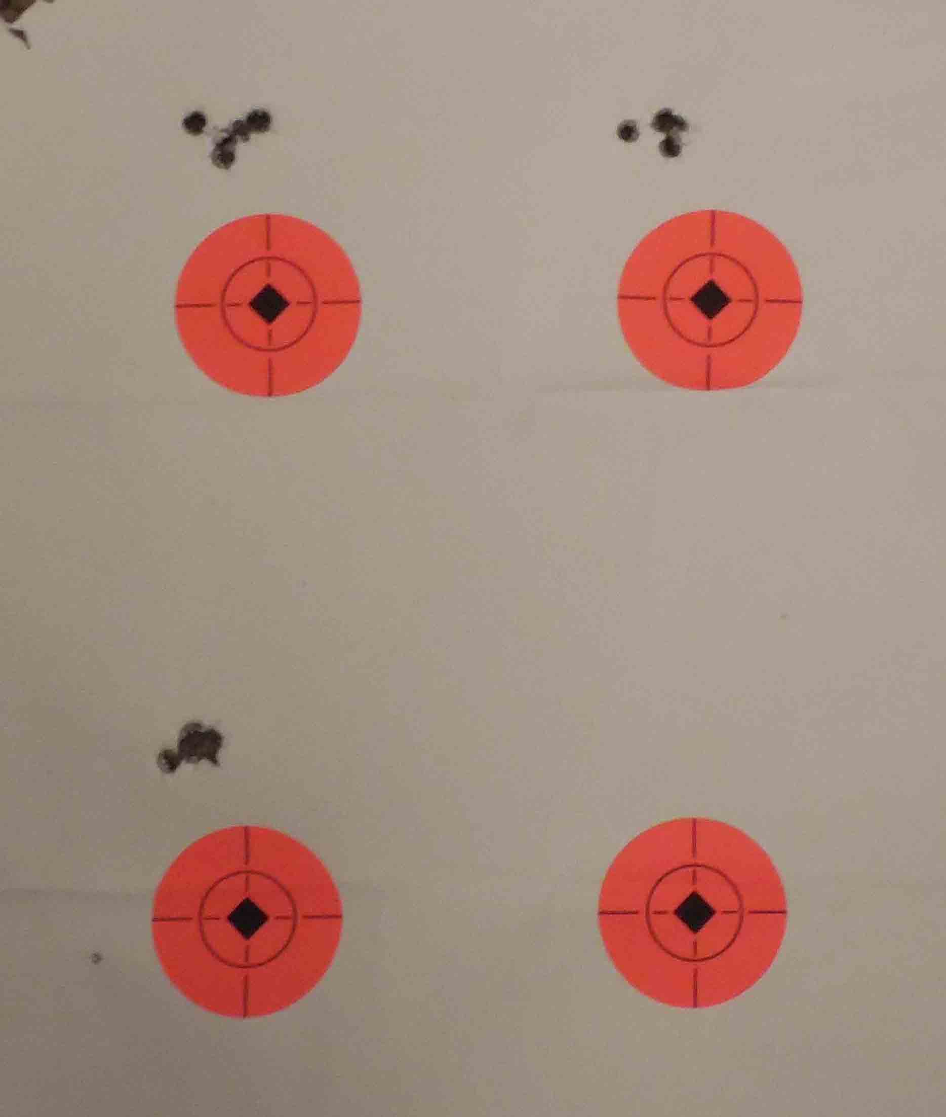

new 40gr target.jpgI've got a Savage Model 12(new model) Short Action, 204 Ruger. She came with the bull barrel, since been replaced with a Shilen Select Match, 28" 9 twist. The stock is "stock". this is my main question here. The stock IS NOT BEDDED, yet. As far as I can tell myself, I'm holding position the exact same every shot, but I could be wrong. Looking at the targets... I could use some opinions on whether to bed the action or not.
Could the one "flyer" be me, or the cheap Savage plastic stock giving differently with shots? I love the challenge, but these flyers are driving me F-ing crazy! What i wouldn't give to get all those inside that one hole...yeah yeah, I know, thats what she said! :)
here is what i've got so far:
win cases, full benchrest prep, fire formed and sorted: upper body .361" tight in chamber(fully supported), shoulder datum exactly same, necks turned, loaded necks at .224", bullets and primers sorted.
Top left group .010" off lands
Top right group .005" off lands
Bottom Left, kissing the lands, my load is 26.0 gr IMR-4064, 205M primer(sorted @ 3.6gr) , close to min load, primers good, no over pressure signs and no carbon on the necks after firing.
The only other variable I can think of is the V-Max bullets not being as consistent as Bergers. In my area, V-Max is all I can get for now with this shortage still going on. Since Berger discontinued my 50gr (still pissed about that!) I'm working on a super accurate load resorting to the 40's. Berger 40's wont be available for some time, so here I am playing with V-Max's. I would LOVE to hang with the guys and their big bores at UNSC 600yd match next month with my little 20cal! I just don't think she'll buck the wind at 600. Sure would be fun though!

Here we go.... I got results I was NOT expecting! I bedded the stock, measured and found my recoil lug had 1/16" clearance prior to bedding. So every shot prior was stressing the action screws 100%. Thanks Savage for a great stock! lol. After bedding, my groups reversed.
Prior to bedding, seating to the lands got me the tightest groups.
Post bedding, seat to lands sucked, .015" off lands was best group!
Has anyone experienced this? Where bedding dramatically changed groups this much? In the pic, target one shows groups at 100yds, target two at 200yds. the 200 yd target you can really see the groups changing.
My issue is, since bedding the action, no longer is kissing the lands accurate! Now, .015 off the lands seems to be better. Could the harmonics of the barrel and action change this much?

Yes it could. You can change point of impact by changing the torque on your action bolts. The barrel could have been touching the stock in front of the action and isn't now. Maybe there was a little stress on the action that you relieved with the bedding.
I would try adjusting the seating in finer adjustments from the 2.385 and the 95 depths. In the first group at 100 yds, It looks like you need to add a little powder but at 200 it seems to level the vertical out. Were all groups shot with the same charge?
I got ya. I did torque, so now it will be a constant from here on out. From here...would it be best to adjust the seat depth up and down by .005" increments?
All were shot with the same charge, 26gr IMR-4064, but I did adjust the elevation after the first 5 shot group and a time or two there after, but NOT during groups. I just wanted the rest to be closer to the bull. I should have left it alone and let the groups hit high or wherever they landed. It was off after re-installing the scope after the bedding job. It bothered me it was hitting high. I do see what you mean and yeah... Shoulda left it alone! Would have shown the true placement better. It still shows each overall group.
I checked my range notes....after initial sight in with fouling shots, went onto targets. after group 1-1, adjusted 6 clicks elevation down for targets 1-2 & 1-3. after 100 onto 200yd targets, cleaned barrel and fouling shots(3) hit low, adjusted for 200yd groups up 8 clicks. Shot 1st and 2nd 200yd groups(2-1 & 2-2), then adjusted 4 clicks down for last group(2-3 on target).
I would try in .003 increments above and below the 2.385. Talking more about the horizontal and vertical spread of the groups, than placement on the target. IMHO the Bergers are more consistent than the Vmax but for the price difference I shoot a lot of Hornadys.
Realize these are amaxs but. Eric Stecker in the Berger Reloading Manual talks about the sweet spot is .030 - .040 wide in vlds. Recommends testing off lands at the following: .010, .050, .090 & .130. 6 shots each. One will outperform the others to you as being the most accurate and then getting fine tuning from there...
