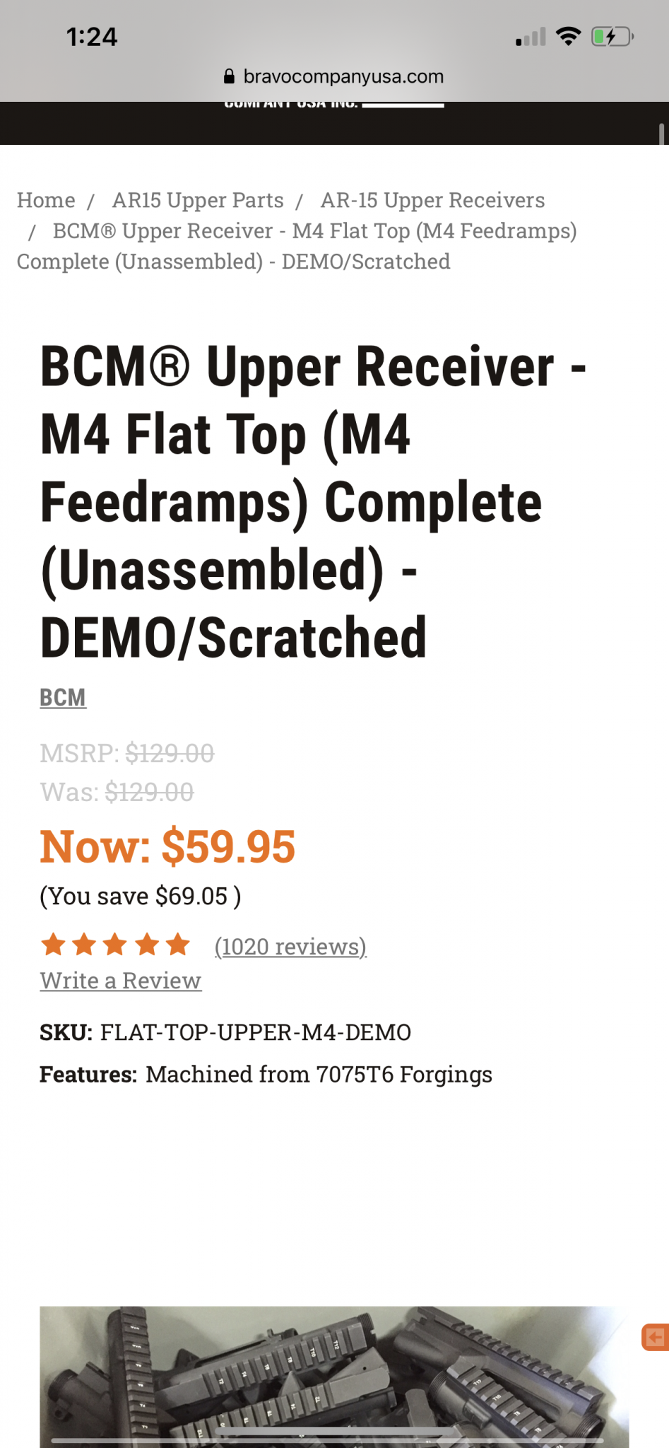

You sure arent loosing anything having a thermo fit BCM upper with door and forward assist for $59.99. Buy it over an Aero all day every day and on Sunday.
True, but nothing that affects function; a little paint covers pretty much all the sins on the ones I've used previously.

I picked a couple up to play with . I have a white oak predator barrel in the way so why not give them a try.
Those are blemished scratch and dent for $59 let’s be clear
You have never bought them but know you know what your buying?? Myself and many on here have bought many 100's. They ARE NOT blems... They MAY have a scratch on them from being handled but only one out of over a 100 came with a mark on it. All the rest brand new in a box with not a mark on it.
No clue what you are even talking about. I stated a fact . That is that the $60 uppers are scratch and dent. This is info rite from their site .
