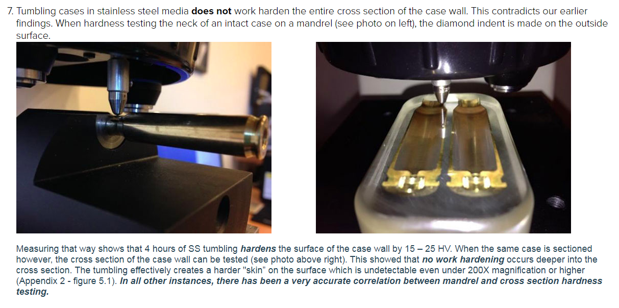

Quite a while back there was a member who ran a test on Lapua .260 Remington brass life. From memory, it was in the neighborhood of 25-27 firings with a 140 Hybrid, 42.5g H4350, annealed every 5 shots, and no cleaning of brass as it was all done in one range session. After I asked 'but how did you clean the brass,' and the member said they didn't. Another member suggested that there are a ton of benchrest shooters that wipe down the neck, and leave the inside of the cases soot'd up. It was described as desirable barrier between bullet and casing that provided lubricity...News to me.

The allegations that stainless steel tumbled cases cause issues with bullets eating neck tension and extreme spread are exaggerated.
If you use the right proportions of soap to acid to water with your stainless steel media, these issues do not present themselves. And if they do they can be quickly alleviated by the use of imperial dry neck lube.

Very interesting. When the Stainless Steel media tumblers became popular a few years ago, many people wondered if the heavy pins beating on the brass will work harden the cases. Well something is pushing your SDs up, wonder if it could be different amounts of work hardening on the necks changing the amount of spring back, and as a result neck tension might vary? Could also be something totally different...

Edit: Tried to summarize the main conclusions of the articles for those who have limited time. If i got it wrong, please do correct me.
Read all of it while waiting for a very delayed flight to Alberta Canada (black bear hunt).
Cleaning with stainless pins: My read of the article is that hardening occurs only on the microscopic surface on the outside of the case, and that tiny amount of hardening (to a depth of only a few thousands of an inch) is not enough to affect the bullet pull force (effective “neck tension” in lbs). The work hardening from ss pins peening the surface apparently does not go deep enough into the brass to have a real effect on bullet release. Good to know! [Of course it will also affect the surface finish (degree of polishing that occurs) and that can affect how well and how quickly the neck grips the chamber when the powder starts to burn and pressure starts to rapidly increase. Their experiments did not test this aspect.]
Also progressive buildup of more and more carbon in the neck (equivalent to graphite dry lube) seems to progressively reduce pull force after firing the same brass again and again without ever cleaning it. [Have had the same experience with a K&M arbor press with the force measurement tip.]. So some degree of cleaning is still required. Over-cleaning is probably not needed, just return the case necks to the usual degree of carbon fouling. Try to keep the carbon buildup in the neck as constant as possible. [So use a timer when you run your tumbler or ultrasonic machine?]
Reloading with less case cleaning and leaving more carbon in the neck seems to work ok, as long as you are consistent. Did i read that correctly? And carbon fouling does not affect the degree of annealing in the AMP machine.
Dezincification can only br caused by chemical attack, like exposure to ammonia, which is present in bore cleaner. So properly clean out all the Hoppes Nr. 9 before you put any brass in the chamber! Brake cleaner works well. Annealing of brass via gas flame or electrical induction heating will NOT cause dezincification. So all the YouTube videos posted by amateur metallurgists showing a yellow flame coming off the case neck and claiming the zinc is being burnt out if the case neck once the temperature goes high enough is just bs. [Of course you do not want to overheat the brass during gas flame annealing as it will go very soft and become unsafe, and the yellow color in the flame might well indicate something of value, but no the zinc molecules do not evaporate and do not enter a glowing plasma state..]
Quenching hot cases post annealing with water has zero benefit. [Does not seem to do any damage either, just a wasted effort. And cases tend to get water spots when you dry them.]
