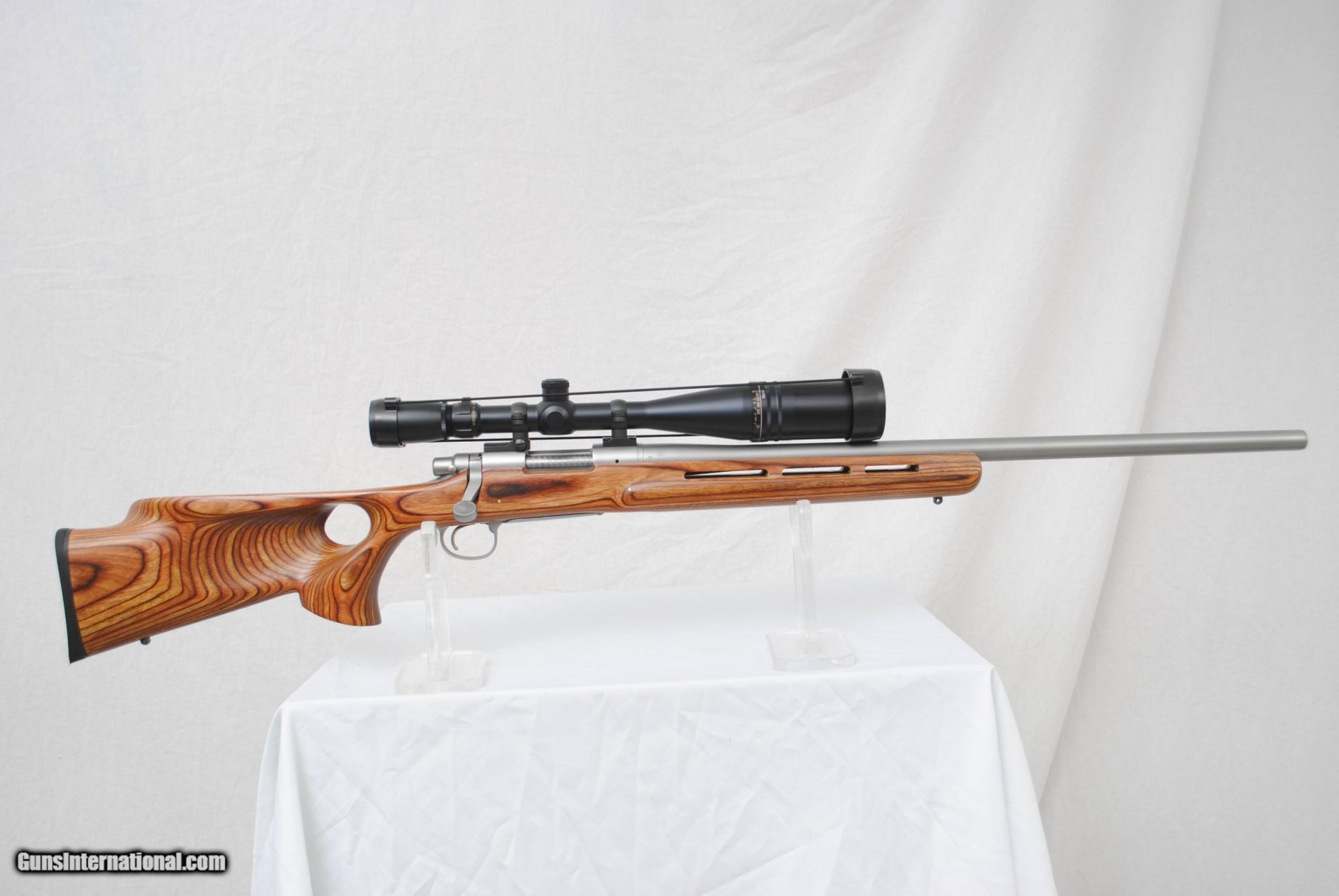

Edit: here’s my gun. Not my pic; it was from the seller, so ignore the scope. I don’t have a fashion studio for my rifles.
That’s on idea I’ve kicked around, although tungsten is 50% heavier and a million times more expensive. Also I’m considering adding rods of lead/tungsten in the forend.
But…maybe I could skip all that work and get a Manners, but I don’t know how heavy one can make them (esp. compared to a chassis like a MDT ACC).

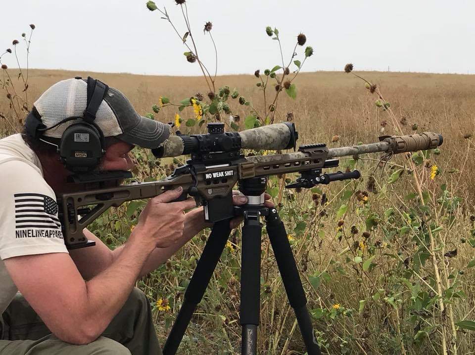

Lose the table. Shoot off a tripod while sitting in a chair, with the rifle clamped into the tripod (ARCA Swiss). No need for weights, etc. Better recoil management, especially for the smaller calibers like 204, 223 and 20 Tactical. Been shooting PD's and ground squirrels off a tripod since they were just called cheaters, and it was a shitty tripod with a small bunny ear bag velcro'ed to tripod base. Started doing that back in the 90's...
Fundamentals. Set the tripod height so both elbows can rest on your knees while sitting in the chair (and on the gun). Steady as hell, and easily handles recoil without losing sight picture.
What MarinePMI said.
If you can't spot your hits with the existing set up, your fundamentals and bench need improvement. Not meant to be derogatory. I had a 204 that weighed 12 lbs scoped and had no problem whether benched or bipod.

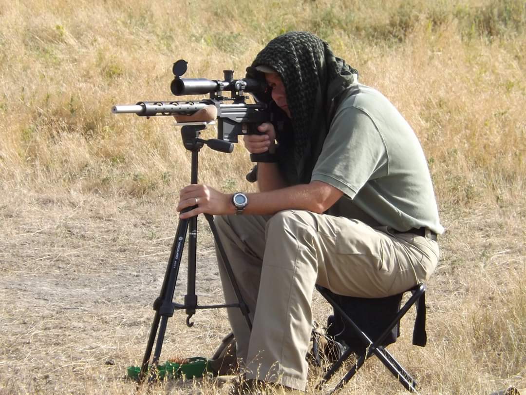

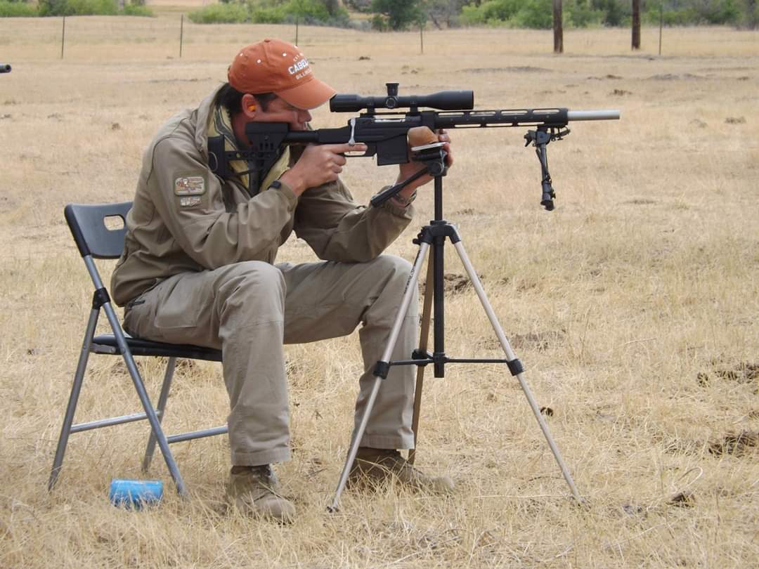

Sure @carbonbased see below a few pics. One if from two years ago, the other two are from....crap, 10 years or more ago... Look at my elbows (bone support), and the angle of my torso (to manage/absorb recoil). Lots of triangles in the top picture...
Two years ago (Tikka 223 Varmint that's been threaded).
Probably 10 or more years ago (note the cheap Velbon tripod, and ghetto cheater bag). .20 Tactical
Forgive the doo rag; it was well over a hundred degrees when this was taken. The wet shemaghan and a slight breeze were the only things that kept it bearable (this was in a horse meadow, that was in a depression...stifling heat at times).

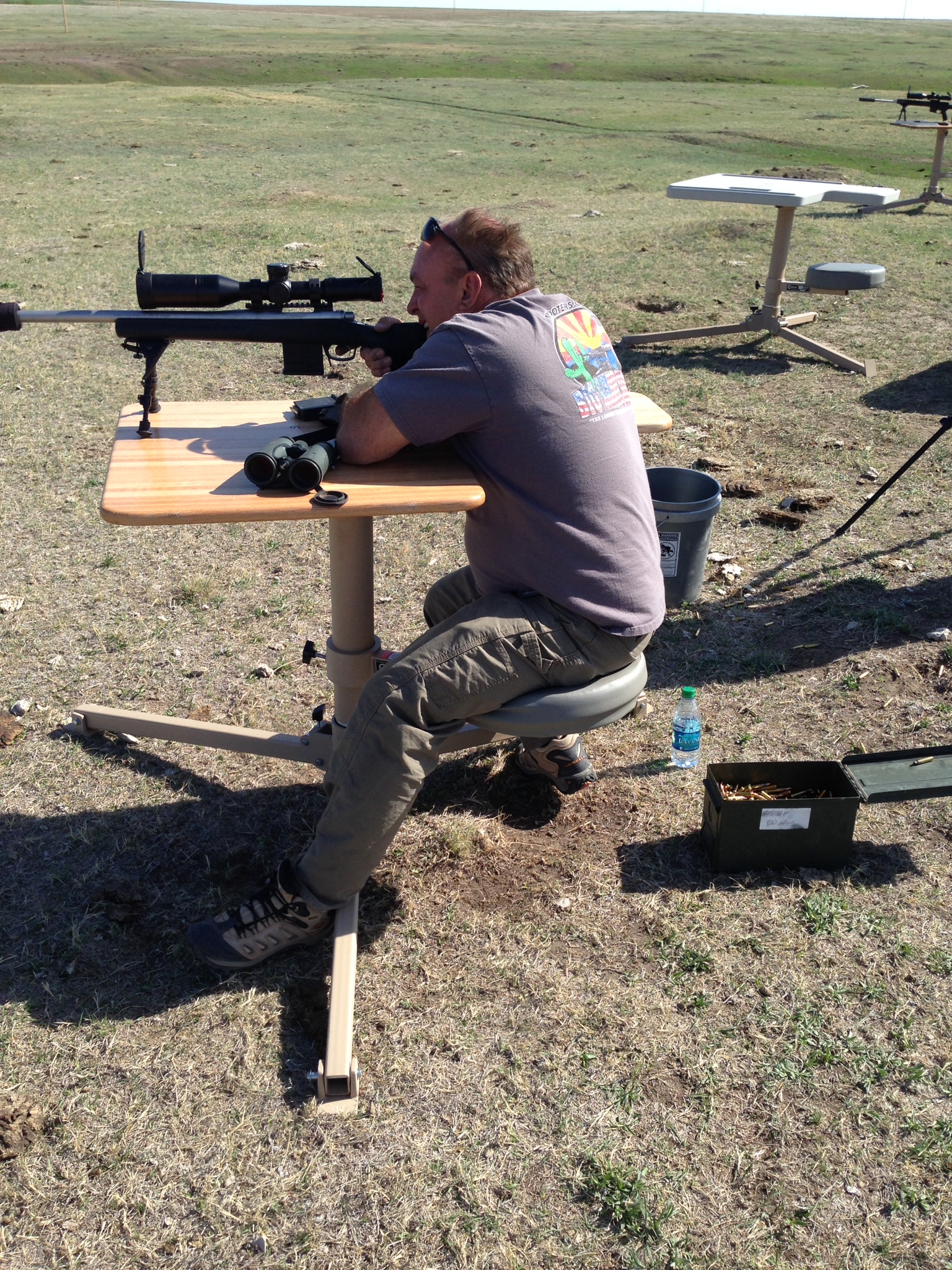

The thing to keep in mind with the tables, is that they swivel 360 degrees. Super helpful in the dog towns I’ve been to.
Nice bench. I’ve heard those are better than the post-cadwell.
One year I got a $65 deal on this one at end of season at Menards: https://x-stand.com/product/the-x-ecutor-360/
My brother has a similar brand bench called Muddy- something. The X-ecutor is better, for what it’s worth.
I might upgrade my bench, but I found shooting off a hard pickup bed cover is more fun, as it’s super fast to set up. Park, slap bag on bed, shoot.

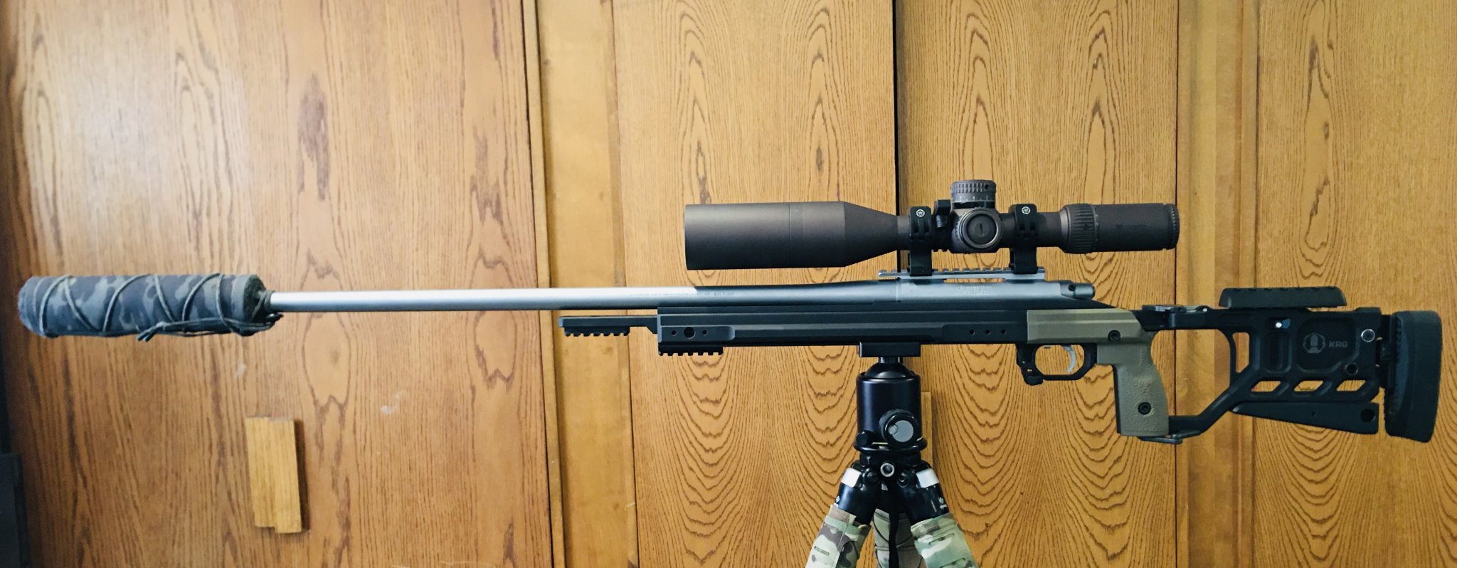

Update: I gave up the idea of adding weight to the factory stock and bought a KRG Whiskey 3 folder (heavier than non-folding). Also added the aluminum Arca competition forend and heavy internal weight. Btw the folder makes it easier to clean as I don’t have to mess with lowering the cheek piece.
Also got both the flat heavy butt weight and the heavy angled butt weight. I like the angled one better because it’s faster to slide the rear bag a little to adjust the elevation. With the flat one, I have to add/subtract a spacer under the huge front sandbag I use. If I use a bipod, I have to reach way up there and ratchet the legs up/down.
Rifle is now roughly at 18-19lbs, so all is good. When I shoot my barrel out I’ll get a heavier profile and it’ll be even better.

You like that table?
I am in search of something like that...
It works well - seat height is adjustable up/down - table top is adjustable to the right / left for how you like to set up your rifle / rest -top has a perimeter ridge to keep fired cases from rolling off - and - it doesn't weigh too much. Not too bad.
