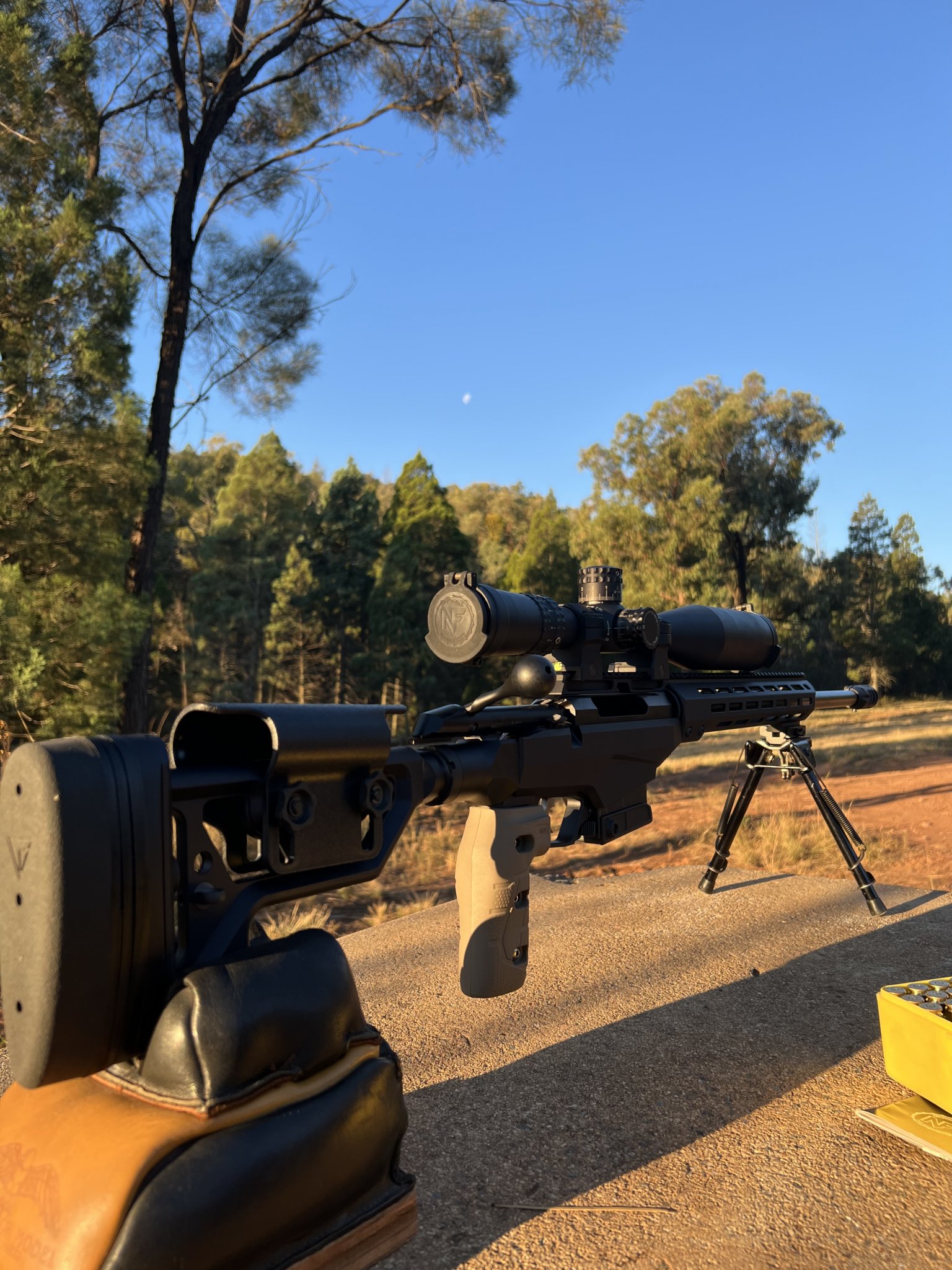

Looking at painting my tikka Desert tan…. Watched a few videos online but still holding off. Thoughts ?? Anyone painted a rifle previously ?? Cheers.

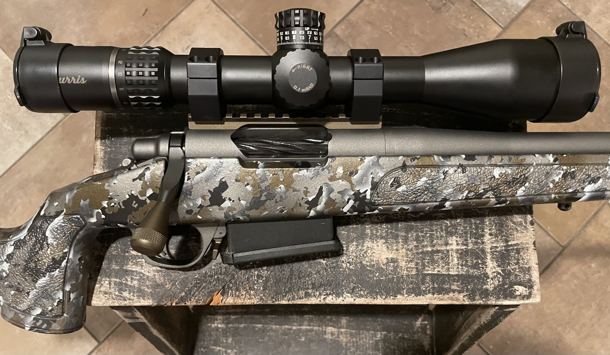

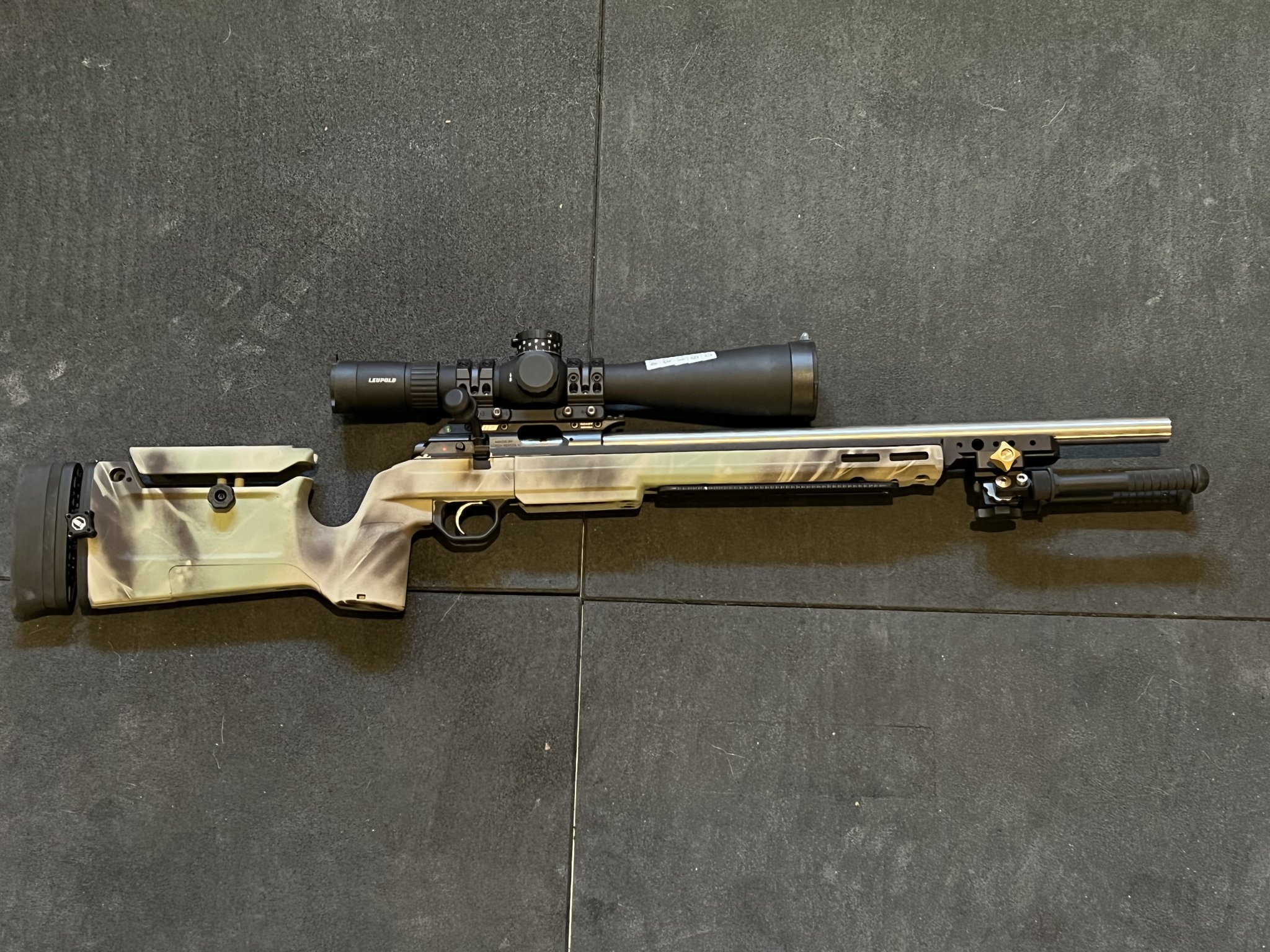

Finally mustered up the courage to take paint to the .22. Turned out ok, I think. Almost looks like it needs a little more dark colour, but we’ll see how it looks in the wild.
Best part was getting the wife to grab a bunch of grass on our walk this morning. “Will this work? Ooh, what about that? That might look good!”

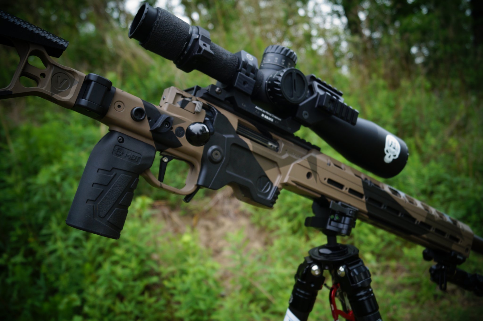

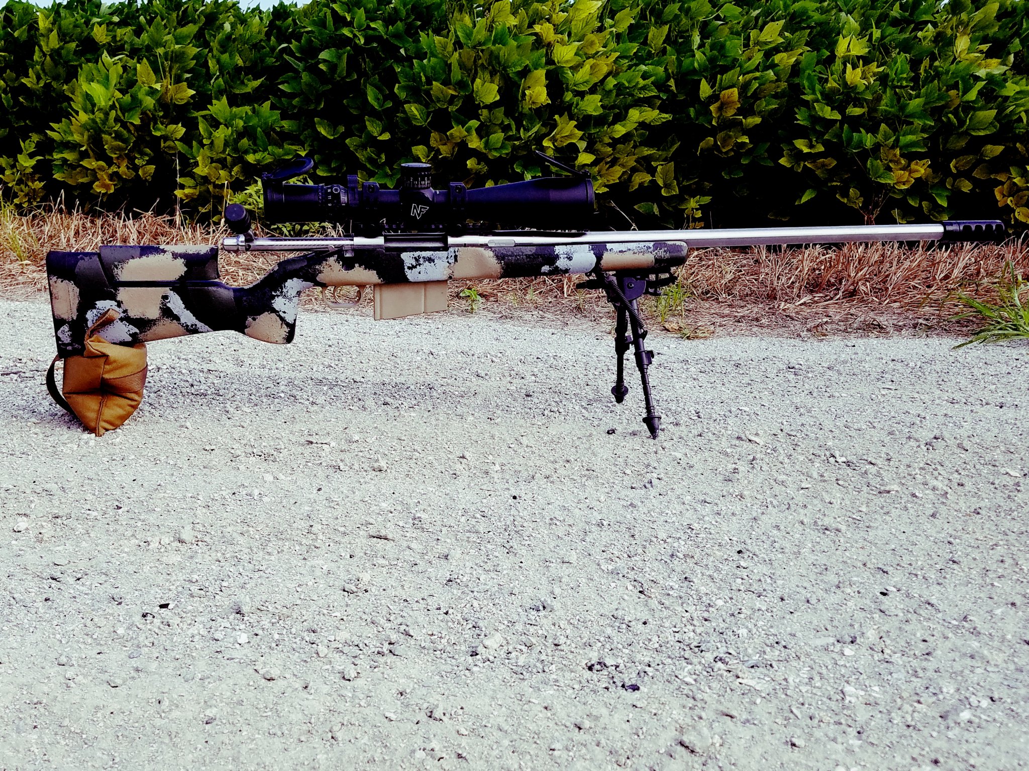

Cerakoted it.
It will be the best coating, and it is durable.

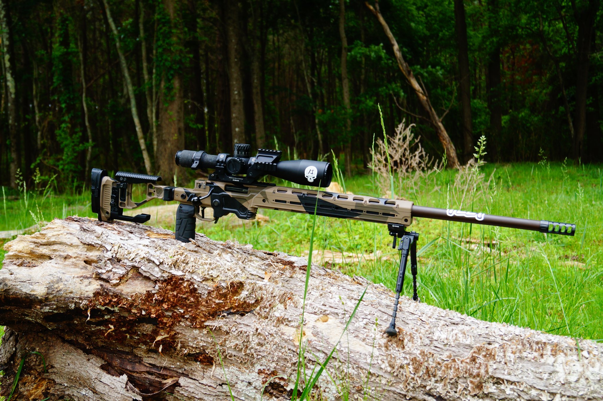

I had TAC A1 cerakoted, highland green.
Code H-200.
This is how your rifle would look, after fde cerakoted ;)

View attachment 7865312Finally mustered up the courage to take paint to the .22. Turned out ok, I think. Almost looks like it needs a little more dark colour, but we’ll see how it looks in the wild.
Gorgeous!

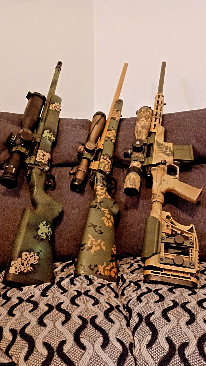

I have 3 SS rifles with cerakoted barrel, no problems what so ever.
Left one is not one of them, that is chromoly barrel, but it is also cerakoted by od.
Middle one is stainless and the on the right, it has 4 different colors, since it is camo pattern.

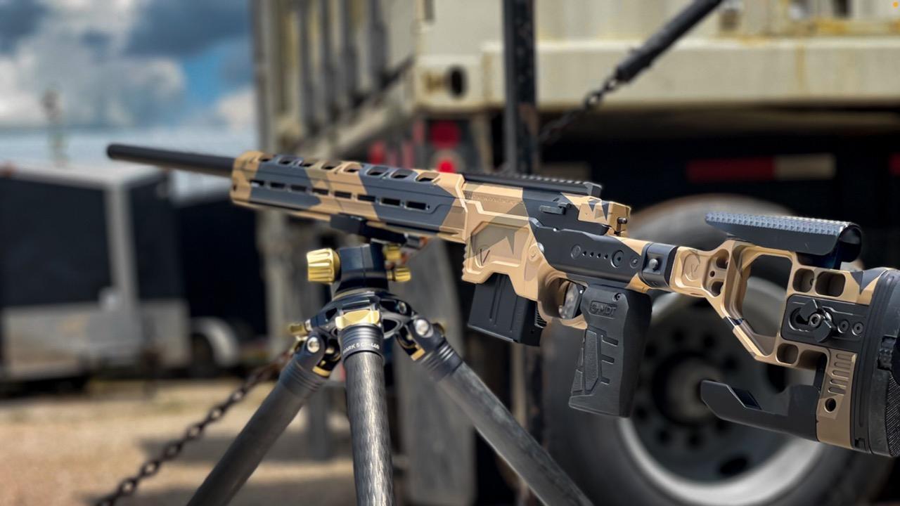

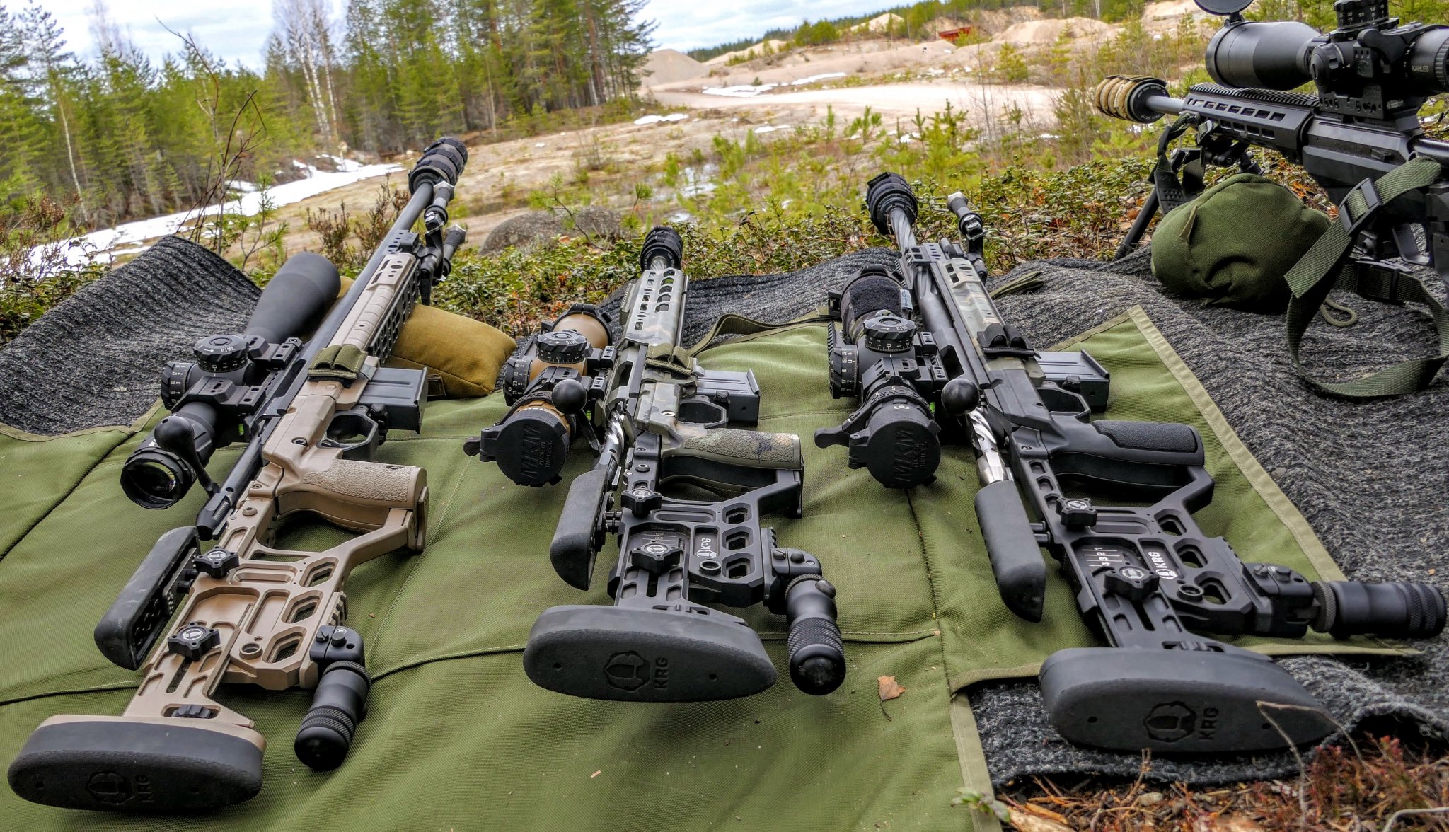

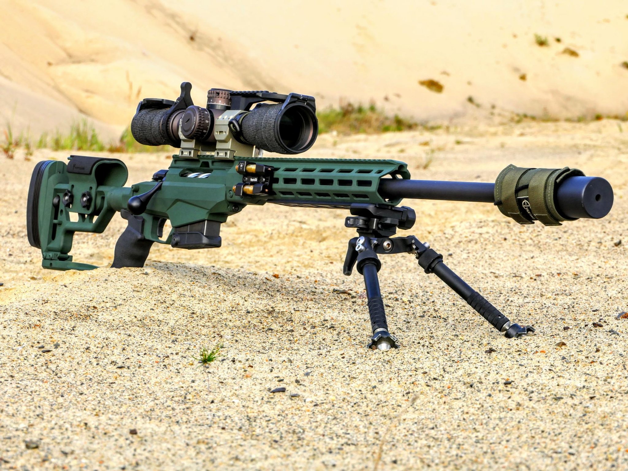

Cerakoted it.
Code H-200.
Mate!! That looks awesome! How much did that hurt the wallet ??
Reactions: viking78
Thanks :).
Singe color it is about 230-270.
The chassis/stock would be about 500$, is equal to 450€ in Finland for a camo pattern.
I have 2 KRG Whiskey panel kit on there at the moment, one will be multicamo and second one is desert camo.
Waiting time is the worst time, would love to see those ready, but i dont mind to call there, and rush it :)

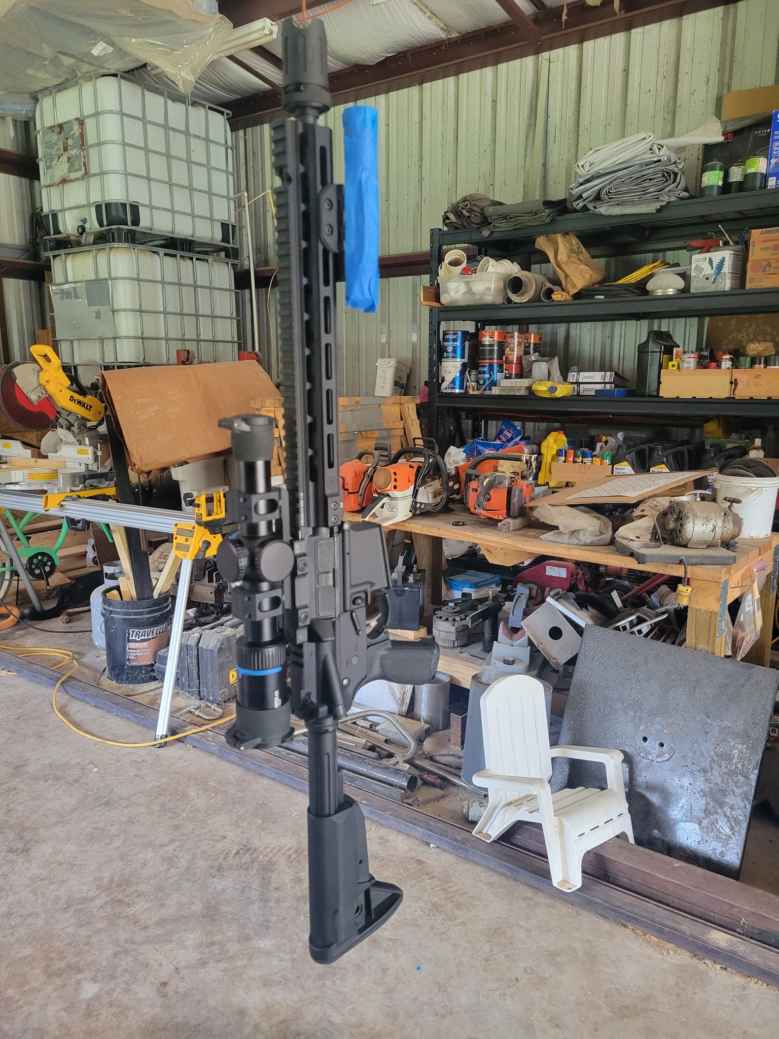

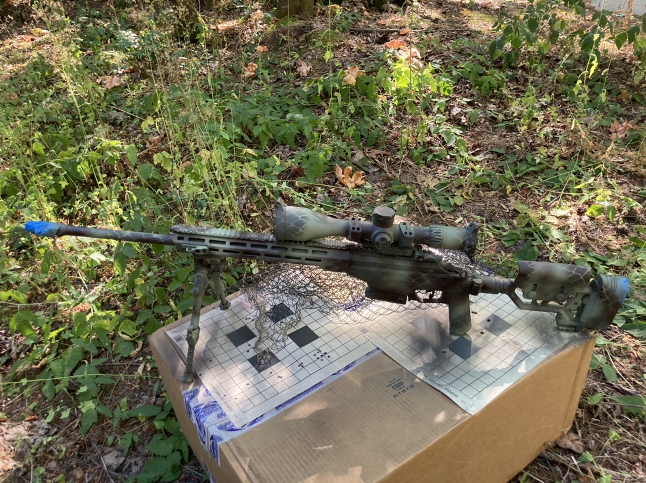

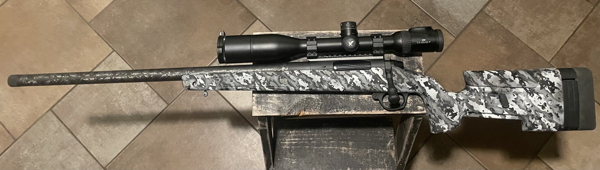

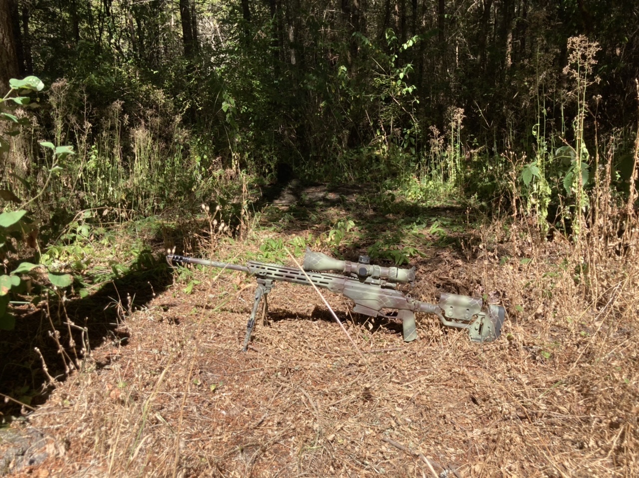

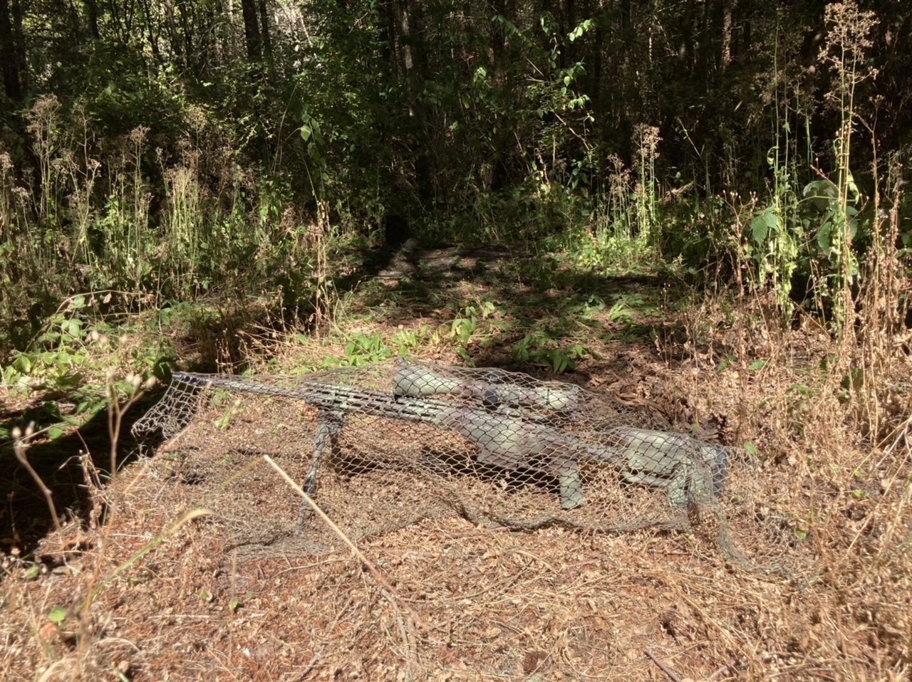

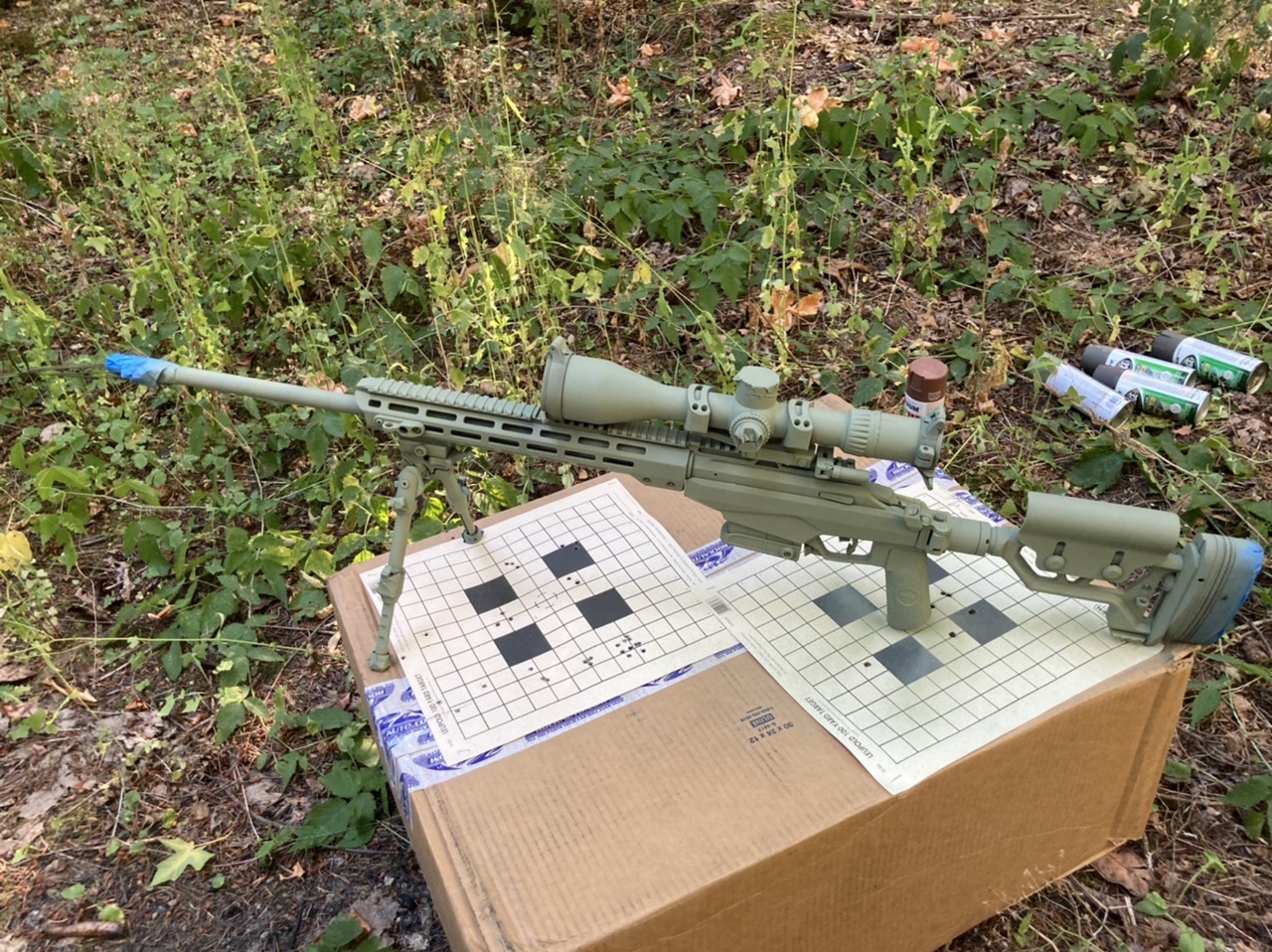

Just painted my Tac A1 this morning. A few minutes masking parts, wipe down with 75% isopropyl wipes, and off I went. Solid color base coat of light green was really 4 light coats. Then the netting went on, hit with forest green and earth brown. Netting off, hit a couple spots with the FG and EB to create a little splotchiness, and cure in the sun for a few hours.
I had all materials on hand, so it was free to me, lol. But really, maybe $2 in materials. 5 ft of 1 inch blue tape, alcohol wipes, some earth tone spray paint, and netting. I highly recommend netting type materials. I keep them with my rifle pack, as field use material. Paint doesn’t hurt em one bit, and adds to their usefulness.
My main goal was simply breaking up the profile.
Paint them rifles!
View attachment 7951377View attachment 7951379View attachment 7951380View attachment 7951381View attachment 7951382View attachment 7951383View attachment 7951384View attachment 7951385View attachment 7951390
Paint them rifles!
Paint them rifles!

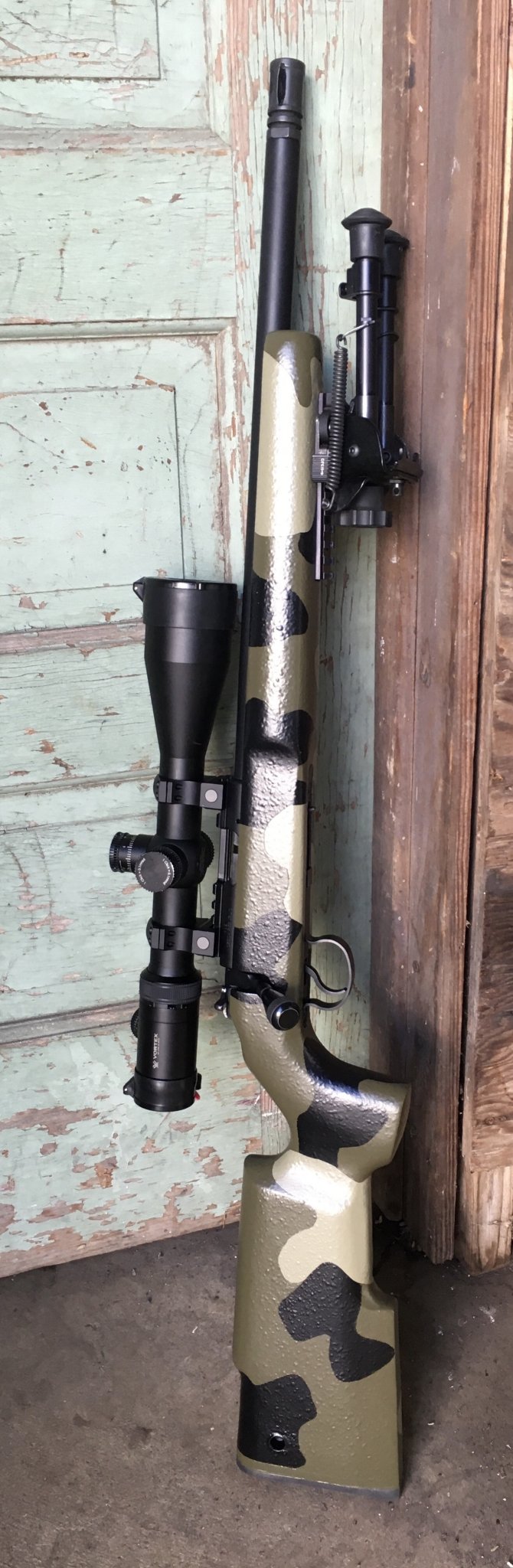

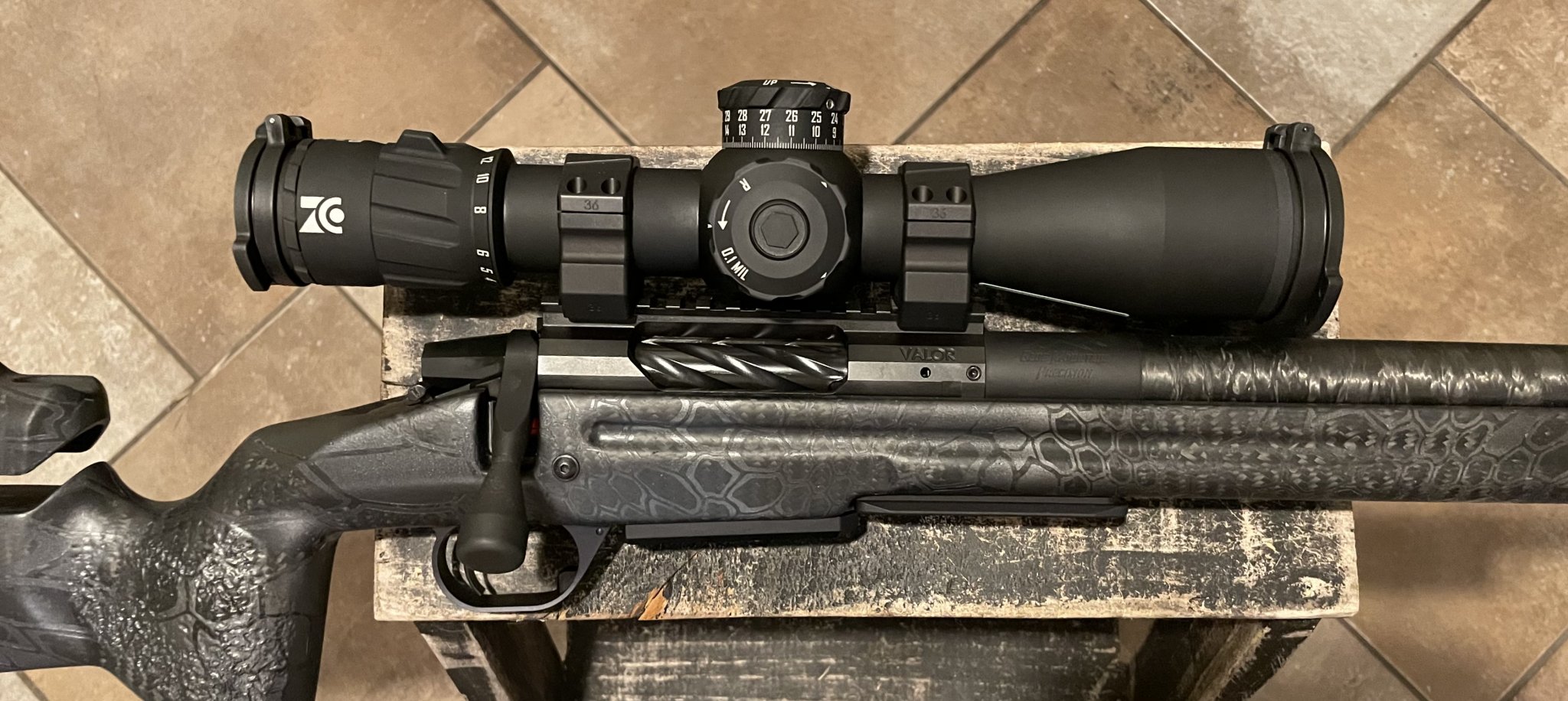

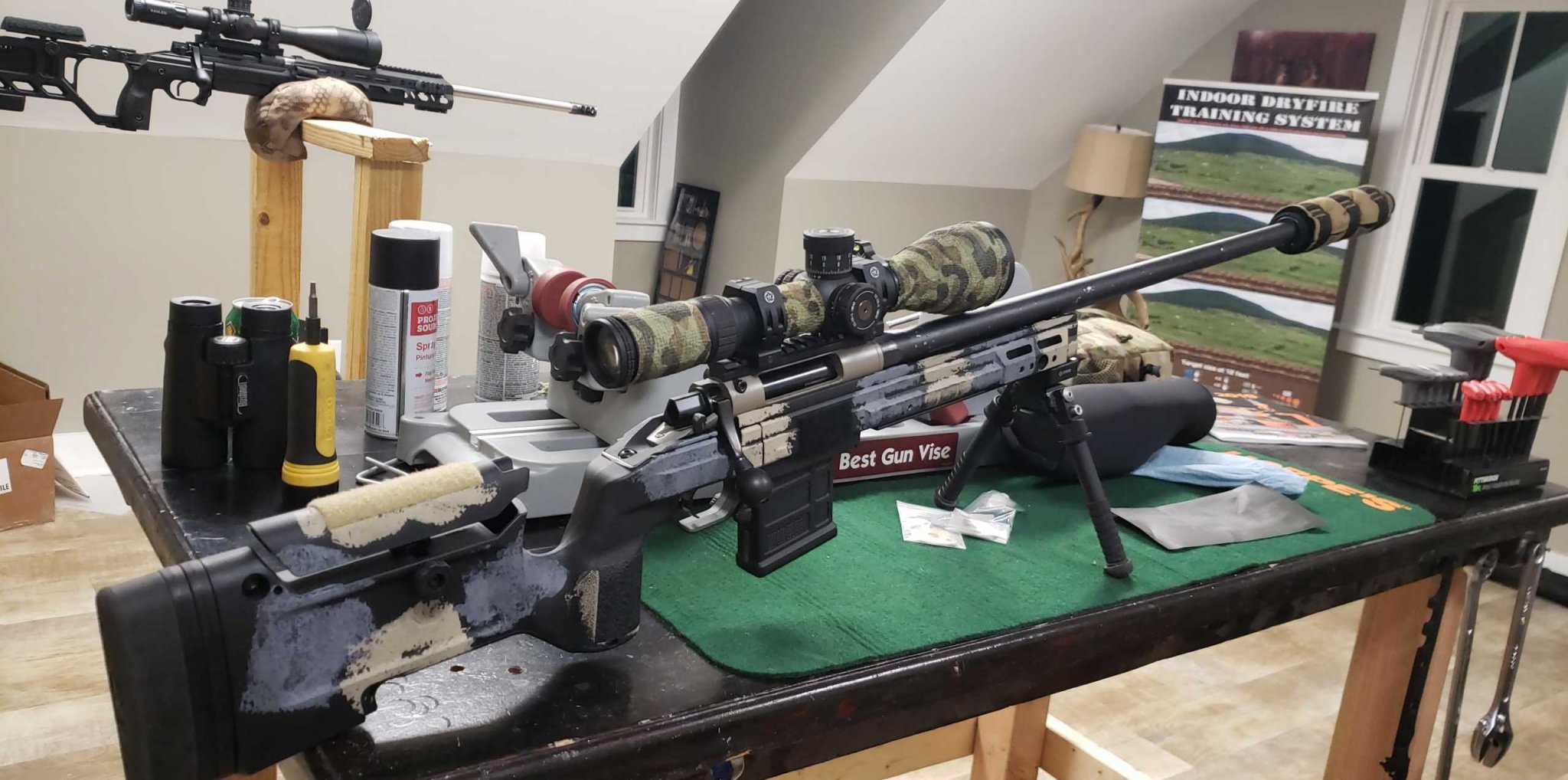

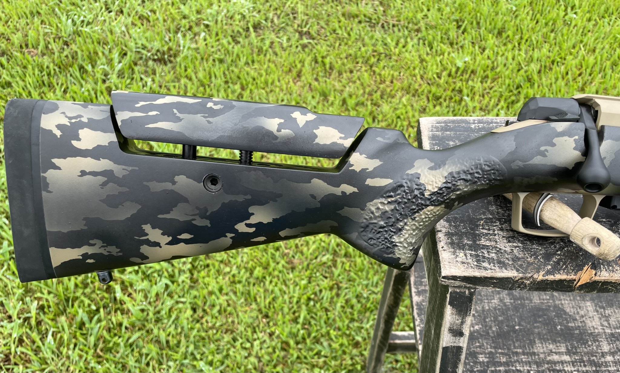

Coyote Tan Tikka - “home brew”
There is a marble trick that really helps with masking for 2-tone flutes. You paint the base coat and let dry. Cover the barrel with 1 layer of tape keeping the overlap of tape to a minimum. Use a marble or steel ball bearing that is about twice as wide as the flute and rub it along the flute over the masking tape. The marble will cut the tape along the edge of the flute. It takes pretty firm pressure and a rubbing motion I have found. The edges are pretty clean. Touch up ends and any over hang with a razor blade. I also use the razor blade to cut along the flute where the tape may be overlapped. The marble has a hard time cutting through 2 layers cleanly.
Yeah I should have taken a pic outside but...
This was my first attempt at rifle painting. Went with a light colored base then sprayed over some local vegetation with some brown then sprayed over it with the green. The green was lighter than I preferred so I lightly dusted over it with the brown in places. I'll do better on the next one.
And yes, my shop is a wreck.
Reactions: jd138 and brianf

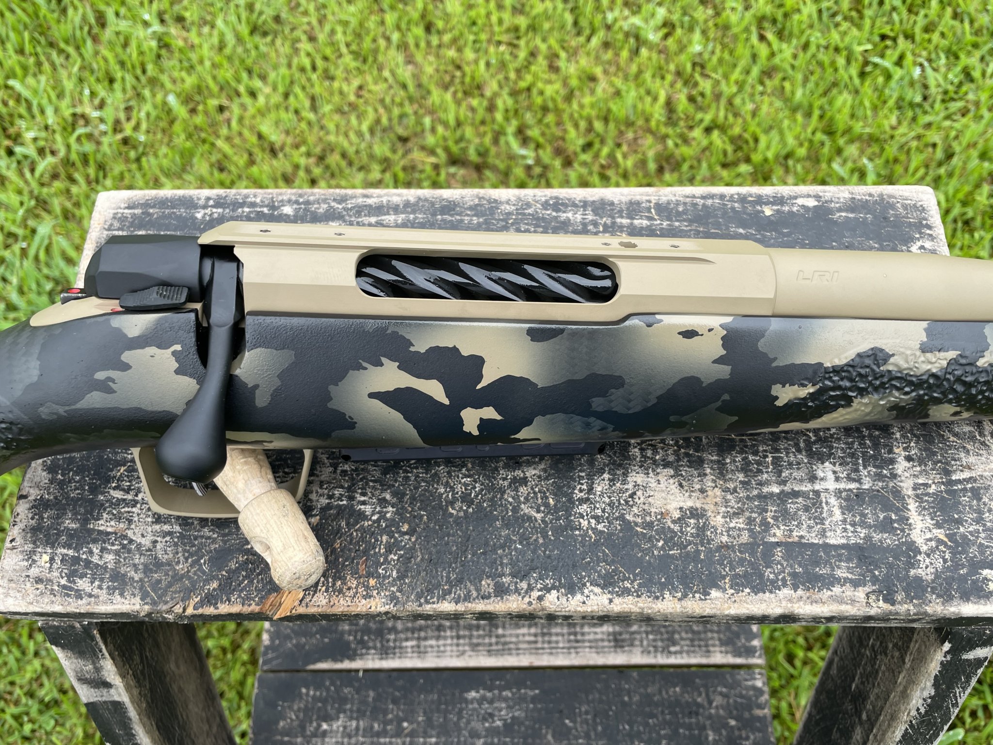

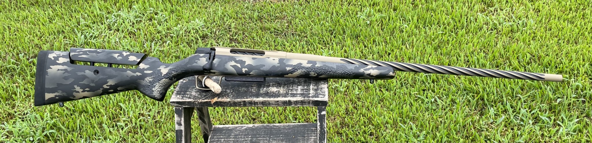

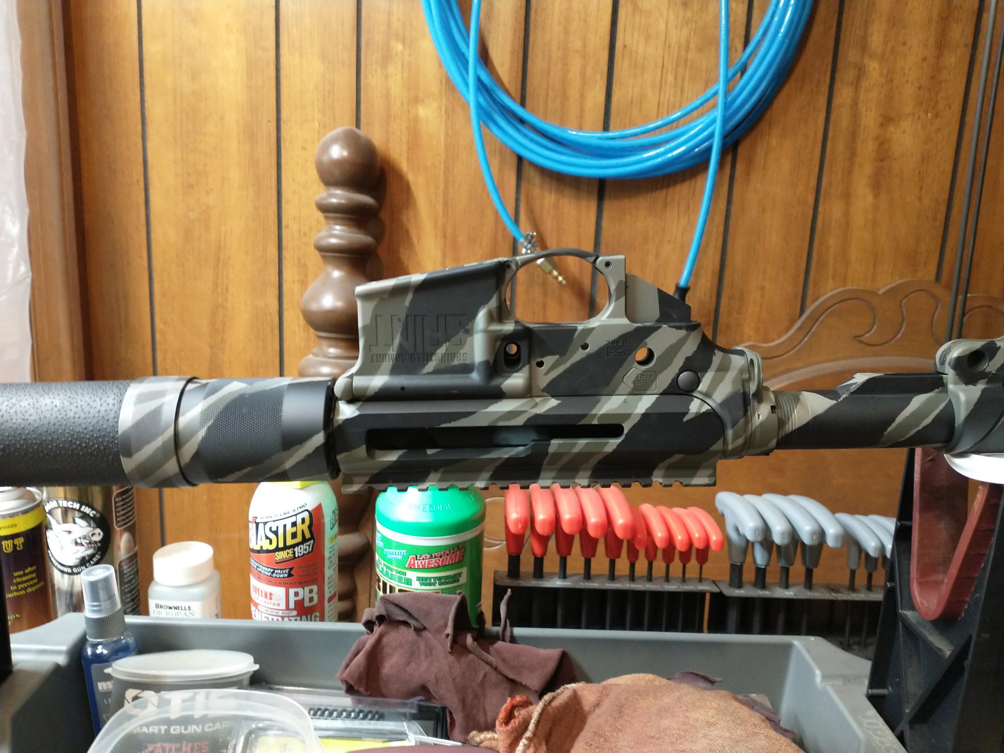

Some patterns from Freedom Stencils Weapon Works stencils…
Sorry for the borderline “high-jack”. If anyone cares to ask about the patterns I thought they were pretty unique when I found them. I just started getting into the more detailed patterns myself.

Lastly, the stencil kits can be used with spray paint too. If someone wants to know more about a specific style, I don’t mind sharing some of the techniques I use. I’m no professional. I just like to paint. I’m still learning too.
I’ve found a couple good places to get stencils. One place has some unique ones I haven’t found elsewhere.
Just here to participate and share information. Sometimes it’s hard to find good inspiration. I’ve searched many hours only to see the same styles often repeated.
