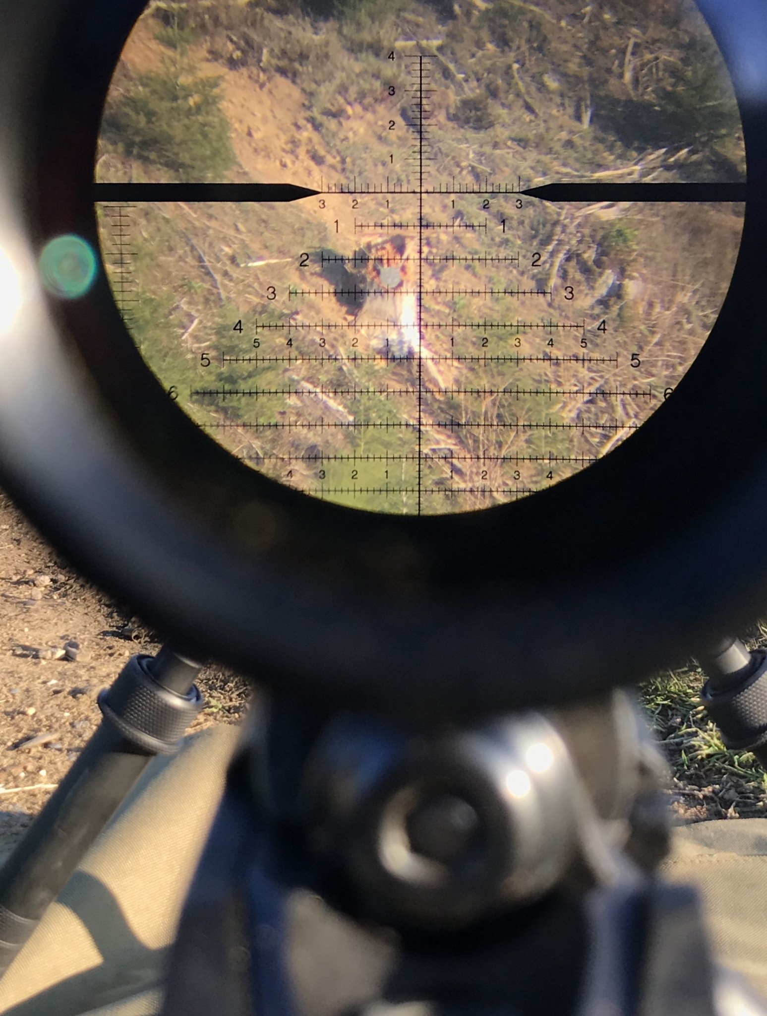

I like a fairly simple tree.
Here is my hold at yards 530 with a good wind for my 260.
here is a view of the newish PR2 tree reticle from leupold. only 3 days old so maybe not a lot of views.
I had to double check my AMG just now to make sure if there was anything above or below the horizontal bar. That's how much I use the tree features.
ETA: Ahh yes, just how I remembered it..

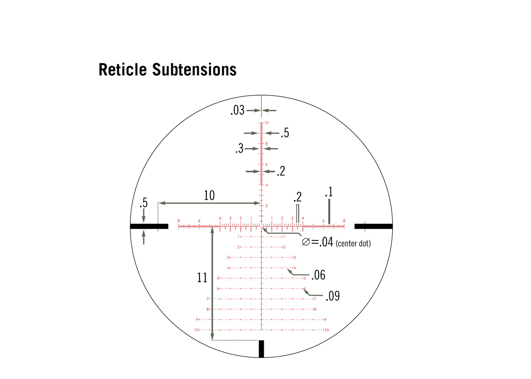

I love them. I use the Vortex EBR-7B, in Mils. I used MOA all my life (a long time) and switched over to Mils about 12 years ago and I will never look back. Mils is base ten ( .1 mil - so it's really easy. Same number to remember with 3 different decimals points (.36,3.6 36). Don't even need those if you start thinking in angles instead of inches.
The "tree" reticles are a godsend. I use mine for a lot of different things, wind, etc. Besides wind they shine when zeroing the rifle or adjusting misses from "splashes" at long range. Zeroing is especially easy. Shoot 3 rounds, center on the three holes, measure from POA and click the turret. One time deal.
Then there's the missed shot "splashes". It makes those pretty easy if they are within the field of view. If the splash is not in the FOV then you can dial down the magnification a bit and send another one. This if you use a scope with front focal plane - an even greater necessity because the measurements on the reticle never change, the tree just gets smaller. Here's the reticle at full magnification:
JAS-SH
Reactions: Holliday
