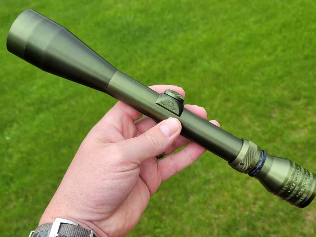

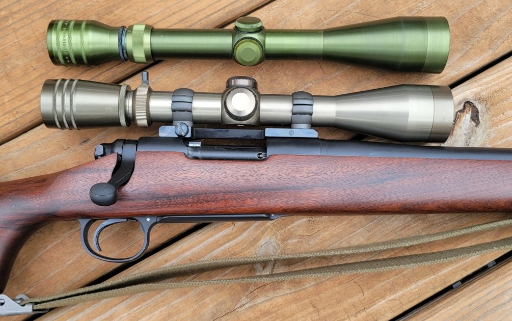

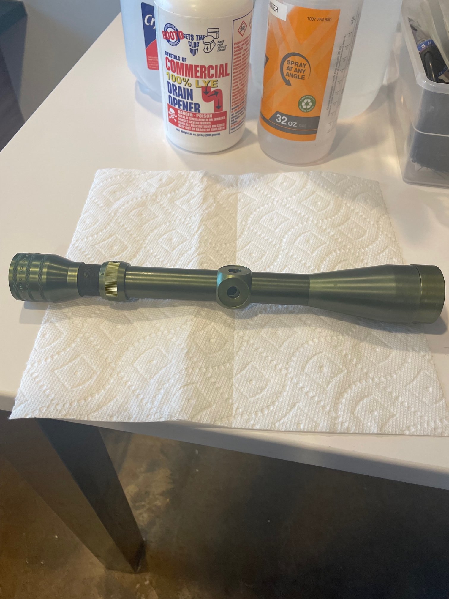

Here is the first one out. One of mine.

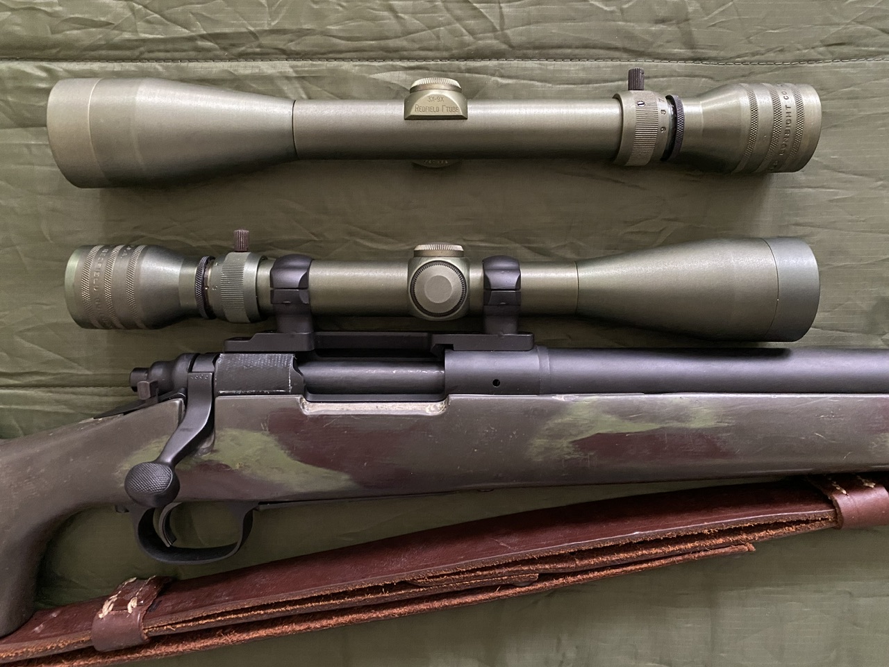

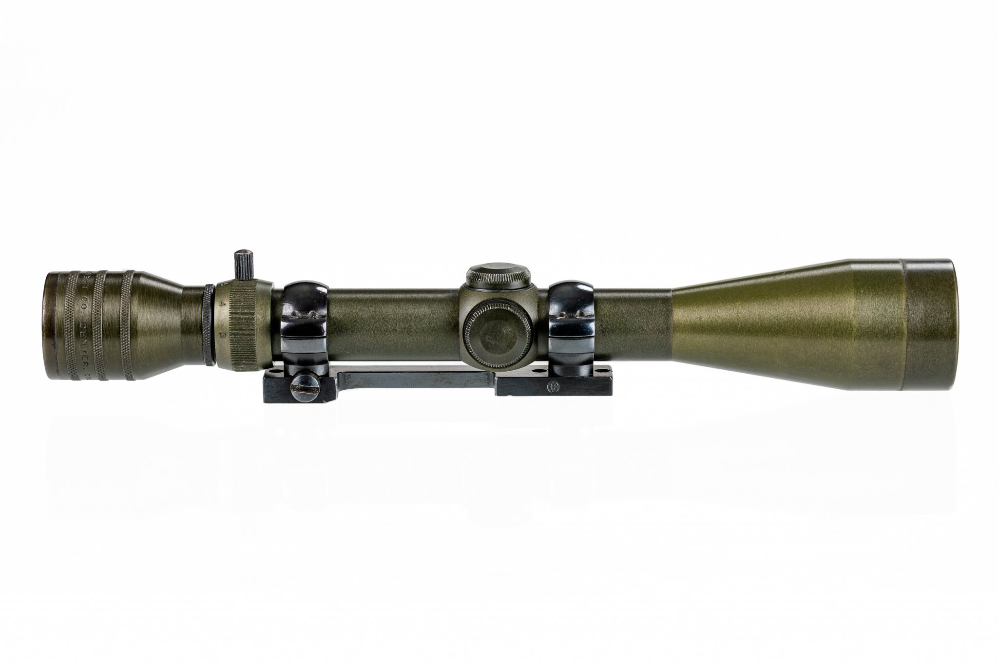

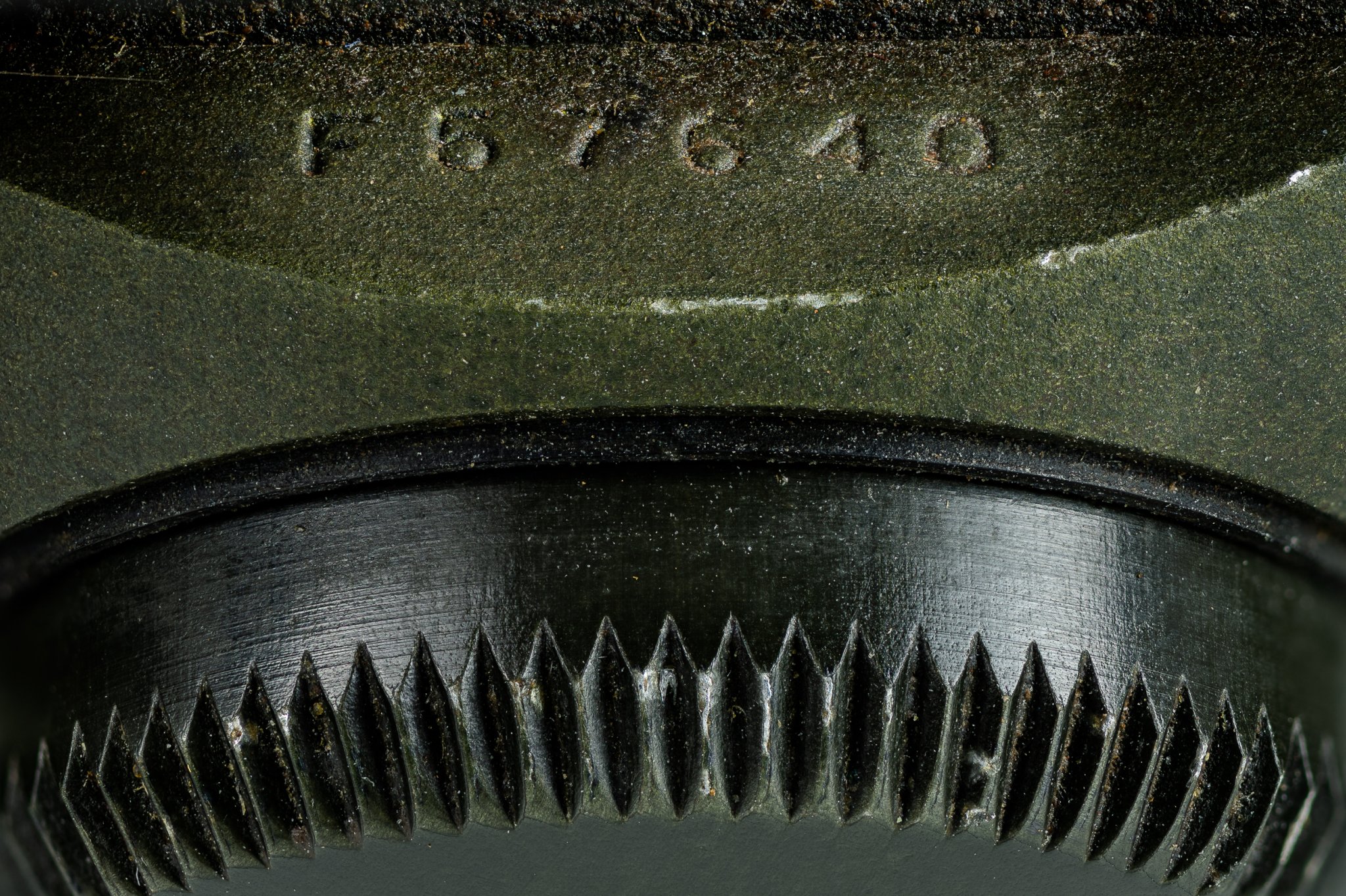

Toki's green is looking pretty good! Just remember to get the gen 1 Redfield scope with the correct external features. Don't worry about having the same tombstone rangefinder or even the correct reticle, no one will see it from the exterior and it will give you more options to find a scope (and hopefully for a better price). If possible, try to find an "F" prefix scope, that is the serial number prefix for the USMC greenies (matte black gen 2 scopes had a "Y" prefix). If you want, you can also weld up the corners on the 700SA base, square them off, and then reblue the base. This will give you a base that's extremely close to the early 40X bases (some later 40X bases had rounded corners) that look really good on the original USMC M40's.

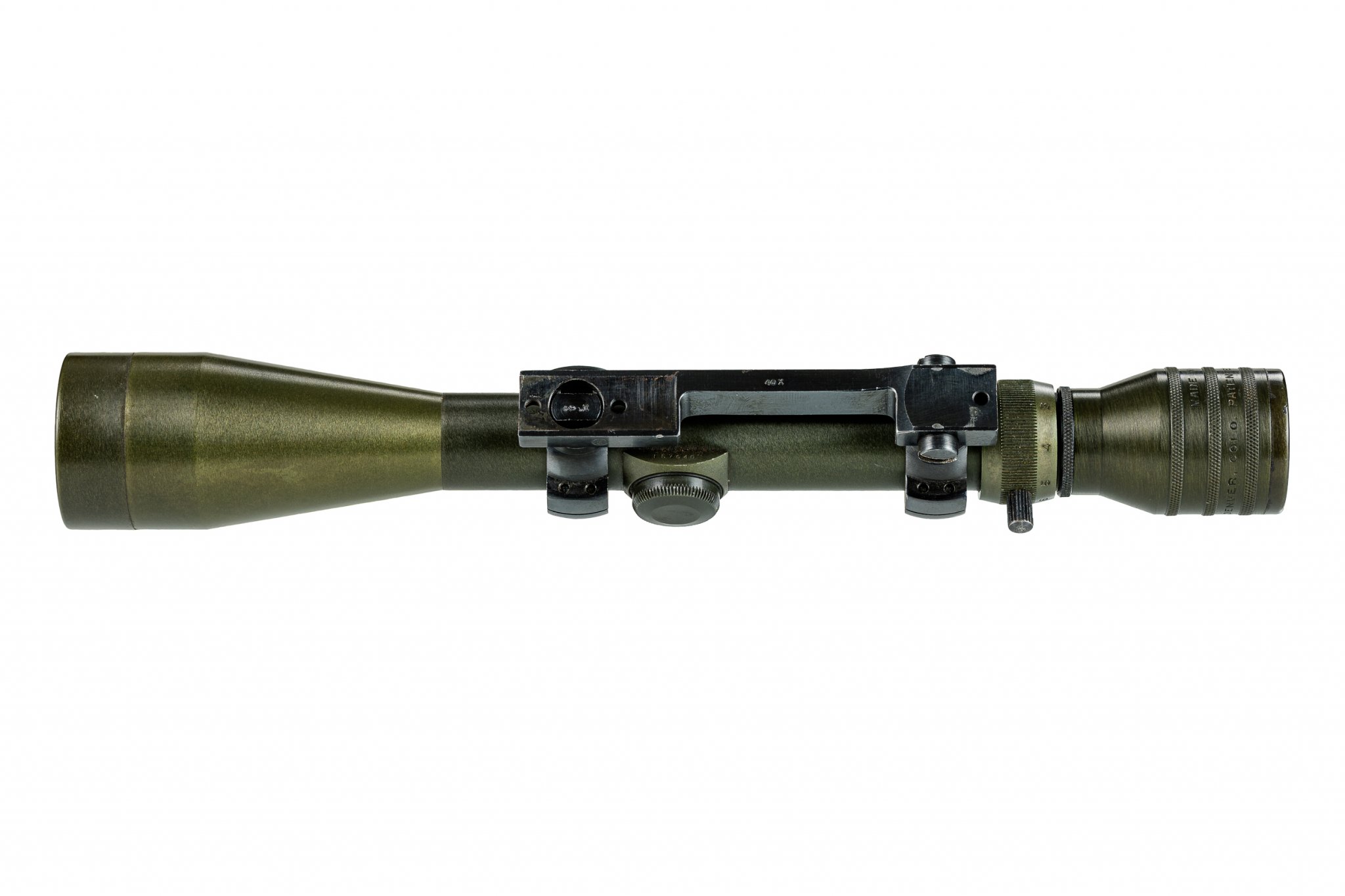

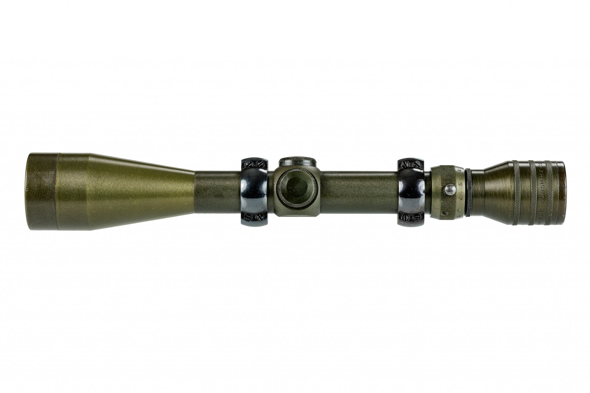

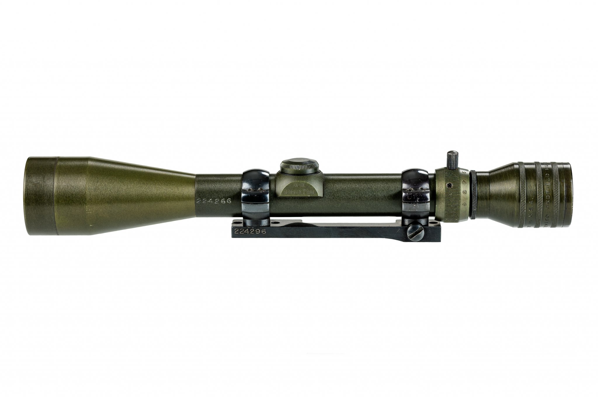

This is actually the scope that's pictured in Chandler's Death From Afar volume 1 on page 164:
*both photos posted with permission from Norm Chandler*
Looking forward to seeing more M40 clones when Toki finishes a bunch of green scopes!

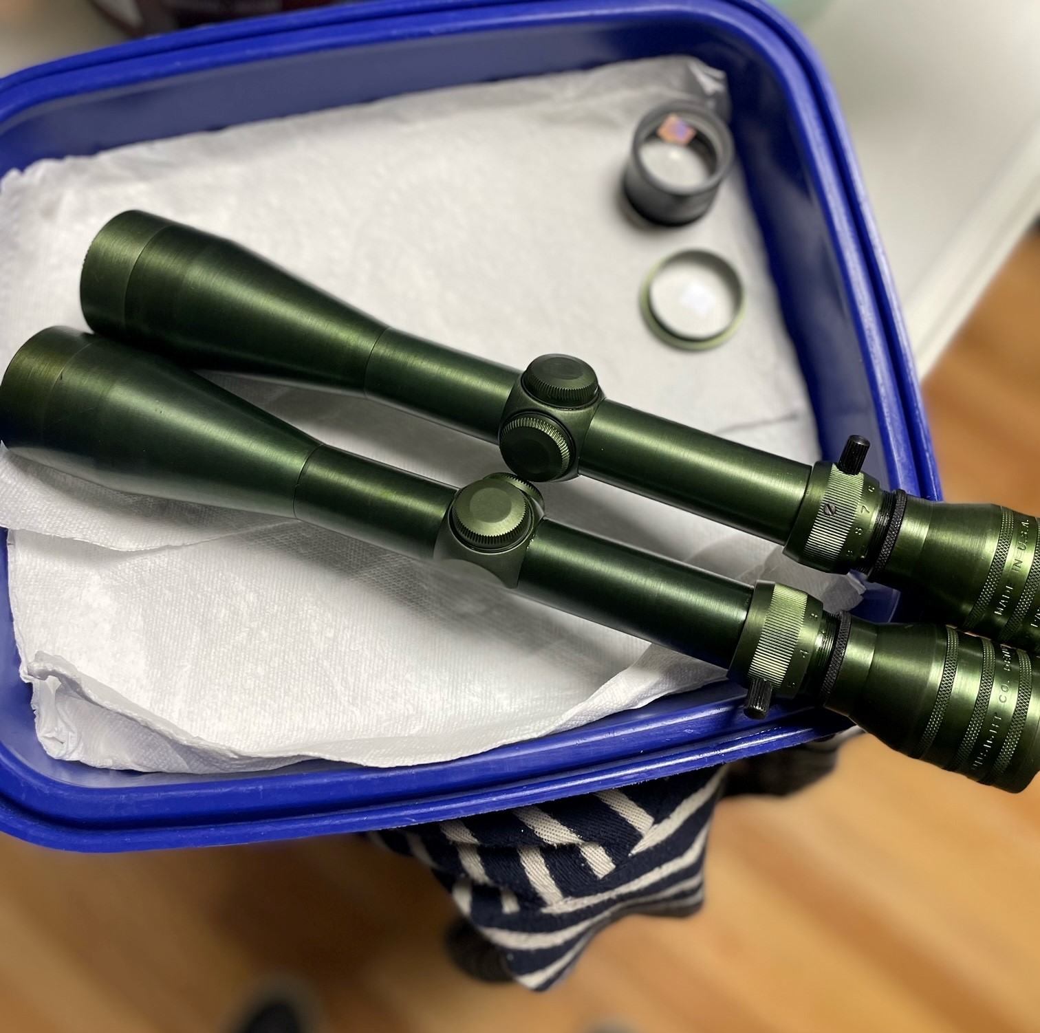

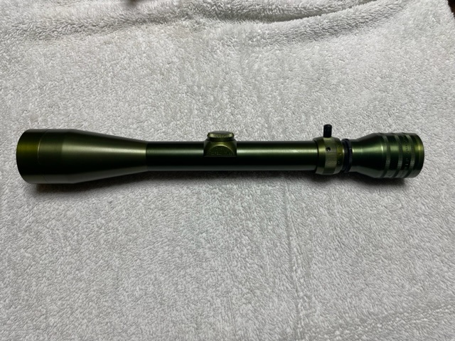

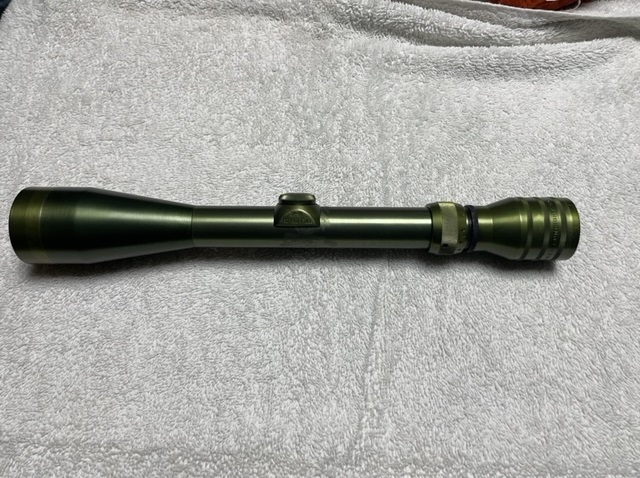

If anyone is interested, I have the two Redfield 3x9 scopes I just anodized for sale. Neither have accurange reticles (standard crosshairs on both)
First one has all the correct external features for an M40 clone. Anodized in US Specialty Olive Drab anodizing dye. Lenses and operation are perfect on this scope. $490 shipped.
Second one is the same early Redfield, anodized in US Specialty Olive Drab dye. This scope is the model that does not have the knurled knob on the magnification ring, but otherwise the same as the first one in feautres. Glass and operation are perfect. $425 shipped
email me at: [email protected]
Both were completely serviced, cleaned, resealed when I put them back together. I don't have the ability to post in the For Sale forum, so hope I don't get in trouble...

Thanks for the closeups. Refining my metal prep a bit to achieve the finish.

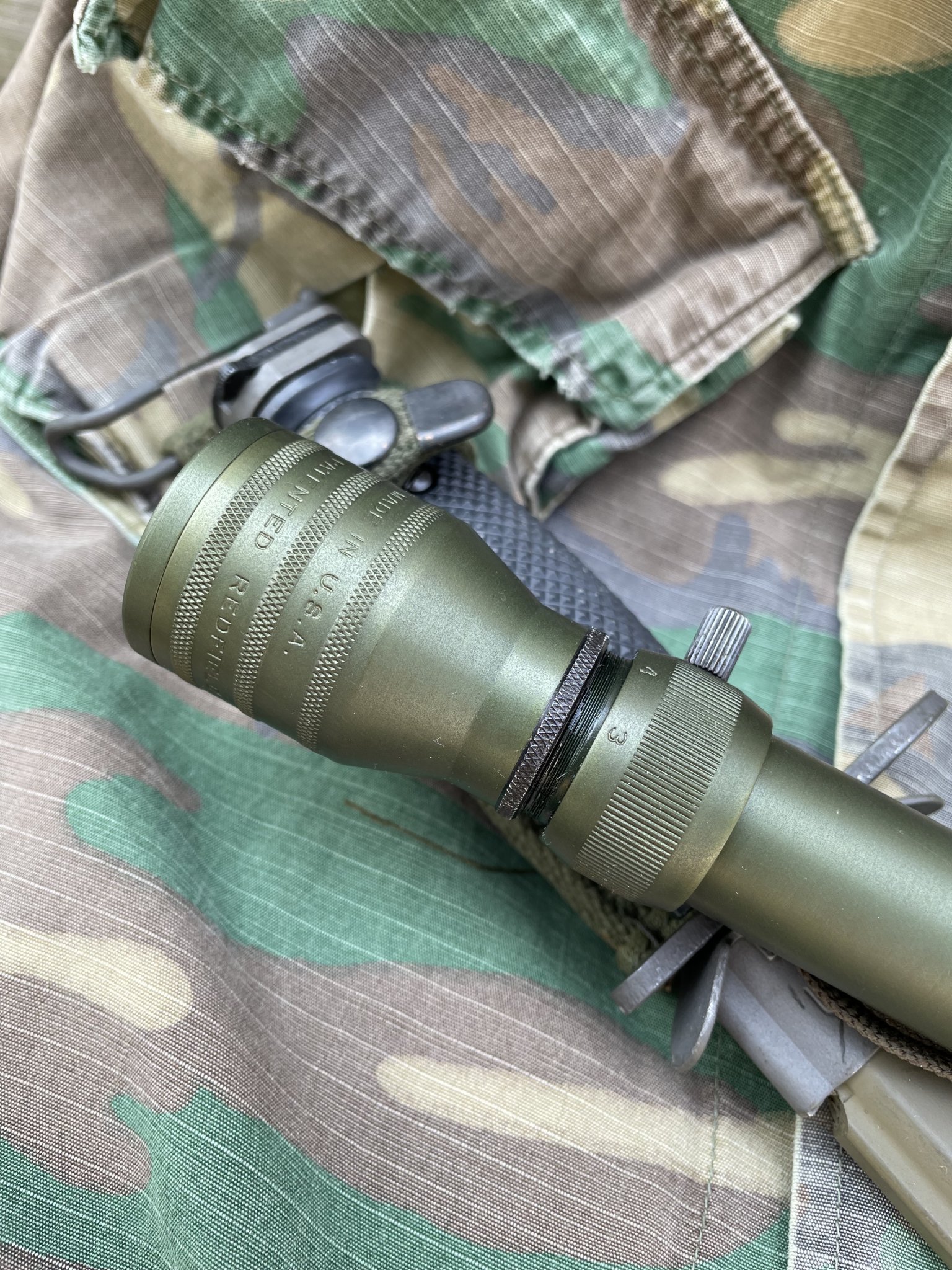

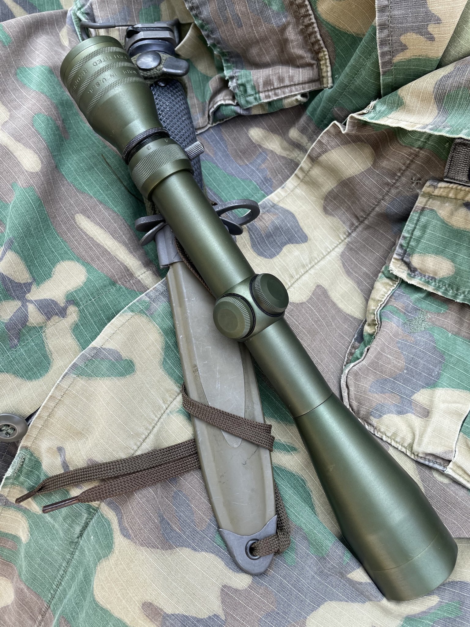

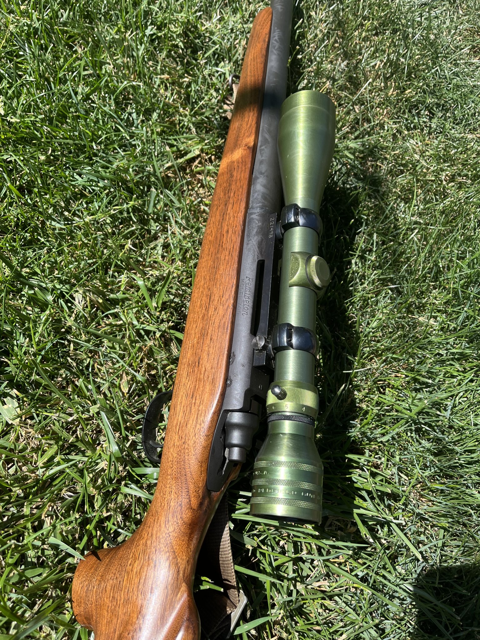

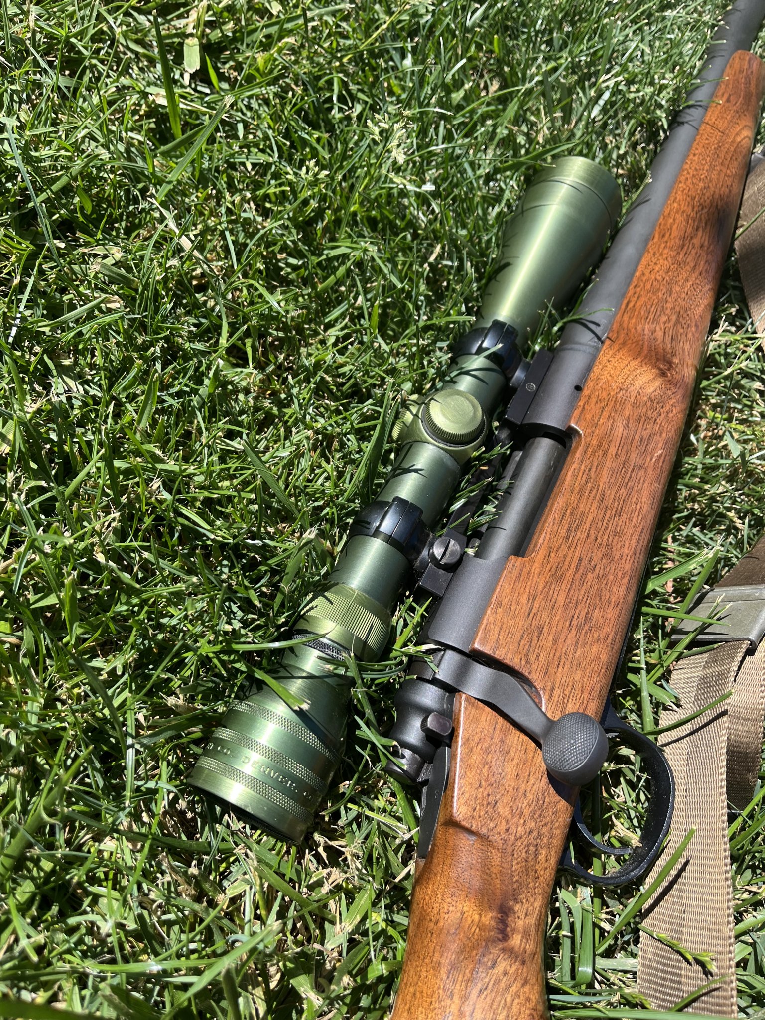

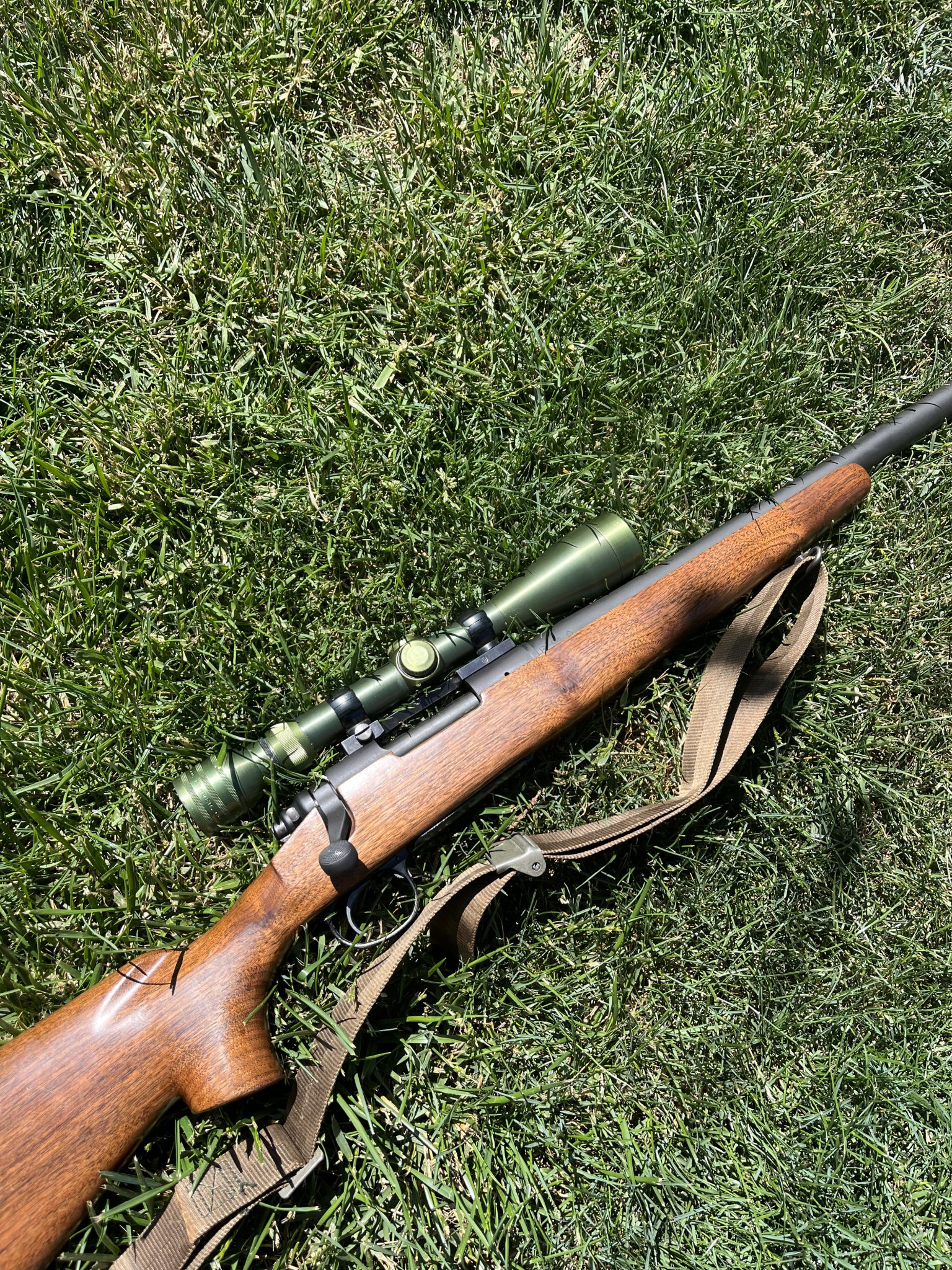

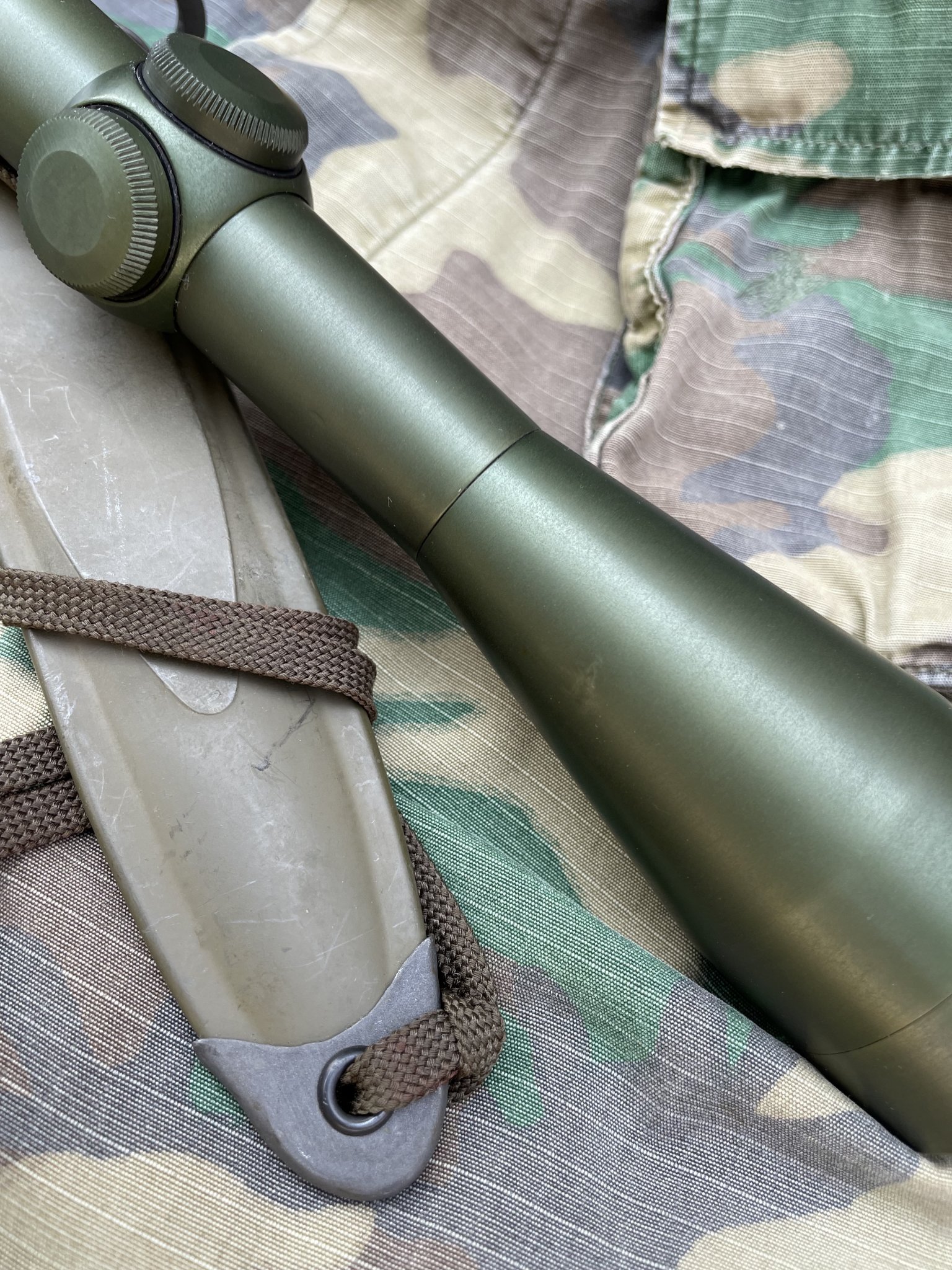

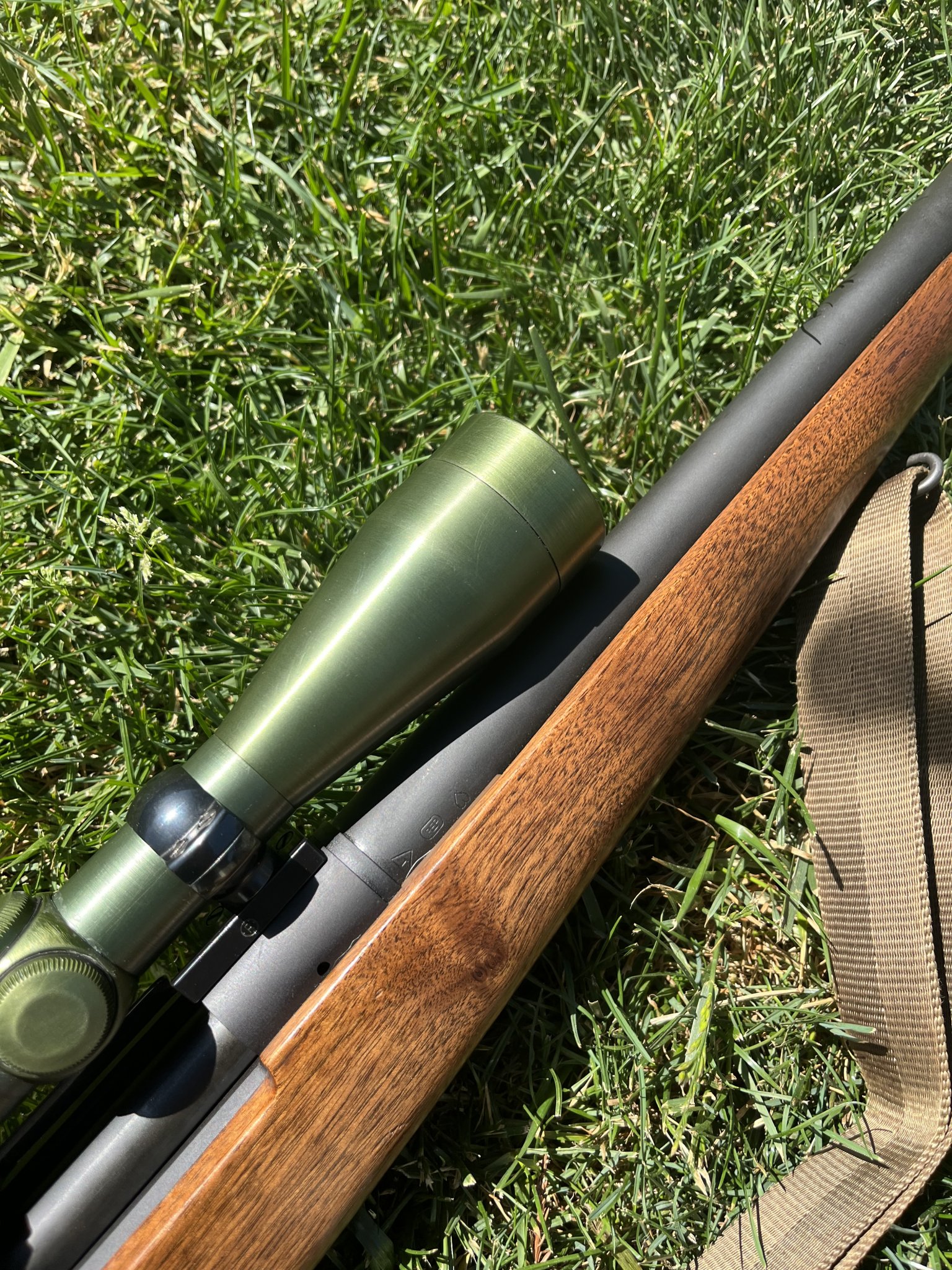

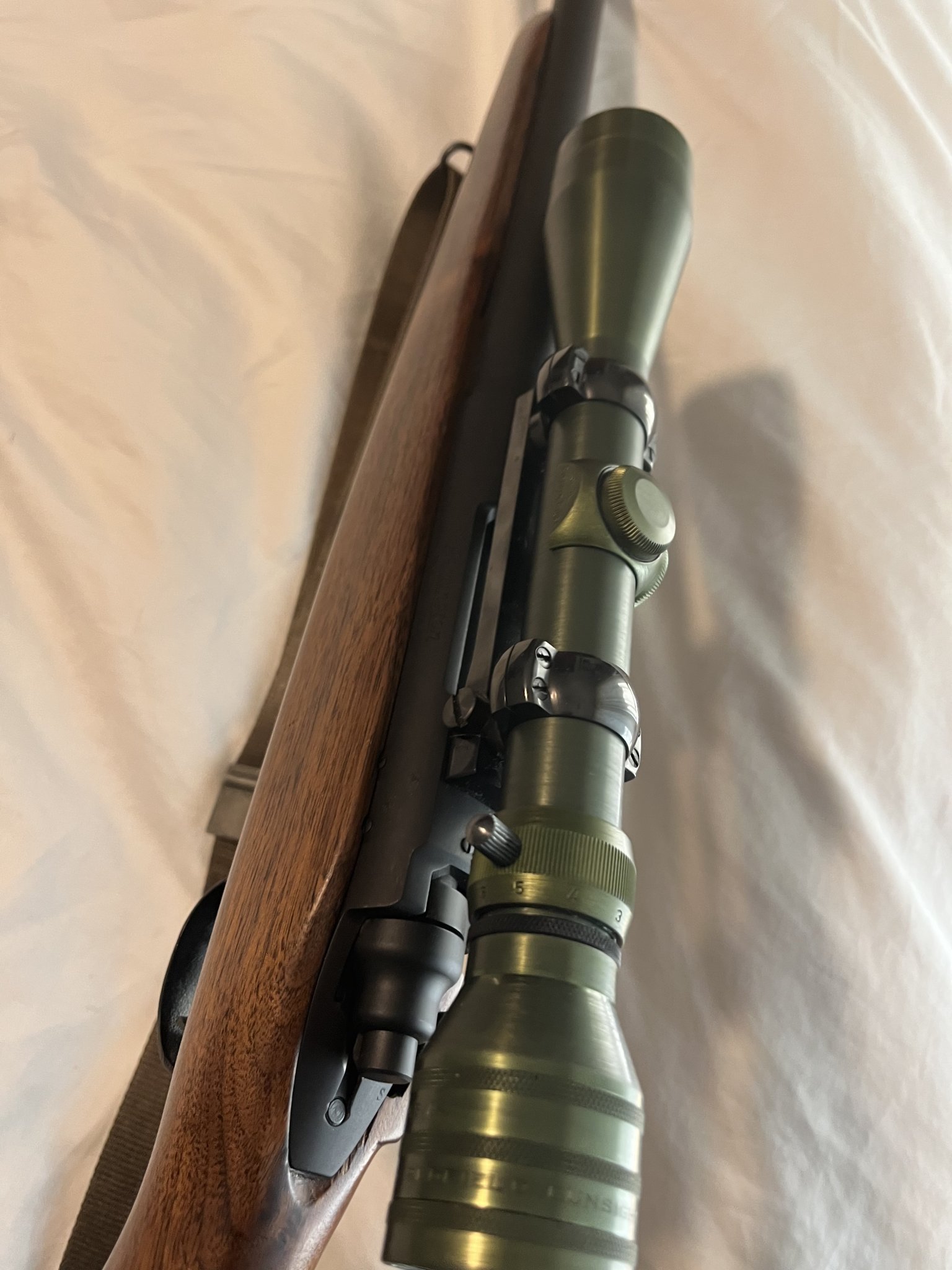

Got my scope back, she's a greenie now, very happy 😃
