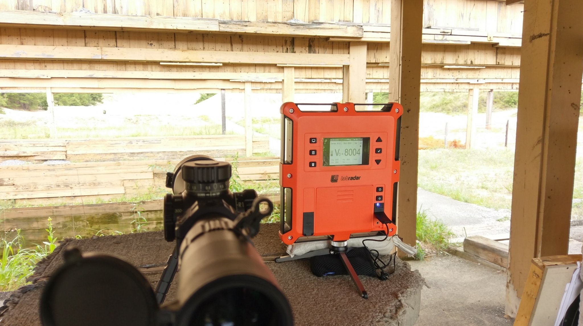

    Guess I wont need 8.2 mils at 1000 with this load.
    What did this pick up at 8004 fps? The down range numbers were normal.

    It's likely due to signal reflection off the sound barriers in front of you. Radar works on reflected signals and my guess is the accoustic signature (V0 trigger) and the reflection noise made it difficult for the radar to determine exact time of shot. The downrange signals will be correct (or at least more so) because they are using actual bullet reflection in the radar field.
    The accoustic echo from the panels would make the sound occur longer/later and time to enter radar field shorter therefore higher MV calculation. The downrange signals are pulse to pulse so they would not be affected as they would be raw data/velocity.
    I don't work for LabRadar but have working knowledge of radar based velocity systems.
    Same thing happened to me once. My LR showed 7004 FPS from a 223 firing 75gr amaxs. The es/sd were laughable. I just deleted the odd shot from the string and moved on. Hasn’t happened since.
    Must be the point I was using that day as it happened twice, first time it gave me a 3711 then later the 8004.
    I have used it many times at this range without issue, usually I move further down away from the crowd but on this day the place was empty.
    I had a round of 77 grain 5.56 show up as over 7900 FPS. There are better responses above but I was told at the time that the expanding gasses from the muzzle brake can interfere with the reading it takes.
    Yes that is true. It can distort the signal and cause it to appear like a velocity spike. Hard to describe without showing raw data but basically it's kind of like the was of a shotgun but if the wad was traveling at Mach 10 and the lead was only Mach 3-4... Easy to notice the difference most of the time and ignore the"wadding" but algorithms can make mistakes too.
