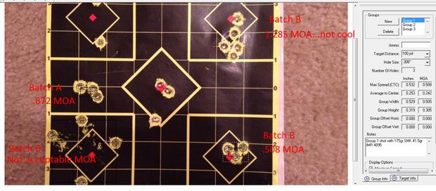

This is what the inconsistency looks like. Batch B had more time and detail put into it than batch A. Could this much inconsistency be from too much neck bump or is it something else? I would like to think that I'm the problem but I had a second shooter experience the same thing. The .242 MOA group and the "not acceptable MOA" group were both shot by the same shooter. The only difference was the ammo batch The other groups were shot by my self.

Your scale is a turd. I would go so far as to say the thrown charges from the dillon are likely more consistant than individually weighing charges on the nickel-bag dealers scale.

Could be 1 could be both, without an accurate idea of how much you are really bumping the shoulder there's no way to answer that. Grab up a set of Hornady headspace gauges for your calipers and then redo the experiment with a solid number for how far you're bumping the shoulder. Then re-run the test with only 1 variable at a time. IE. bump the shoulders and use the same throw from the powder measure, then bump the shoulder and weigh every load, and run each of these test loads against your original batch A and see where exactly your deviations are coming from. It's the only way to answer your question accurately.

.004 should not effect your accuracy much if at all unless something is misaligned in your press/die setup, I normally only bump about .002-.003 but .004 is definitely not excessive.

A .004" bump shouldn't hurt anything at all. I agree that there's something else going on with the ammo. That something could be too much runout or a myriad of other things. I highly doubt it has anything to do with how much you bumped the shoulder.
Stop shooting 3 round groups.
Full stop, period, end of story.
You have to provide yourself with meaningful data so that you can make meaningful conclusions. I know, it's nice to see that 3-round group touching - but the longer you don't accept the fact that it's just a coincidence, the longer you will hold yourself from becoming a better shooter.
Shoot some 5-10 round groups, make a small change shoot some more - see if the groups change. Don't get caught-up in "waste of time" or "waste of ammo" BS - trigger time is never waste of time as long as you pay attention to your fundamentals.
Right now you have a 2MOA gun/ammo/shooter combination. Work from there.
P.S. At 100 yards you'll be surprised how little powder charge matters....

IF you have enough loaded rounds run groups of at a bare minimum 5 rounds, 10 if you have enough, to really test the loads to see for sure if the previous results were anomalies or if it was actually the deviations you saw with 3 round groups.
