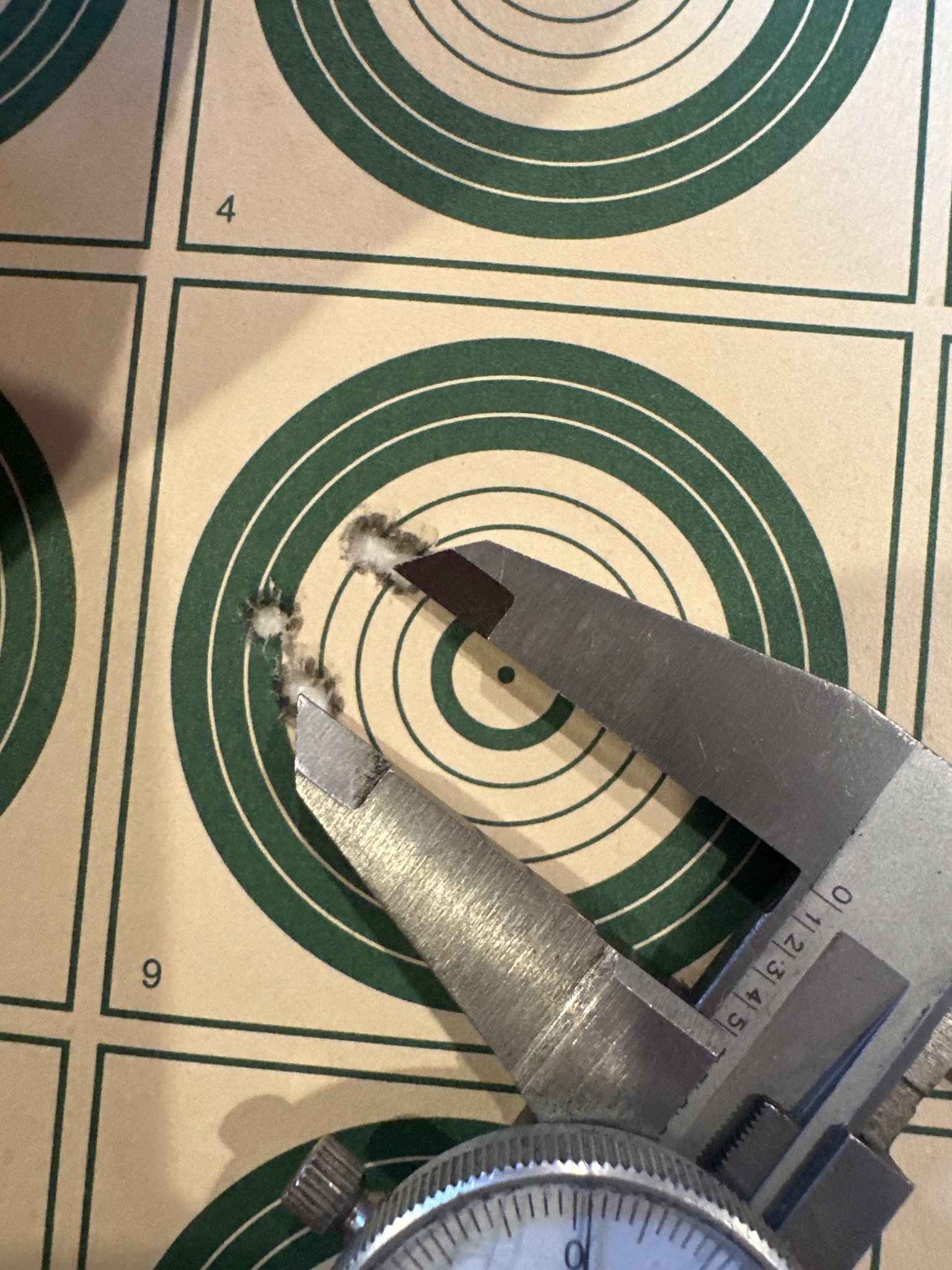

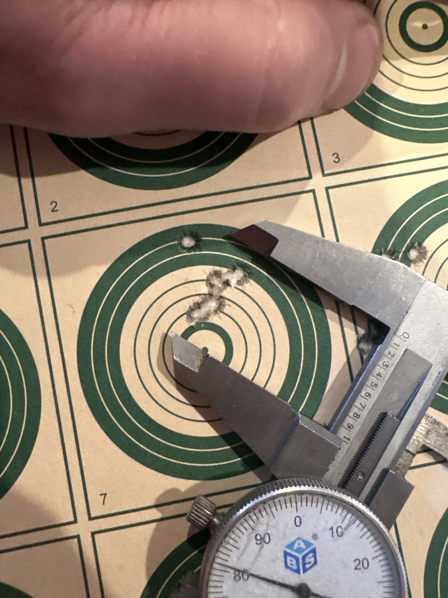

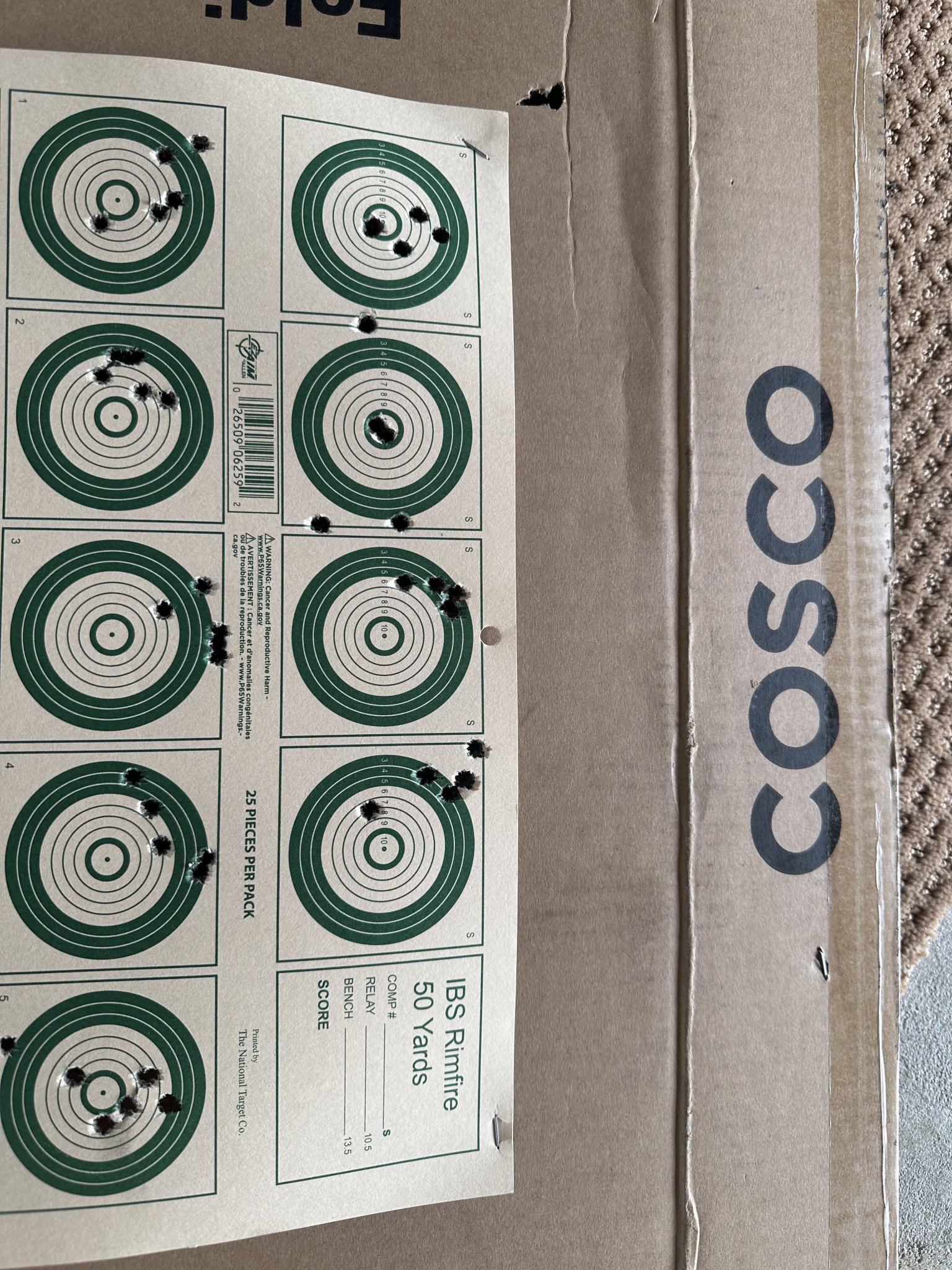

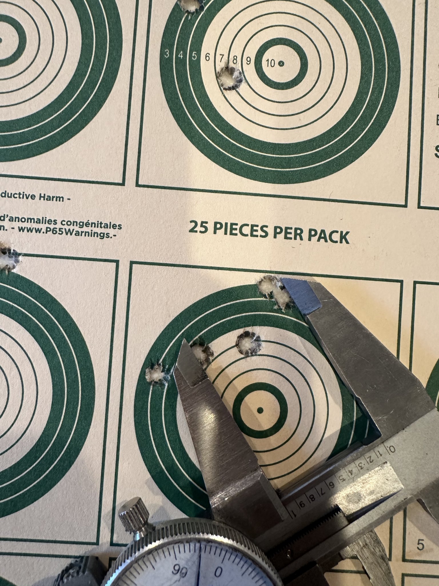

    My 20" Proof carbon 6ARC barrel shoots great. My buddy has the same barrel bought 6 months later and it shoots identical to mine. Both were purchased in 2022.
    I’ve had a bunch of Proof barrels and every one has shot great. That is not the point of this post, I want something else.

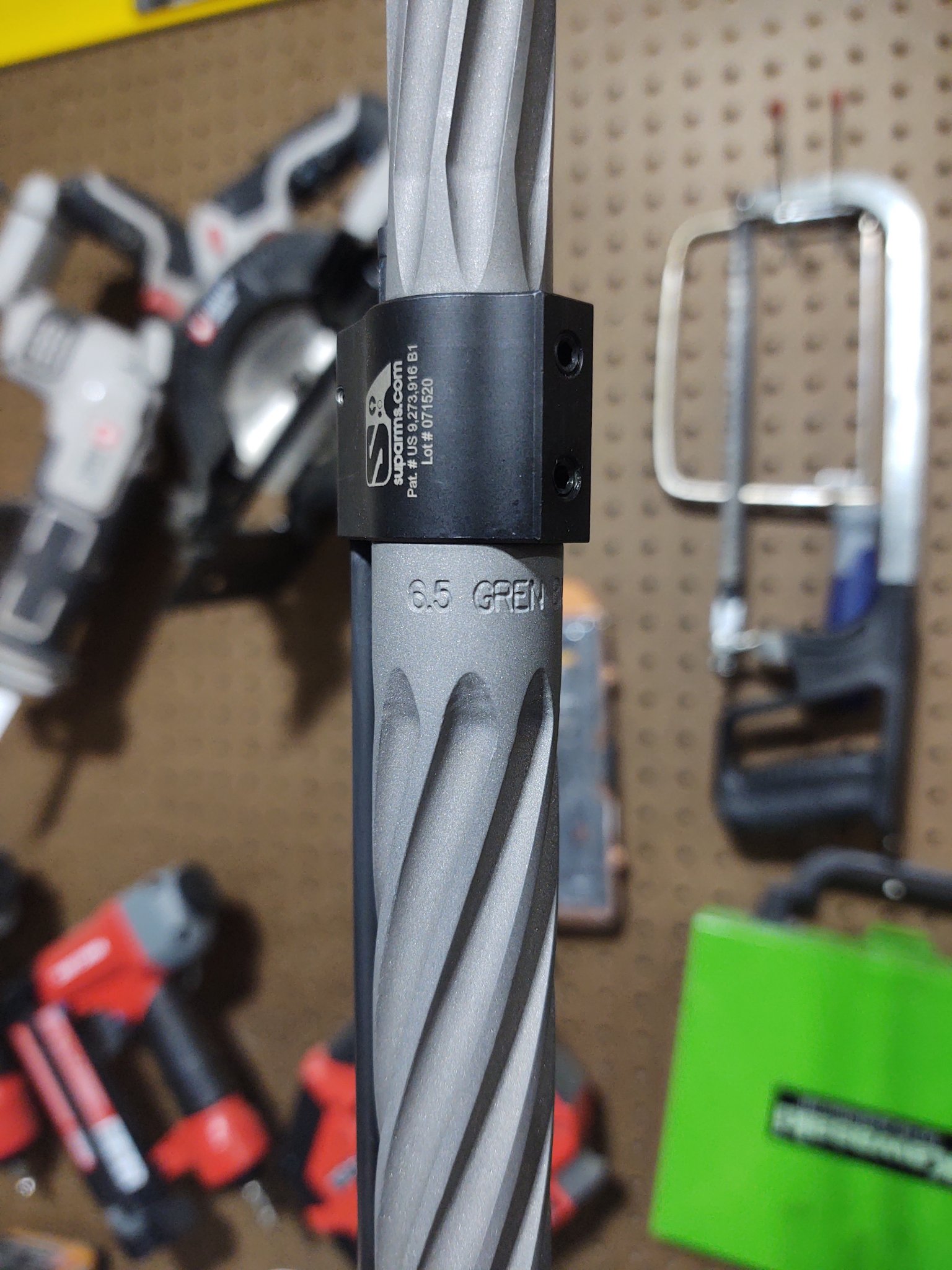

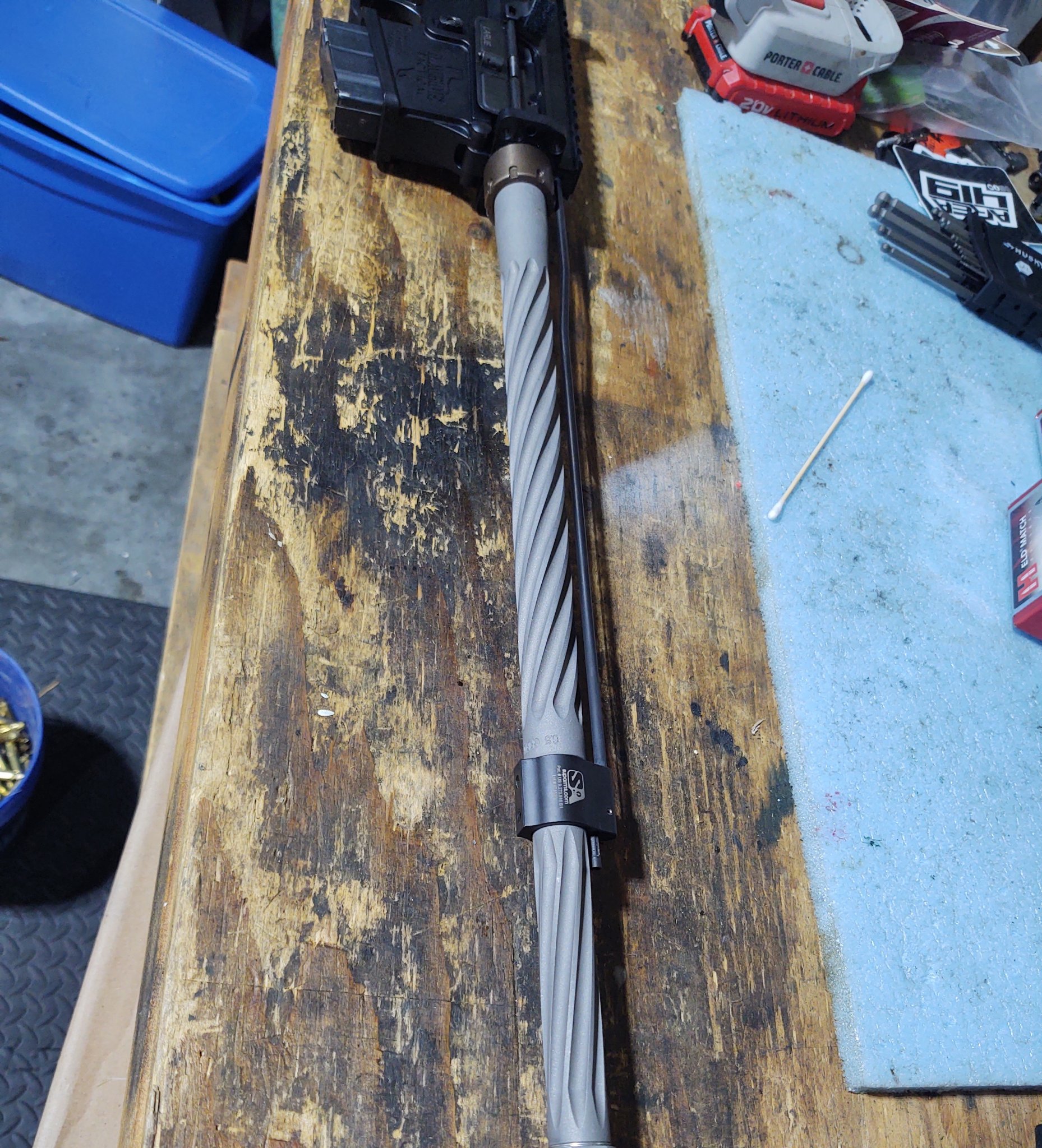

    As for your reasons for choosing a Rifle +1 gas system, you're assumption is incorrect the a SA AGB will fit under the handguard just fine.

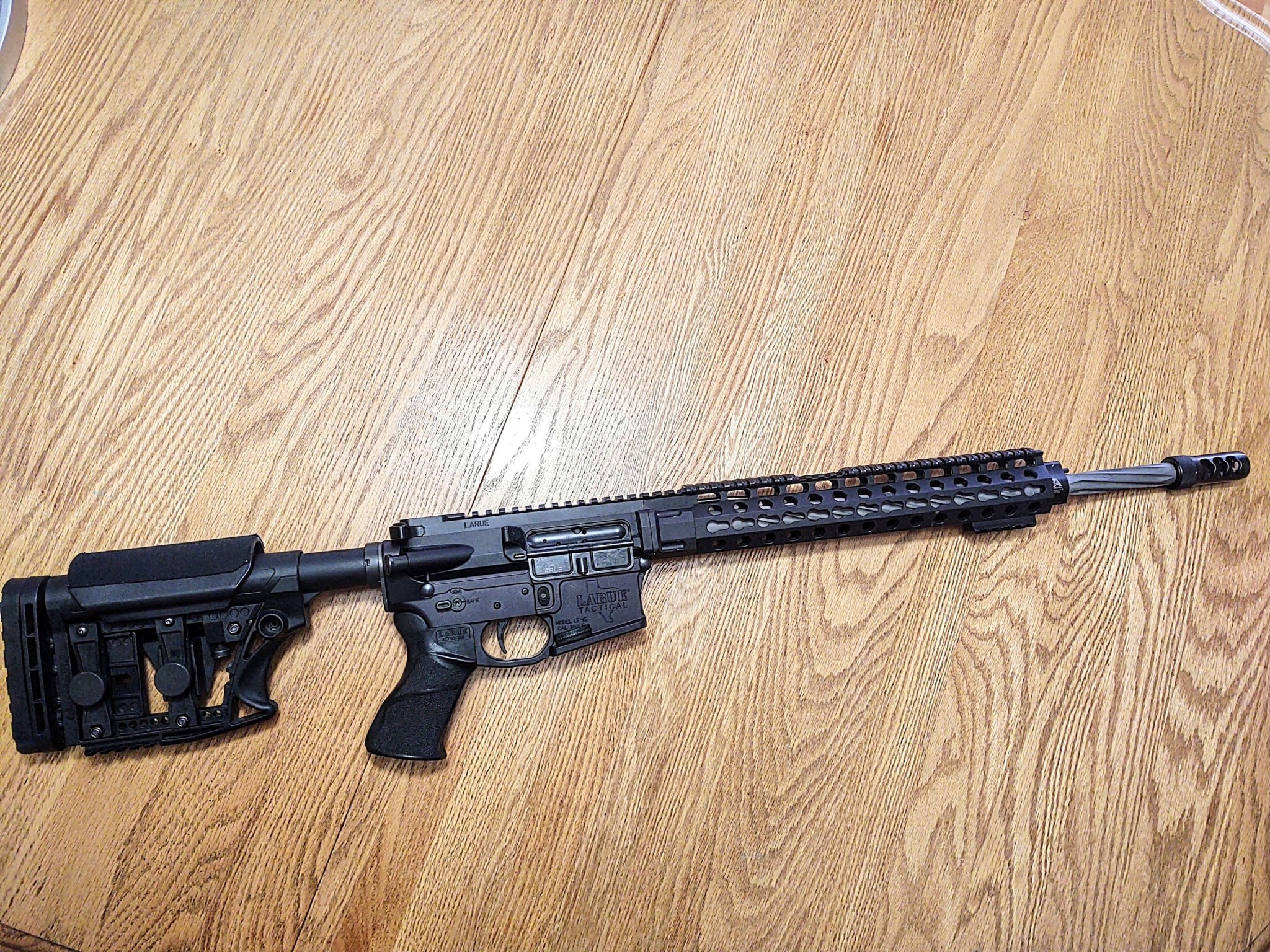

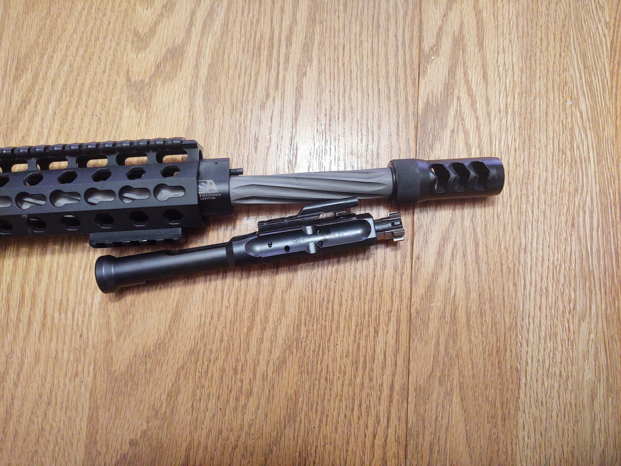

    This is a 18" Bartlein 6.5G with a .750 gas block with Rifle Length Gas from Craddock.

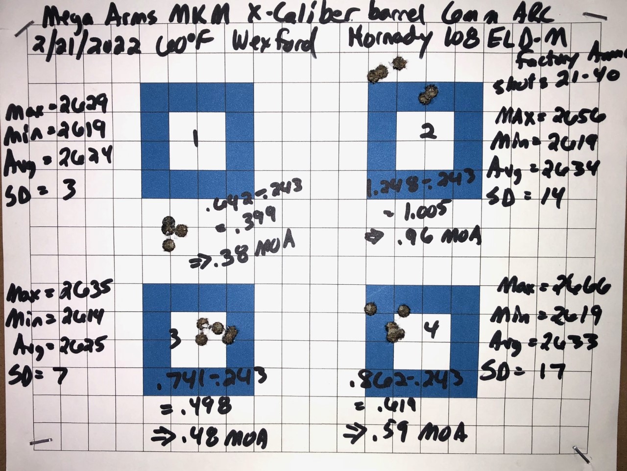

    I'd add X-Caliber to the options you might want to consider. Significantly better than BA, Faxon, etc. but not near the cost or lead time as Craddock or CLE. Mine has been sub moa for two factory Hornady loads. Are you capable of shooting the difference between a Craddock, CLE and X-Caliber? X-Caliber routinely posts sales on major holidays, so expect one for roughly 20 or 30 percent off on Black friday. I'm totally pleased with my X-Caliber barrel. They delivered mine quicker than their advertised lead time as well.
    I'll add another vote for X-Caliber, I've had a trio of barrels from them so far, and the quality of the work on every single one has been excellent. The carbon wrapped 6.5 Creedmoor Ruger Precision barrel I got off them is shooting bugholes with hand loads from a lead sled off a concrete bench. had to go out a fair distance to get a reading on actual group, it was 1/5 MoA
    Heard a lot of great stuff about x-caliber. Bought a carbon wrapped barrel from them from their recent sale.
    Some guys in the 6 ARC facebook group that have put many thousands of rounds downrange recommended x-caliber as well.

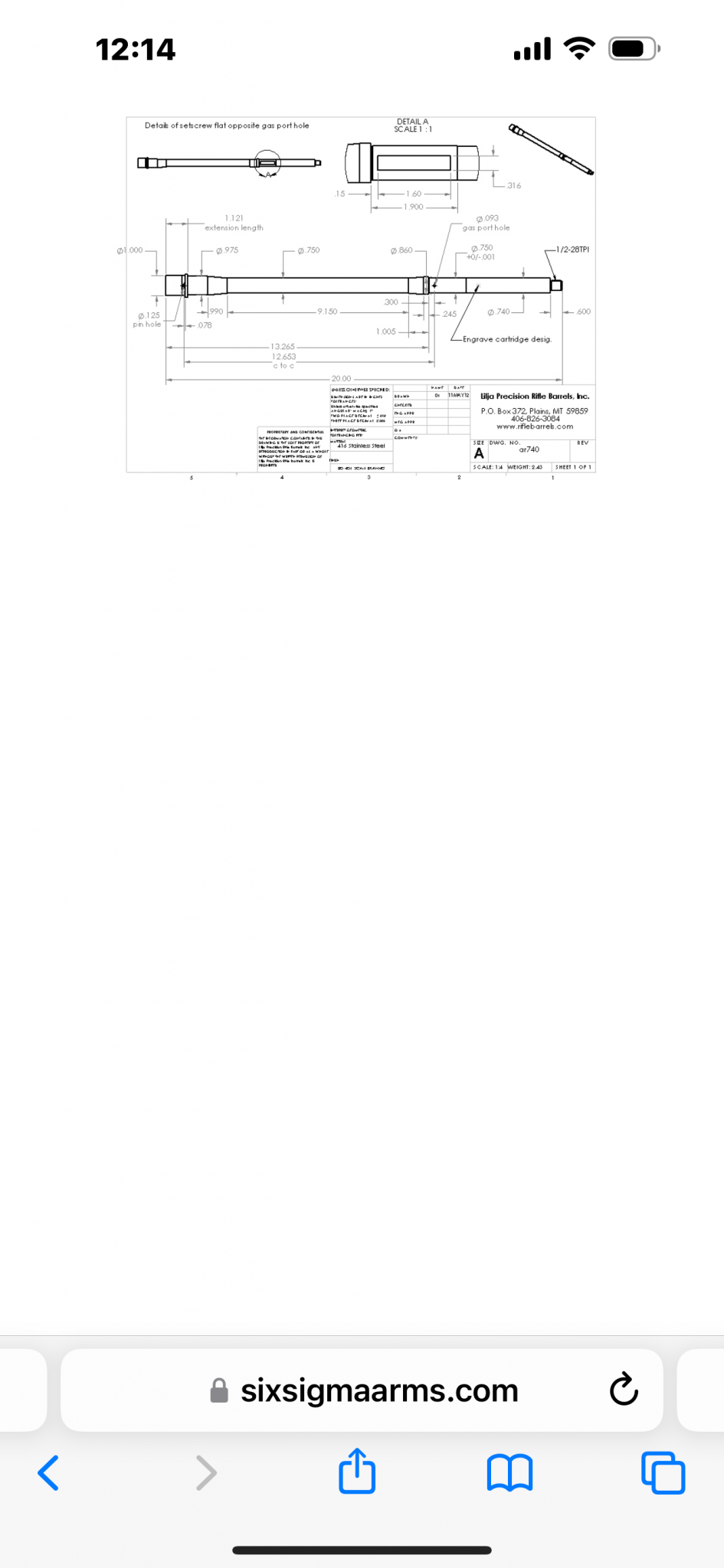

    They list multiple different barrel lengths, and also profiles.. it just seems like there are gas block, lengths seem kind of short, but then again, I’ve never looked at the schematics of a AR barrel…. I’m not sure where they take the measurement.?? is it from the end of the extension to the gas port or is it the barrel not including the barrel extension to the gas port??

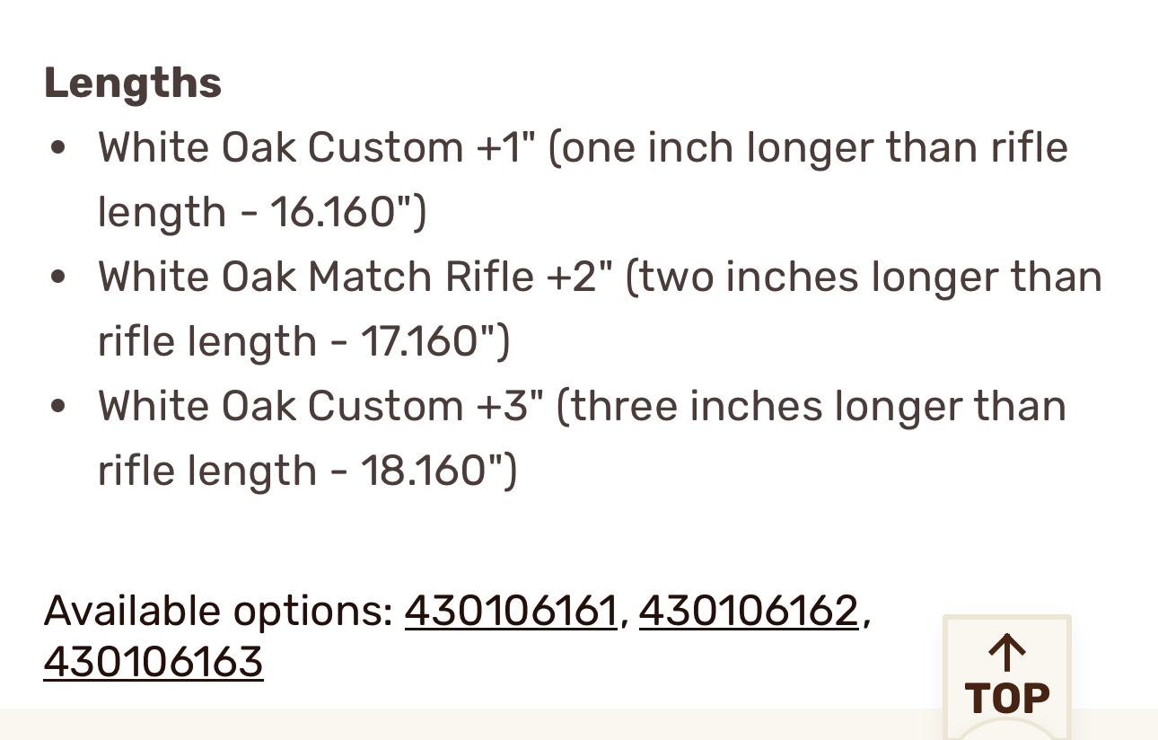

    Obviously something I didn’t know is plus one is literally a rifle length +1 inch and that gives you the gas to length of a +1…or 16.1inch approx..

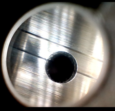

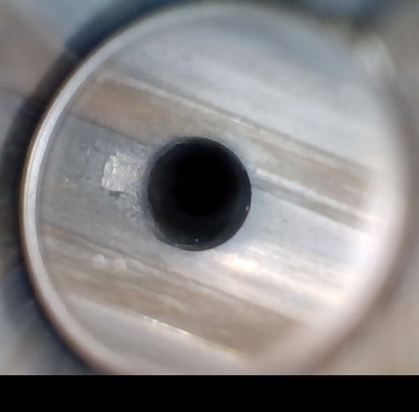

    Well, I received my barrel from (will not say) and it looks like the chambering job ???? The lands start from mid and one side … and the other lands start from right off the chamber. Would that not force a bullet wonky? From the brass ?The crown doesn’t look smooth as it has cracks off the lands on exit…I would think that matters? The gas tube although looked pretty good, actually really good how they got in there and cleaned it up It’s got a burr on the exit as the bullets leaving, and I have that on proof barrel, and it never went away. end up grabbing bullets. The Craddock gas hole looked very similar to my proof (burr ) and that looks to be still there (on my proof barrel)and ended up doing is peeling the burr over into the lands. It looks like I’ve got a lot of copper jacket material where the burr peeled over remaining not saying that it’ll happen on this one but I think I’m sending this one back.
    shit happens so I’m by no means slashing these guys I’ll send them an email or talk to them. I’m sure they’re gonna take care of it so I’m sure I’ll be good. These guys are solid as it comes so please don’t let this you change your mind .
    I had just gotten my borescope and a couple of barrels …had to go through the new one as I didn’t want to put any rounds through it and deal with any sort of return issues after

    Yeah that’s why I deleted all the pictures this is the only the second barrel I looked at. Easier to see the variances with a brand new cut barrel then one that hasn’t been put a few down the tube.
    I’m really interested to see what my Shilen 17 rem ar 15 barrel looks like and my Rainer 223 barrel….. it’ll be interesting to compare
    My proof barrel looks like it’s got a lot of carbon @ the junction of case neck and head. I’m working on getting that out, and I’ll test it with regard to if it makes it shoot any better if it doesn’t then it’s possible that there’s something else going on with it…. I may just give proof a call that’s probably the easiest way.

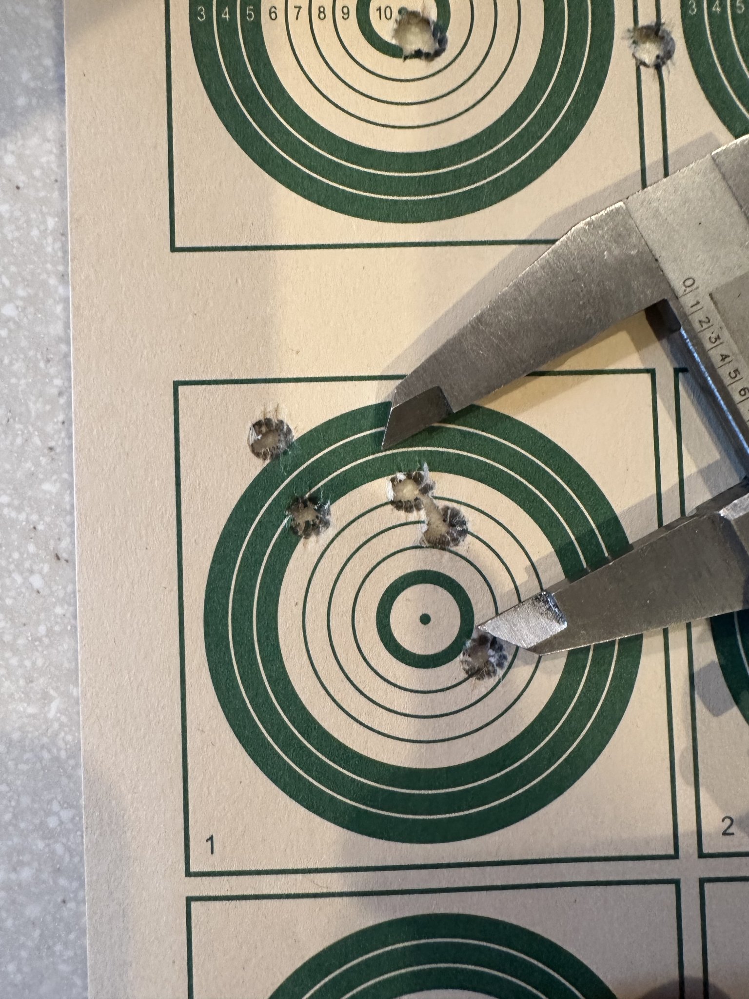

    Picked up a 16” Proof. Rifle length gas, runs with an H1 buffer.

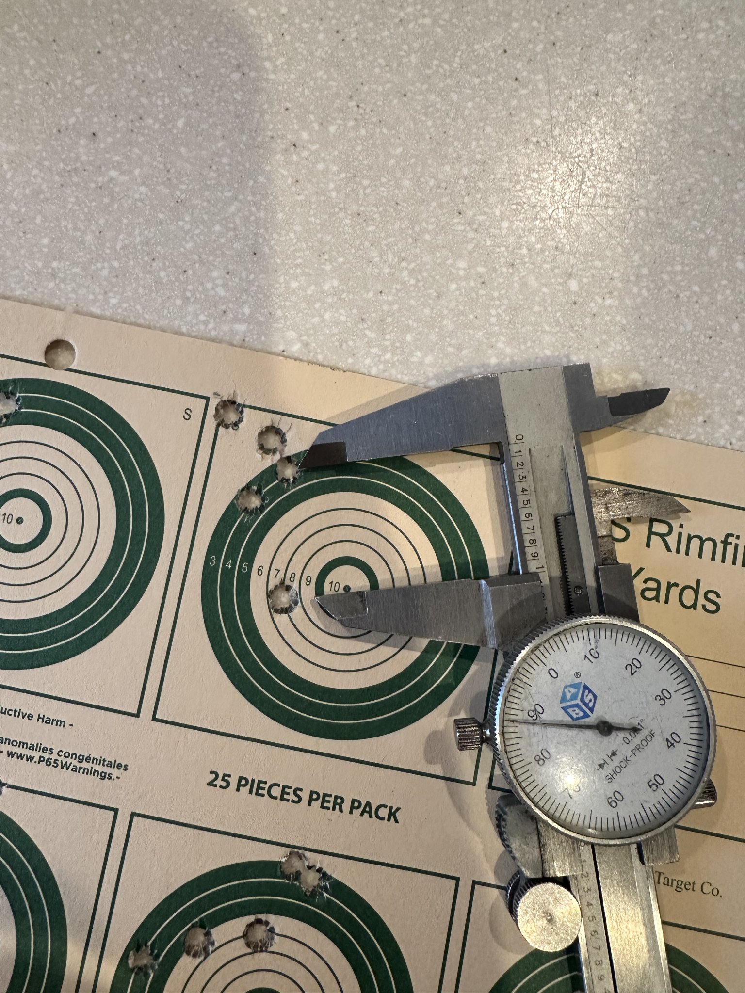

    Haven’t shot a lot of groups, but very pleased so far. Shot 3 five round groups, two of them were in the .6-.7 moa range, the other was .9 with factory 108 ELD-M.

    so what’s your opinion about the overall cut of the barrel? have you looked down your barrel on a brand new one and does it have the same marks ? It seems like chatter but then again these are small little chatter, but it’s still chatter..
    My proof barrel seem like it also would get brass buildup in the same area as the craddock did. I don’t know what a good gas block is supposed to look like because it seems like all of them end up with a burr that folds over towards the tip or the outgoing of the berral.
    It gets real fuzzy like I can’t tell if the but burns out or if it folds over and never goes away.
    The smooth barrel, which are the first I think three or four pictures have no chatter at all but then again I think Schilen riflings are not formed the same way.( I just don’t wanna look it up right now)

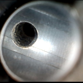

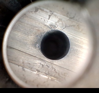

    My proof has port that looks like that as well and after a few rounds down the tube the burr causes all kinds of accuracy issues. I guess the same with this one will happen if it is bouncing off the thing
    I have a 6.5G proof barrel with 2k rounds through it. The port looks like a tear drop. It doesn't accumulate copper though. All ports are going to erode. Starting off with what looks like a chamfer isn't going to help.
    Here are a couple of gas port pictures to give you a sense of what is common. I don't have a 6ARC so these are different calibers.
    Proof 6.5G, roughly 2k rounds, uncleaned. The erosion is filled with carbon. This barrel shoots, does not drift or string:
    WOA Wilson 223Rem. 2.5k rounds, uncleaned:
    Brand New Faxxon 5.56. Notice the tooling marks, they run the entire barrel.
    Even the Faxxon port is round and unchamfered.
    Reading this thread had me thinking about the Craddock 22 Arc RTR barrel I just bought. I've been shooting it for the last two weeks. Shot it at a match yesterday. Initially I got really good accuracy and then tried a couple other powders and did not get very good accuracy. It shot my old 22 Grendel load really well. I loaded that stuff up again. Same powder charge. Same bullet. Same seating depth, same brass, same neck tension and it was okay but not the same accuracy for some reason. Kind of scratched my head on that one. I cleaned it after the match last night and loaded up the 8208 load that it liked and was planning on taking it out to the range today to see how it was shooting because I kind of felt like it opened up at the match. It's got somewhere between 250 and 300 rounds on it at this point. I just went downstairs and looked at the gas port with a Hawkeye borescope and man, it is ugly. Huge erosion triangle It looks like to me. With a black oozing sludge pouring out of the gas port in the direction of the muzzle. The bore looks good enough to me and after three passes with a couple of wet patches of bortech eliminator and dry patches it looks pretty clean. But that gas port, woof. Now I'm thinking about just buying a shilen or a McGowan blank and having my gunsmith build me a 22 arc barrel.

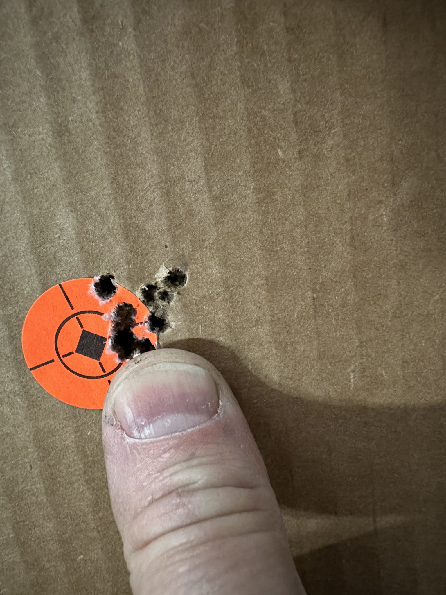

    I built up a light 6 ARC with an 18" Proof. Works great shoots good. Typically ~3/4" or slightly better 5 shot groups at 100 with Hornady Match. I have not fed it handloads yet but expect to shrink groups a tenth or two when I get to it.
    I also built up a 6 ARC with a 22" Shaw. Many groups in the half inch range and the best under 0.4 with Berger 109s.
    Reactions: Shoreglide
    Well, whether or not, it was the internal of the barrel lands or the gas port damaging the bullets on the way out. I just couldn’t get any good groups.
    These are all hand loads with lever and up to the max amounts with no pressure signs barely shot 1 moa. All top grade parts and scopes that typically shoot very accurate.

    This is shot with my bolt action 22 Creedmoor
    I didn’t even have the nice high-power scope on this to really get down to fine groups.
