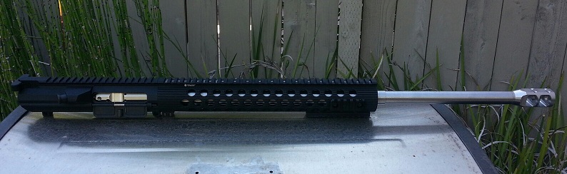

Here is the hand tight version: (also selling the troy 13.8" 308 TRX forearm as the gas block touches the rail brackets. Going for a 15" PRI CF forearm instead)
