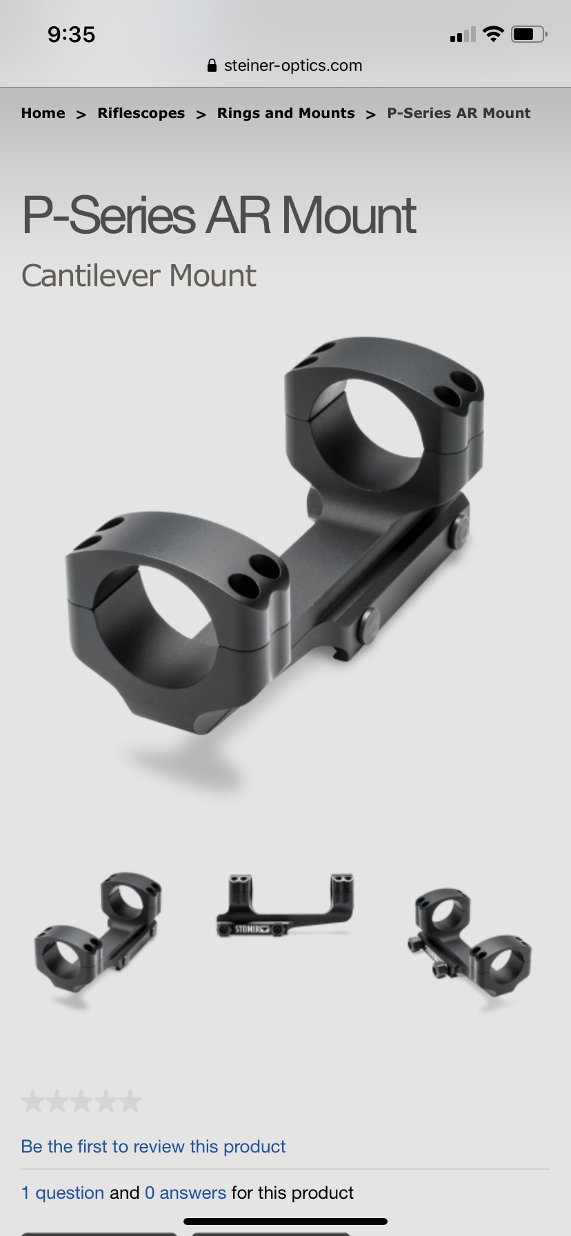

T Tikka_taca1 Sergeant of the Hide Full Member Minuteman Dec 18, 2019 156 38 Dec 25, 2019 #1 Dec 25, 2019 #1 I have the Steiner mount that come with my optic, but their are no torque specs for it, any one have any guess on how tight I should tighten the cross bolt and cap screws ? Attachments C6345E5B-7912-4DFB-B897-EC4705562309.png 1.2 MB · Views: 23

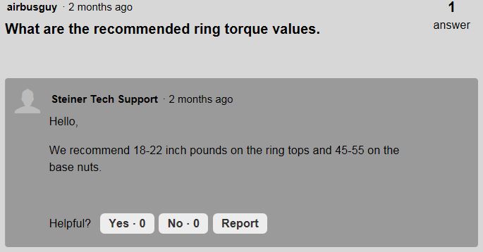

J JGR1953 WTF....over Full Member Minuteman Nov 24, 2017 453 309 Dec 25, 2019 #3 Dec 25, 2019 #3 Reactions: SonicBurlap, Average guy and Deleted member 10043

T Tikka_taca1 Sergeant of the Hide Full Member Minuteman Dec 18, 2019 156 38 Dec 25, 2019 #5 Dec 25, 2019 #5 JGR1953 said: View attachment 7209242 Click to expand... Awesome thanks
