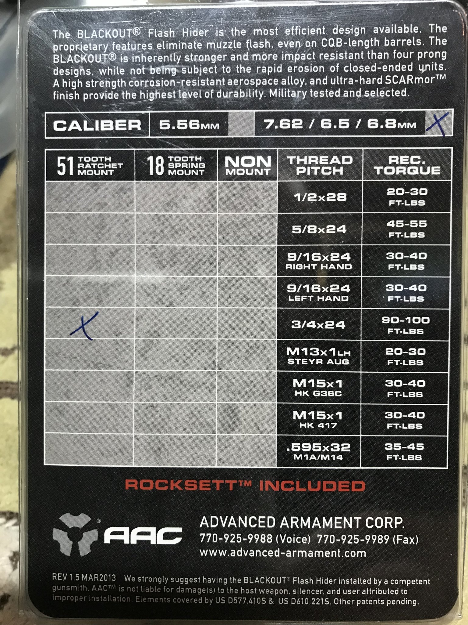

I am about to mount an AAC 51t flash hider on a Knight’s SR25 APC 308. AAC makes a special mount for the SR which has a 3/4x24 thread pattern. AAC calls for 90-100 ft-lbs of torque.
That sounds really tight based on the above comments and others. Anyone have this setup and care to share their experience?
90-100ft/lbs? That's more than the specs required for my Toyota truck lug nuts!
My AAC 7.62 51T MB called for 45-55ft/lbs (per packaging). It was a P.I.T.A to get it timed perfectly which took 40ft/lbs and I left it at that.
Reactions: Spblademaker
That spec is right on the back of the package. It’s kind of scary. It 2-3 time the othe mount torque values listed for different thread patterns.

Damn. Let us know how it goes with that. I'd be worried about warping the threads trying to achieve 90ft/lbs. I'm sure AAC has their reasons though.
I’ll be calling Knight’s to see if they can provide any advice. I can’t be the only one trying to use a 762SDN6 on one of their rifles.
I would never torque any muzzle device on my SR25s at that. Ever. Wouldn't even come close. I was told by KAC that you "can time the MDs as low as 15ft lbs and generally advise not going above 35. Clean threads on both with brake cleaner. Use rocksett. Snug it up. It will never come off on it's own. If you try torquing it to 100, you will be sending that barrel back to KAC for a replacement. And that's not cheap.
Tightening a muzzle device doesn't need to be complicated or destructive.
And the torque values listed on that AAC package would fall into the destructive category in my opinion considering most barrels are 416ss and would result in a trip to the gunsmith to have them removed or the threaded portion cut off and rethreaded because the threads were dry with a locking compound applied and then over torqued.
Another issue with over torque at the muzzle threads is inadvertainly creating a choke point at the muzzle due to thread elongation and would be detrimental to accuracy.
The Surefire brake I installed on my 68spc called for I believe no more than 19ft lbs when properly shimmed for timing and Rocksett applied, it's been on there for about 8 years now and has been trouble free and I bet I could also get it back off without trashing the muzzle threads or break with little effort.
If you want a damn good barrel vice for minimal money look at the Viper vice they are perfect for switch barrel set ups and routine tasks like installing muzzle devices and tightening barrel nuts in a way that puts no stress on AR receivers.
I tighten the barrels on my Kelbly actions to 98ft lbs without any rosin on the vice or barrel while only snugging the four clamp bolts down not gorrila strong arming them and have no slippage.

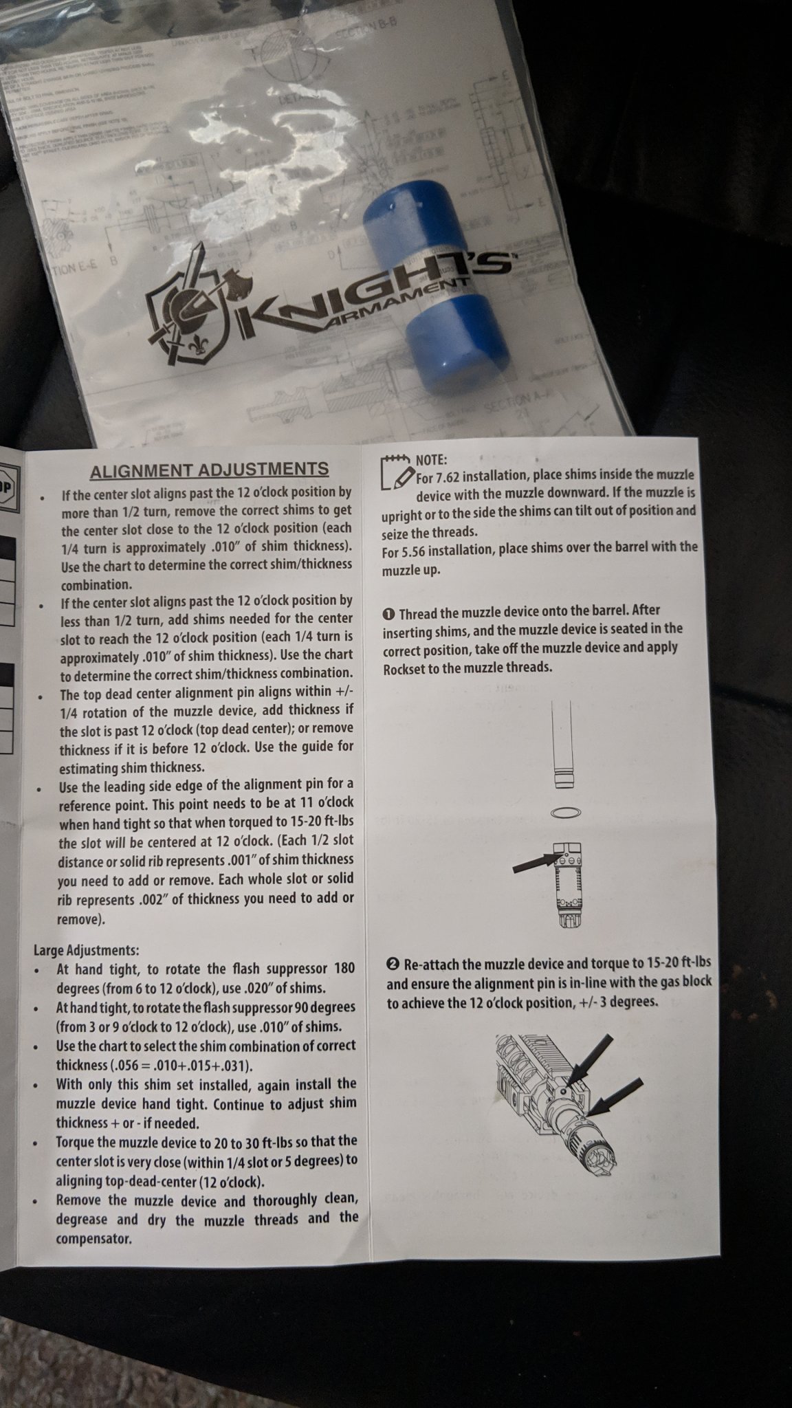

Here are KACs muzzle device timing instructions that came with my 7.62 MAMS for the SR25. 3/4x24.
Torque with proper shims to get close with 20-30 ft lbs. Then clean and degrease threads. Apply rocksett and tighten to 15-20 ft lbs of force to 12oclock position +/- 3 degrees.

You guys are right and I’m glad I didn’t just jump in without consulting a couple sources. JackL over on the Knight’s ARFCOM page confirms “NO MORE THAN 20 FT-LBS”.
