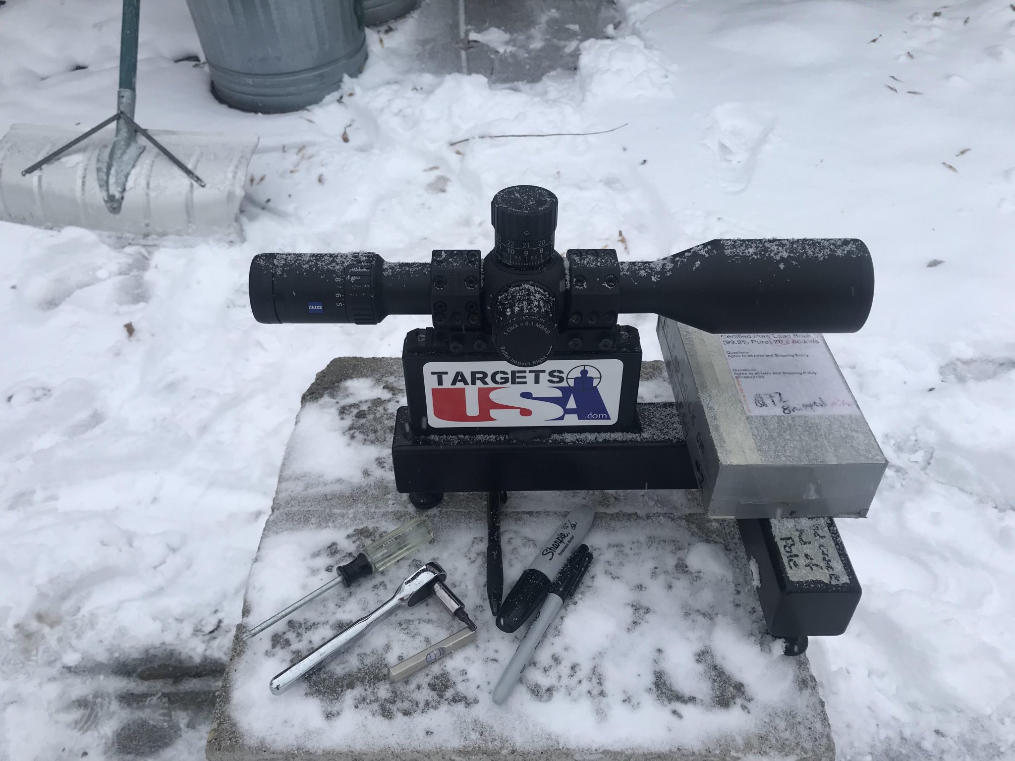

    In order to test the collimation/tracking you need a reliable procedure and I've developed one. In theory, it's easy: measure the distance to a tall target or ruler, run the scope from the top of it to the bottom, measure how far the the crosshairs travel and how many MRAD you turn and then do some simple math to figure out if the predicted movement of the reticle based on the clicks matches the observed movement downrange on the target. For a simple example, if you have your target at exactly 100 yards, and you move 10 MRAD on the turret, your crosshairs should move 10MRAD*3.6" or 36" at 100 yards.
    In practice, it's far more difficult to get repeatable (and accurate) results than it sounds in theory. I won't turn this into a "how to test your scope tracking" thread as there are many of those; suffice it to say that the biggest sources of error in my experience is not knowing the distance to your target to within less than a foot of error (not a yard - your field laser is not good enough; I use a Leica Disto D2, accurate to 1/32" and with a range of over 100 yards); and movement of the scope as you dial the elevation (I use the original Snipers Hide gizmo with a 25# lead brick on the front of it, all atop a 400# stack of concrete blocks cemented and rebar together [just something I have around as a parking barricade].) If you avoid those two errors, have stuff mostly level, and don't make any math errors, you're GTG. I'm stating this so you know you can (probably) trust the results I'm reporting. I always repeat measurements at least 3 times. I use a 96" ruler at 85.58 yards (256' 7").
    Tonight I got the LRP set up in a Spuhr and leveled and then attached to the Gizmo (Targets USA; SAC now is making one that you can mount in a fixed position if you have the space) then I ran from the top of 96" ruler all the way to the bottom 0" - it was 31.4 MRAD, measured over and over. It was between a click sometimes but I can't get any more precise than that.
    If you do the math, that 31.4 MRAD at 85.58 yards should have caused the crosshairs to move 96.65" but it was only 96" - so that's an error of 0.7% short (the clicks are slightly too small).

    Yea I measure to the turret/center of the scope. My measurement error is about 6” I remeasured after this post and it was 256’ 4”. My 8’ ruler is not fixed in place I strap it to a telephone pole across the street. I live in the city. So there is some session to session error in distance to target. Ideally I would eliminate that or measure each time with the laser. The problem is that over 50 yards the laser dot is hard to see in daylight so I have to range the target in the dark.
    As I said, to do it right you have to have a reliable repeatable procedure and that is no small feat/task!
