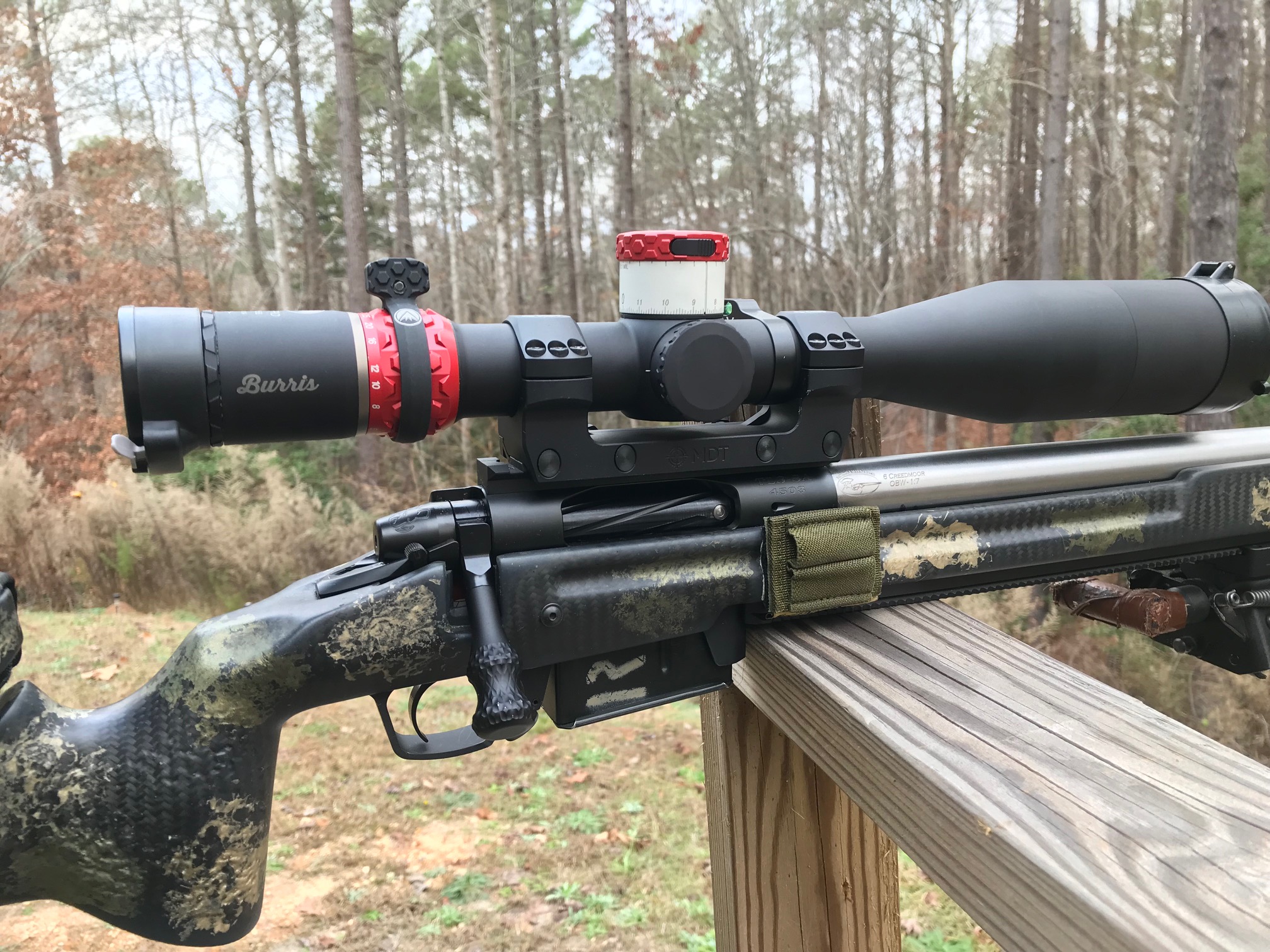

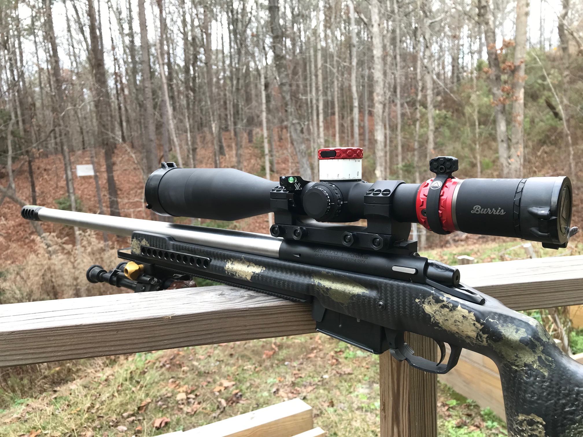

And UPS made a Christmas miracle and dropped my Burris Pro off today. I was shocked but popped it on my rifle and took a few pics. Overall it's a nice scope. Glass looks really good in my peering 100 yards into the woods looking at leaves but will give it a better test this week at the range. I like the reticle. The little + in the center is nice and not overly heavy. Put the switchview on and the power ring moved smooth enough. Parallax was a little rough and the finish is kind of a rougher feel so when you run your hand over it you can leave a little skin smear but it's not a big deal for a match optic. You can see a little in the third pic below near the sunshade.
I didn't play with zeroing yet but popped off the race top and it comes off easily and goes on easily. The book says it is zeroed on a 20 moa base from the factory but I spun the knob up and I got two full rotations and a mil so 25 mils as each revolution is 12 mils. With a scope that is said to have 26 mils it will be interesting to see where it ends up after zeroed. Clicks are tactile and audible.

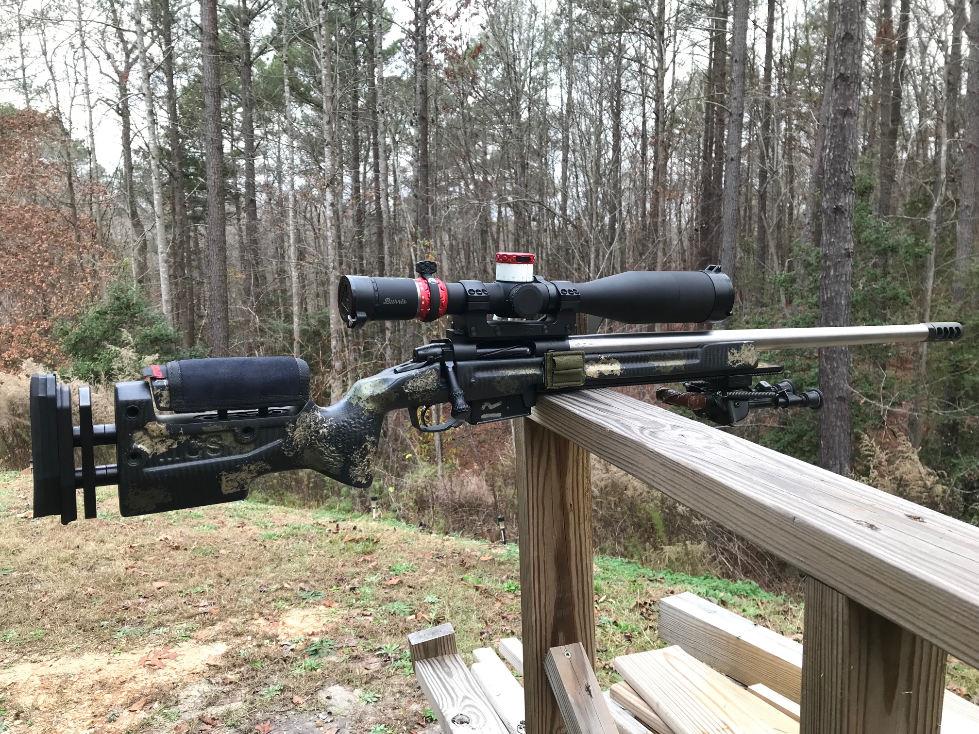

Well here's a couple quick pics to show overall size on a rifle. Will play more with it when I hit the range and compare it to other scopes. Hopefully ups drops my Tract off Monday instead of Tuesday. LOL
ETA I will add that if you want a Pro or XTRIII go look at Liberty Optics. Scott has great prices.

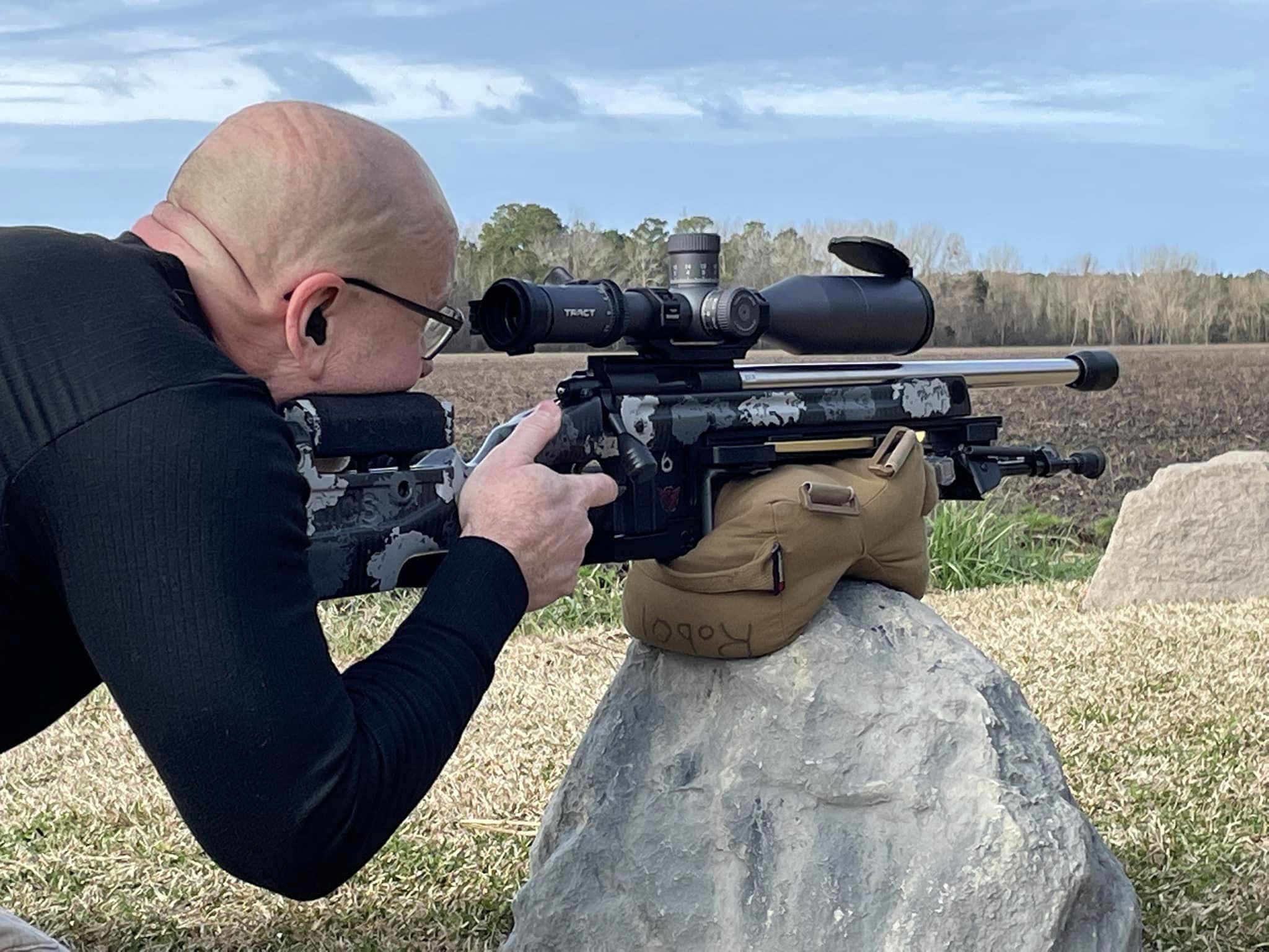

The Tract Toric ELR came in today. I got it mounted up and gave it a quick once over. The smoothness of all the adjustments are nice. No grittiness turning power, parallax or occular. Knobs feel good with audible and tactile clicks. Looked through it like I did the Pro and the glass is very good. I really like the reticle. Still need to put the zero stop in but put the Tenebraex caps on and they fit well. The occular doesn;t have a lock on it but with the cap on it's easy to see if it was moved accidentally with the small set screw in the 6 o'clock position.
A little con was now I can see what was meant by "tunneling" comments. There is a larger outer black area but I will wait and see until I get to the range to see how it compares to the others for FOV. Also the ring placement with eye relief was tight and on last slot. It was a little closer to the turrets than I usually set it but it's not something I would worry about.

Well made it out to the range today. Gary @DownhillFromHere was there also and took a look through the three scopes. First to get it out of the way I will say the Gen III Razor has better glass than the Gen II, Burris Pro and Tract. Just is what it is and being more money expected. Of the three I thought the Burris had the best glass and the Tract and Gen II were close. Gary said he liked the Tract glass but the sight picture/FOV was a non starter for him. It is as mentioned above by others more of a larger black area around the sight picture. Not so much tunneling as that is not what it is but just a little like looking down a paper towel tube. I will address each below.
First the Burris. The Pro is a very nice optic. Glass is better to my eye than the Razor II as mentioned. It has a locking diopter which is nice. The capped windage is good to protect from spinning as I don't dial but easy enough to pop off if I did. Windage clicks were very crisp. The parallax was easily adjusted for view but the knob turn itself was a little gritty. Hopping it smooths out with use. It was easy to set and when set at 400 I could swing to the 550 targets without having to move it. Illumination has off spots between brightness and is daylight visible on the highest settings. Both red and green. The whole reticle does not illuminate but enough of it does. The elevation knob with the race dial is easily removed and the tooless zeroing is easy to use and works great. Once done just rezero the knob and pop the race dial on. Simple. After zeroing on a 20 MOA base I had 17.5 mils left. more than enough for a centerfire rifle. On a rimfire I would put it on a 40 MOA base. The reticle was really nice and thick enough to be seen but fine enough to drop the center + on small dots. The only real down side to the scope I can see is the scope caps as they are a little inexpensive feeling but they were free with scope and work so not a big deal with a scope that does so good with glass clarity and FOV.
Now the Tract. Again another nice optic in that sub $2000 price range. Glass was very good but again the larger black diameter kind of took away from it. No locking diopter but with the Tenebraex cap on it's easy to see if it moves. The parallax was tight to adjust as in it would go in and out of focus fast. Took a little play to adjust at 100 but easier farther out. The parallax knob itself is very smooth. Same with illumination which also has off spots between settings and is also daylight bright. The whole reticle illuminates also. Zeroing was easy enough. Dial until you are on and then take out single center screw and rezero knob. The zero stop is also easy to install. With the elevation knob off you just drop it in and tight three small set screws with the supplied allen and replace outer knob. @The4GunGuy I played with the zero stop and if you drop it in and bump it to the stop inside and then turn it back a little and then tighten set screws you can get some dialing below the 0 mark if someone wanted it. I had 23 mils after zeroed on a 20 moa base. The reticle was very nice with a good amount of hold points but not cluttered. Only two things I didn't care for and that's the ring around sight picture and the other I think will warm to me which is having to lift the elevation knob up so high. The ring around sight picture was more distracting than anything. I plan to run this scope for a few matches and see how it goes.
I am sure I forgot something so ask if I did as I just did this from memory. As a side note I am working to get a Bushnell XRS3 with EQL reticle in to play with. Will update when I do.

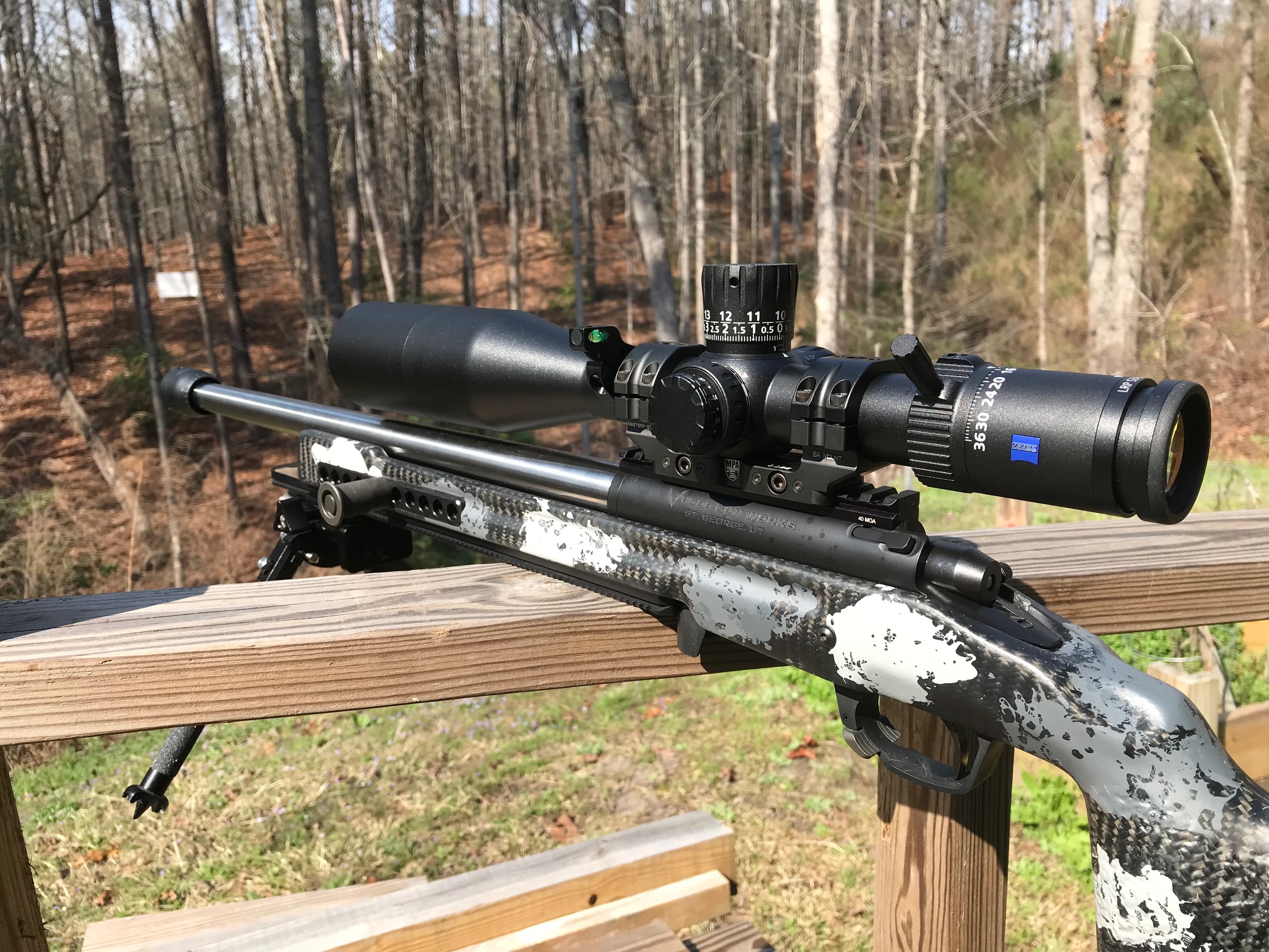

Well got the Zeiss LRP S3 6-36x56 yesterday. Got it mounted up and to the range today. Just wrote this in another post for someone asking about the Zeiss versus the Pro for glass.
Well just got back from the range a little while ago and figured I would update. Had my friend Gary @DownhillFromHere at the sight in 50/100 range with his Gen III Razor and ZCO as well. I looked at the Razor, Zeiss and Pro first and then let him take a look but I didn't say what I felt so not to muddy the waters. After he got done he said the same thing I saw. The Zeiss and Razor III were even with the Pro just a smidge behind them with glass. I say a smidge and mean a smidge in that it won't make you miss a target but just a hair better clarity. The ZCO was a little better as to be expected. I then took the Zeiss and Pro over to the longer range and with the heavy mirage today it was a good test. The Zeiss again edged out the Pro in cutting mirage.
All in all Zeiss did a great job on this scope. Was easy to get zeroed and set zero stop. I ended up with 26.5 mils of up elevation on a 40 MOA base on my Vudoo so can dial past 400 yards. Here's a couple pics of the scopes sitting next to each other. I just threw some Butler Creek Element caps on the Zeiss until the Zeiss caps come out in April.

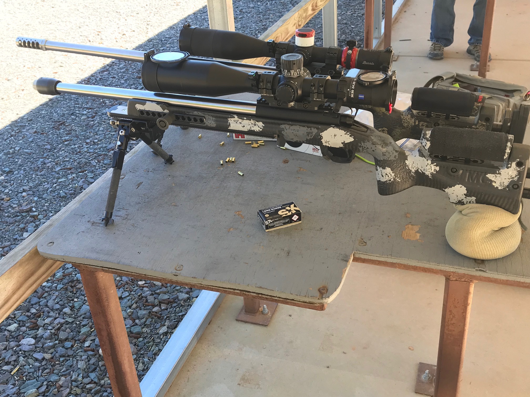

Well my Zeiss LRP S3 4-25x50 showed up today and man it is nice! The glass is very clear and bright. Same reticle as the 6-36 so no surprise there. Basically the same excellent scope as its big brother but lower power. I took some pics of both scopes together. The 6-36 still on my Vudoo and the 4-25x50 on my 6/6.5 Creedmoor now. I have the 4-25 in a 20 MOA MPA mount so when I drop it on the Vudoo I should have close to 40.5 mils of elevation on the 40 MOA base. Will have over 34 mils on the 20 MOA base. As I said before about the 6-36, Zeiss did a great job on the 4-25 also. I have some cheap caps on it from an Arken scope until the Zeiss caps ship next month.
Let us know your thoughts again when you compare this one to the Pro.
Reactions: Rob01

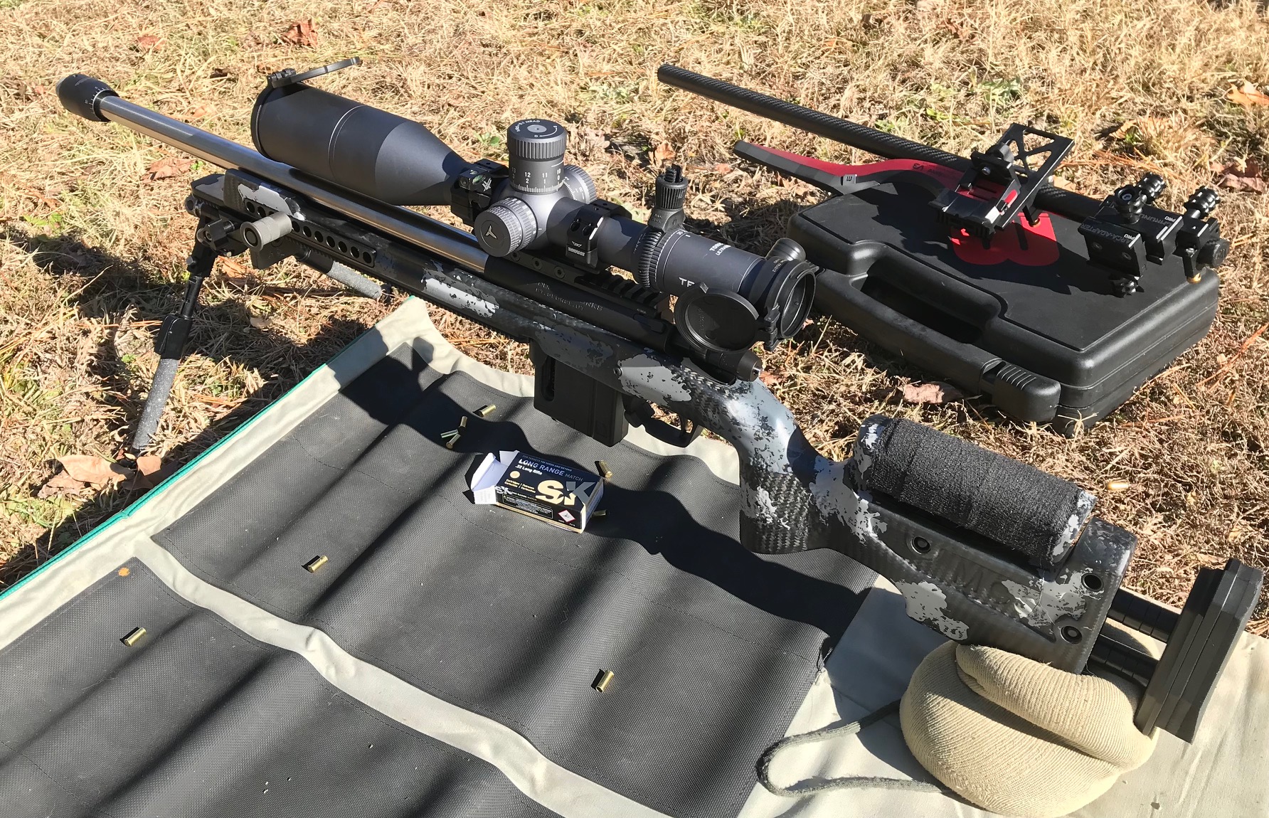

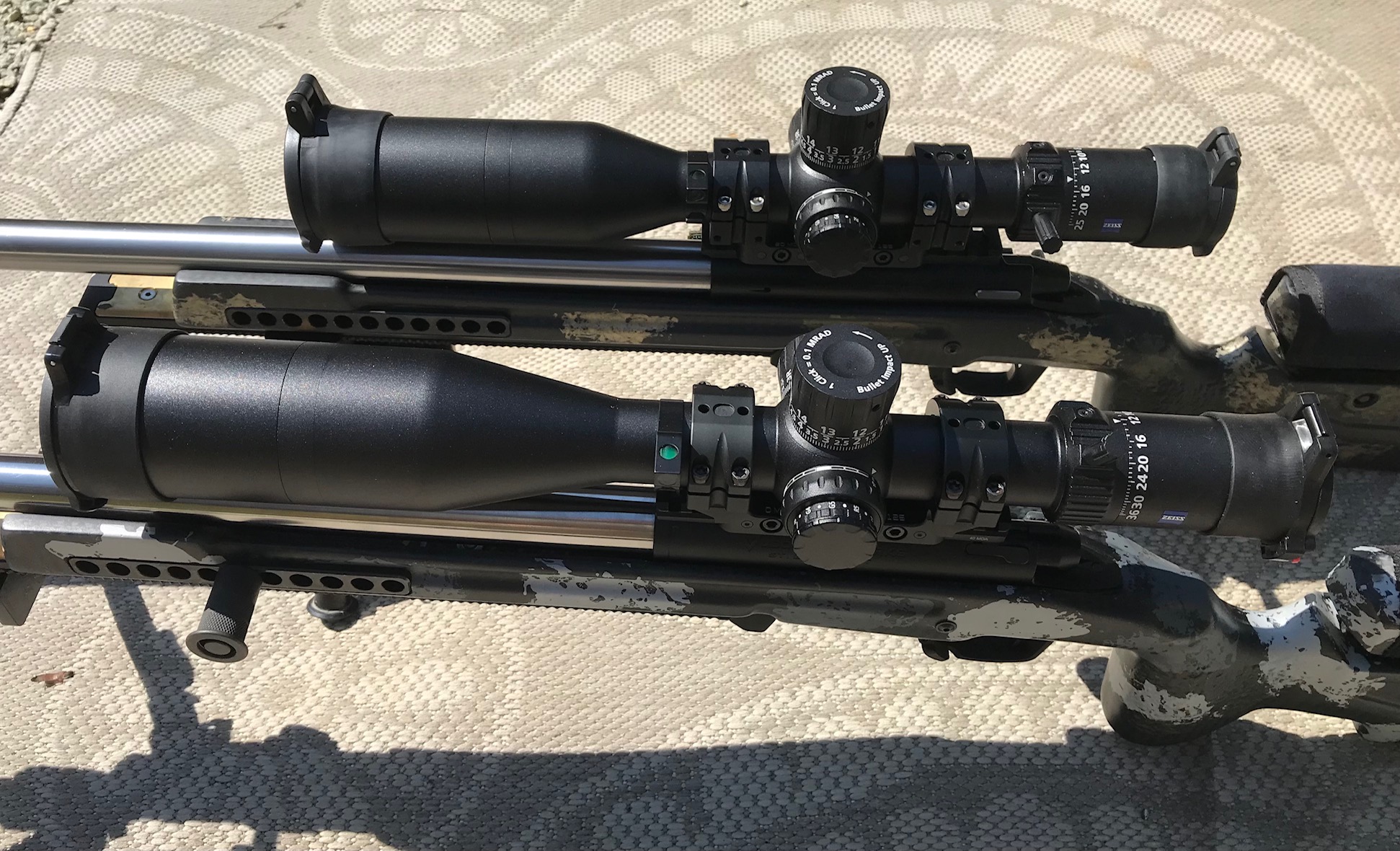

I got out today with the 4-25 for an initial zero and shooting out to 1000 to check data. I looked at the parallax at the 300 yard and out range and it actually worked well when transitioning. 300-500 yard is close and not a lot of adjustment needed. When I went from 600 to 1000 it was basically the same. Set at 1000 I could come in and see and impact 600 yards without issue. I did have the parallax set at the block just before the white block at infinity at 1000 on the parallax knob. It was actually the same setting for the 4-25 and 6-36 at 1000. I have a match in 2 weeks I will be shooting with the 4-25 and will have targets out to 1600 yards so will be interested to see how it does that deep.
It was a pretty hot and humid day and the mirage was cooking today but the glass did very well with it. I put it next to @DownhillFromHere ZCO with both set at 25x and the ZCO we both thought it was close but the ZCO was a little better cutting the mirage as most would expect. Had no problem seeing and hitting the piece of shot up grey 6" steel at 550 yards today so The Zeiss did a good job.
I also ended up with about 37 mils of elevation with the 4-25 in a 20 moa mount on a 20 moa base. I didn't notice any shadowing in the edges when topped out in elevation. If I put it on my 40 MOA on the Vudoo I should be able to dial out past 600 yards with the .22LR. That's nice! ;)
It was interesting today... we had multiple rifles side by side on the bench, peering through the glass and discussing what we saw. We kinda drew an audience, with one guy fairly new to the discipline especially asking a lot of questions. Rob's depth of experience and willingness to share knowledge is a gold mine for our community. I've learned a lot from him (and it's cost me a lot of $$$$ :ROFLMAO::ROFLMAO:).

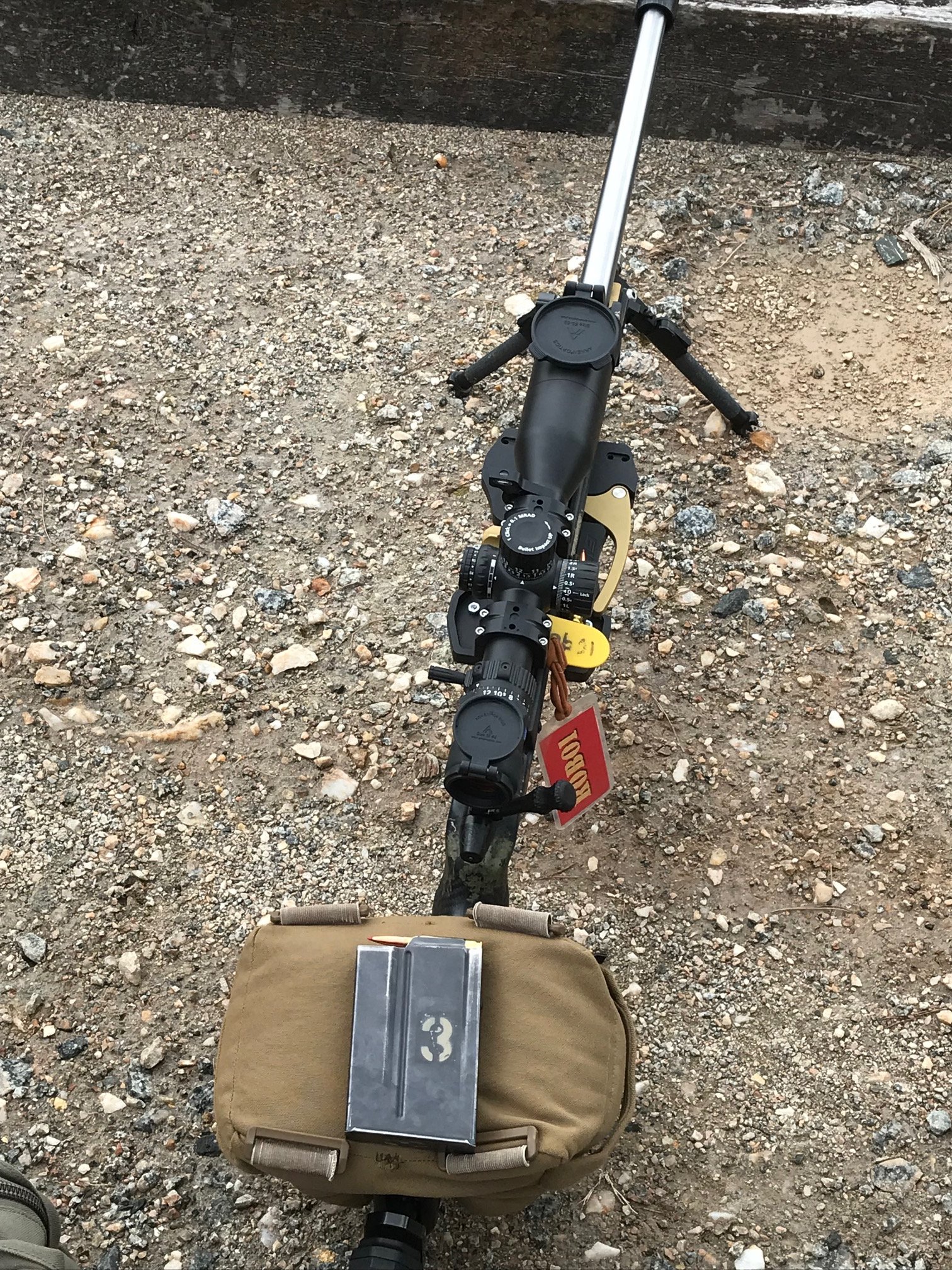

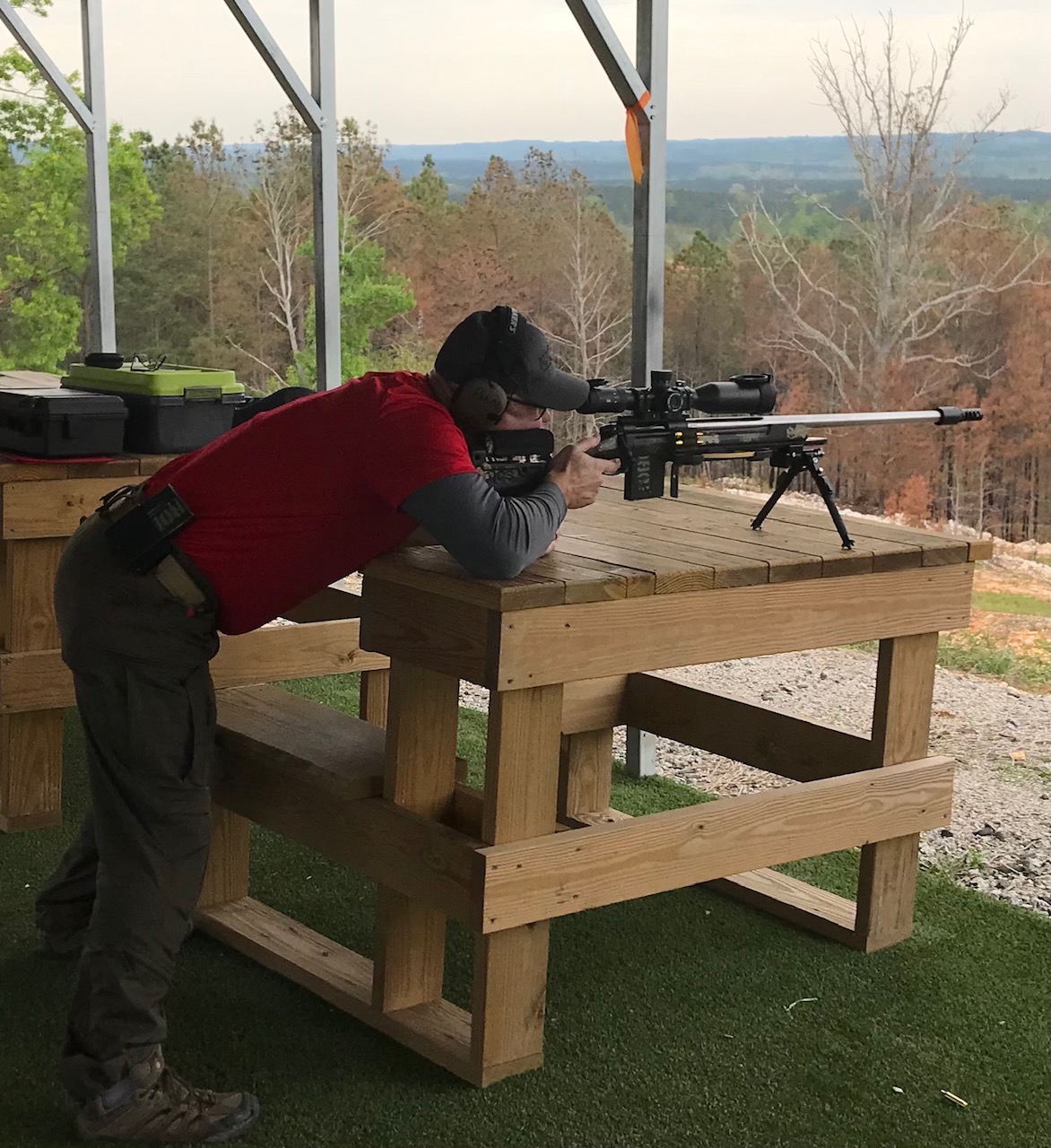

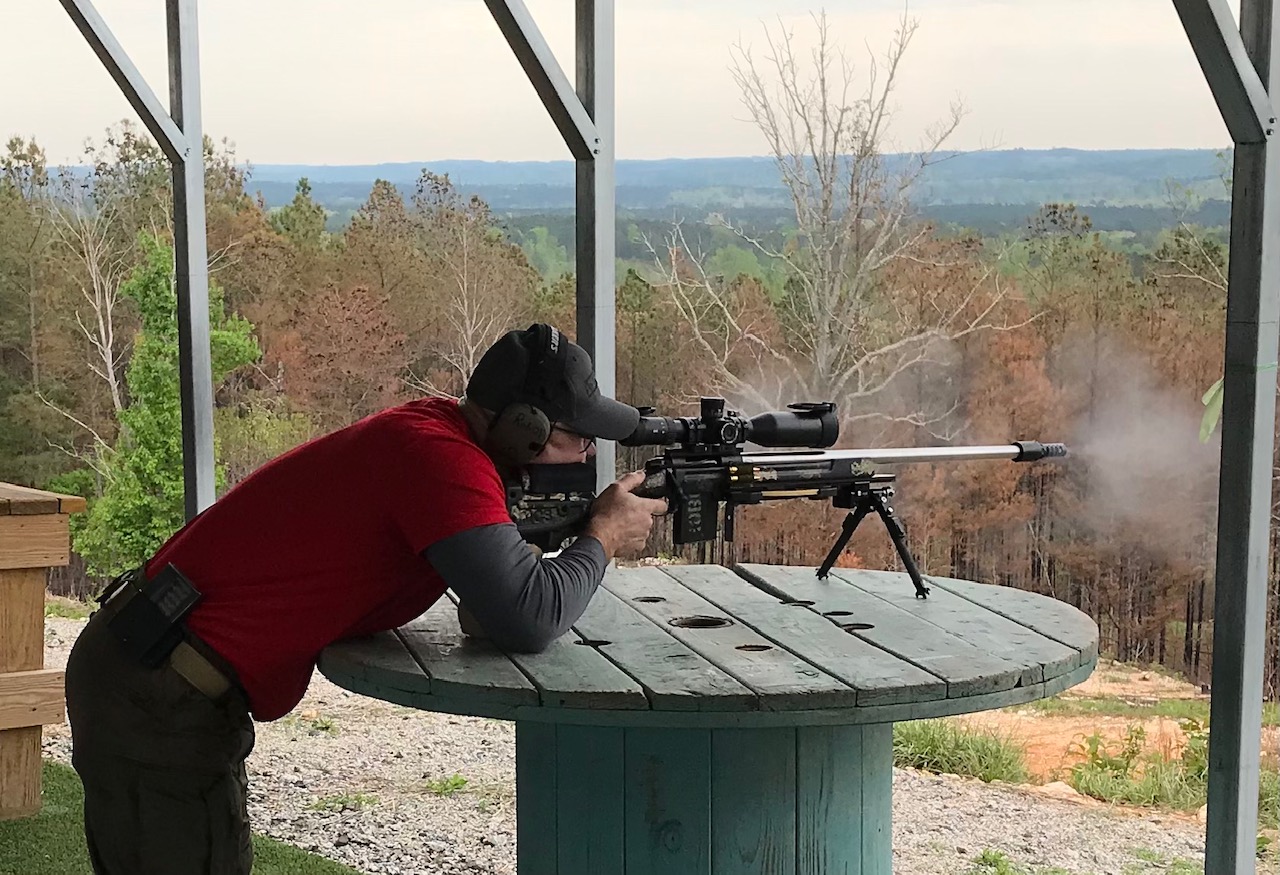

Well I was finally able to get a Zeiss out to a match today! I took the LRP S3 4-25x50 on my 6.5 Creedmoor to the Coleman's Creek Atlantic Coast Regional PRS match today. Was a good match to bring the Zeiss out to as we shot to 1247 yards and they have a mile range so I was able to check out targets to a mile with the scope. Glass was great and able to see even shot up targets at longer ranges through some mirage. One thing I did notice was that the parallax was very forgiving from around 580 yards and out. One stage we had targets from about there to 1247 yards and I didn't have to touch the parallax. Had another stage from 300 yards to a little over 800 yards and I set it at about 400 and it worked great. The glass is very forgiving in this way. Scope tracked out to the 1247 yard target and if I didn't brain fart on that stage I would have gotten three hits there but when you shoot an extra on another target it takes away from that. LOL
The reticle was excellent for holds. I used it on half of the ten stages for holds as it was quicker. The day bright illumination works great. I used it on more than half the stages also as it showed better contrast on the shot up targets. All in all I am very happy with this scope. I am really fighting though with the thought of moving it to my other Vudoo when it gets rebarreled as it will have about 41 mils when it's said and done and mounted so can dial a long way with the .22. We will see.
I didn't get a lot of pictures but here are a few. Ended up 8th out of 101 shooters so not bad for a new scope on a 6.5 Creedmoor shooting factory ammo. ;)
View attachment 8121792View attachment 8121793View attachment 8121795
