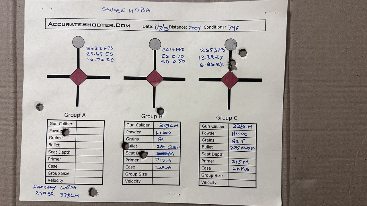

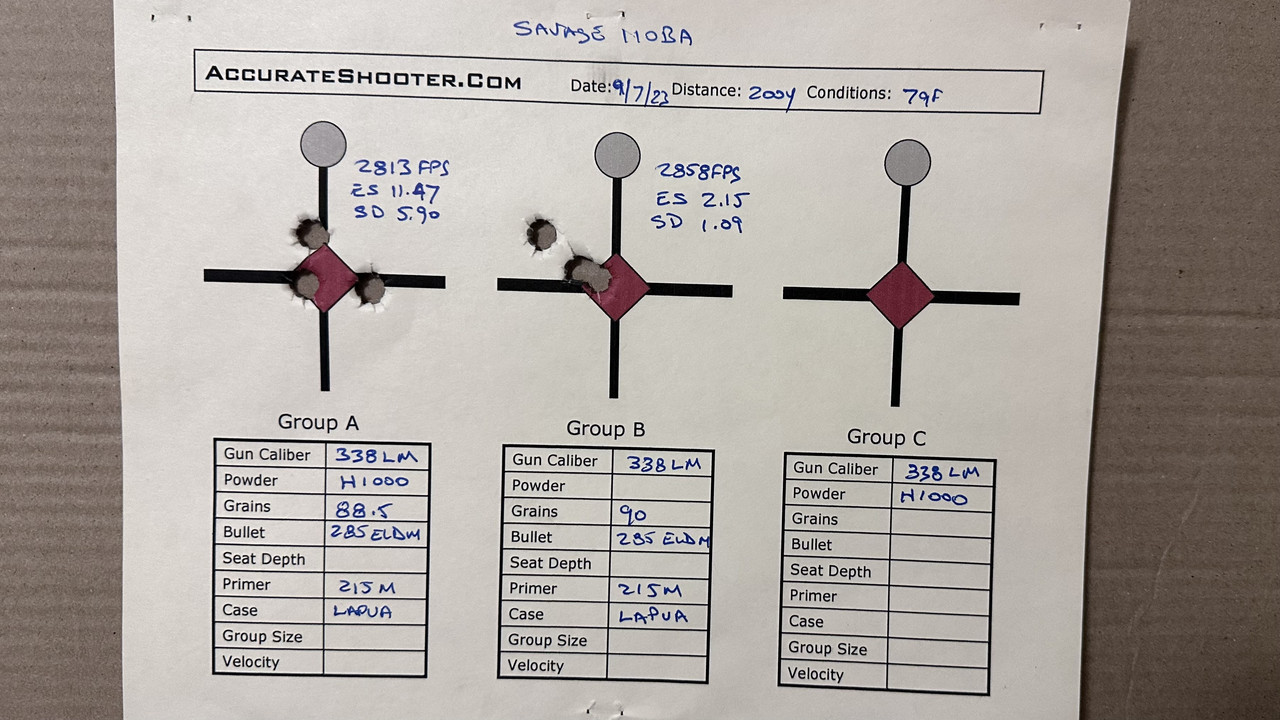

No offense but since you reload I would get a set of dies and 100 bullets.
Do a simple ladder test.
That will tell you all you need to know moving forward.
Edit: Here is an example of factory ammo vs hand loaded.
Savage 110BA 338 Lapua Magnum
Lapua factory 250gr ammunition vs hand loaded Hornady 285gr ELD-M with H1000.
You wouldn’t think that it was the same rifle shooting these groups.
