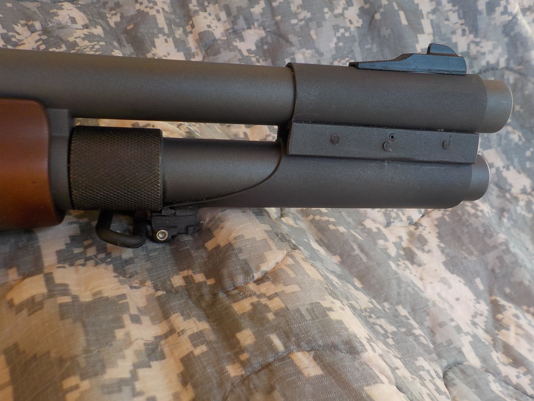

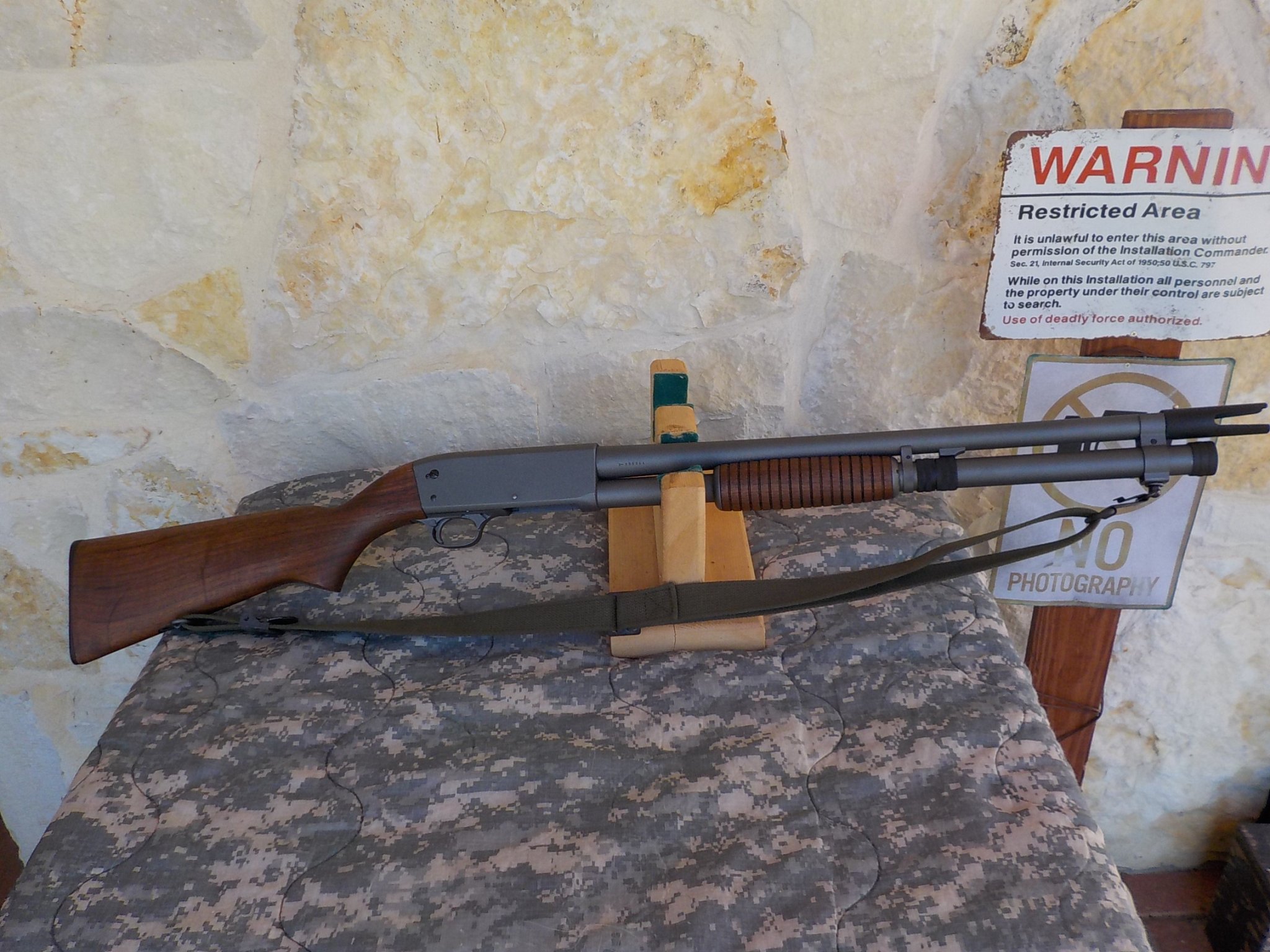

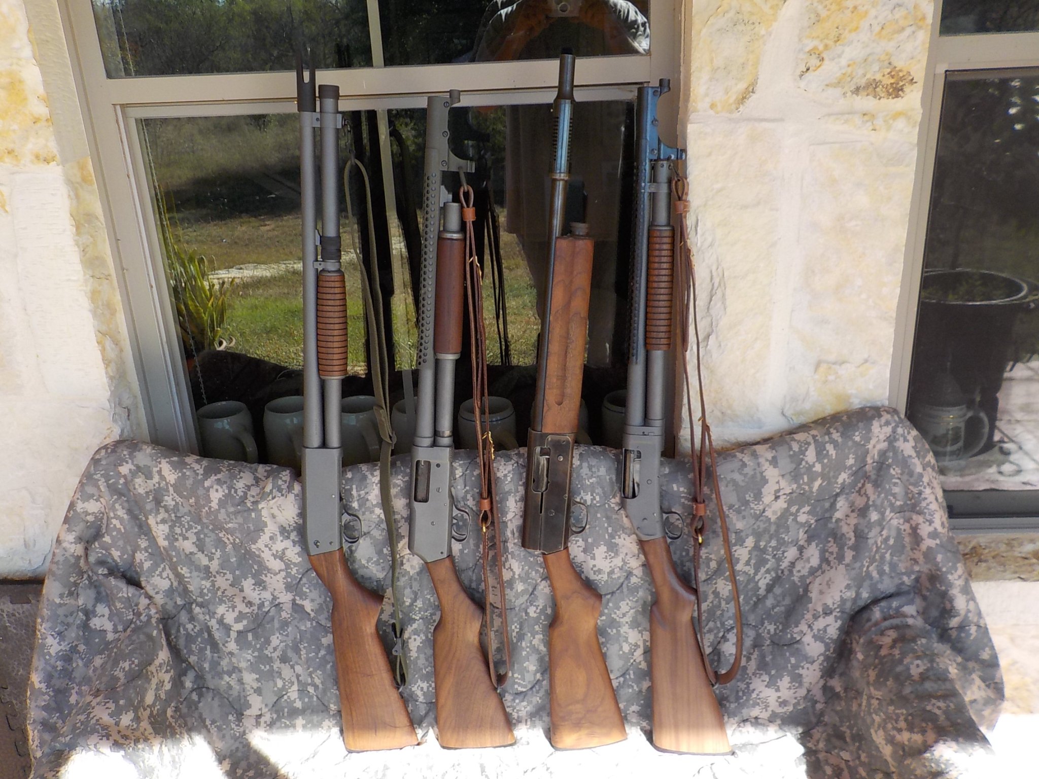

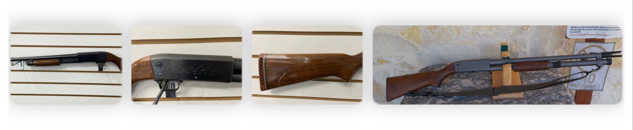

    Well, after reading some history, I once again became intrigued by the Duck Bill Spreader Ithaca Model 37 used by the Navy SEAL's in Vietnam. One thing lead to another and I've spent the last month buying every cheap piece of crap shotgun off of the internet and restoring them to Trench Gun magnificence.
    First, and foremost, The Ithaca Model 37 with Duckbill Spreader. Designed for and used by the Navy SEALS in Vietnam in response to their request for a shotgun that would spread shot horizontally for a bigger kill area.
    I fabricated the Duckbill Spreader and Magazine extension, among other things. Finished in my proprietary Parkerized Cerakote finish.
    Before and after:

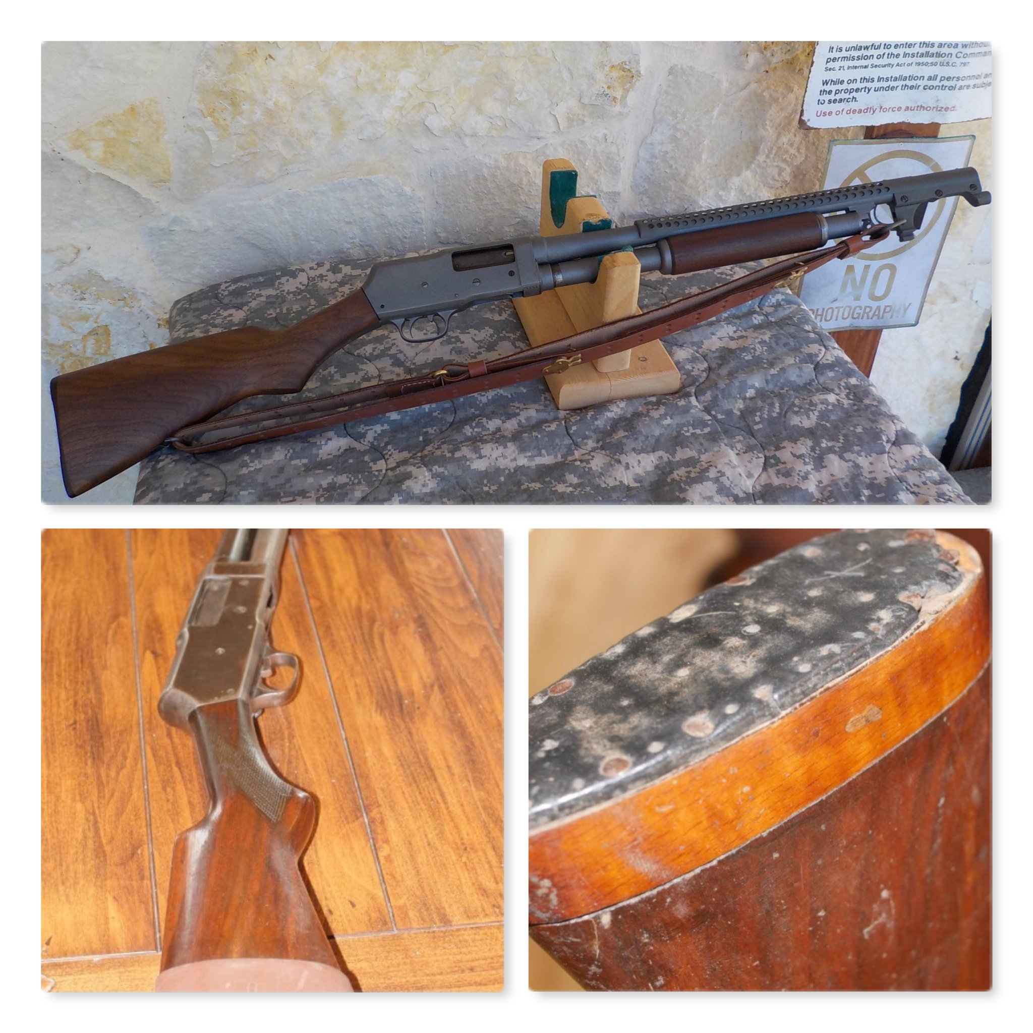

    Next I built a Stevens 520 trench Gun. The Stevens has the smoothest action of any shotgun I've used. Real old school craftsmanship, everything is made of either steel or wood.
    Before and after:

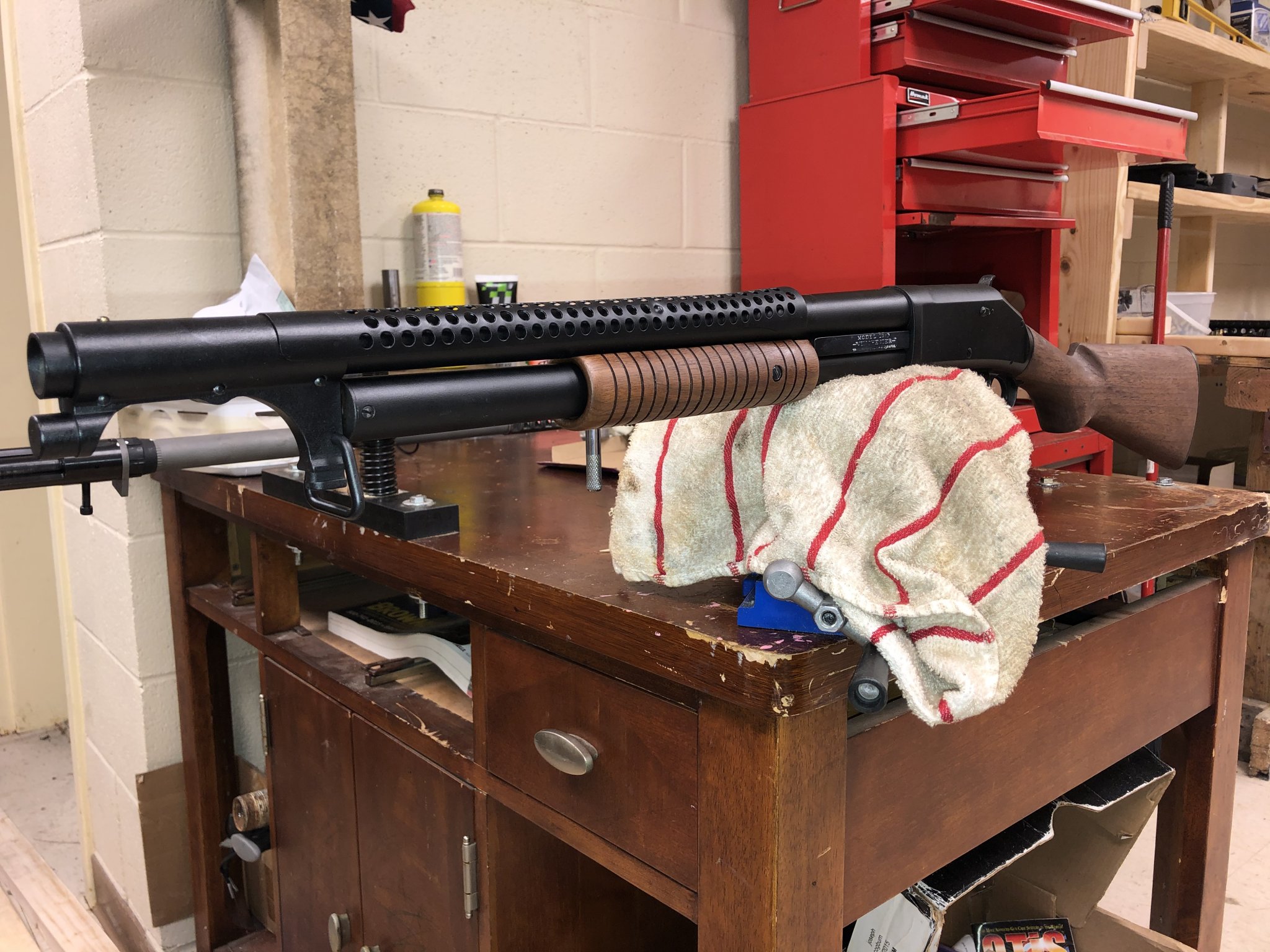

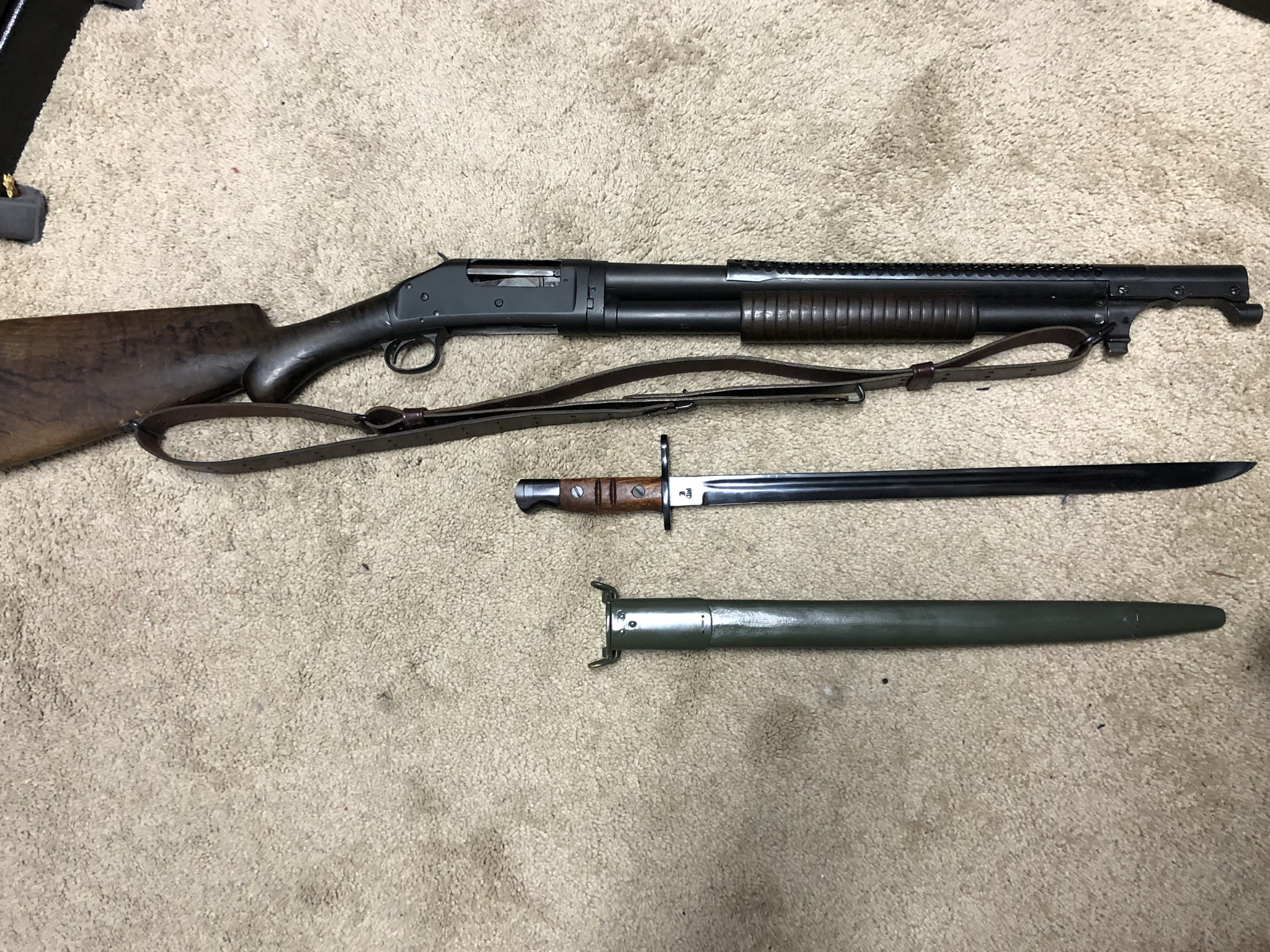

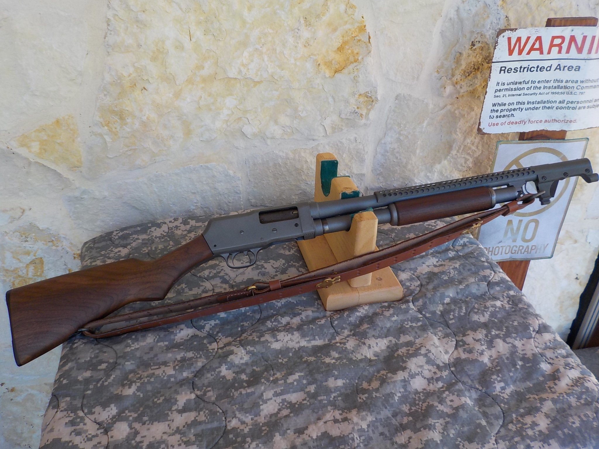

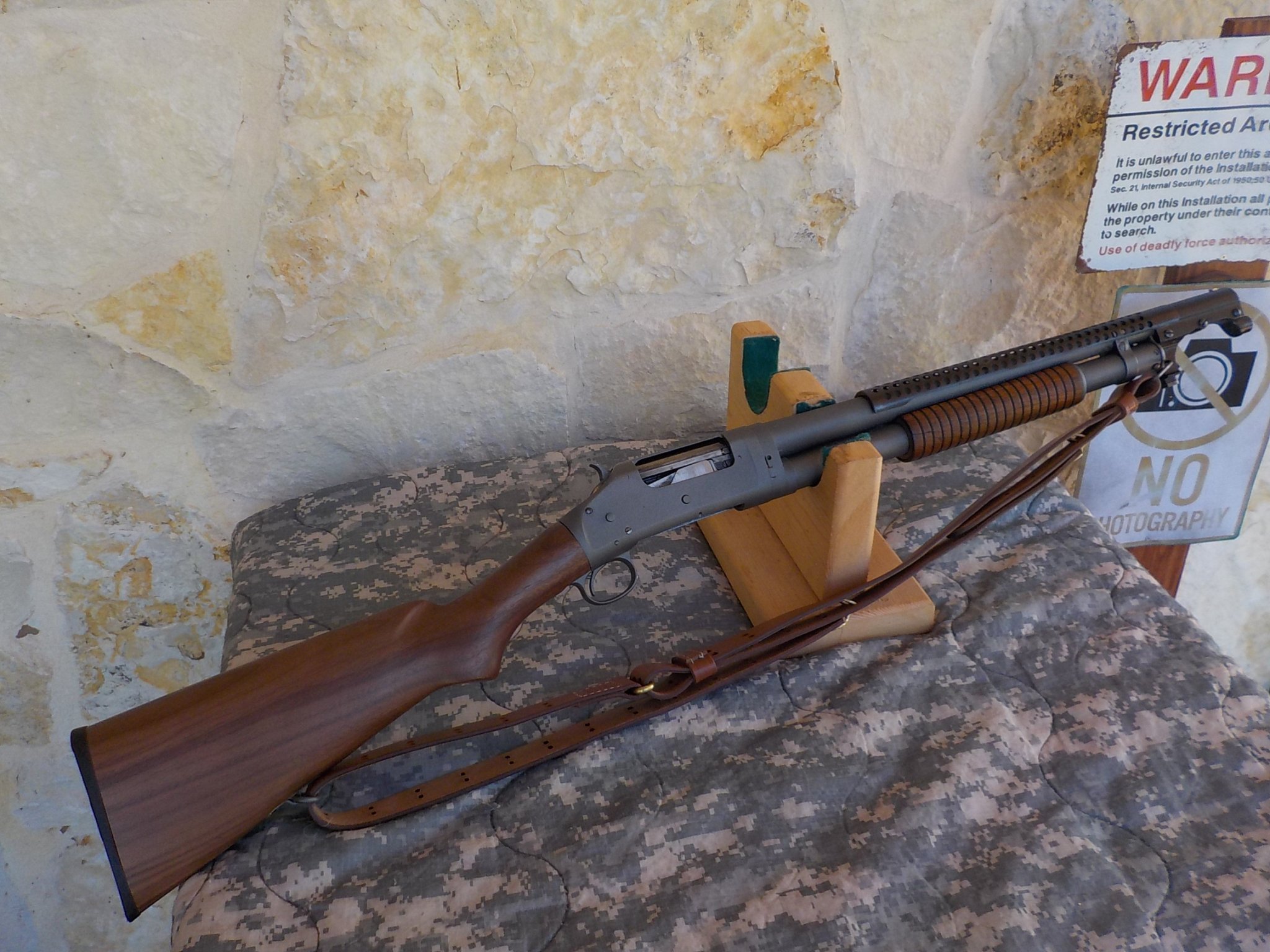

    Winchester 1897 I literally build from scrap parts I had laying around.

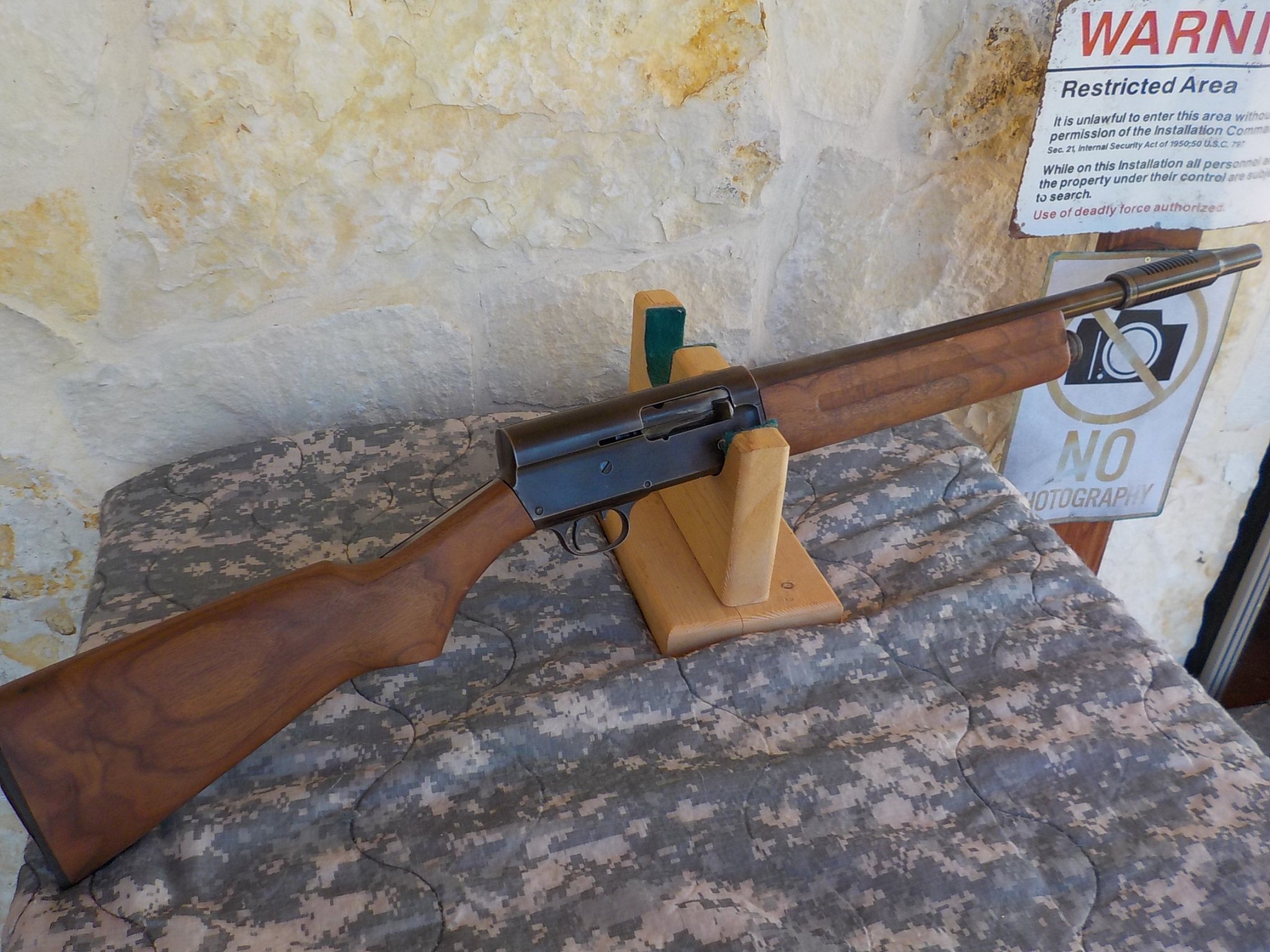

    Remington model 11 with Cutts compensator

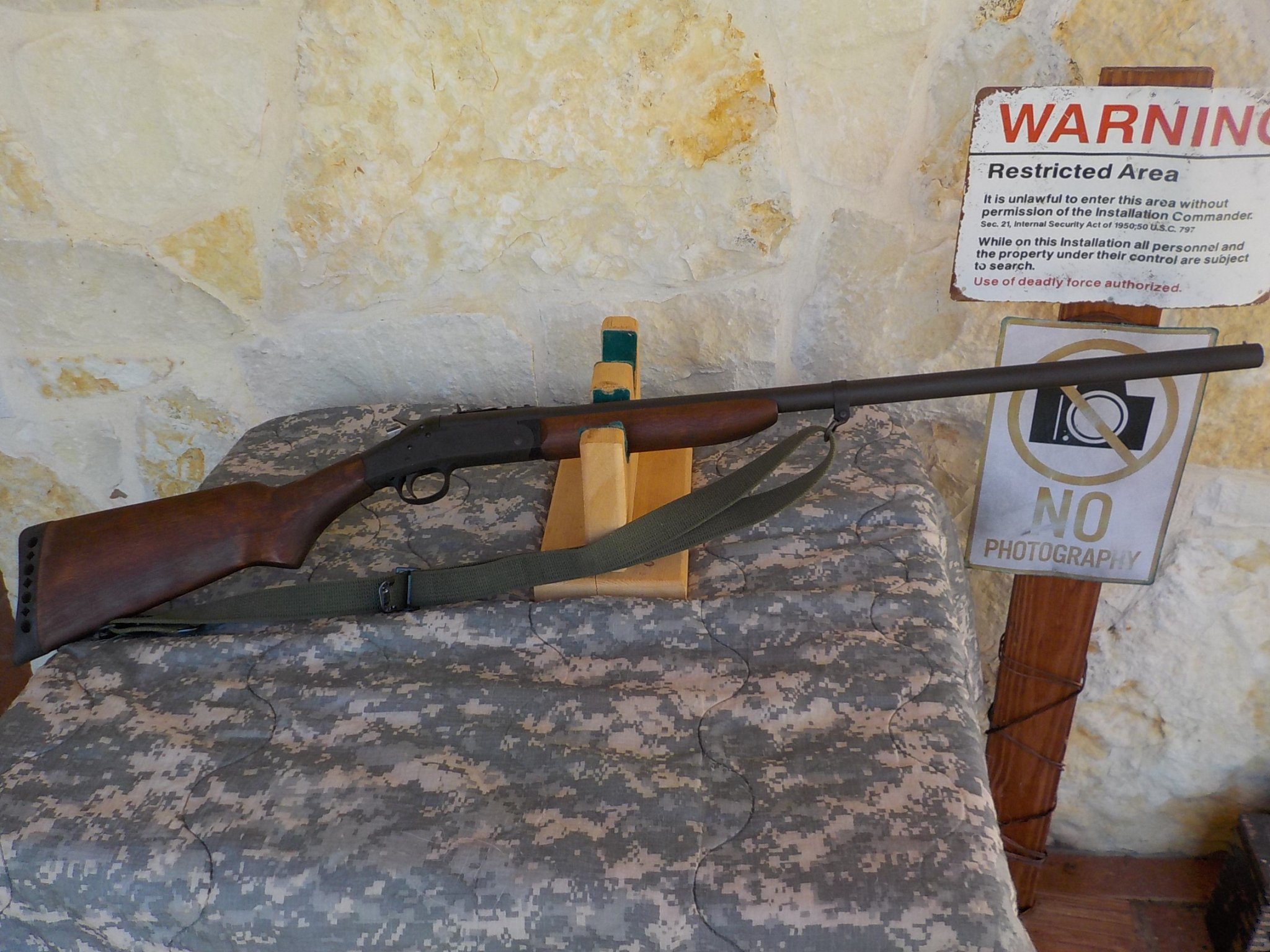

    And just for some history, the infamous Harrington and Richardson "Special Forces Shotgun". After much investigation, and with help from SirH, we found this to be the real deal, made for Special Forces to be given to Montagnards in Vietnam.

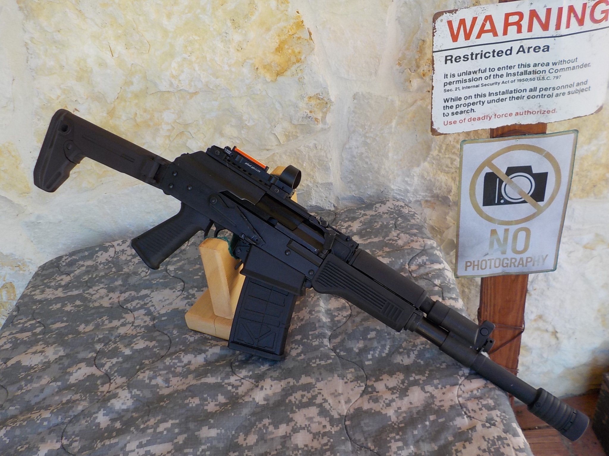

    And finally, as a counterpoint, my NFA registered SBS. Lots of effort to get this to work Zhukov folding stock. I had to manufacture a trunnion to attach the stock and get the angle right so that the stock could be folded and have the gun still function due to its' reciprocating charging handle. The right side folder also allows for the attachment of the AK side rail optic mount. The charging handle had to be fabricated also.

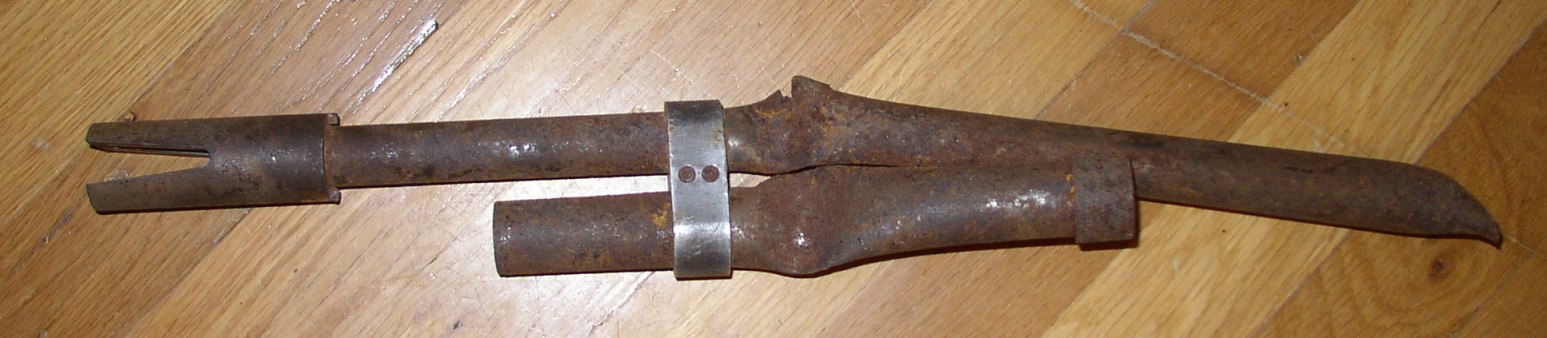

    Very Impressive(!!). May I ask where you found the duck bill (real or repo?)
    On edit: The original duck bill I saw off a de-milled M37 was umm, a bit past salty (see attached)
    Have built two M97 clones in last few years. Both of mine were built on solid frame guns. #slidebite is real
    That's outstanding! I always love to see your posts. Again, knocked it out of the park with those builds.
    Before and after:

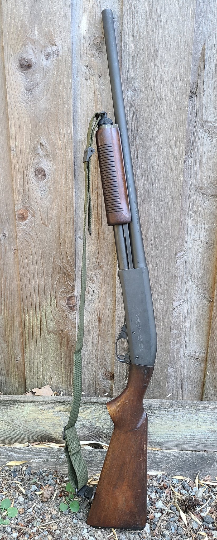

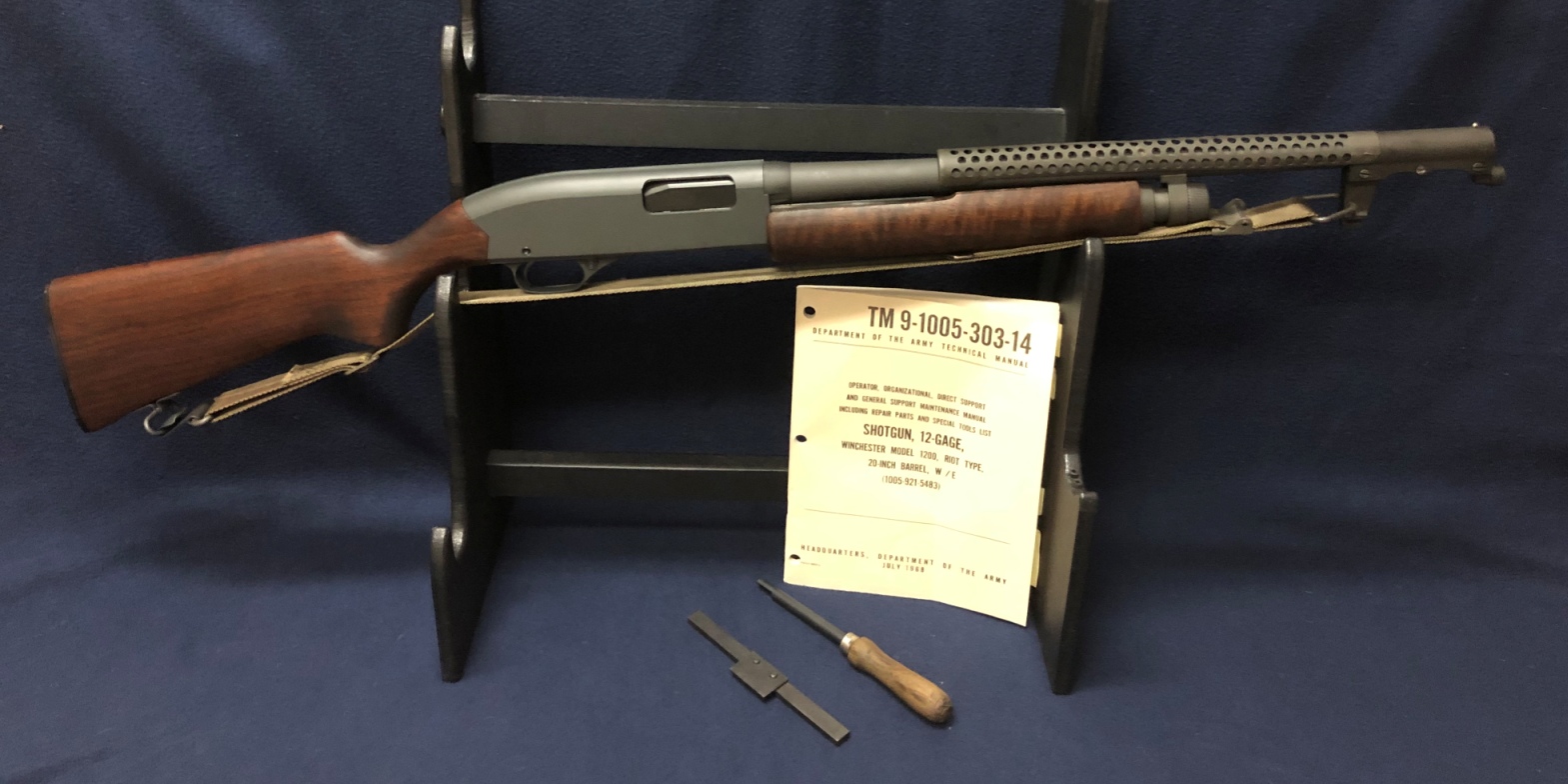

    My "Fighting" shotgun.
    Before....
    After....

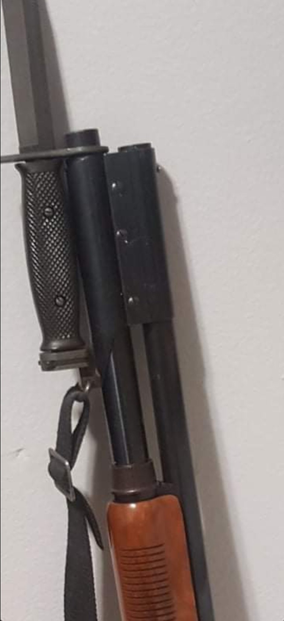

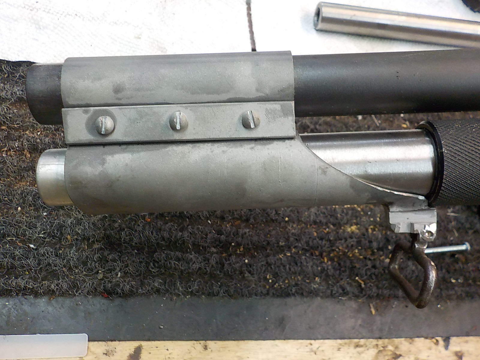

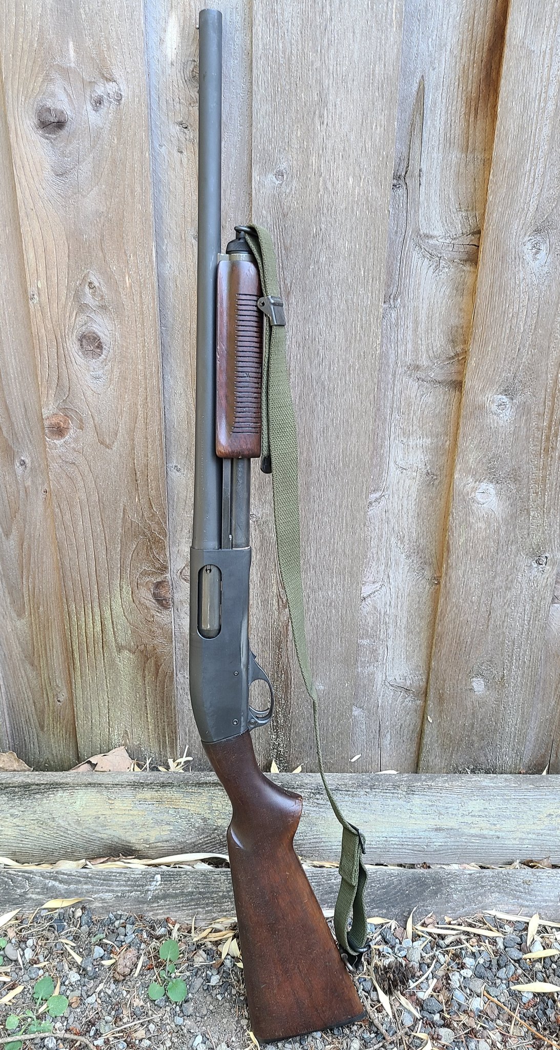

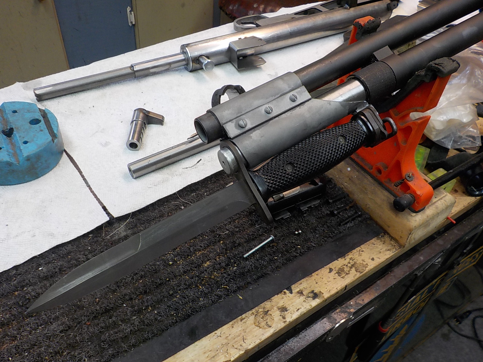

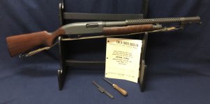

    If I were a retired Major with mad major skills how would I go about replicating the Mk I bayonet adapter to make my shotty mo' legit?

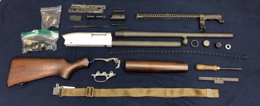

    I've pondered that same question in thinking about making one of these. here is the "kit" for the original.
    Here are some pics of the unit
    So it doesn't appear too difficult, and I think I'll make one. It appears it is simply a tube around the barrel, a tube around the mag extension, a rectangular tube in between and two side plates riveting it all together. You have to add a bayonet lug. So, I'm going to buy the correct size tube and plate. I'll weld the round tubes to the rectangular tube in the middle. Cut and shape as required. Rivet the two side plates to the assembly. I have an old M16a1 sight that I'll cut the bayonet lug off of and weld to the assembly. Cerakote. done.

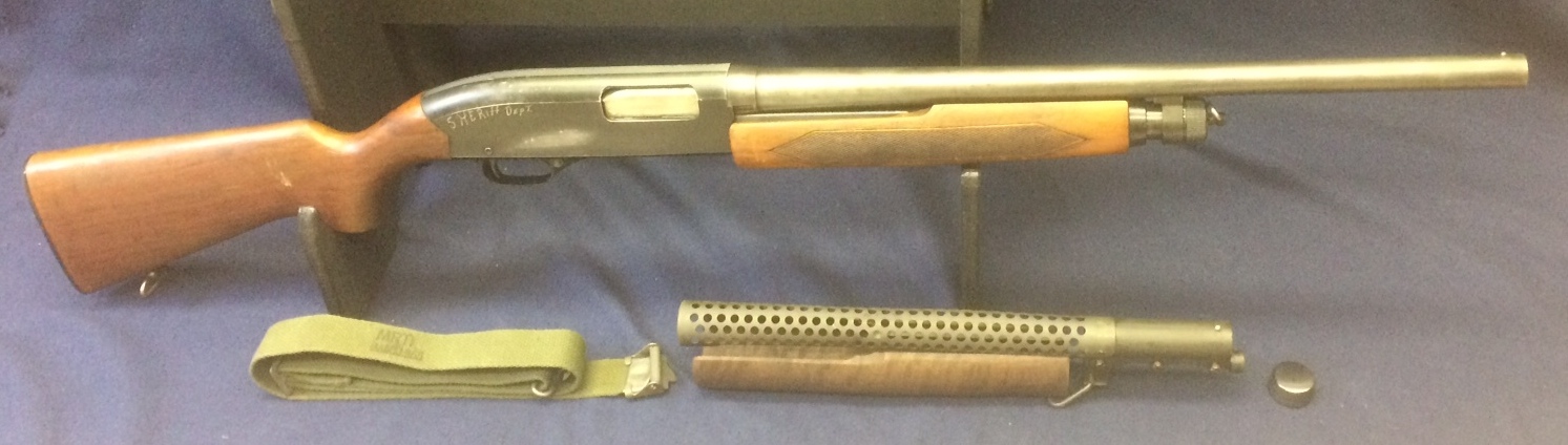

    guns not listed that are also candidates for your project: Win model 12, Stevens 620. Millions made of the Winchester. grab one and do what you want to it. successor to the 97 and they overlapped in production. personally, id find an old Model 12 with a Cutts or Polychoke thats been cut down or similarly defiled and have at it. nothing of value will be lost after you mess around with it.

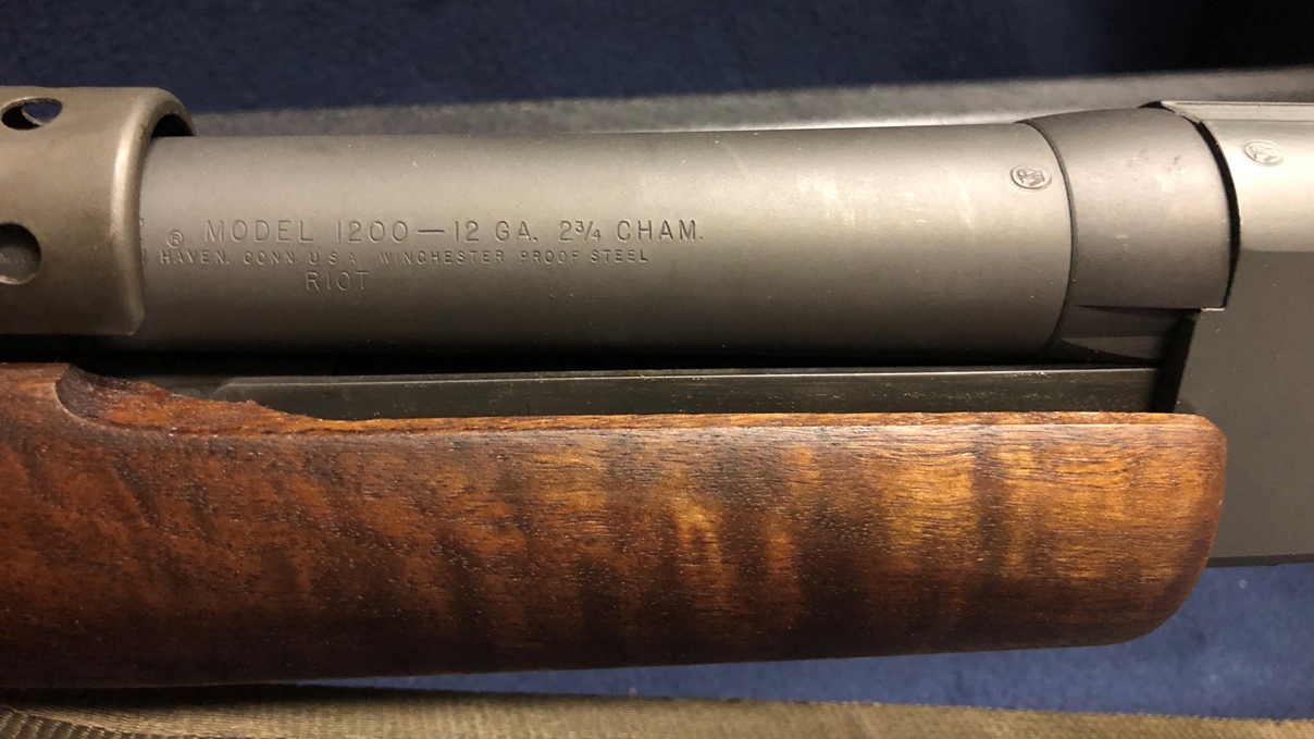

    ...but I will add one more candidate to the above list, the Winchester Model 1200, which came out in the late 1960s. Similar to the Model 12 (which has a steel receiver) but the M1200 had an aluminum receiver and trigger guard to reduce weight and decrease rust-related issues. A few years ago I bought a 1972 M1200 'Riot' shotgun that was a former LE shotgun, for $200. I bought it b/c I had just purchased an original military M1200 heat shield/bayonet bracket for $200, and eventually made a replica military M1200 as used in Vietnam circa late 1960s. Some were still in service in Iraq in the early to mid 200Xs. I confess I spent 3x+ on the conversion to a trenchgun, but still way cheaper than an original military version.
    Its a "U" shaped stamping over another stamping to fill the void between mag tube and barrel.
    The middle screw "locks" into the relief dimple on the mag tube and the other two just further tighten the metal sandwich. Unsure where the seam is on the bottom stamping.
    The Ohio National Guard shotguns that were released some years ago had the bead sighted version. Some bought those shottys at $250 now the adapter itself goes for well above $500.
    The USMC used the version with the rifle sights though it seems all pictures of the shottys in use have the sights removed. USMC Mk I spec called for the barrel to be longer than the other services barrels. Length matters to the USMC. If you compare the USMC shottys to the other service you see the barrel extending beyond the mag tube. USMC barrels are I believe 21 inch IIRC.
    I have a 30 inch barrel with rifle sights ready to be cut to length and with the correct front sight to be mounted by drill and tap when you have my adapter made....

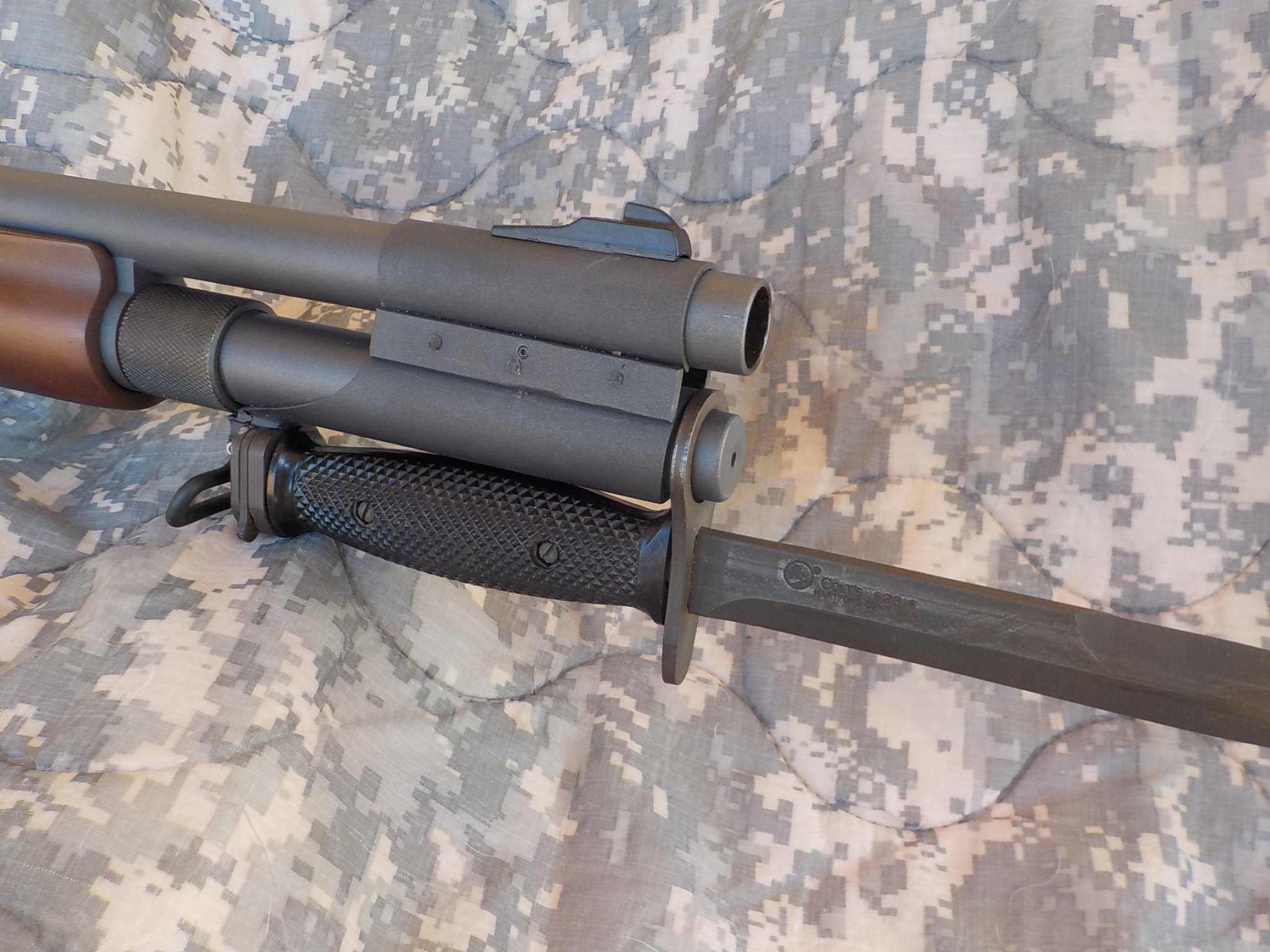

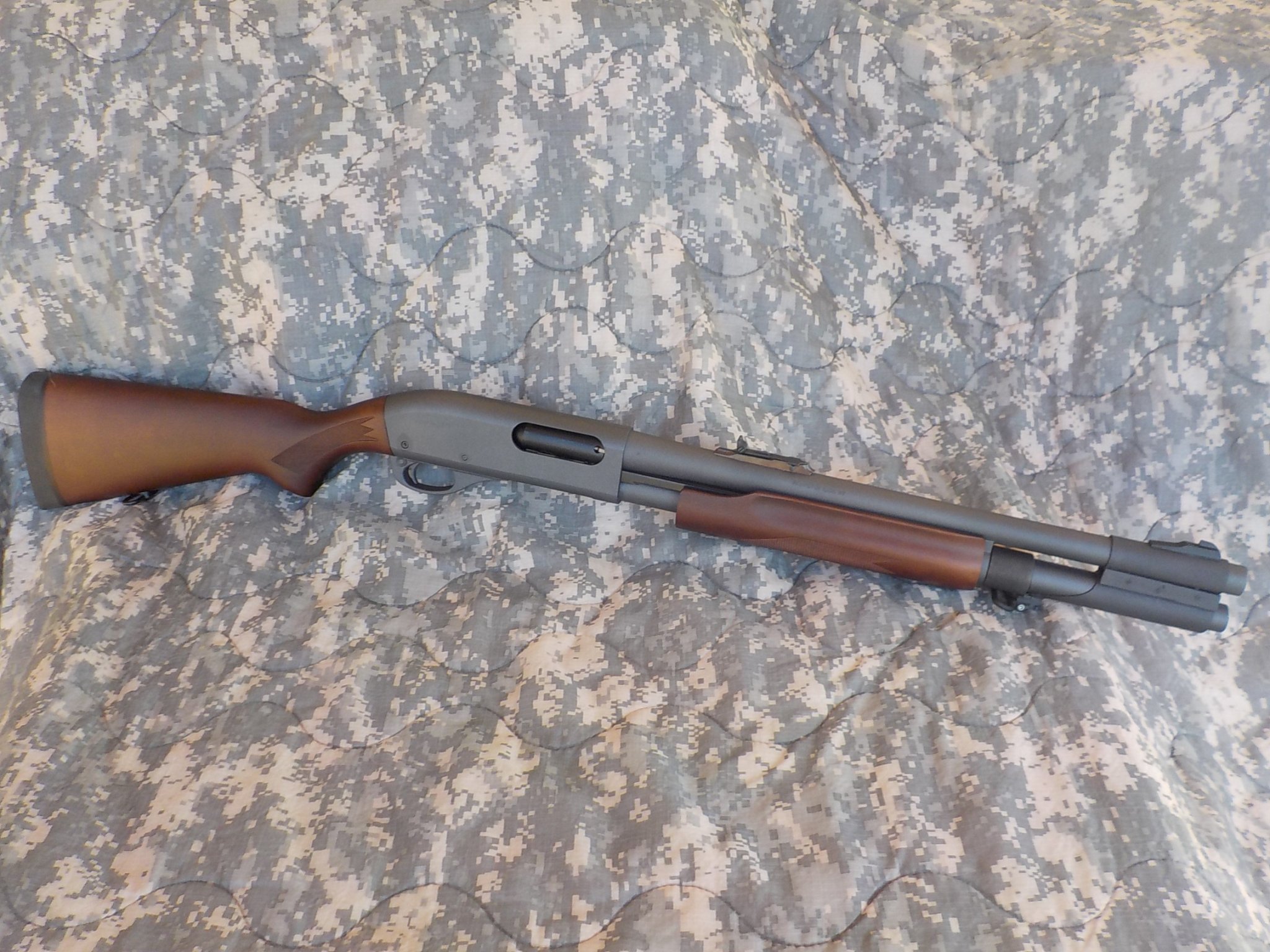

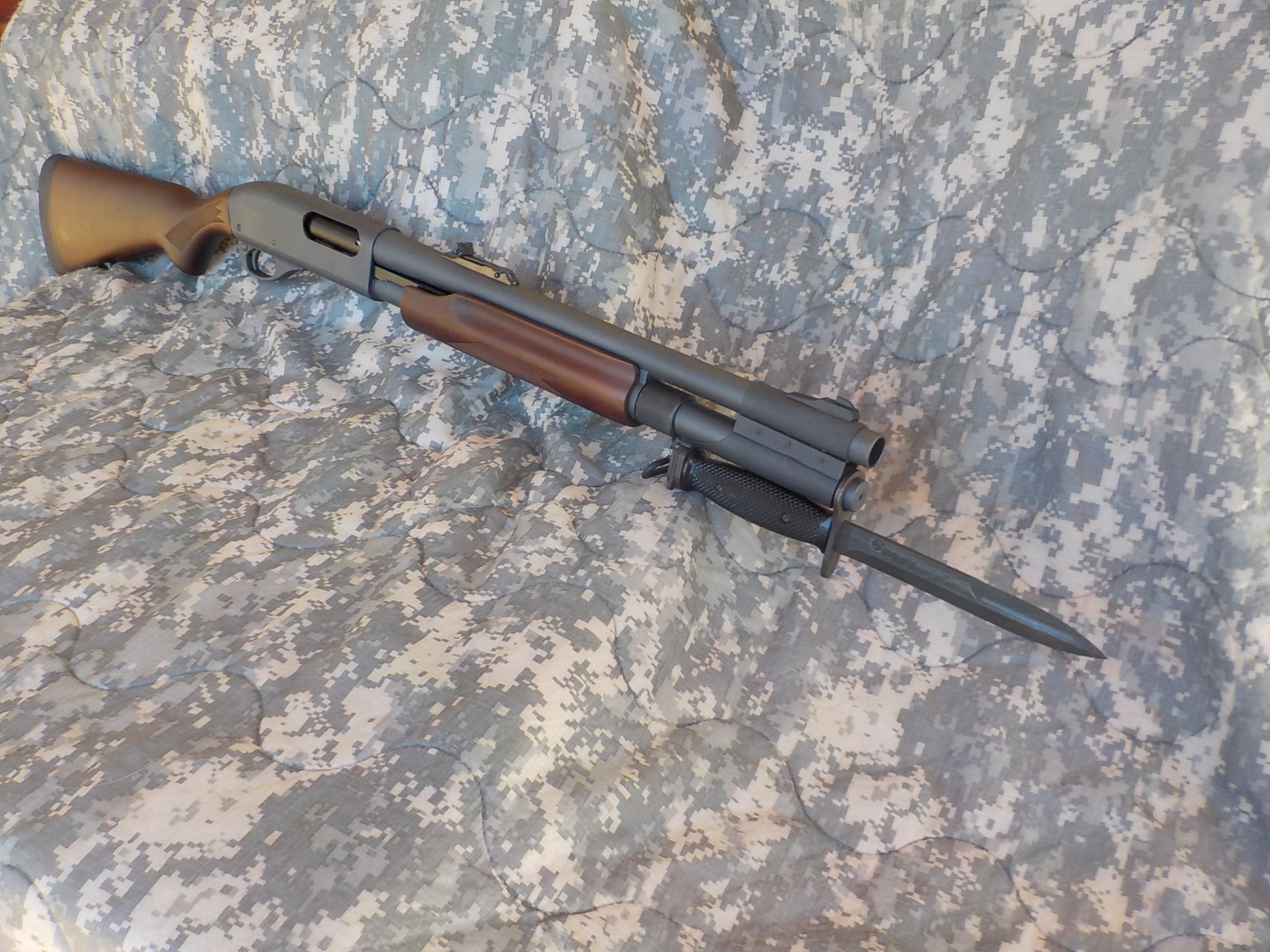

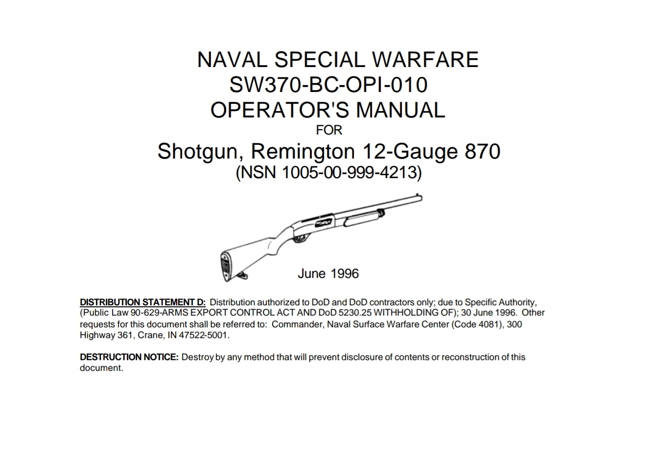

    I just bought an 870, the sights, and a mag tube in the last hour. When I get the gun I'll spec the dimensions for the steel I need to buy. I don't think you can find a mag clamp/bayonet assembly...if you can find one for $500, buy it!. I'm not sure your slug barrel has the same barrel diameter as the "Wingmaster" barrel. Let me make mine first, I think I can do it, the only question is how much it will cost. As a hobbyist, I don't buy materials in bulk so the tubing, in 2 foot lengths, cost me an arm and a leg. Maybe I'll buy some 4 foot lengths and make a couple of these to sell. Like you said, it appears to be stampings and they are screwed together, no riveted, as I first thought. Stampings are great for mass production but not really economically feasible for small production. I'll probably use tubing as I said, which will necessarily be thicker, so I can weld it. The screws are going to be basically cosmetic, and the welds won't be visible, so it will look the same.

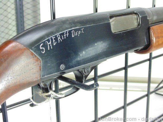

    maybe that was a typo but a 1200 is not the same as the model 12, though both are winchesters.
    if you want to get crazy awesome with your build, ditch the pump and go with a Winchester Super X 1, arguably one of the finest auto shotguns ever made, discontinued because it was too good and way too expensive to make.

    @buffalowinter
    The Merry Shotgun Fairy provided this....
    us3445951-1-png.7757963
    Note in the final construct they used three screws and the middle one is slightly lower in line to catch in the groove of the extended magazine and locate/lock in the adaptor.
    Word is that the bayonet lug is just silver soldered in place on the stamping.
    I think bead sight models didnt include any sort of base just drill/tap the stamping.
    The rifle sight models I assume were drilled/tapped for the front sight base/blade to be screwed on.

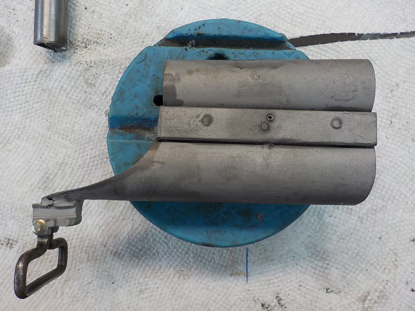

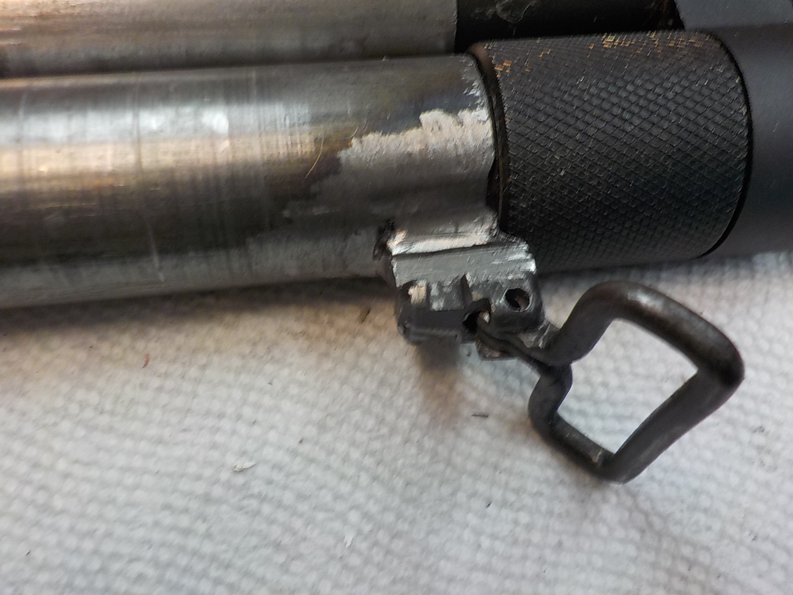

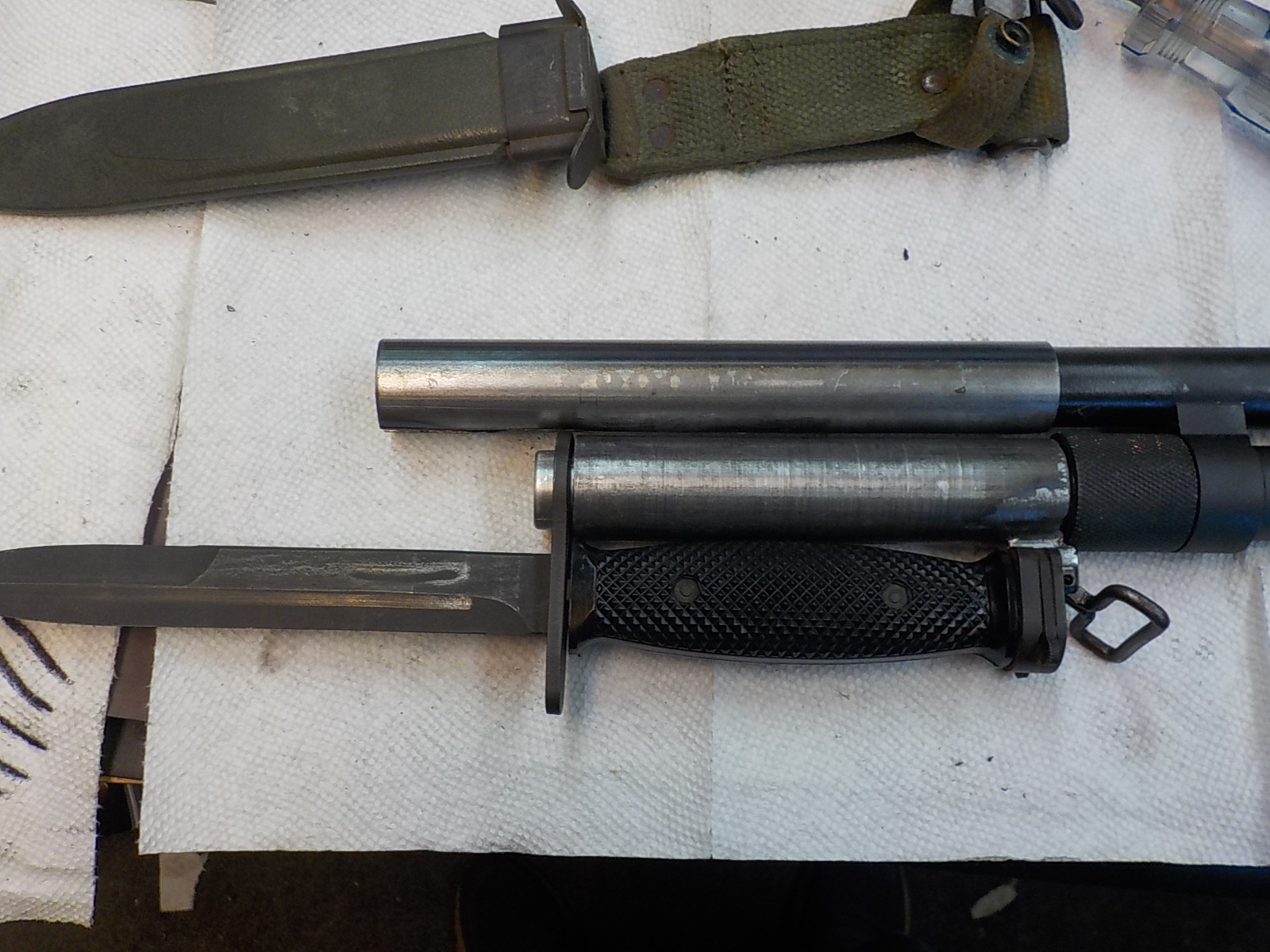

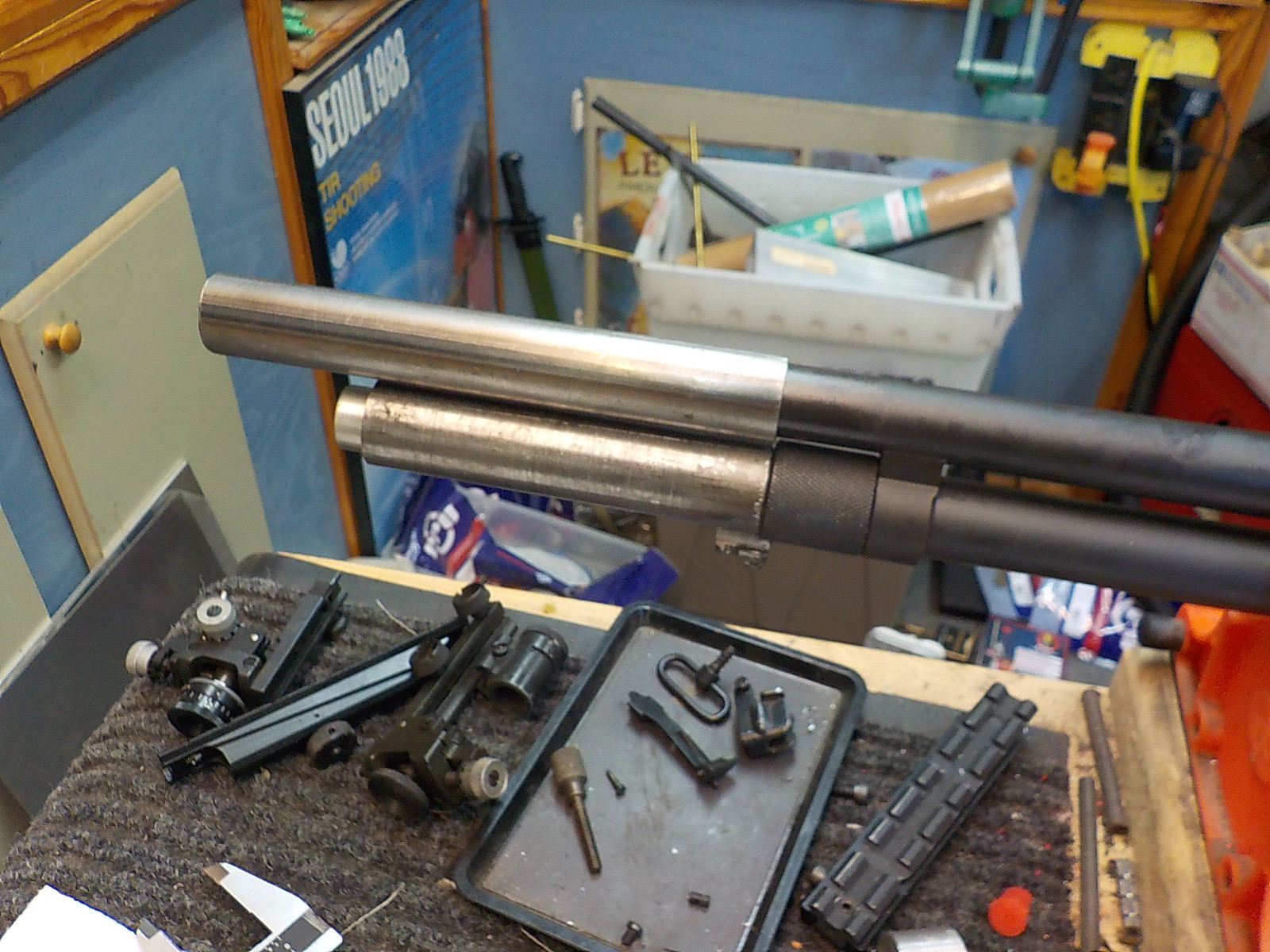

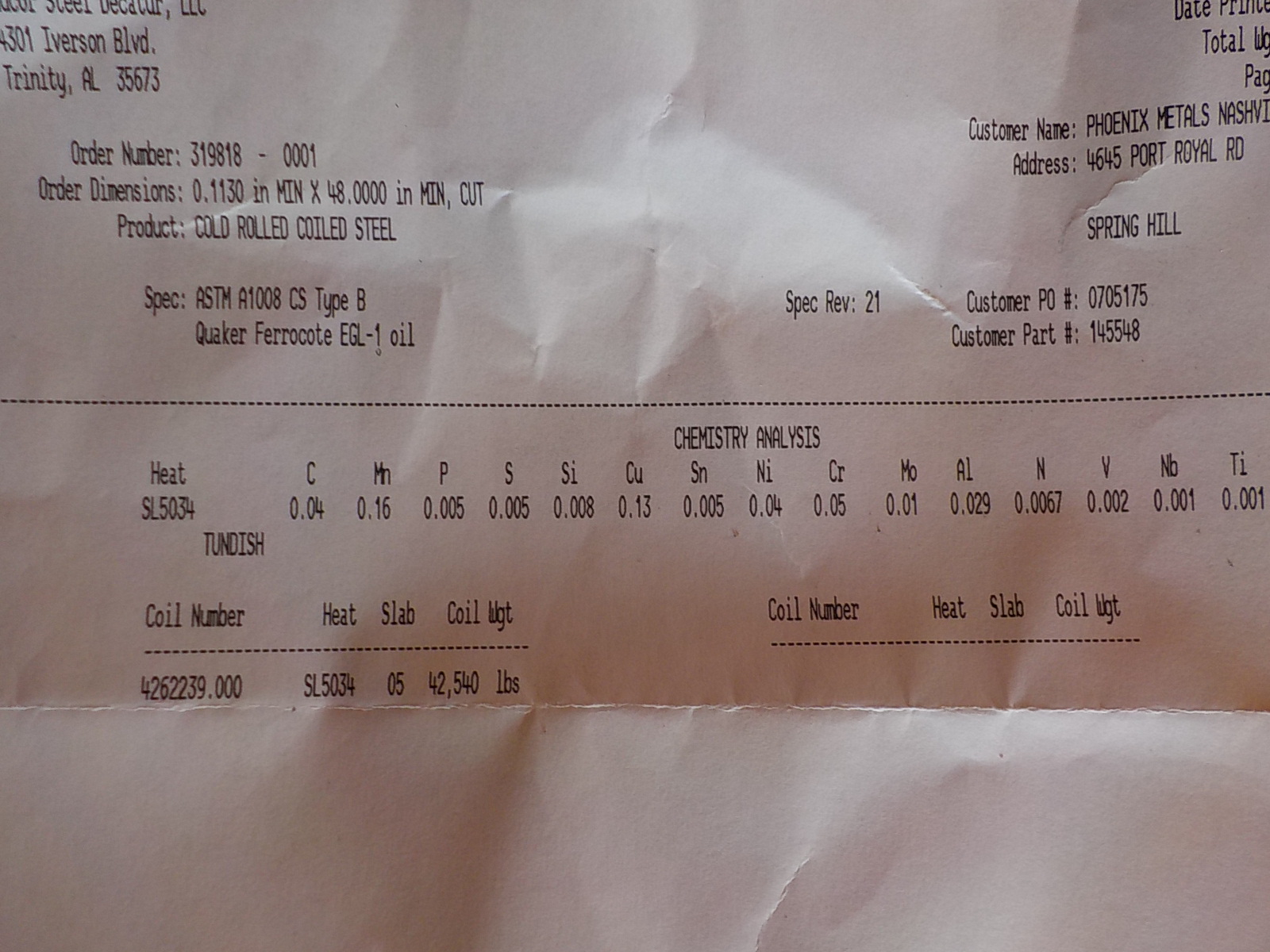

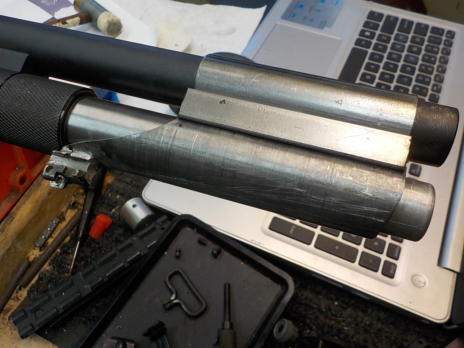

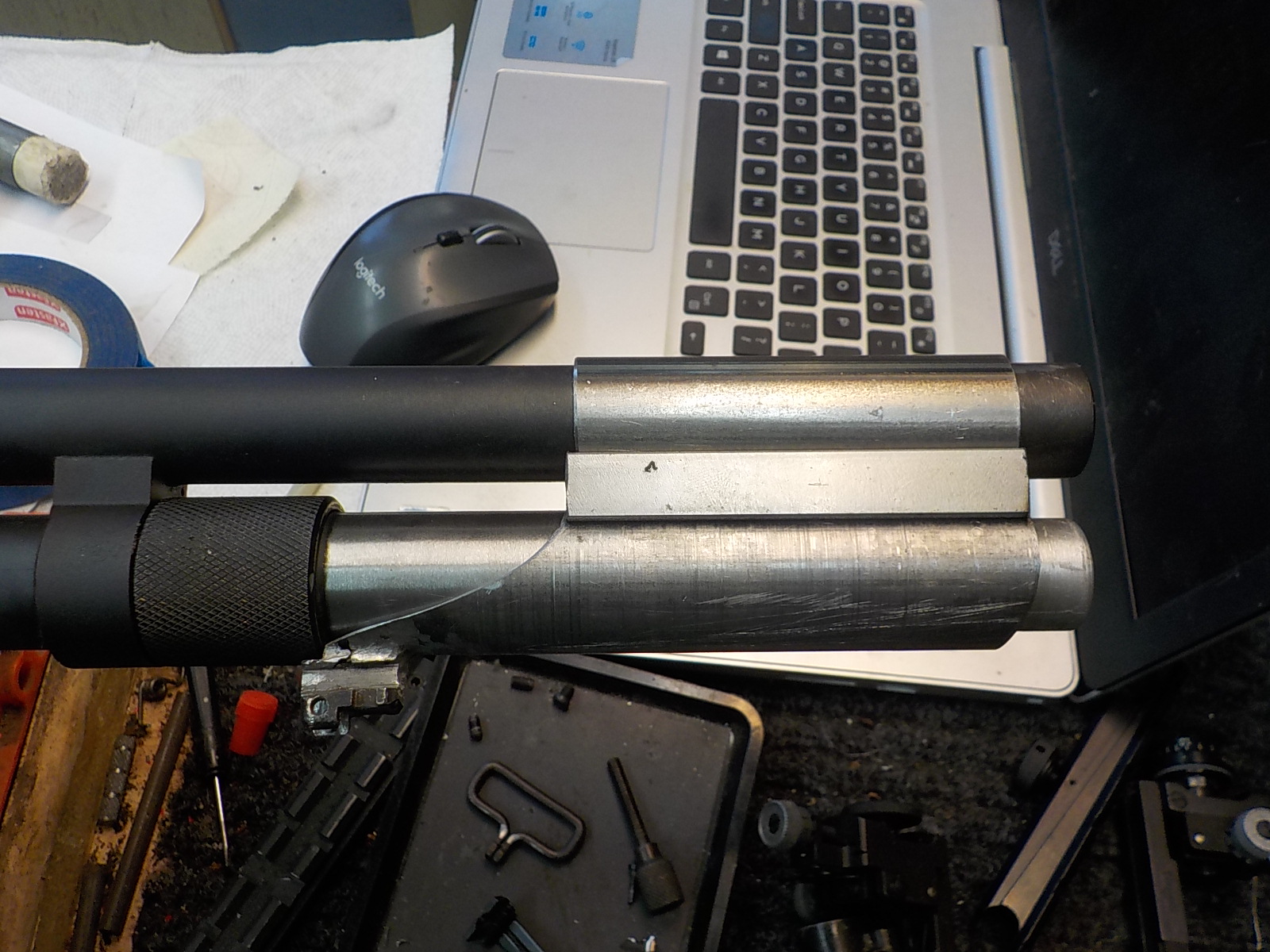

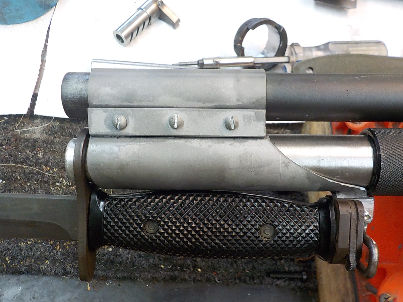

    Progress so far on the 870 bayonet lug adapter.
    Metallugical analysis of the tested/inspected/certified steel I am using. if you're hit by a nuke, this is all that will be left.
    Finished rough shaping and will smooth it all out and put together tomorrow, then on to Cerakote, install front sight and butt sling swivel.

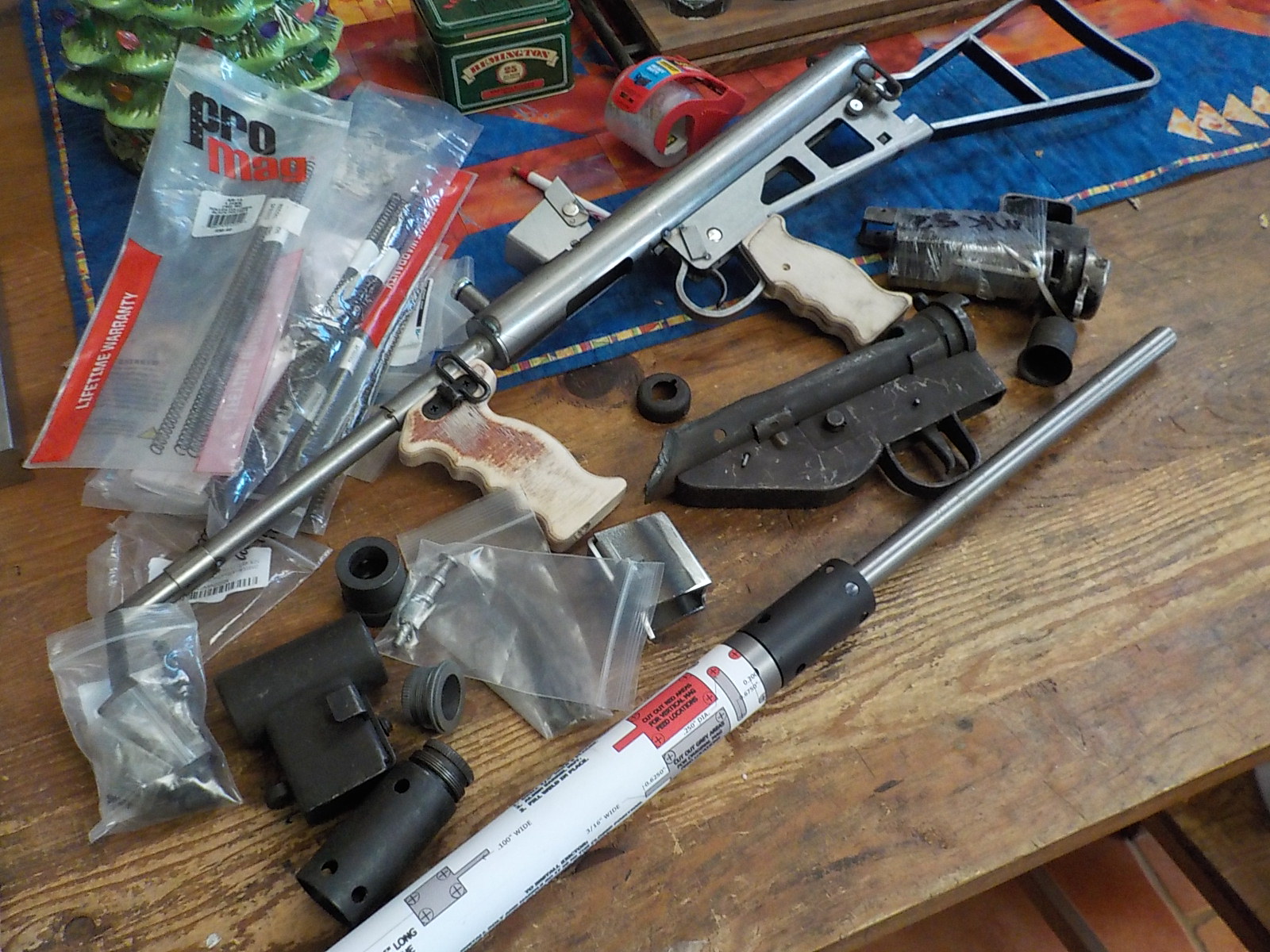

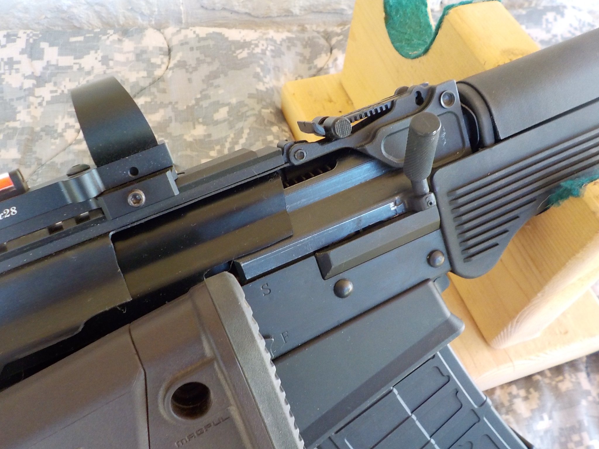

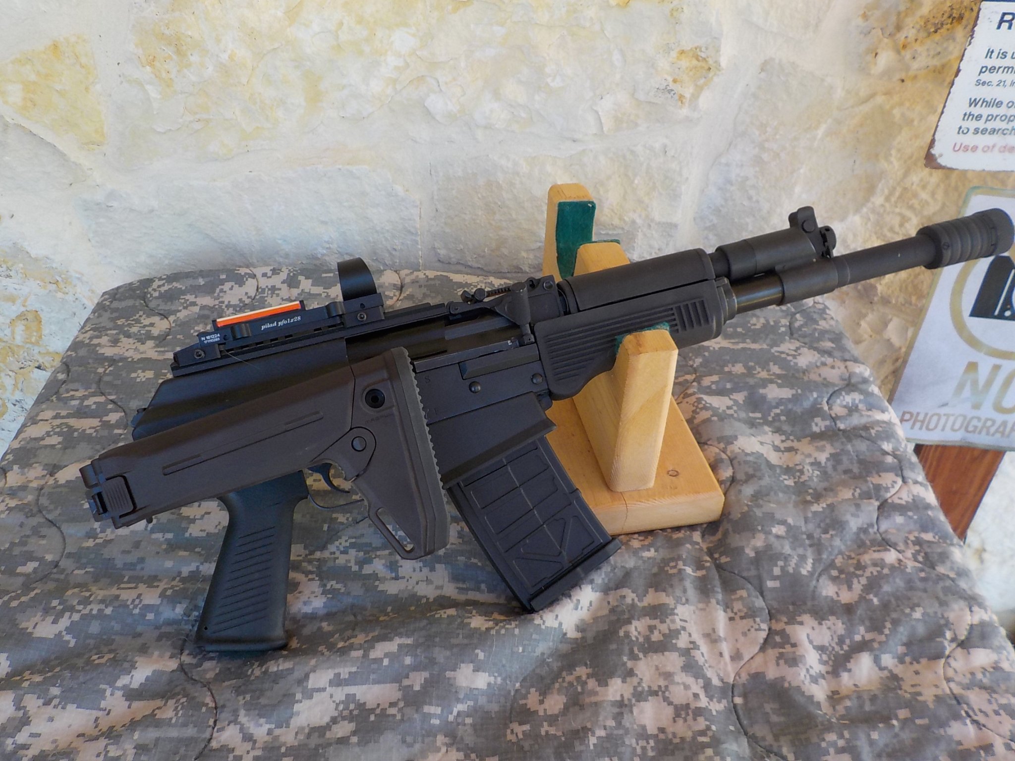

    Moving on to my semi-auto Owen SMG. Totally one-off and just winging it off plans in my head.

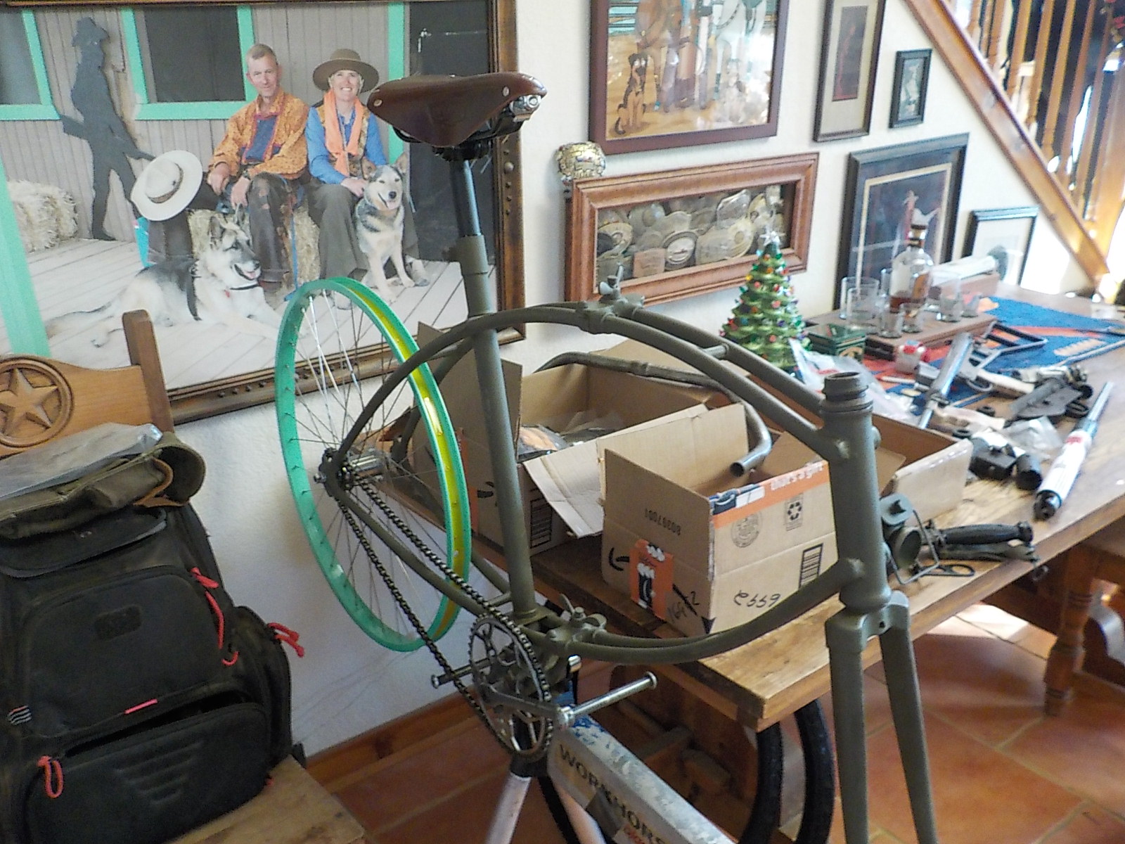

    Also have to work on my British WWII folding Paratrooper bicycle.

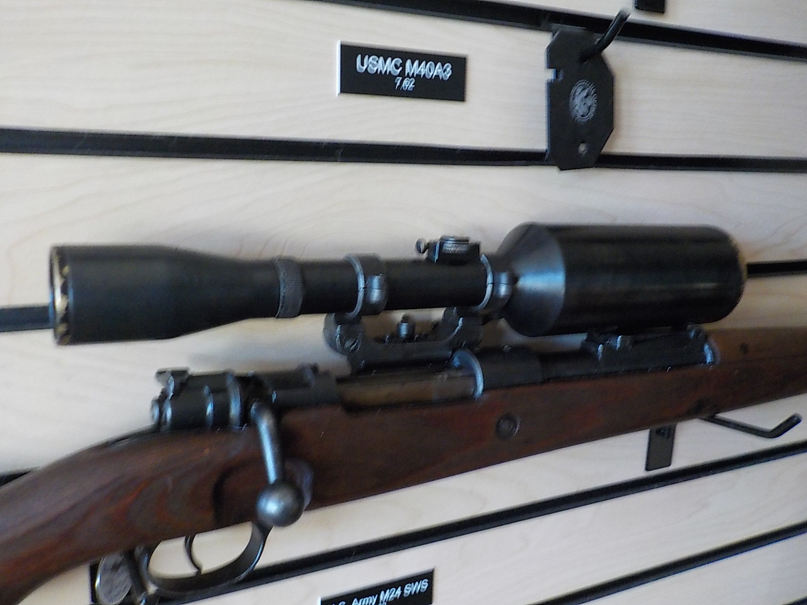

    Just finished putting this cool vintage Oigee 8x scope on a short side rail for my Russian capture DOU Mauser K98
