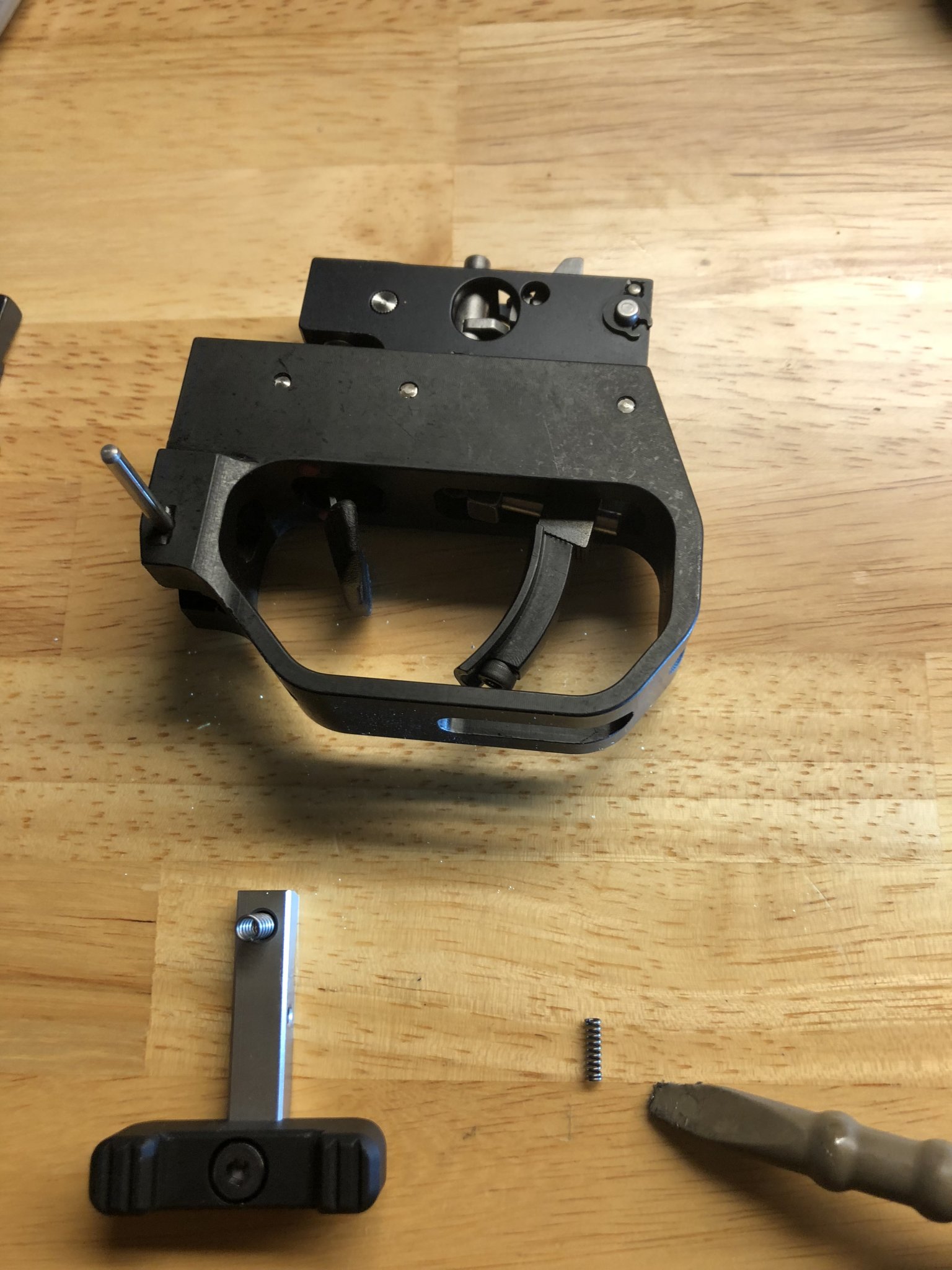

I just installed a KRG catch extender. I have no idea where this small spring came from. It’s not the magazine catch. Everything seems to work fine.
It’s just very unnerving to have extra parts when I simply loosened one captured bolt to remove the trigger housing and pushed over one pin to change out the mag release.

See if the grub screw is still there. Mine was missing and still is. I’m lucky the trigger works a treat and has the best pull I’ve ever had on a TRG. My other one won’t work without it in.
You need to look if it’s in place. It might not be after all I’m only guessing from a photos.
