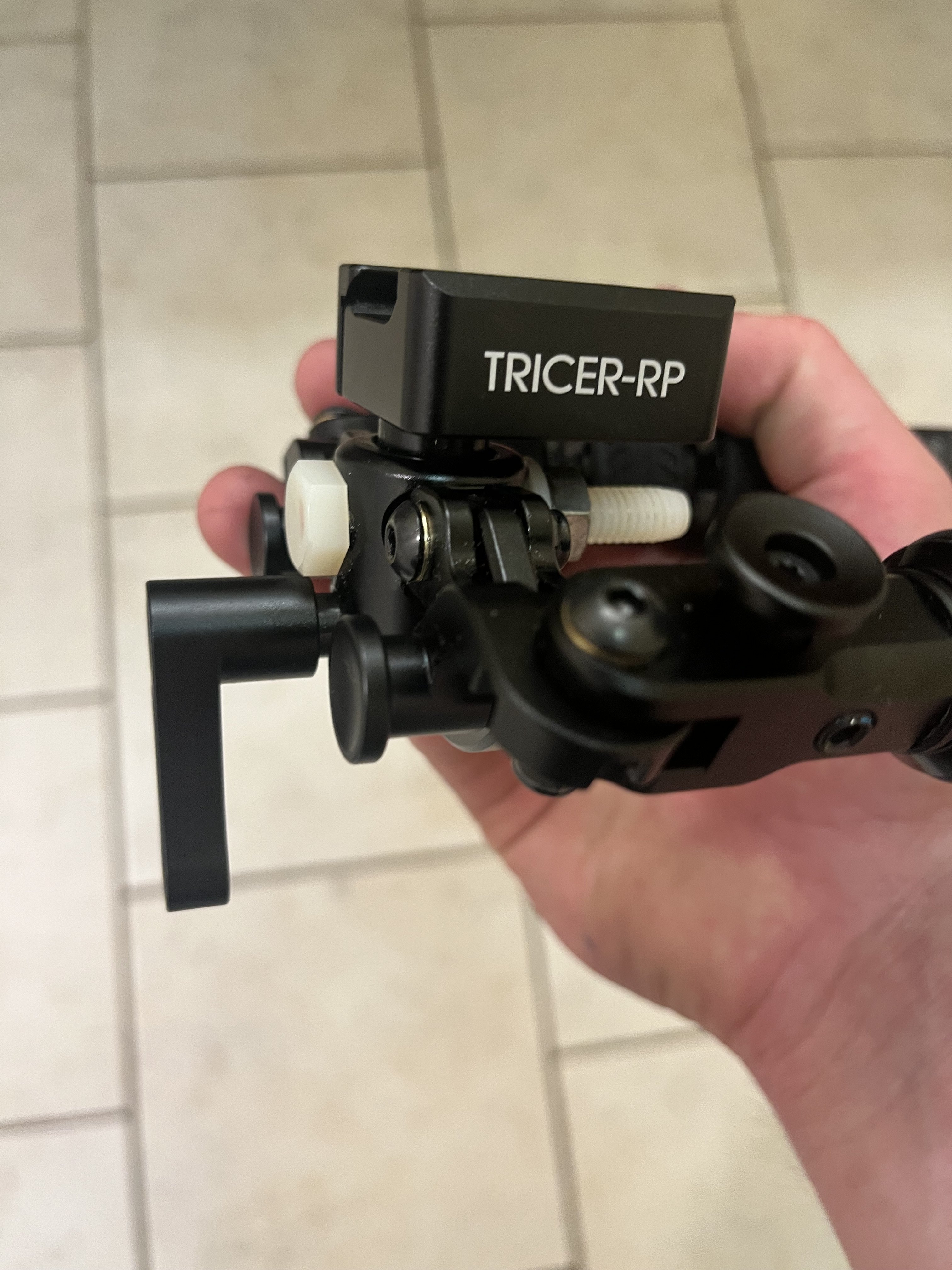

Has anyone seen the new Tricer RP Bipod at any of the shows? If so what are your thoughts on it?
There seems to be a lot of positives and adjustability for the price point - I'm just curious what people think who have seen it in person.

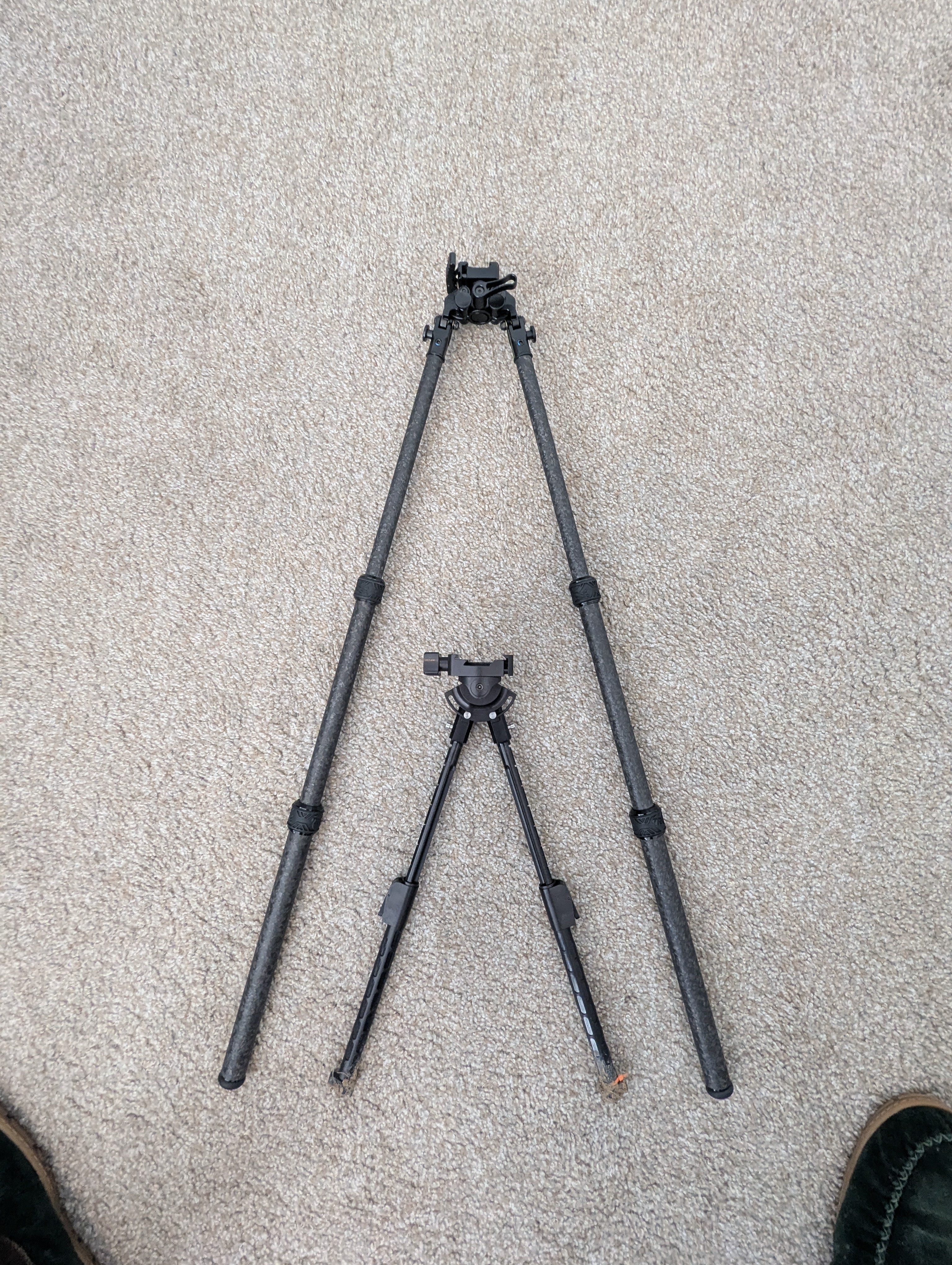

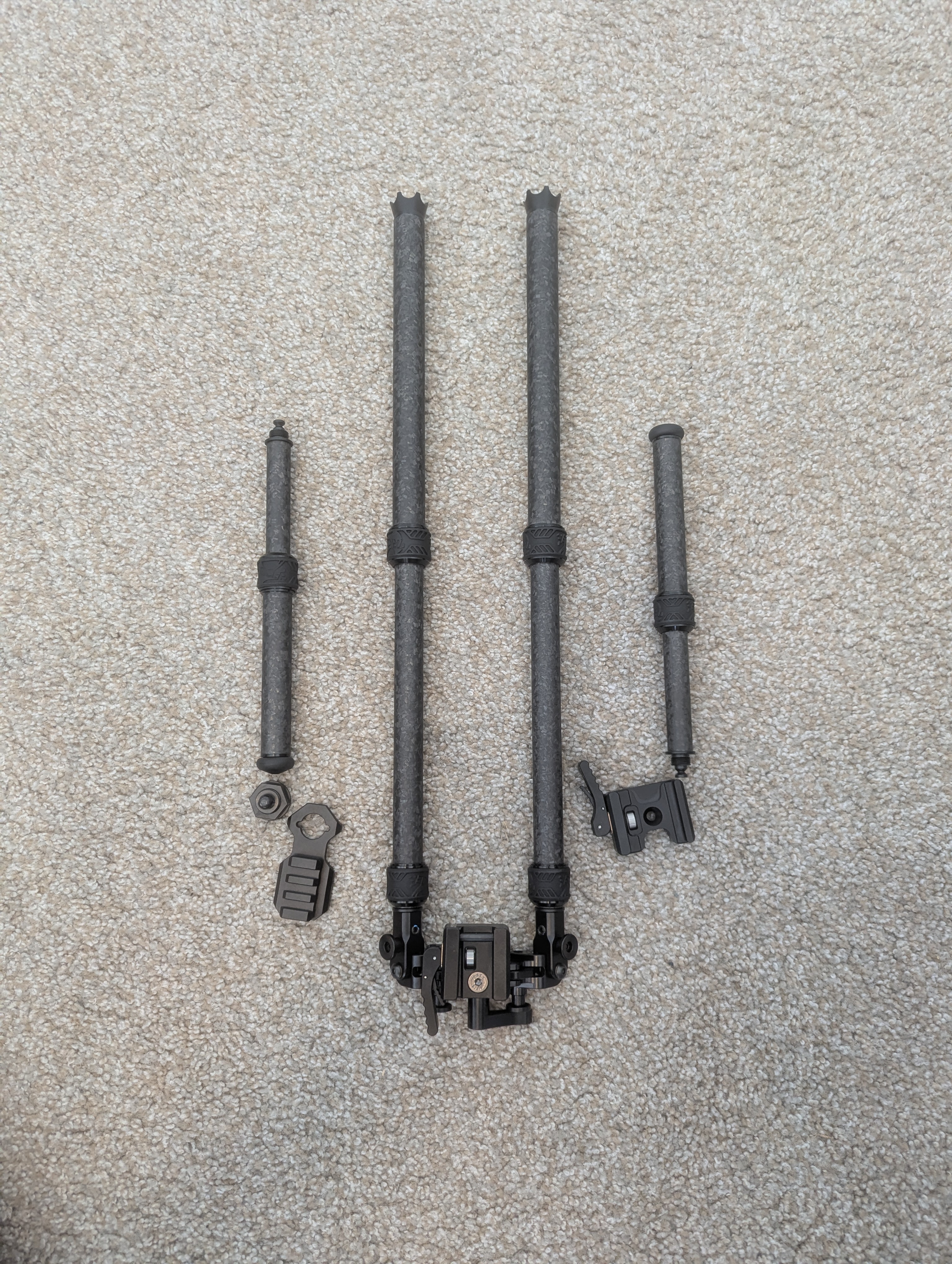

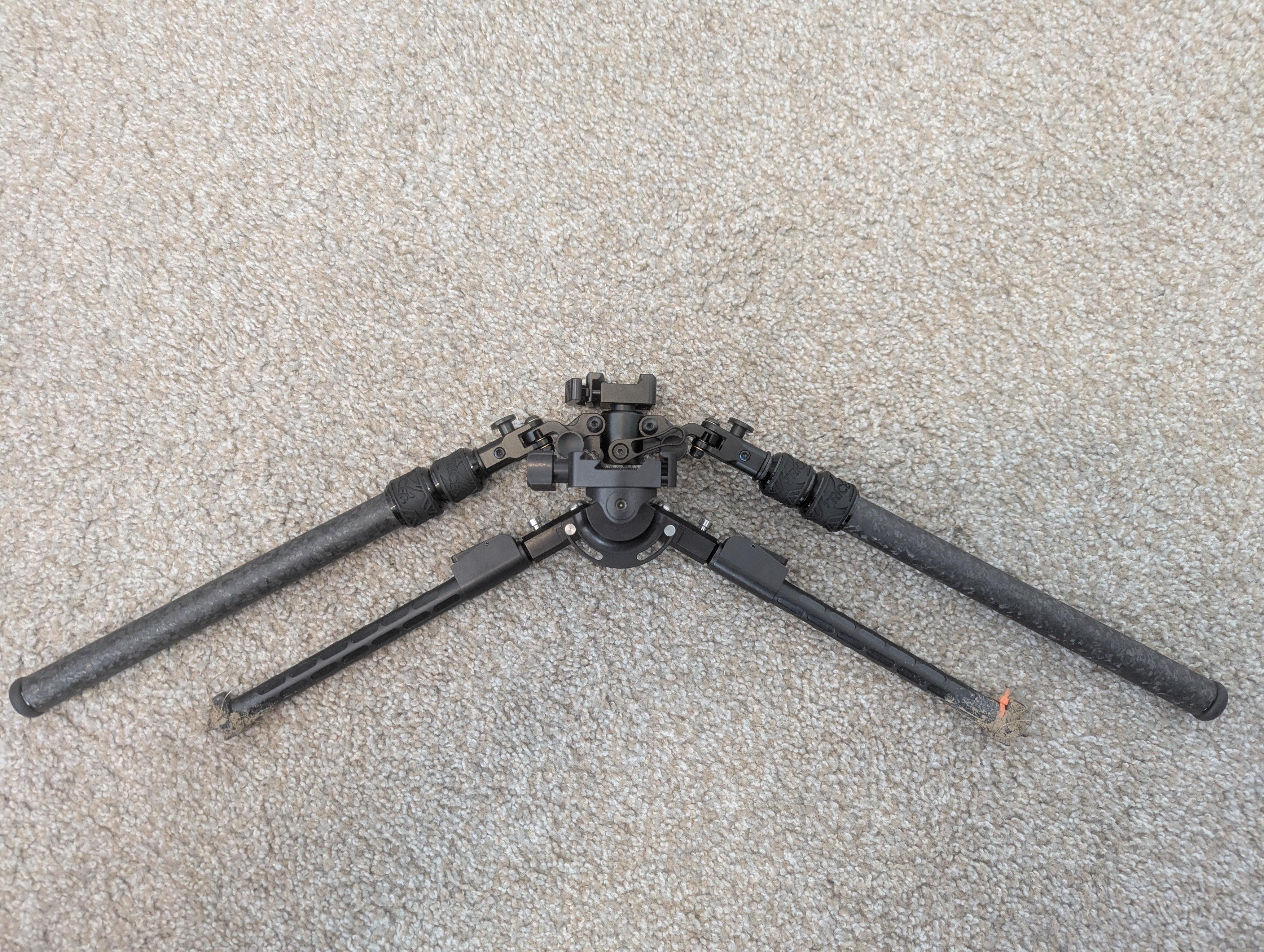

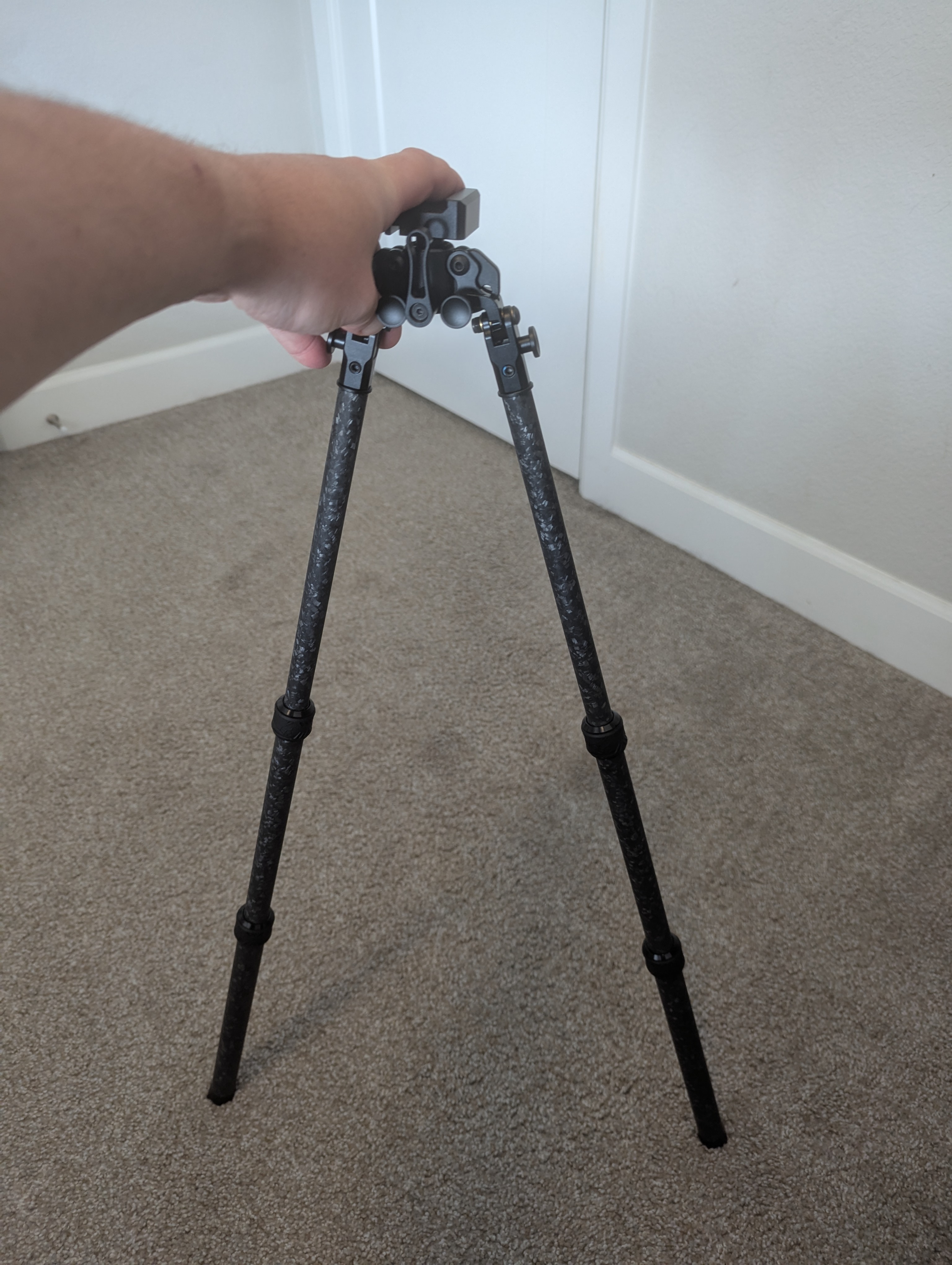

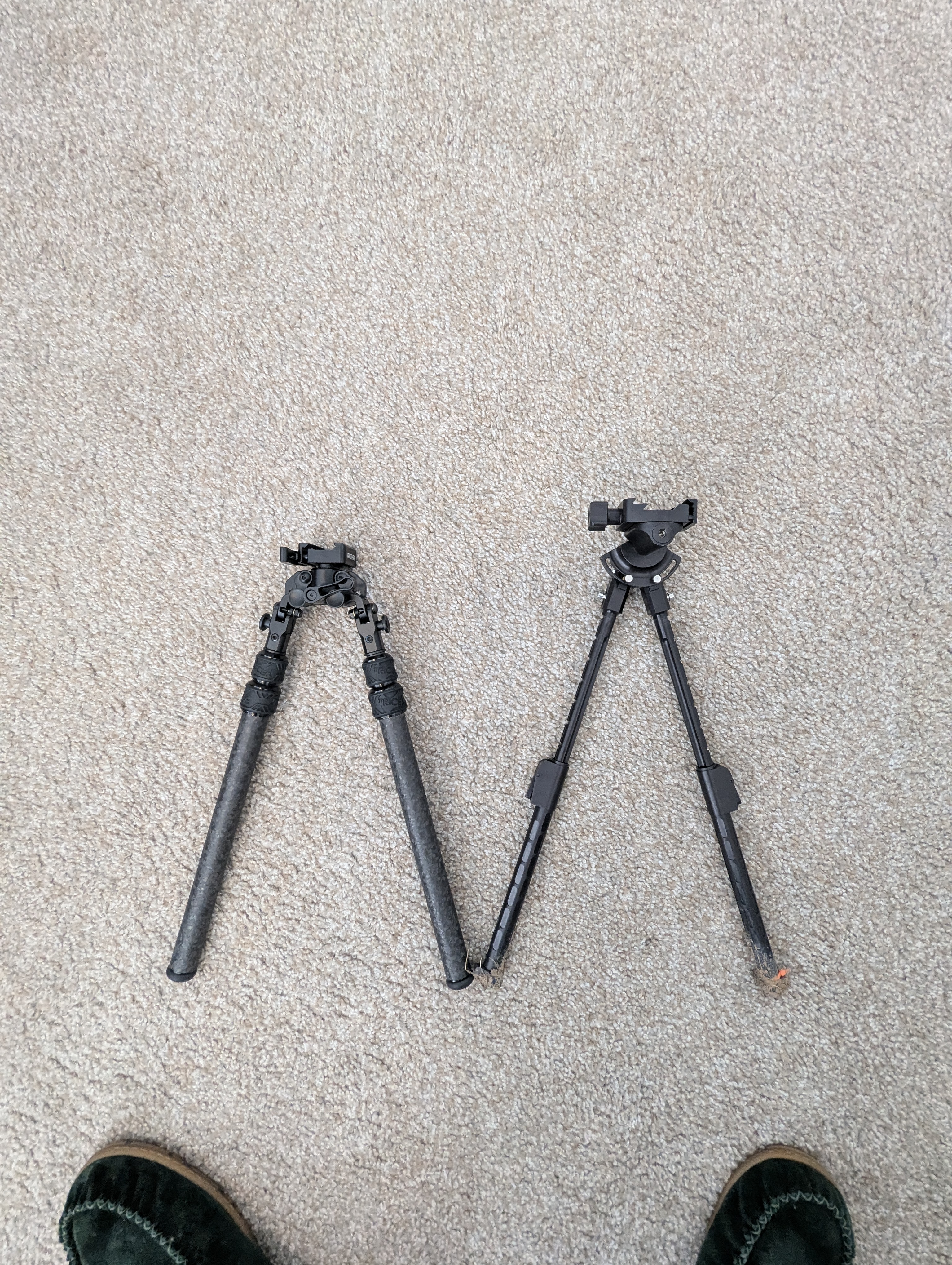

Initial thoughts. Deployment is pretty good. Not Ckyepod fast but it's pretty quick if you're used to a tripod. The splay options are easy to use and there are 4 settings.
The pan/cant ball lock seems rock solid without a rifle on it, once a rifle is mounted I could see this possibly being a pain - my ckyepod light has a hard time perfectly locking cant out so it's possibly a wash.
The weight with the long legs is lighter than my lightweight single pull - that's a huge benefit for NRL folks.
The pic rail adapter for a sling stud is stupid easy to use and a nice addition to the package.
Weight shows up at 15.35oz on my scale with either the pic or arca head and either set of feet mounted on the long legs. Both arca / pic heads weight in at 1.85oz
More to come after I can actually mount it up and shoot off it. For the price of it, this will be a hard bipod for most people to beat.
