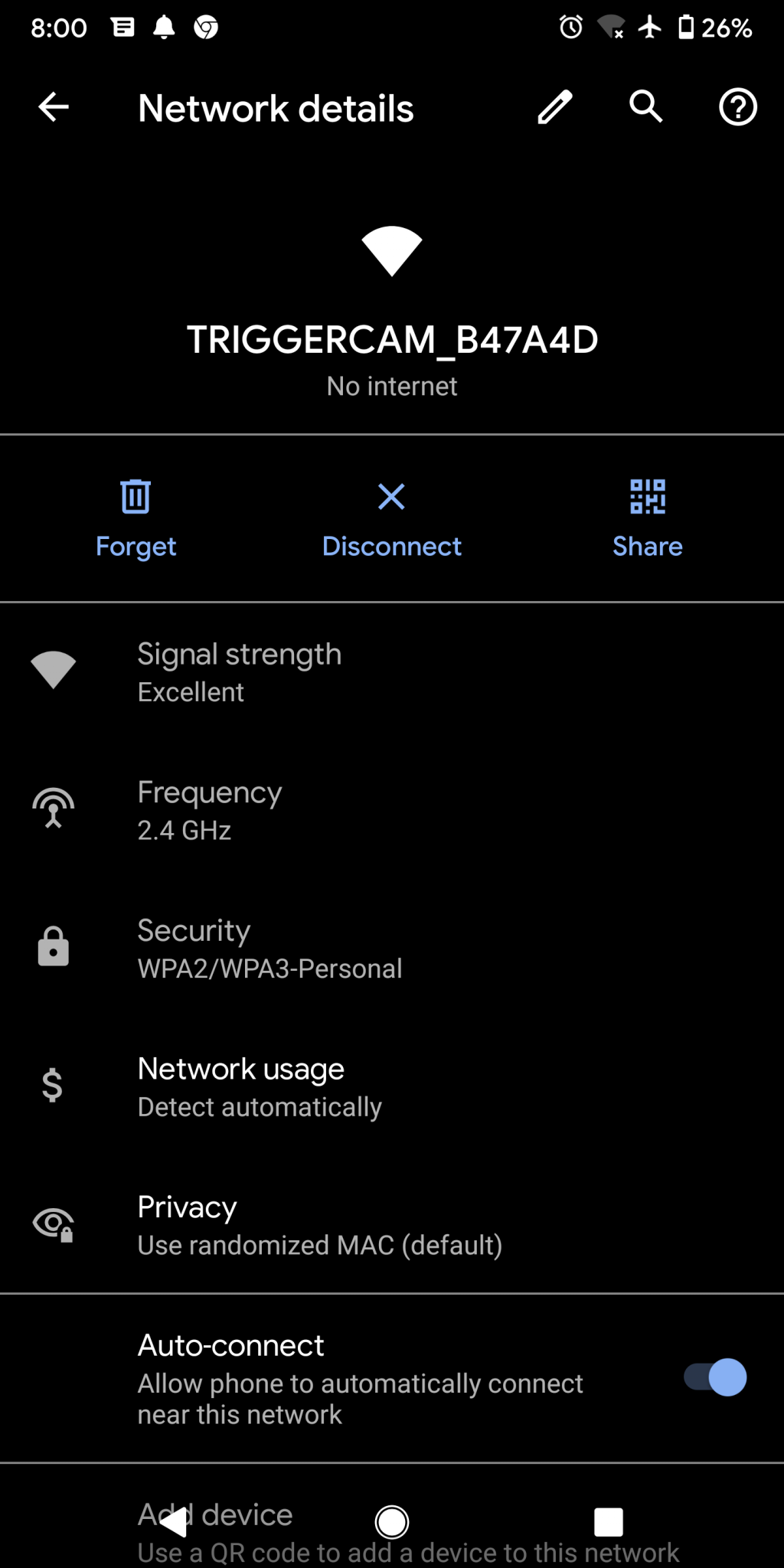

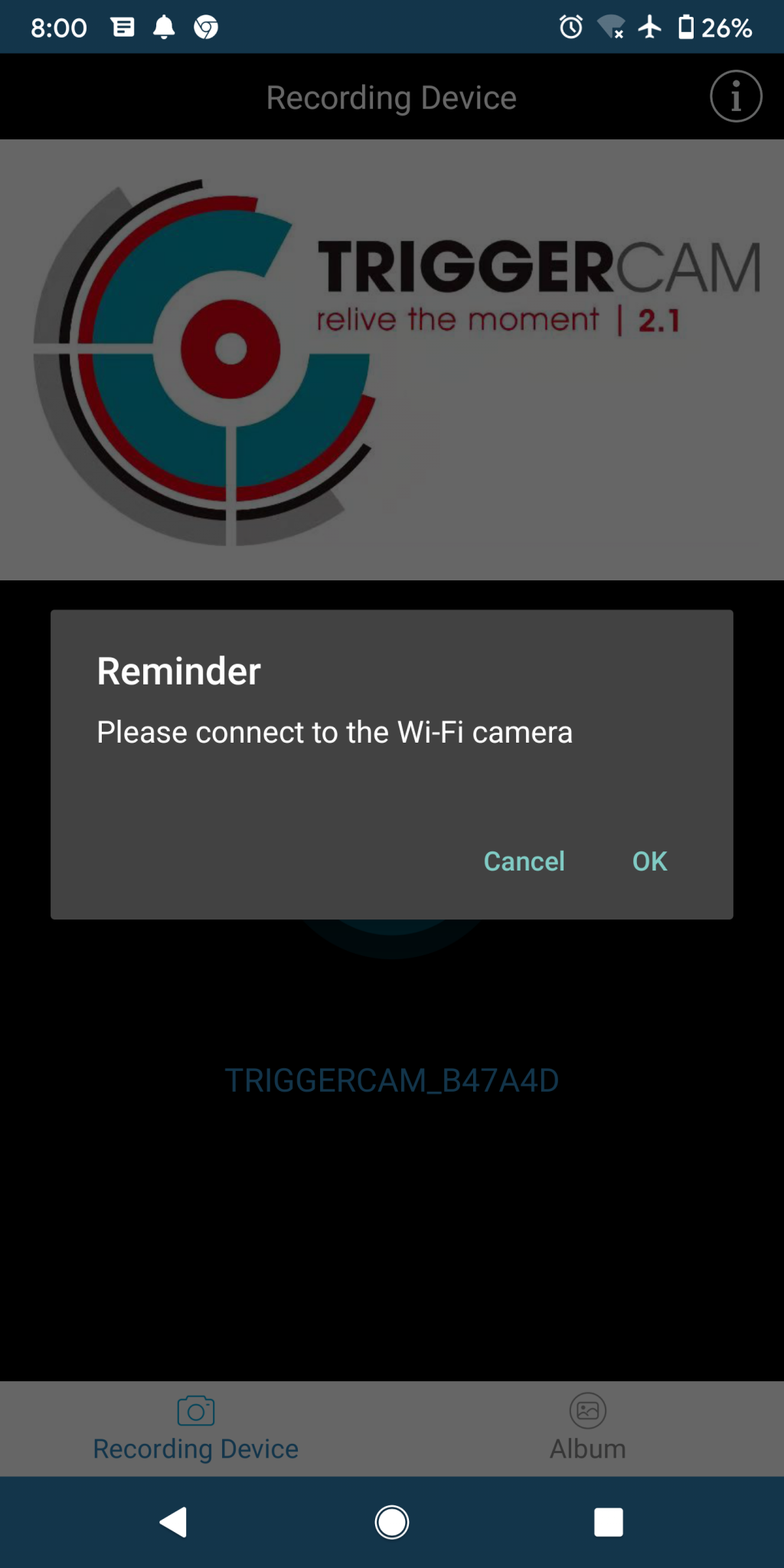

So disconnect from my house WiFi. I disconnected from it and connected the TC. But it says no internet connection.
Also says to connect to camera on the app.

Did that. That's not what my issue is.
The camera should act as a wifi access point, it won't have internet so your phone is going to bark about that.
It is sounding like the app needs the right permissions set for it. Look under the application settings and enable all that it needs, likely: location and storage.
If phone is being really stupid about it enable airplane mode then turn on WiFi and try to connect to the camera.

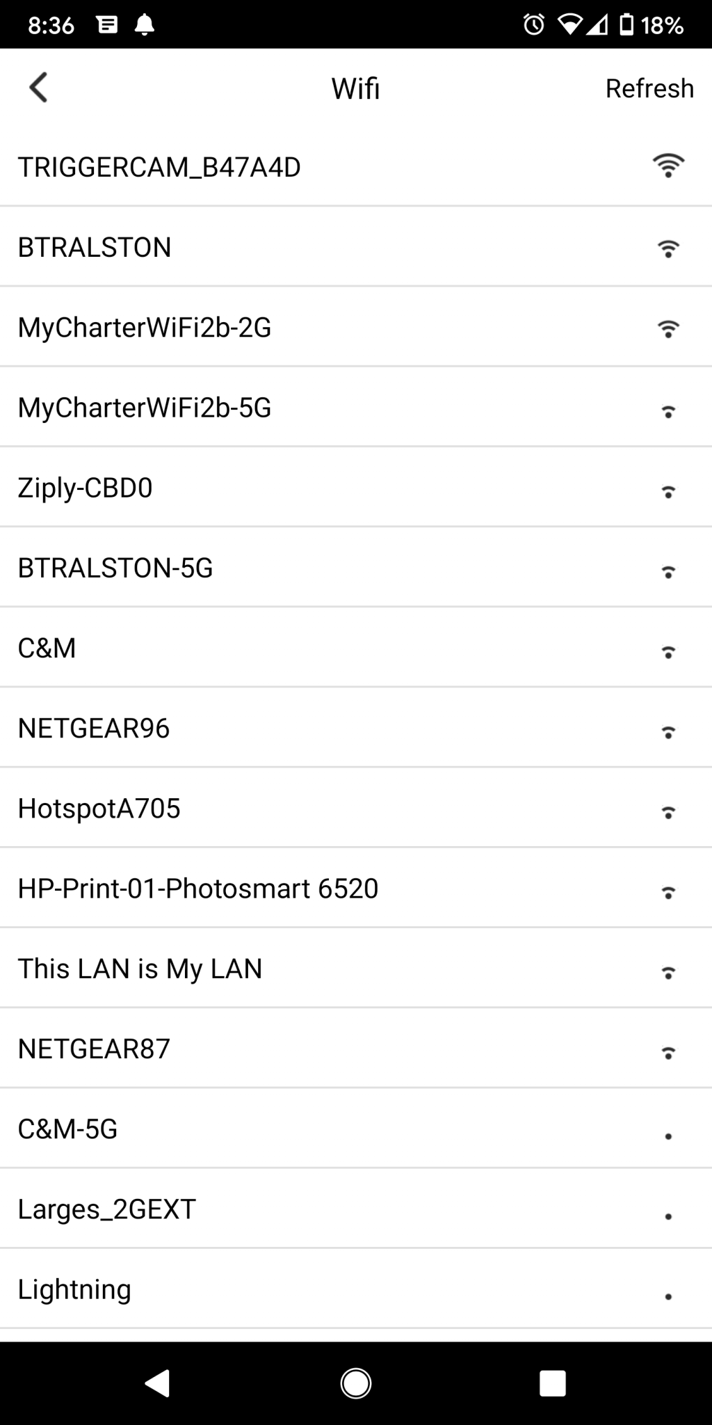

I have one. So with the trigger cam on, you can select it under your wifi correct? it will say no internet connection but should connect through the app. Are you not able to see it in the app?
Is showing you are connected to the trigger cam's radio for your network. Are the permissions for the app enabled?

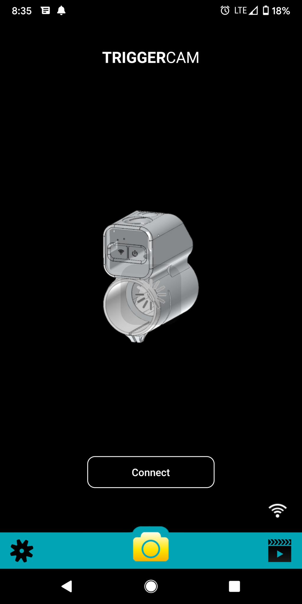

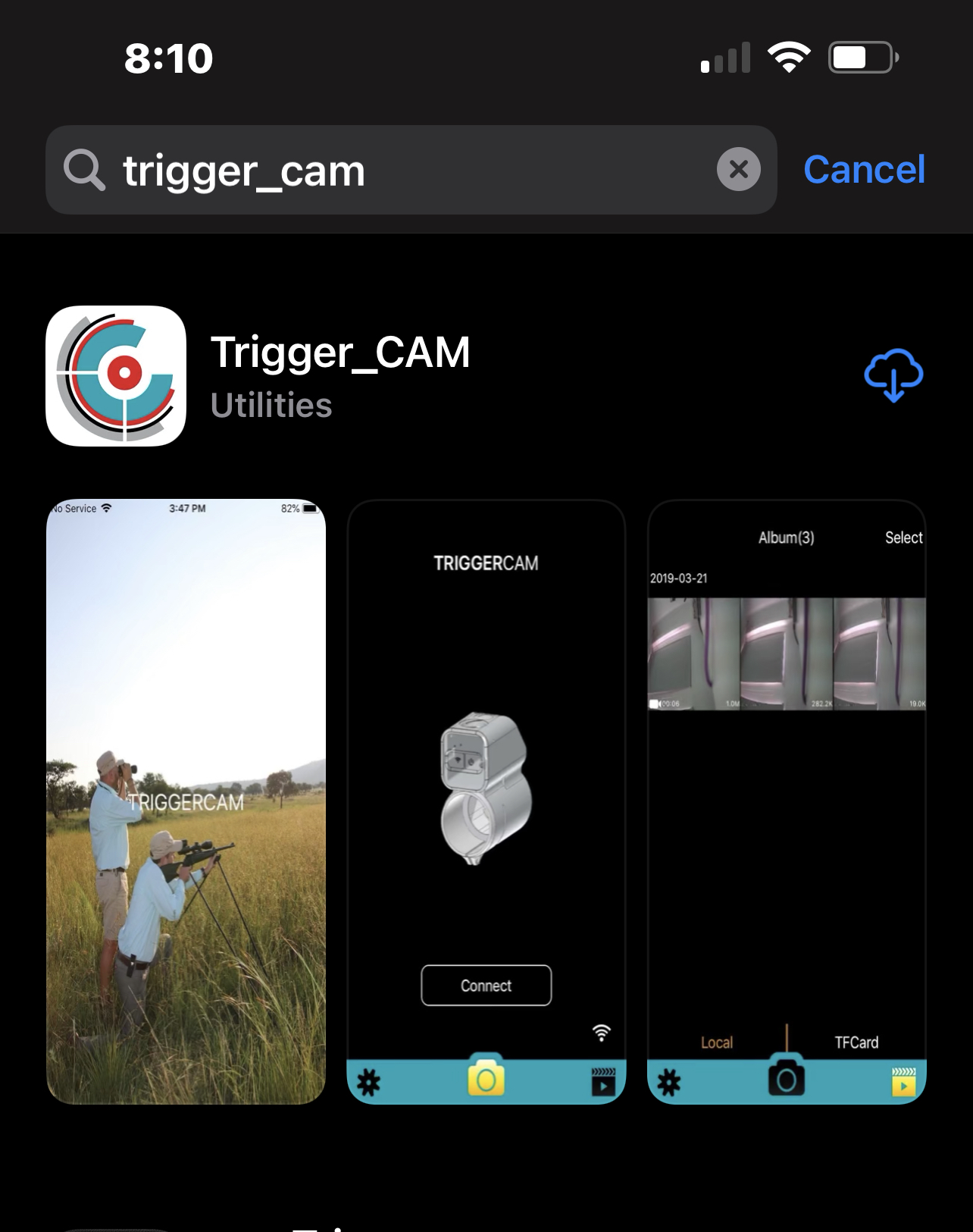

Is it a trigger cam 2.1? I know there is a different app for just the trigger cam.
I have tried both apps. This isn't the 2.1 cam. The other app I see is the BSP app. Bow, shotgun pistol app. But I tried it as well with the same results.
Is this the other app you tried?
There is an apk for the V1 from the maker:
Since it is a non-store install you likely will have to disable a security setting to allow un-trusted sources for apps to install it.
Be sure to turn the setting back on once are done installing that.
