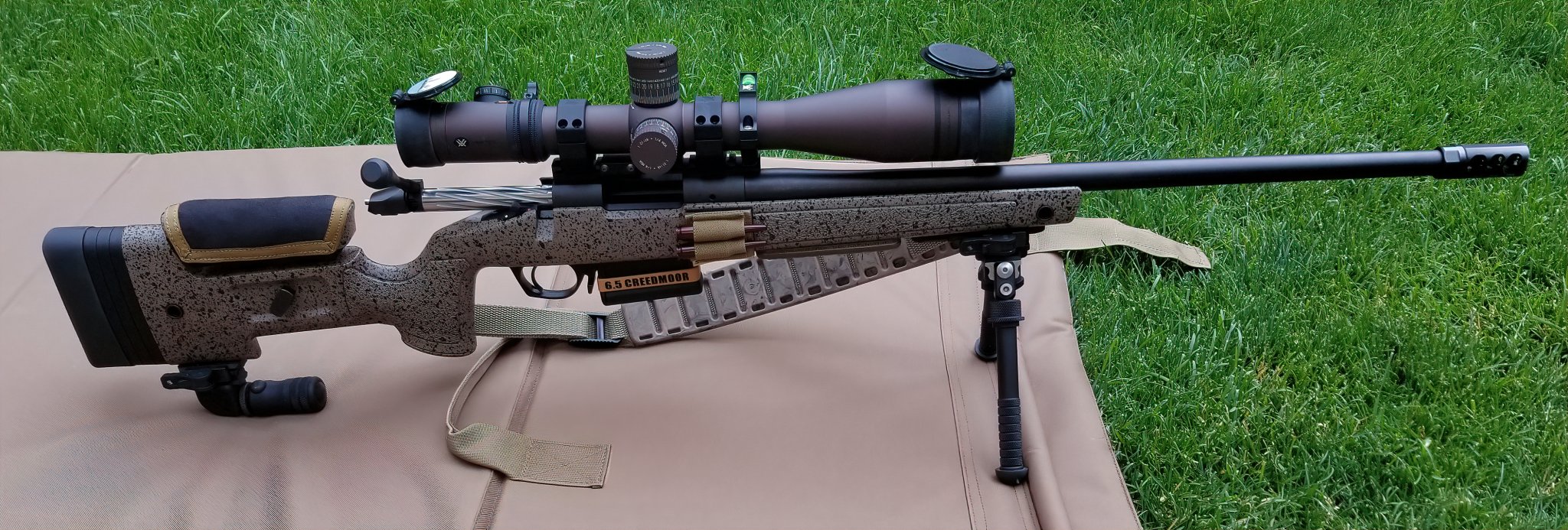

I swapped my B14 HMR factory trigger out for a TrggerTech Special and set it to 2.8 lbs., felt a whole lot lighter than the factory trigger, no more creep, broke like glass. I recently also swapped out the bolt to a Bergara Premier Short Action bolt for the lighter firing pin and spring, the gas shield, beefier shroud, and fluting which is great for dry, dusty areas; now the TriggerTech Special has me grinning from ear to ear every time one of my buddies shoots my HMR - it's fun to watch when the lights come on and the first thing I hear is "I've got to get me one of these!"
