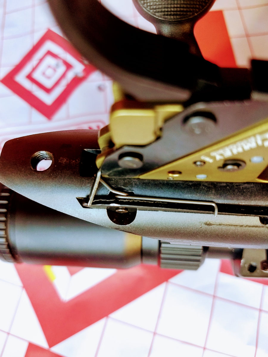

I purchased a used Timney trigger here at the hide and not knowing to much about triggers it arrived but does not have a bolt release like my rem 700 has .How do you remove the bolt or is it going to pull out every time I open it up to extract a round?
Thanks Rick

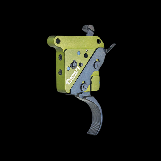

The bolt isn't going to come out when you cycle a round because the bolt stop and bolt stop spring are held in place by the trigger pins. What your trigger is lacking is the assembly on the side of the trigger that lifts up the tail end of the bolt stop and allows the bolt to be removed from the action. It looks like this:
So even without that tab there on the side of the trigger, the spring pressure will keep the bolt stop engaged but I'd contact Timney and see if they can add the bolt release to the side of your trigger.

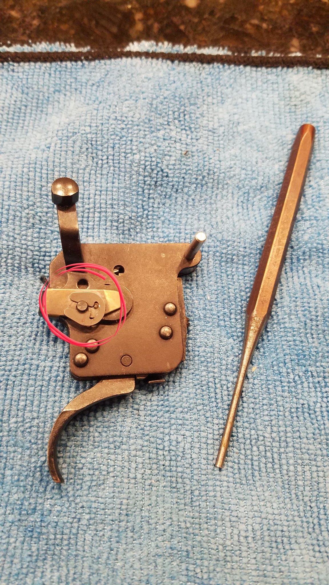

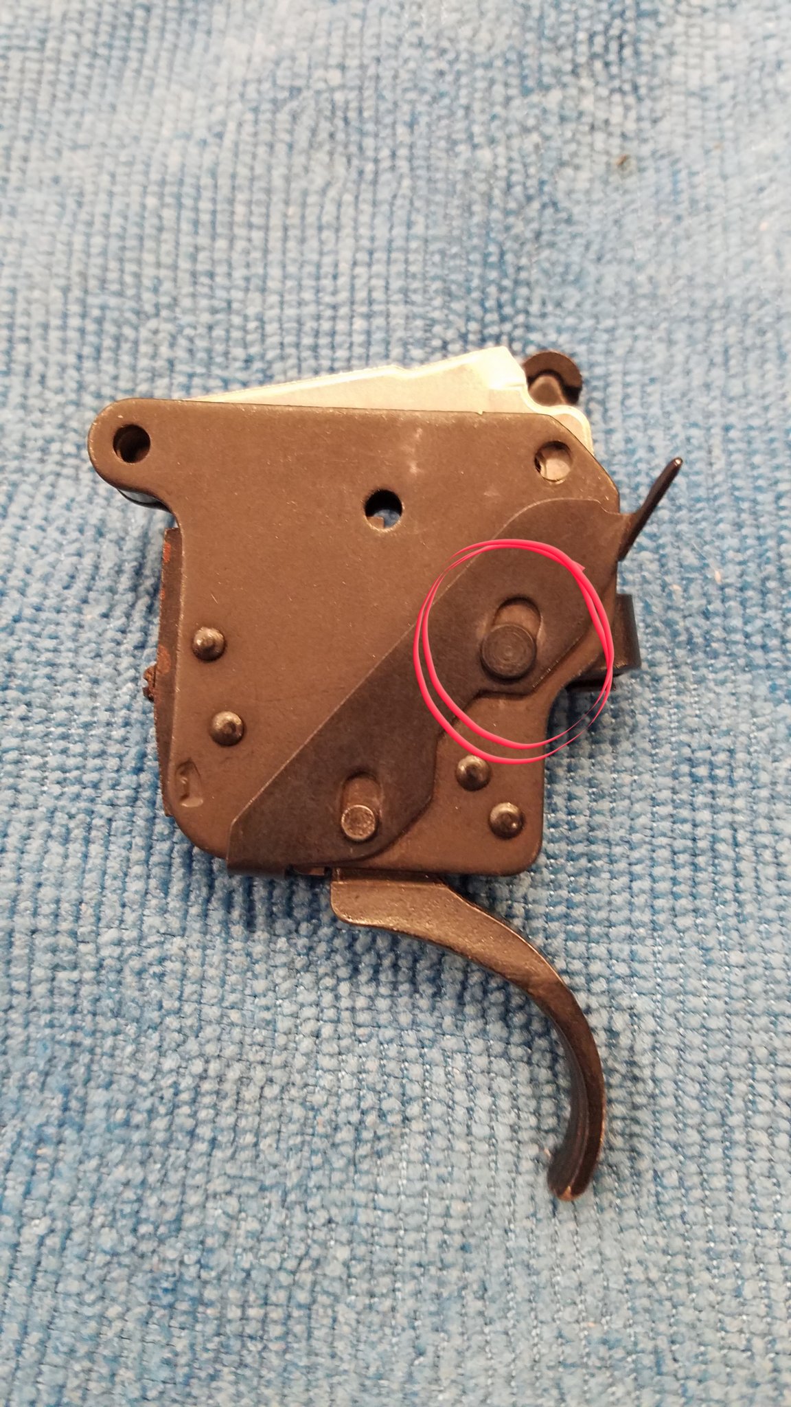

I just installed a Timney last week.
I got it without a bolt release.
Took the one off of my Rem Walker trigger and installed it on the Timney.
Your Timney should have a removable button head screw on the left side.
The Rem trigger bolt release is held in place by a pin and a guide stud.
The pin is held in place by a C clip on the right side.
Remove the C clip and use a small punch (or nail) to push the pin out.
Pull the bolt release away from the trigger assembly.
Push the old pin back into place displacing the punch or nail and reinstall the C clip.
Install the bolt release on your Timney.
Don't overtighten the screw or it will bind the bolt release.
The entire job takes less time than it did for me to walk out to the garage and grab the trigger and punch...
