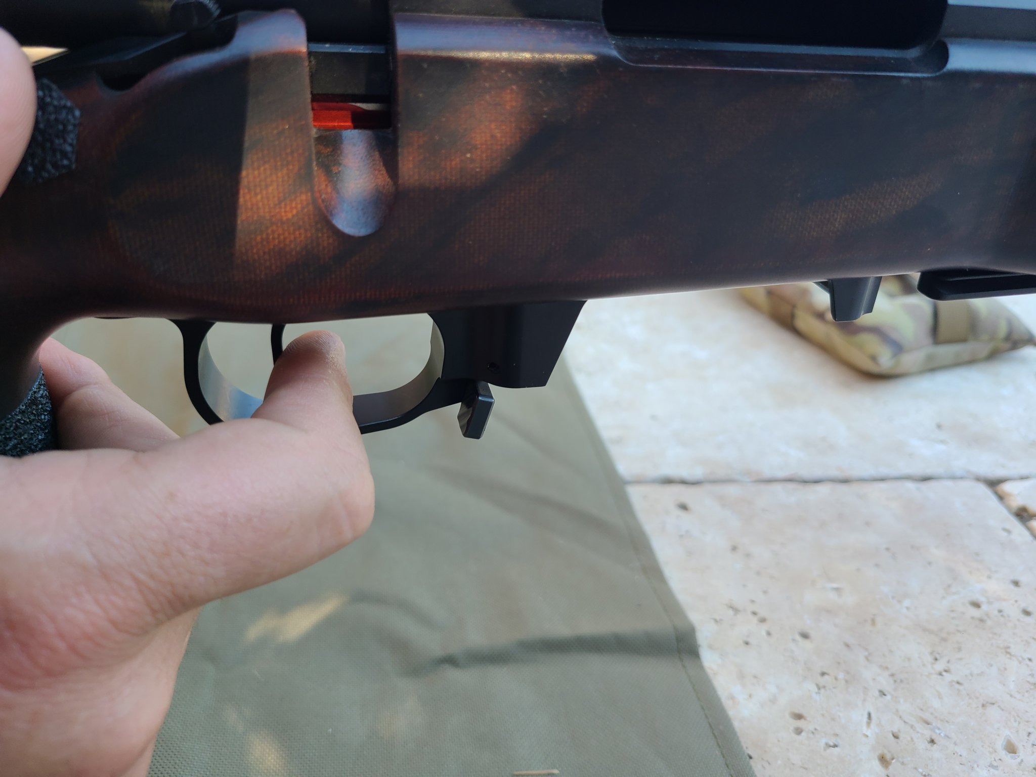

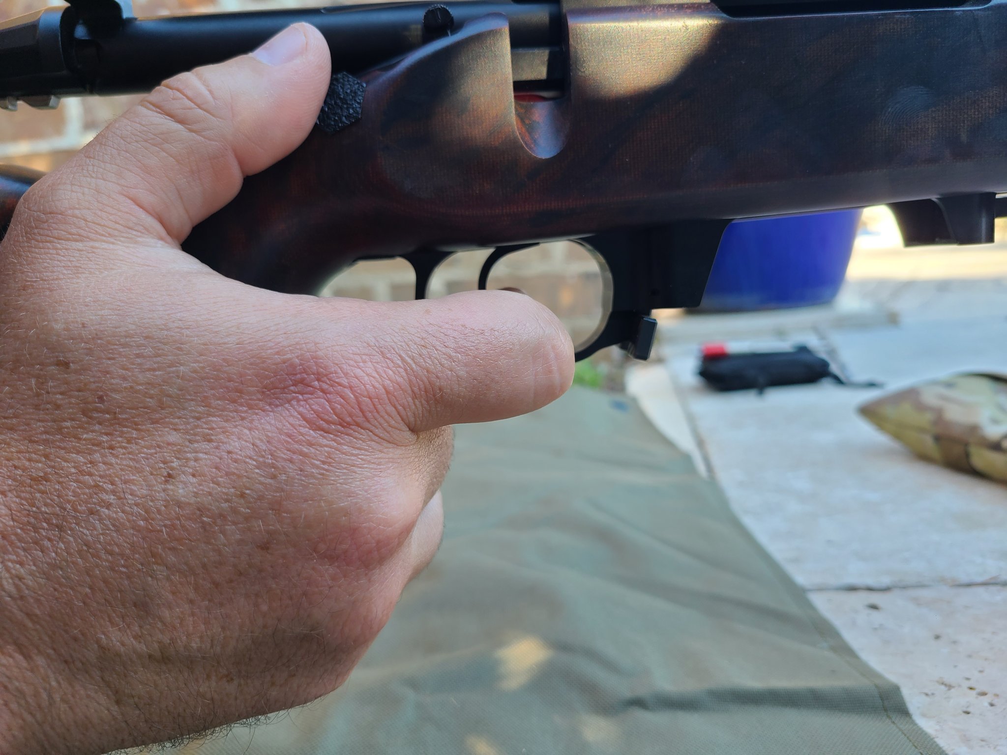

Im having some trigger pull issues and trying to solve them. I have been dry firing to help correct hand placement and follow through, but want to make sure I practice correctly.
Ive seen @lowlight preach that angles matter and that my finger needs to be at 90deg, however I cannot seem to find a way to get all the way there. Here are some pics. Its a bit hard to tell but trigger shoe is half way between tip of finger and 1st joint. Any advice?
Also why do you think it's a trigger pull issue? I'm not saying otherwise simply asking.

need more tension on your grip (thee-finger) pull to flatten shape in you hand,
as noted above, check your length of pull to make sure its sorted

Ha. One, was told that at a JTAC class last summer and two, struggle to shoot good groups. Been thinking it was rifle, but let my buddy thats better than me shoot it and he buried 3 in the same hole 😜
how much are you pulling back with your graspers? (the other 3 fingers)
i don't think exact finger angles matter as long as you have a firm platform and your trigger finger is uninvolved in that.

need more tension on your grip pull to flatten shape in you hand,
So did check LOP and its was a bit long. I pulled a spacer out and its a lot closer. Second issue is the palm swell on this Centurion is wide, but vertical.
It feels like my palm right at my knuckles curves out.

I also found that having my trigger set too light was preventing me from getting finger to 90deg. My finger needs a bit of pressure to get that 2nd knuckle (closest to tip) to straighten out so that my finger is straight from tip to the first knuckle (near palm).

Trigger pull is a key part but honestly everything before that is likely more important.
Good groups are from consistent everything. If your not slapping it perfect placement is one of the minor things.

Is that a TT Diamond? If it’s setup out of the box or less than 2 lbs, you really don’t require a firm grip to stabilize your hand so you can make a clean press. My grip pressure is much different on a gasser with a 3-5lbs or more trigger vs a light Comp trigger on my PRS guns.
The best way to know is dry fire it, if there is any reticle jump then something is happening. Anticipation is huge reason why groups open, not focusing on the reticle is another big one. Then bad parallax, shooting while uncomfortable (rifle setup/body position), loose bipods, breathing. There’s a lot to look at outside of trigger press.
Finally, the best antidote is to continue to dry fire, live fire, and hold yourself accountable. But the real key is to seek training in person or ask a good shooter to watch you. There’s just a lot to diagnose. But your buddy drives home ragged 1-hole groups then at least you know it’s not the rifle.

Not sure it's a trigger press issue that's causing less than perfect groups. Stuff I run through in my head that might be helpful to work on.
  • Disconnect the movement of trigger fingertip from any other hand movement, avoid secondary squeeze with your lower three fingers.
  • Pull and/or press the trigger straight backwards in line with the bore, mentally aim your fingertip movement toward your shoulder.
  • Feel the tip of your finger on the trigger shoe, try to equally feel both sides of the trigger edge.
  • Set up the gun/bipod body position to facilitate straight back recoil. Once in position and looking at target, give the gun a little back/forth shake to see if it wants to track straight-back at you in line with target. Goal is to remove any torque from the bipod/bag setup that would twist the gun on firing.
  • Maintain perfect relaxation/NPA through the trigger squeeze and complete firing process. No gripping the gun post-shot, no tensing of the shoulder or body.
First and last ones are probably most important IMO. Test yourself next range trip. Shoot 4 or 5 groups, but make yourself a primerless dummy round and sneak it into the magazine in an unknown position for each group. Then put your cell phone camera on slo-mo and film your trigger finger, hand and face to watch how you react (or lack of reaction) when you break the shot.
