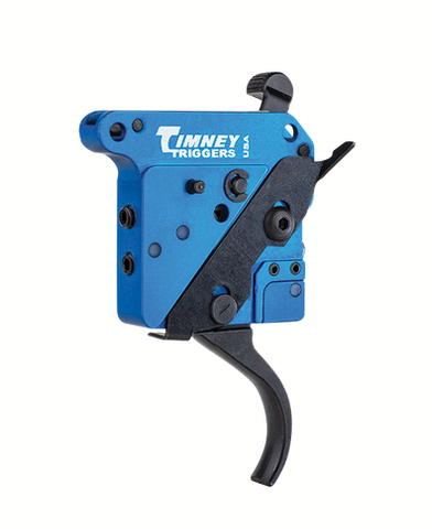

So the bolt stop is the flat piece on the left side of the trigger that you have to remove?
Yes, it is on oppisite side of the trigger from the safety normally. one allen screw or c clip and it is off. Below is an image of the bolt release.
