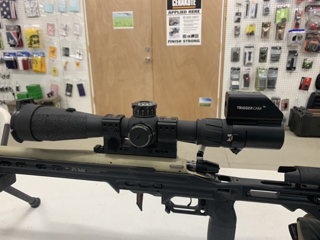

    Mine arrived today, looks like 47.9 is the current diameter. Fits the S&B 5-25, not sure if it will go on the Razor II, I'll check it tomorrow.

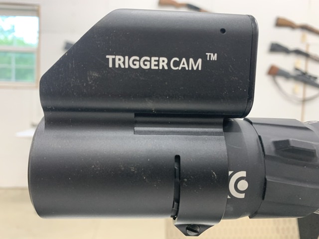

    With a slight modification, they will fit on a Zero Comp.
    Remove the hex bolt, drill the bolt hole out with a #29 drill bit, tap with an 8-32. Takes a bit to flex the ring over the eyepiece, but it goes. Install and tighten the new 8-32 bolt and viola.

    I was also able to get the triggercam to mount securely to my razor gen 2 without using the plastic inserts. I have used it for 2 range days and a match with zero issues so I'd say it's GTG

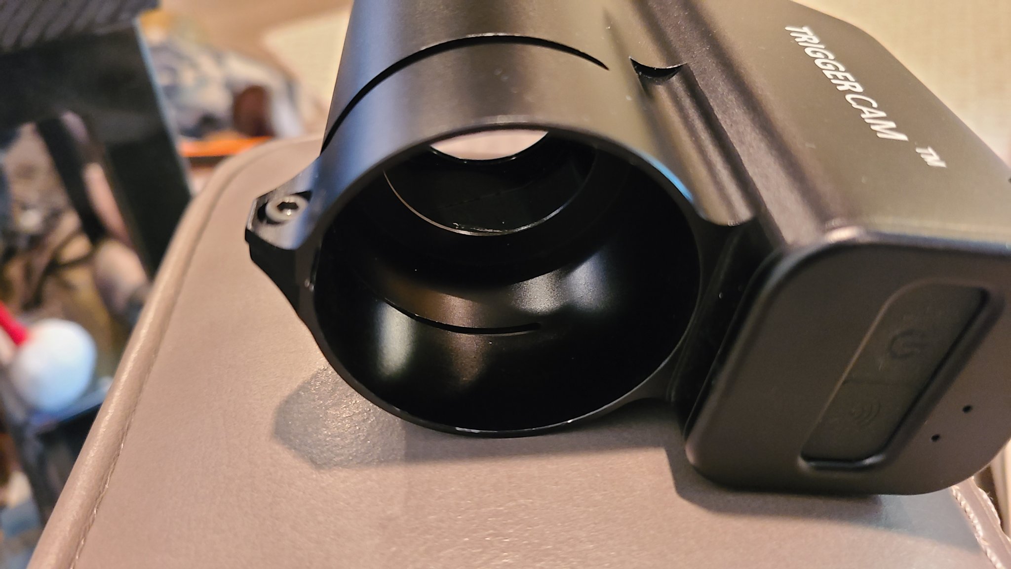

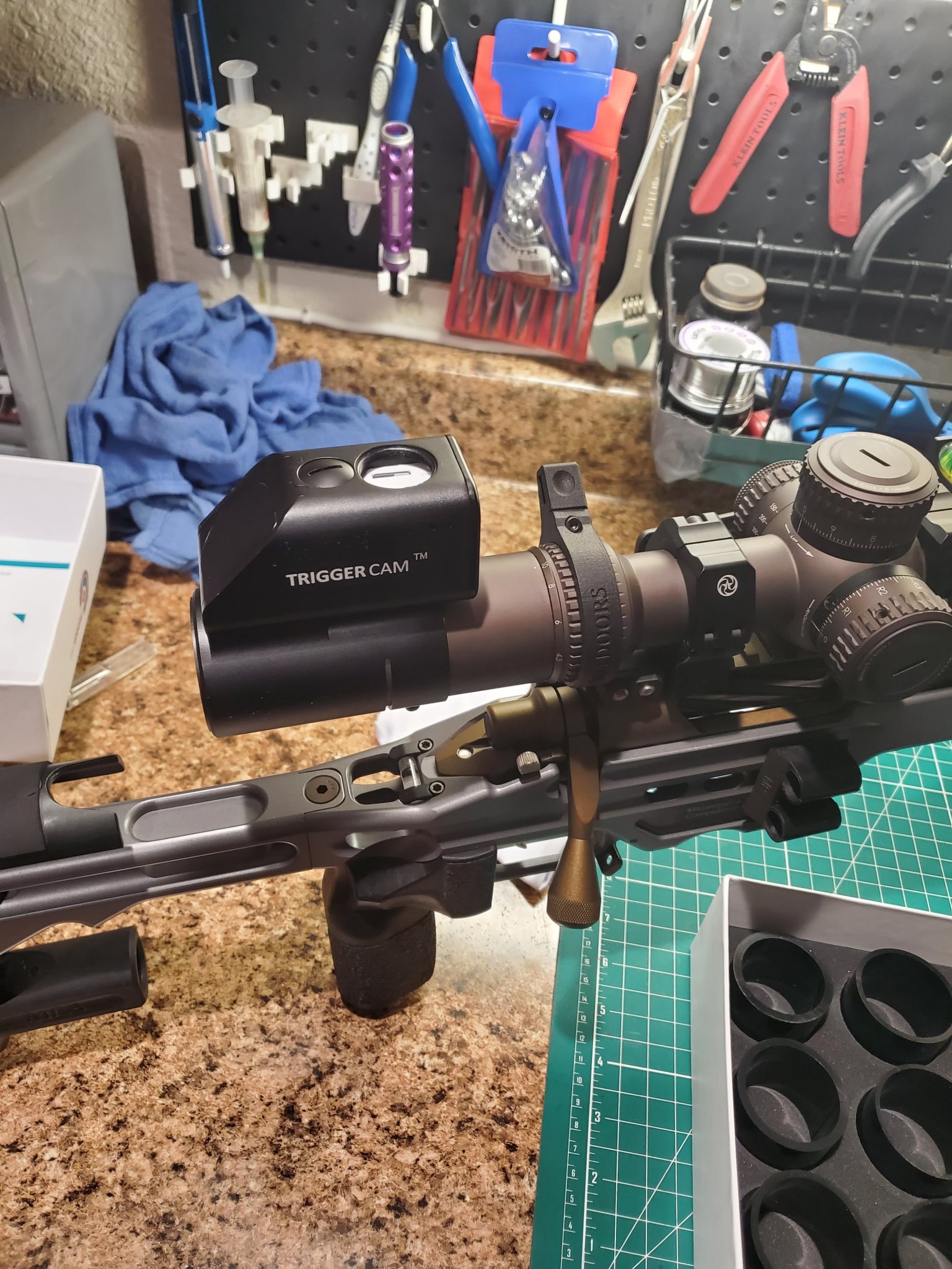

    So I bought this to mate up to my zco, as mentioned above you can get the first section over the eye piece but the second inner section does not. I was not able to get good focus without getting the second section over the eye piece. I may be able to adjust the diopter and make it better but I doubt it.
    I mounted it on my PST and it was easy to focus.

    On the ZCO without any inserts you can spread the first section and get it to slide over the eye piece. You can't get the second section over the eye piece. On my PST Gen2 I was able to slide it completely up against the wall you can see at the back of the second section. The PST was super simple to focus to very crisp at high zoom. The ZCO I could not get to focus to any quality level. I may play with the diopter adjustment on the ZCO to see if I can dial it in, I am not hopeful. I knew this was a challenge when I bought it.
