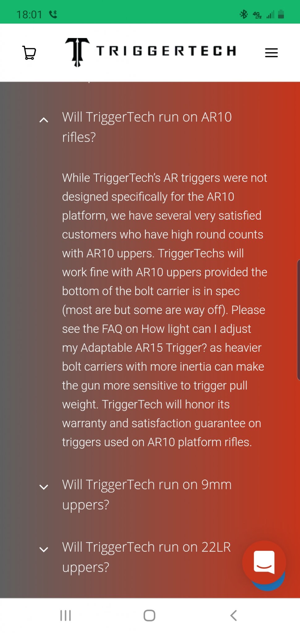

Will this trigger match up and function for an AR10...they seem to indicate AR15 and no mention of AR10. Anyone know something, want to do on Labor Day Sale savings, but can’t contact them so far this weekend. Tks.
I just put one of the TriggerTech Diamond AR triggers in a Seekins SP10. It fits and works fine.
Thanks for the extra word it will work. Diamond is the one I’m getting. I hope the LMT will fit it fine being as their upper ranking. I’ll just have to verify that by install carefully following the instructions and run the function test steps to well verify proper functioning then range check. Tks?.
You should be good to go-I would definitely get the anti-walk pins if it doesn't come with them.

Run a TriggerTech in my Sig 716. As well as in three other AR15s. I use anti walk pins in one rifle that came with another trigger. Only reason I even have them. Just snug up the two tension set screws that are on the trigger housing real good. They put pressure on the trigger pins and keep the trigger housing from any small movement. Now could they walk, possibly, but I have yet to have any trigger pins move.

Right, I think that also, once I read what the “Snug” screws actually do...to tighten the TTech against the original pins...I’ll ask for TT Company info advice on this also. I keep sweating these details around. Will wait to hear from them and any others. Anti’s sound like insurance for sure, but for now think I agree somewhat with your info. Tks
