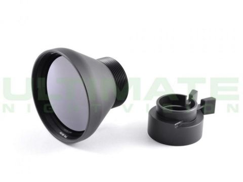

I was wondering if anybody knows if the Trijicon magnifier, the 3x that appears to screw in and not clip on, is compatible with the Reap or the Hunter series?
If so does this triple the native mag and leave the same resolution? But at same time reducing FOV by 1/3?
It screws in to a pressure clip which clips on to the focus ring of the ir-patrol.
For the patrol it reduces FOV by about half ... and increases the magnification by 3x.
In my experience it moves if you try to shoot it and POI shifts by feet at 100yds ... so not practical for shooting only for observing. And AFAIK only works for Patrol, though with a different mount/adaptor could work for some other thermals.
And to be clear, here is the one I think you're talking about ...
https://www.ultimatenightvision.com/3X-Lens-for-IR-Patrol-p/3x-62mm.htm
That’s it. I just saw the threads inside the Reap models and was hoping it screwed in but I guess it doesn’t and won’t work. Just trying to find a more elegant solution to the PVS30. UTC appears to be the only other real option. And no idea where to look for one of those or if one could be found for a reasonable price.
