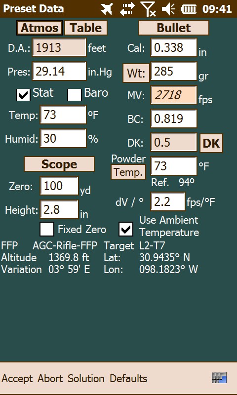

    Like the previous versions, Delta V does not use density altitude by default. You can reference a chart of course to determine station pressure, but the program will want temperature and station pressure as it's main environmental inputs. Note that station pressure is not barometric pressure and the application can use either as long as you tell it which you are inputting. You can also link a Kestrel via Bluetooth to pull this data in near real-time.
    Along with environmentals, FFS allows you to set a "powder temperature offsets" that will impose a "fps increase or decrease per degree" ambient temperature change. For instance, through data I have collected I have found H1000 to give a 0.7 FPS increase in velocity per degree Fahrenheit temperature increase over my zero-day temperature. 1.1 FPS per degree F appears to be a good all-around metric for Varget for instance.

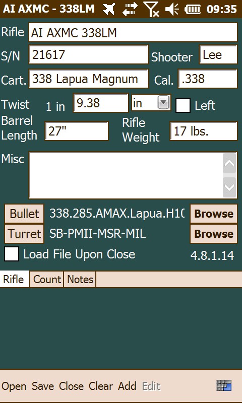

    This is where things start to get very customizable versus Kestrel AB/Horus. The rifle profile is the basis around most of the application. It allows you to select a particular rifle, but jointly also select bullets to fire out of that rifle - dynamically. (I don't mean loaded rounds when I say "bullets" here).
    As you can see, you input the basic rifle information here. Even with the commonality of switch-barrel systems these days, think of this being "the barrel". Twist rate is the only variable from this screen that are used additively in ballistic calculations.
    Shooter - This is for team shooters that may use the same rifle. It provides the ability to filter based on this name for different zero offsets, etc. You can setup the same rifle data with a different shooter. I believe there are easier ways to really do this though.
    Bullet - Will be the default bullet profile that the rifle is zeroed to.
    Turret - The optic that is attached to this rifle.
    Count Tab - Lets you keep track of you round count for this rifle, with dates and cumulative round counts.
    Notes - Just a general text field where you can put any text notes you might have.

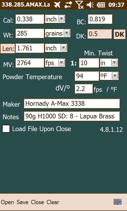

    This is where you'd build the profile for the actual bullet. Most of this is going to be rather self-explanatory but I will cover a few of the fields.
    BC - Obviously this is the ballistic coefficient of this bullet. I'll cover this more as an important thing to note is that Delta V does not use exacting G1 values. Calculation is almost always a must.
    DK - We don't touch that - ever! That's an "all else has failed, let me mess with this" field. It basically alters the way the engine generates values.
    Min. Twist - This is the minimum twist rate that this bullet should be fired though. It's informational, no calculations are used from it.
    Powder Temperature - Remember earlier when I was talking about powder temperature offsets? This is where you set the "zero-temp" for this particular velocity/powder. It's a selectable item that can be turned on or off on demand.
    Notes - That's just where I put some reloading details about that particular bullet/brass/primer combination. You can put anything you want to here.

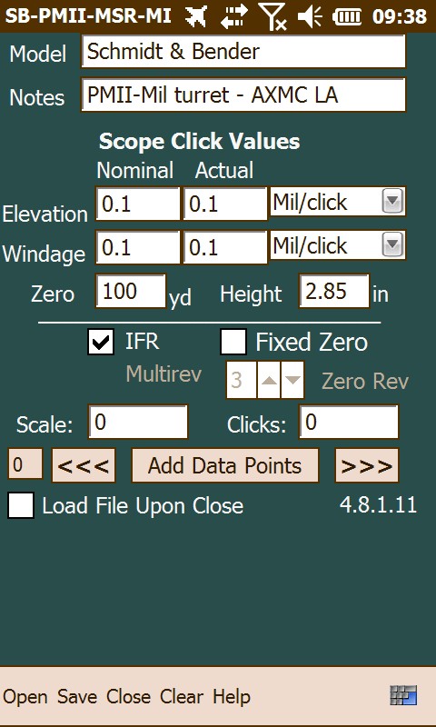

    As you can see here, this is where you optics profile is associated. All of the normal information in here, relatively straight-forward.
    "Scope Click Values" are used to true your turret for actual real-world click data. Who knows, your optic might actual equal 1.1 MILs in 10 clicks due to random variables. (I track-test all of my scopes right out of the box.)
    The "Scale" section is used to set the values for "clicks" to the actual scale printed on the turret (1 MIL on a S&B DT MTC turret equals 10 clicks).

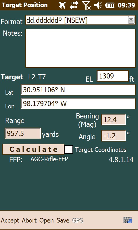

    Target Profiles
    These are a rather nice feature. Targets are defined either by strictly distance (with no bearing information) or via the method pictured. If you create a profile with coordinates and angle, the program will give you the magnetic bearing and cosine to the target from your set FFP. This is useful for Coriolis/Eotvos calculations with magnetic variation. Useful if you know the exacting coordinates but don't have a LRF (for some reason). Target profiles can also be grouped together and bound to a FFP if desired. There are several LRF (Vectronix having the most support) for direct-targeting information linking via a serial cable.
    The Final Firing Position screen is rather self-explanatory.

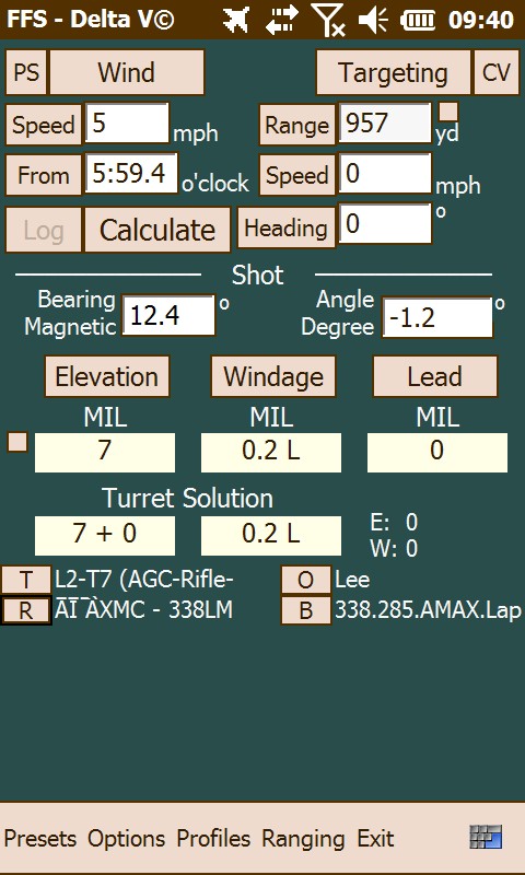

    This is where all of your different profiles will comprise your dope, etc. You can get a full target profile dope list, or you can manually type in a distance.

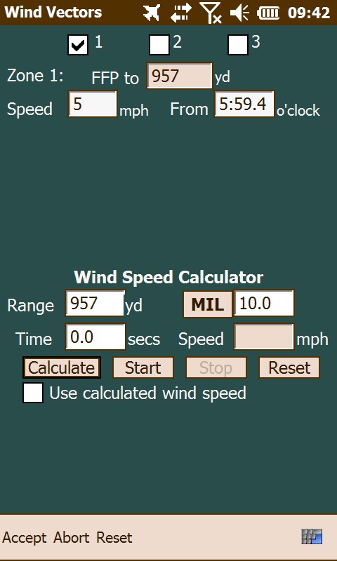

    A single wind direction can be input on the main screen. If you are firing in an environment that has multiple wind directions out to your target, you can resolve for that as well with "Wind Vector Zones".

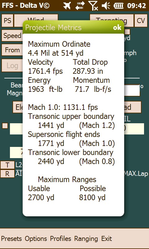

    The small box next to the range is the projectile metrics button. The color of the box indicates the velocity of the bullet at that distance. White/tan equals supersonic. Yellow equals transonic. Red equals subsonic. Pink-White means that the bullet would have to be fired at such a ridiculous angle that it would probably never even make it to the target.
    Speed will be target speed. Heading is target direction.
    T is your Target profile selector
    R is your Rifle profile selector
    O is your Offset profile selector
    B is your Bullet profile selector

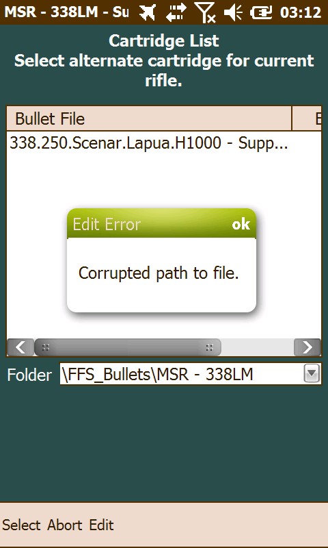

    Just a reminder... If you shoot the same bullets in multiple rifles you might be inclined to just copy the files on the SD card. You can't do that.
    If you do and then try to build an offset profile (suppressed offset in my case), you will get this and a crash. This is sort of by design because I use folders for bullet profiles rather than just keeping them all in a flat folder like you are supposed to. It used to be much worse before 4.8.14 (Blaine called me out on using folders to organize things back in the day and I stopped for everything except for bullet profiles). He did work in a "fix" into 4.8.14 for people that use the same bullets across different rifles and sort the files into folders like I do.
    I am trying to duplicate all of my AXMC profiles over to a different rifle so I can customize them there without having to manually type everything again. My plan is to customize the "new" bullet profiles on the new rifle after I gather data.
    Point being, it's better to clear all profiles that are loaded (everything), open just the bullet profile that you want to duplicate to a different rifle and re-save it under a different folder or a different file name if you aren't using folders. This way the file pathing doesn't get messed up in the rifle profile or the offset profile. It indeed works flawelessly this way.
