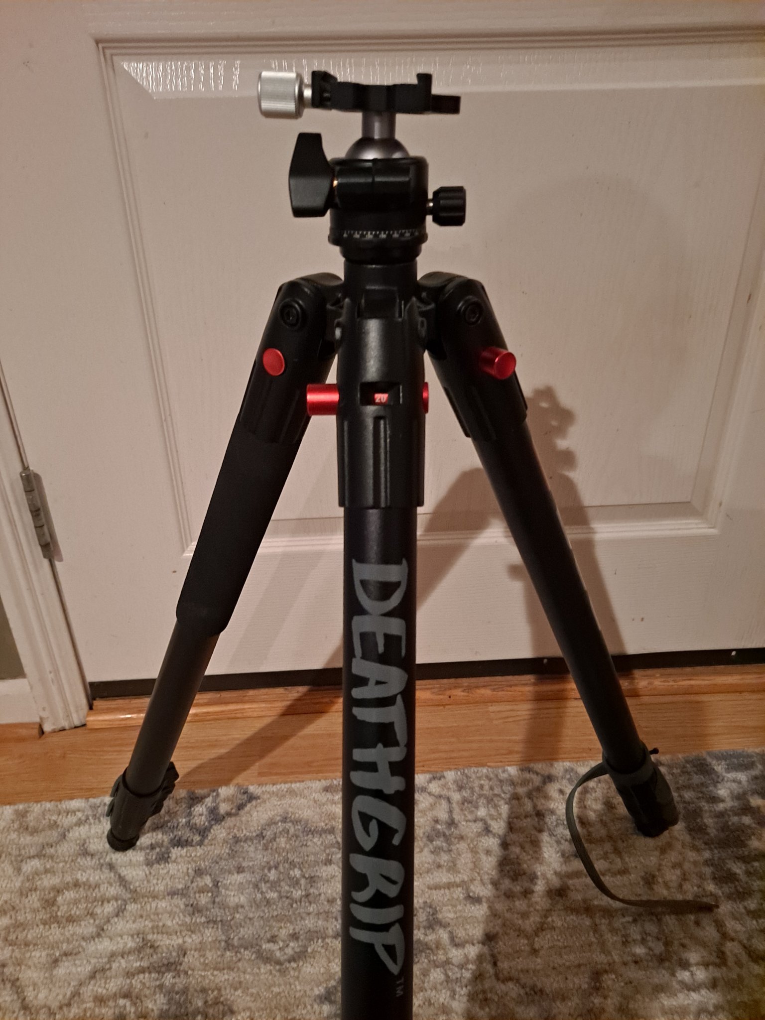

While waiting for a tac table to arrive for my hog Saddle tripod, I decided to disassemble my deathgrip clamp, leaving just the legs......since I like to tinker, I threaded a couple washers, grabbed a bolt, and added a little ball head to the BOG legs....should work nice for a spotting scope 🙂

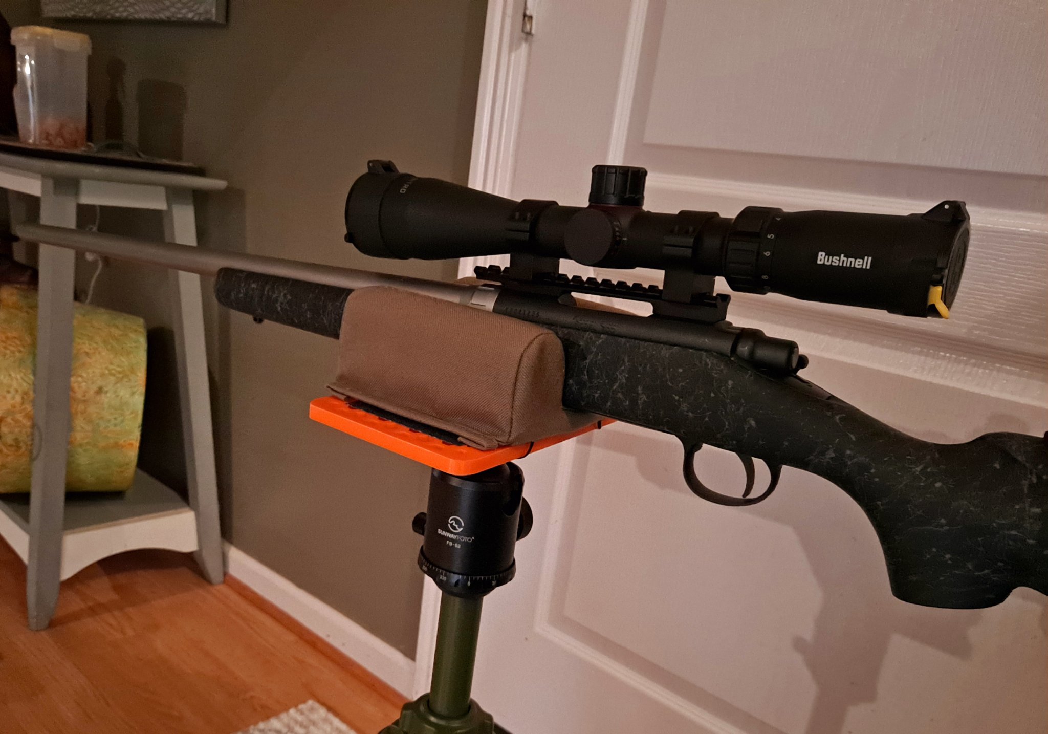

Tac table arrived and I think I'm in good shape for hunting season. Thanks to @Drhorsepower and his son for getting this in my hands. It's a nicely finished 3D printed piece that's super light and super rigid.
