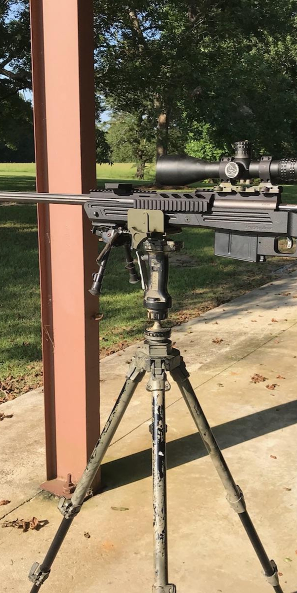

The leophoto tripod, this Desmond leveller, and a pig saddle was very hard to beat.
Manfrotto and manfrotto grip head. I find it too easy to get loose, and if your rifle is too heavy, you can "cant" it really quick, and if on unlevel surfaces, if you cant it, and lose it sideways, you can dump the system on the ground.
Which is why I showed leofoto and Desmond, suggesting that and pig saddle.

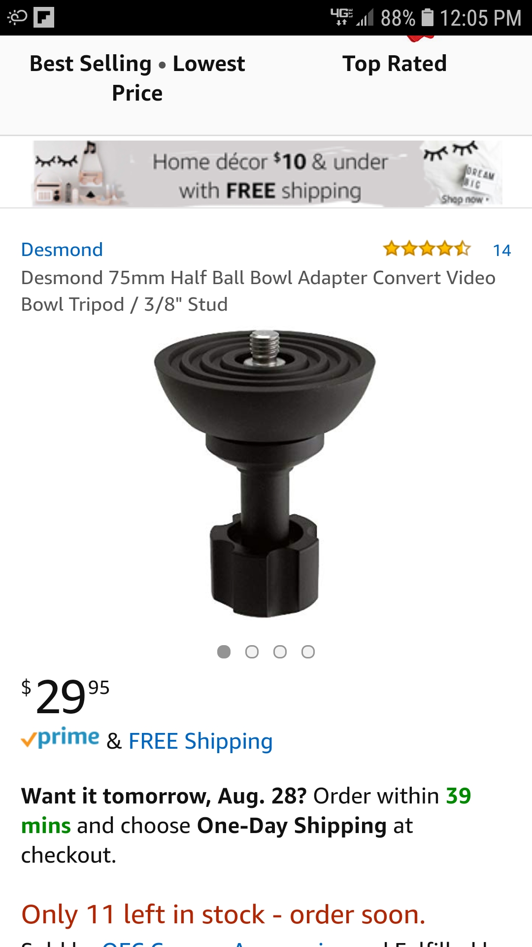

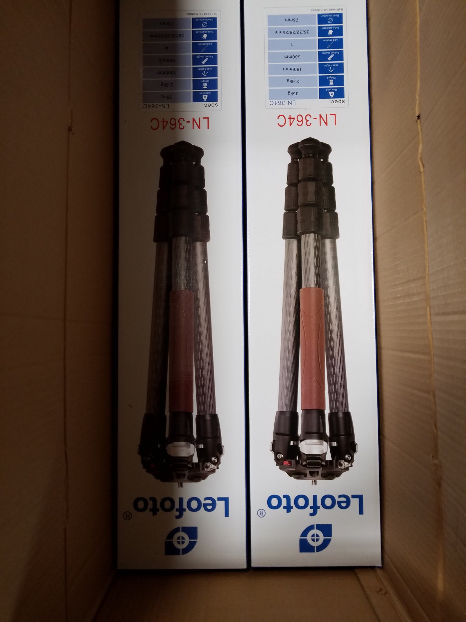

C.K. Arms, Camilla Ga, will sell you the setup, leofoto LN364C, the Desmond 75mm adapter, and a c.k. saddle that's real close to a hogsaddle.
Accurate Ordnance in Winder, Ga, same tripod setup, close to same $.
But, I think you need to PM AMTeam4 and let him give you a quote.

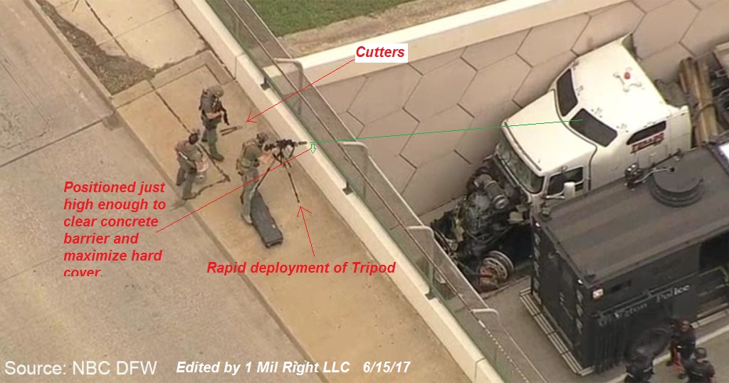

Aside from that, I am of the opinion that every LE sniper should deploy with a tripod. I find mine to be incredibly useful.

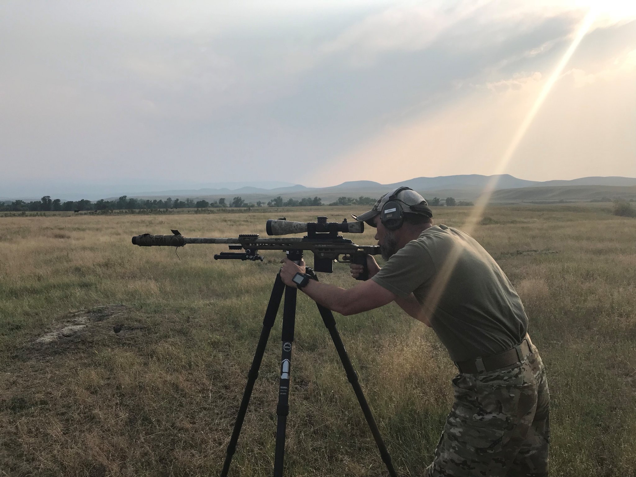

For a direct mount, it's hard to beat the stability of a leveling base (plus Arca rifle rail) and the flexibility to pan on target without moving the tripod or a pig saddle. I have the older RRS B-55 ball head, their universal leveling base (TA-U-LC) and a PIG saddle. The direct attach is more stable than PIG saddle (by far), and the leveling base is the more stable of the two (old ballhead and leveling base). I have not used the new Anvil 30, so can't comment on that.
The direct attachment via Arca rail, also allows better positioning of the rifle on the tripod (which cant always be at the balance point where a pic rail is attached to the stock, if not running an Arca rail). This is important, because depending where that pic rail is mounted to the rifle and tripod, it may or may not impact your ability to change mags if you happen to pan over, with the stock/mag well sitting right over one of the legs (essentially blocking you from doing a mag change without having to move the rifle over, away from a leg, to allow the magazine to fall free, and a new one to be rocked into the mag port).
I've spent a lot of time shooting off a tripod (granted it was shooting prairie dogs for weeks at a time, and not on overwatch) in both seated and standing positions. And when your covering a wide swath of ground with your rifle, and engaging multiple targets under time constraints, it helps to be able to slide the rifle back off the tripod mount without taking it too far off target, so that you can either change mags or swing/pan the rifle across an arc without the mag snagging one of the legs.
JMTCW...
Reactions: 260284
Note how the rifle is slid back on the rail here, so that the protruding magazine is away from the tripod legs to allow panning across the field. If a pic rail/Arca adapter was used (and attached too close to the mag well), I'd be stuck having to move the rifle off target to change mags. Here, in the pic, you can see I have the rifle far back enough off the leveling base to allow mag changes and panning past the legs, but still fairly close enough to the balance point. The low profile of the leveling base is what gets you that increased stability, but really makes you have to consider where you attach a pic rail if that is what you are going to use to marry the rifle to an Arca mount such as a leveling base or ball head. Hence why full Arca rails are a no brainer for most folks.

Purchasing a tripod setup for Law Enforcement use is justified by the many benefits a good system can offer. The flexibility to deploy the tripod in elevated positions looking down (ball games, parades, protests, rallies, concerts, festivals, etc.) is one of the biggest benefits.
Having the ability to also rapidly deploy on low ground to aim at or cover elevated positions (balcony, water tower, roof tops, etc.) should also be practiced and be included in the initial purchase justifications.
Basically the tripod should allow the officer advantages in all 3-D / vertically offset environments. My opinion is that leveling heads neuter a lot of the potential for tripods in Law Enforcement.

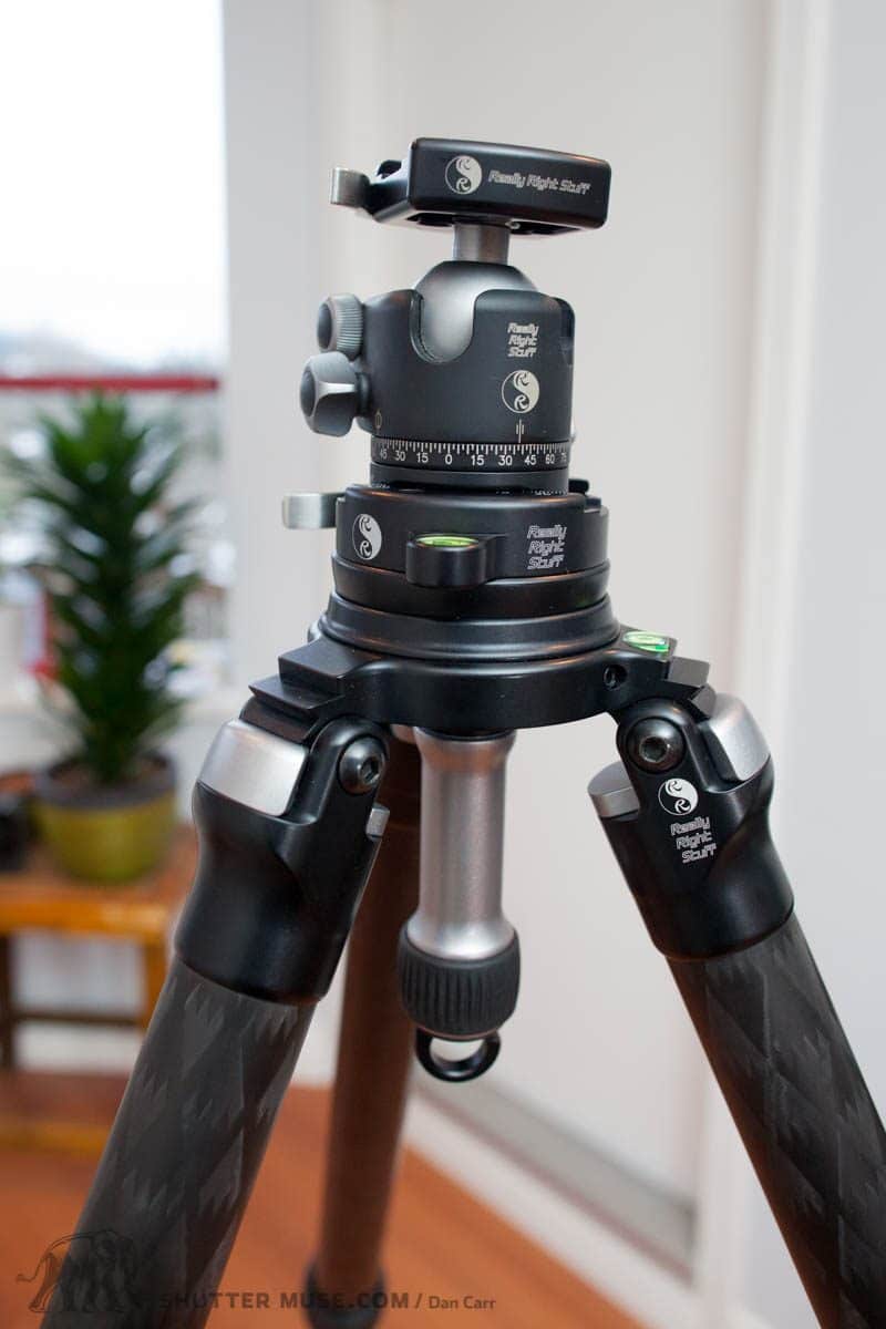

Stacking a ball head on a leveling base gets you zero additional vertical coverage.
....... it puts your rifle even higher over the apex of the legs = less stability/higher CG with nothing positive in return.
........ it is just begging for something else to come loose at the wrong time.
Stacking a ball head on a leveling base with the lower handle length as shown is just limiting your ability to take the rifle low if needed (long handle underneath plus extra crap stacked vertically between base and rifle)

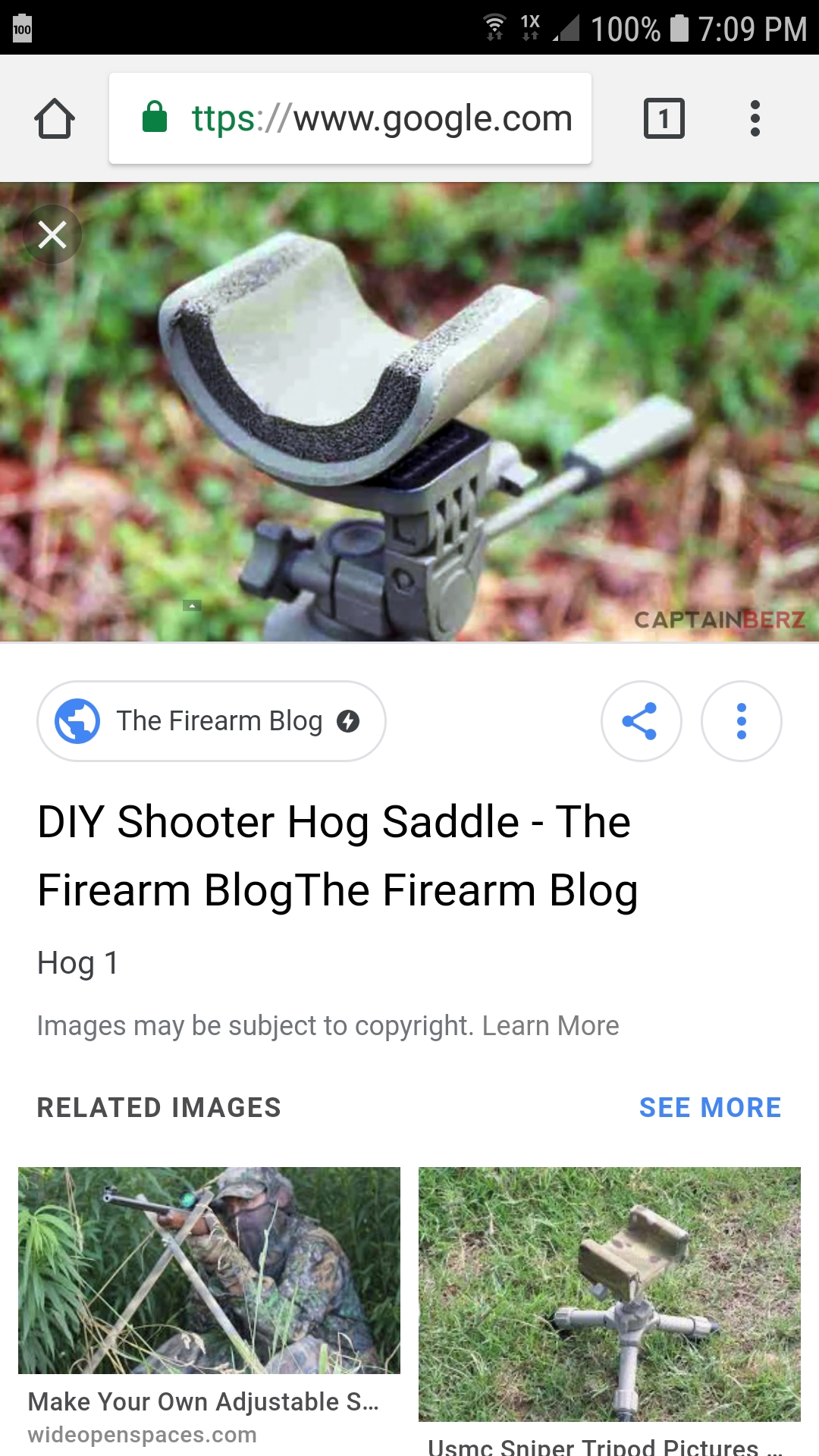

Back when the Brits and usmc taught us to cut bamboo or use broom handles, mop handles, and arrow shafts with 550 cord and duct tape.......
Then we used cheap tripods and PVC pipe with foam or channel iron with carpet....
And the emphasis was physical control over the rifle and the ability to use it with two hands, two arms, and one body. And move to, react to, or direct to the target as needed, either on or off the tripod.
And in hide building or position building, any chair, couch, cushion, tuck, tripod, bipod, monopod, bag, sand bag, or body was an aid, not an integral part of the sniper and his rifle.
And then there was the hog/pig saddle concept of things, and where we are now.
The only self leveling heads I like are those with the drop handle off the bottom, like the Manfrotto 500ball, 100mm half ball, Gitzo GSLVLS, Gitzo 1321, Feisol LB7567, and the Desmond 75mm half bowl.
Reason, one hand loosens them in a natural position from under the rifle.
**I dislike them for the same reason you do, lack of ability to handle high angle, like from the scoreboard down on the field.**
Sure, with lots of training, you can loosen the bottom handle, and loosen the pig, and push the angle envelope, but this is a "loose" solution, and I "old school" the tight hold training of the sniper controlling the weapon.
The vertical head pic I posted earlier is something I've used, but its weak, easy to slip, easy to lose control of the weapon. I dont recommend it either.

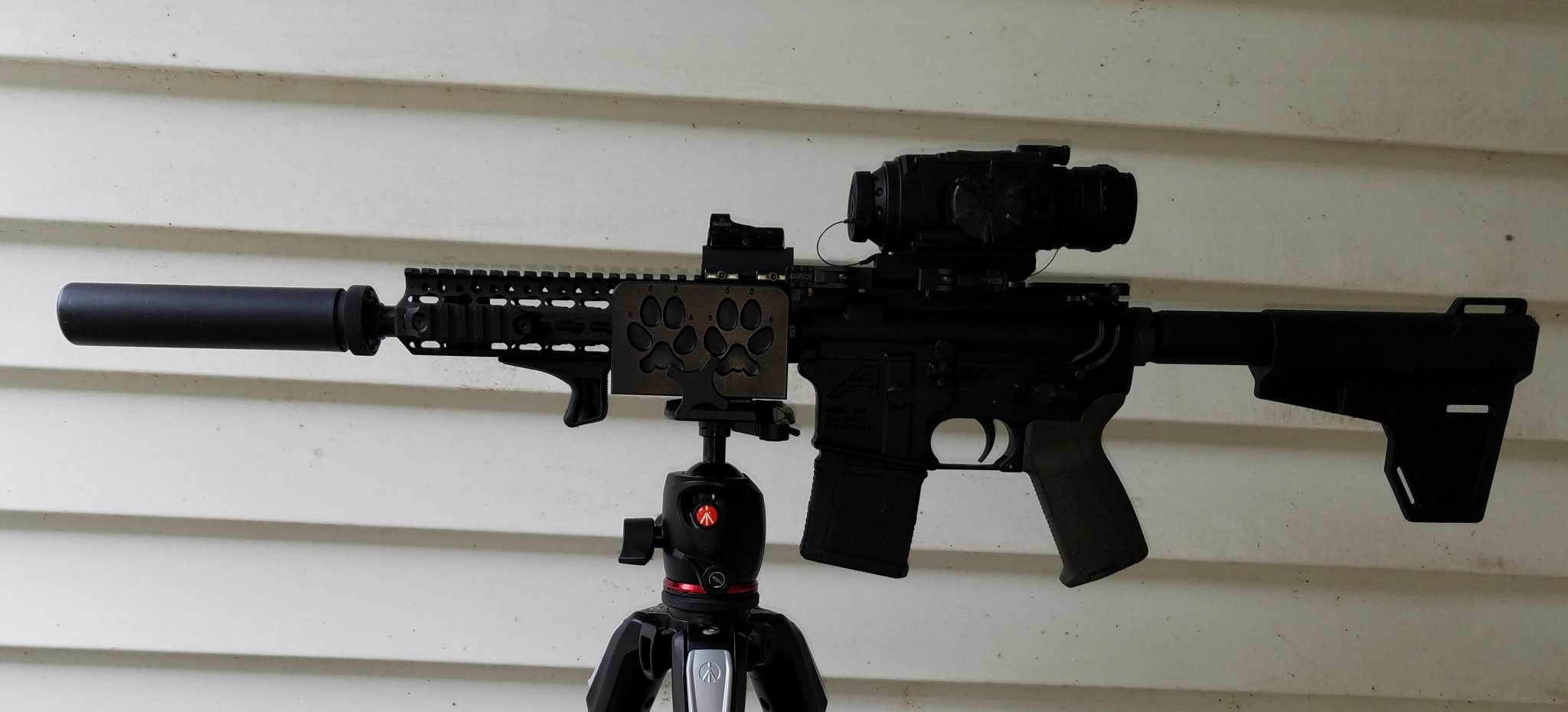

Thing I'm using right now is a manfrotto MHXPRO-BHQ2 ball head, that I switch from the nikon 200-400 and 500mm lenses and the rifles. Those lenses cost way more than two rifles with glass... that ball head gives me angle, and the pig/hog single point adjuster let's me remove or readjust "some" angle of the rifle pretty quick.

@Terry Cross Hey Terry. I have used the stack method a few times only for one reason. If you have to set your tripod up on un-even ground and your maxed on elevation in the legs, you use the leveling base to level the ballhead. Then you can get your reticle level and open up the independent pan feature of the ballhead and be able to pan 360 degree perfectly level. Used this situation looking at distance, when having to scan across the building roof tops that were all pretty much one story same height. When scanning 360 with just the ballhead or just leveling base you can induce cant in pretty easy. That is the only situation I have used it for.
There is a reason but pretty limited.
Only other reason I know of is the leveling base is not tool-less. You rush into a situation, setup and realize you need more elevation or the ability to use the drop notch with a spotter or camera and want to be able to switch back to rifle extremely quick.

Thanks for the input Mike. Your $.02 is always valued as you are pretty much THE collection center for how your own products are being used.
I considered what you are saying regarding the ability to pan in large arcs but again, keeping within the confines of the thread title, I just don't see this as a legit worry in L.E. deployments. At the same time, probably very valuable for PRS movers and varminting on flat ground.
Your wide scan is going to be done with optics other than weapon mounted. Once your area of concern is identified, that is usually involving a relatively small cone of focus. Even if you do need to quickly address another target area, there would likely be at least a small amount (probably more) of vertical adjustment needed as well which means breaking loose the ball head to reacquire anyway.

@Terry Cross completely agree with all you said. Just sharing one example where I have used it. Deployed during overwatch mission, we were watching a route with historied IEDs looking for spotters on rough tops along a road about a k along in which we were perpendicular. So we were scanning sectors often on the rifle.
