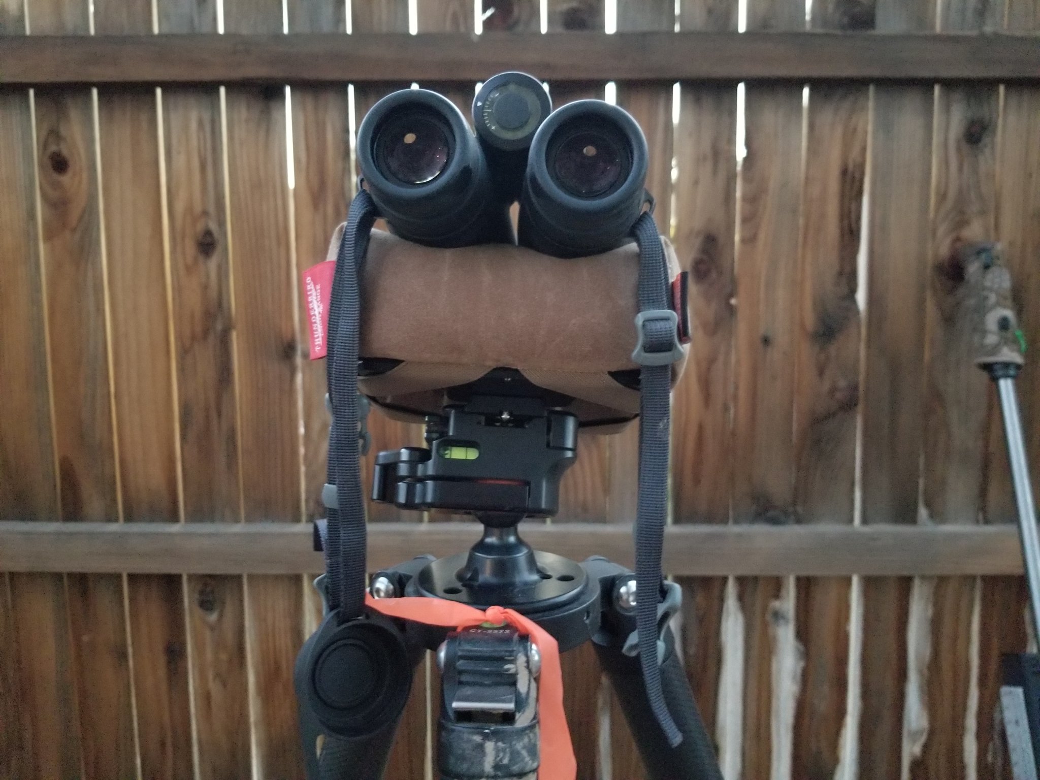

I use my RRS 34L + Anvil 30 with a MUB MOD DOS plate and the RRS cinch strap for my binos. Super fast and easy to swap as needed by stage. Simple rock bag from Amazon serves as a shelf if I'm just using it for spotting, takes <10 seconds to remove.

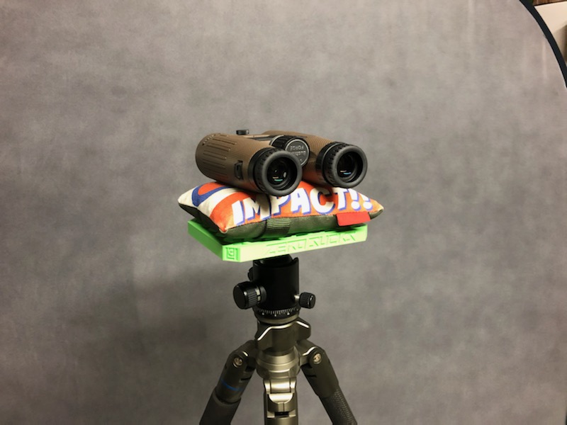

I use a newer version of the L3i plate above. I'll take some pics to show how I'm using it but so far it's the right price and extremely light.
Reactions: Mechdesigner

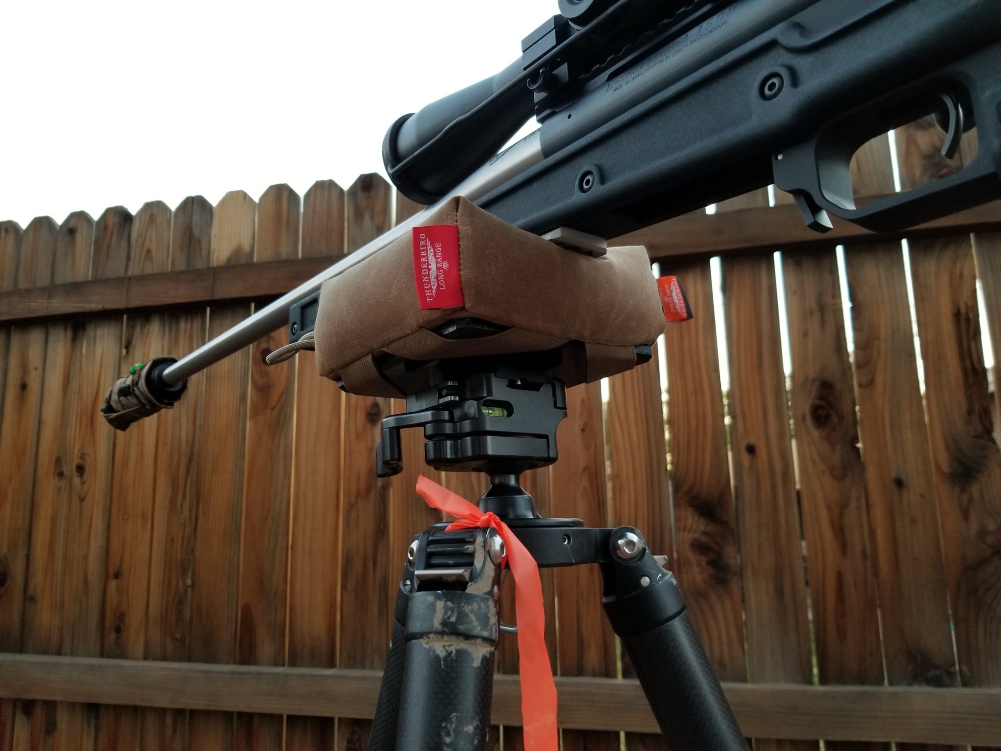

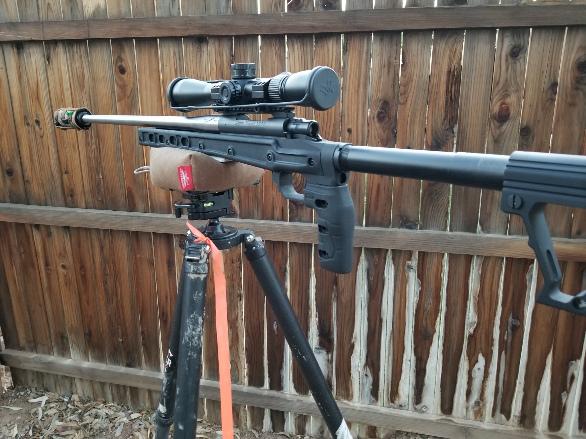

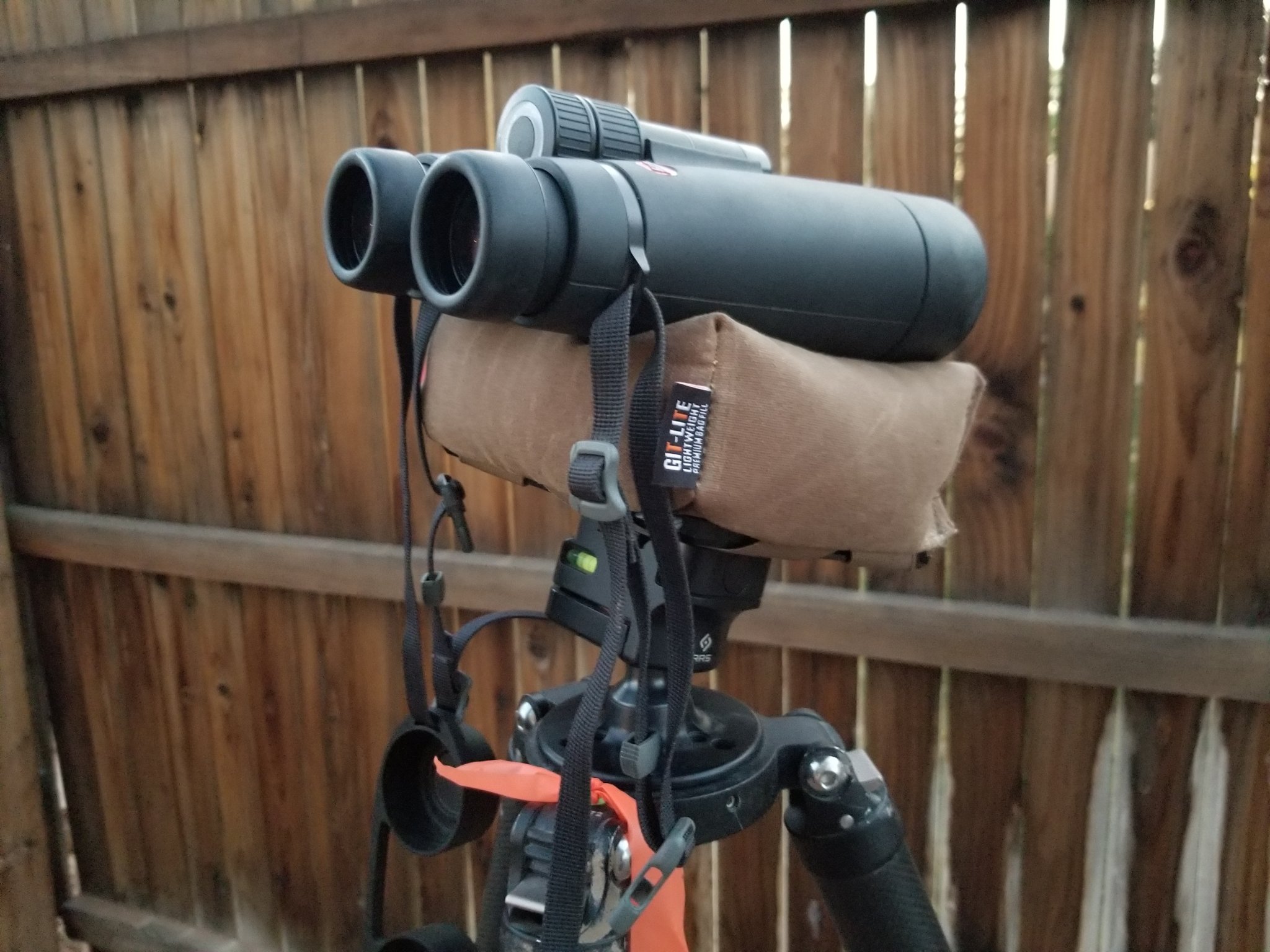

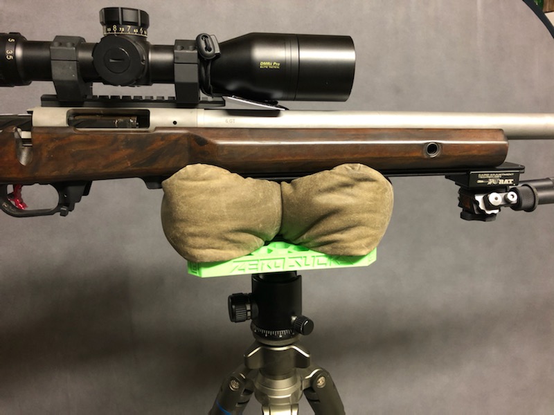

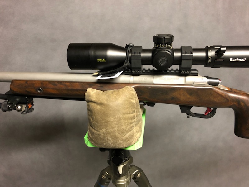

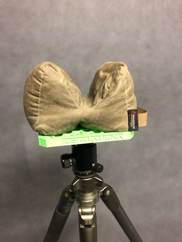

So I just took some pics because I use this daily for dryfire. Here's how I use it for your original question.
1. A flat bag on it with my binos on top is WAY more stable than my bino mount, I just rest my hand on top of them and it's much easier to move and adjust than when its mounted as well.
2. Rear bag with pint size game changer, stock seated in the "v", can't really get that pic in my basement.
3. I lay my game changer flat and shoot on it, for my bag this is the best position to shoot from.
The pictures have a ballhead but if I want to cut weight I can attach the arca right to the tripod and it saves a pound.

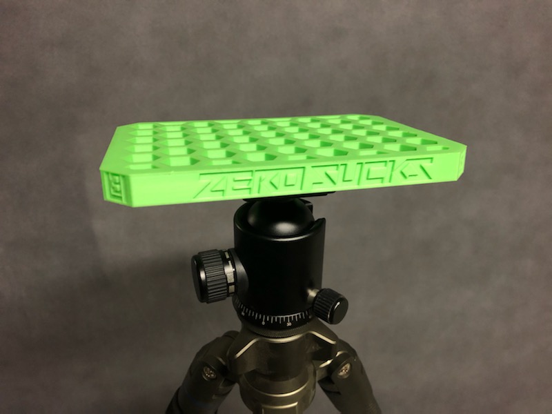

L3I Break Fast Plate...4 ounces and sturdy. Direct attach to Arca
do you mind sharing a link to that plate? I’m not having luck finding it.
Would you be willing to share a link to the plate? I can't seem to find "Zero Sucks L3I plate" anywhere. Thanks.

The idea behind the breakfast plate was field matches where lighter is better. Trying to make it economical was because lots of guys only shoot maybe 1 field match a year and don't want to drop much cash on gear for it.
If someone wants to work on a small bag to fit the plates, lemme know.

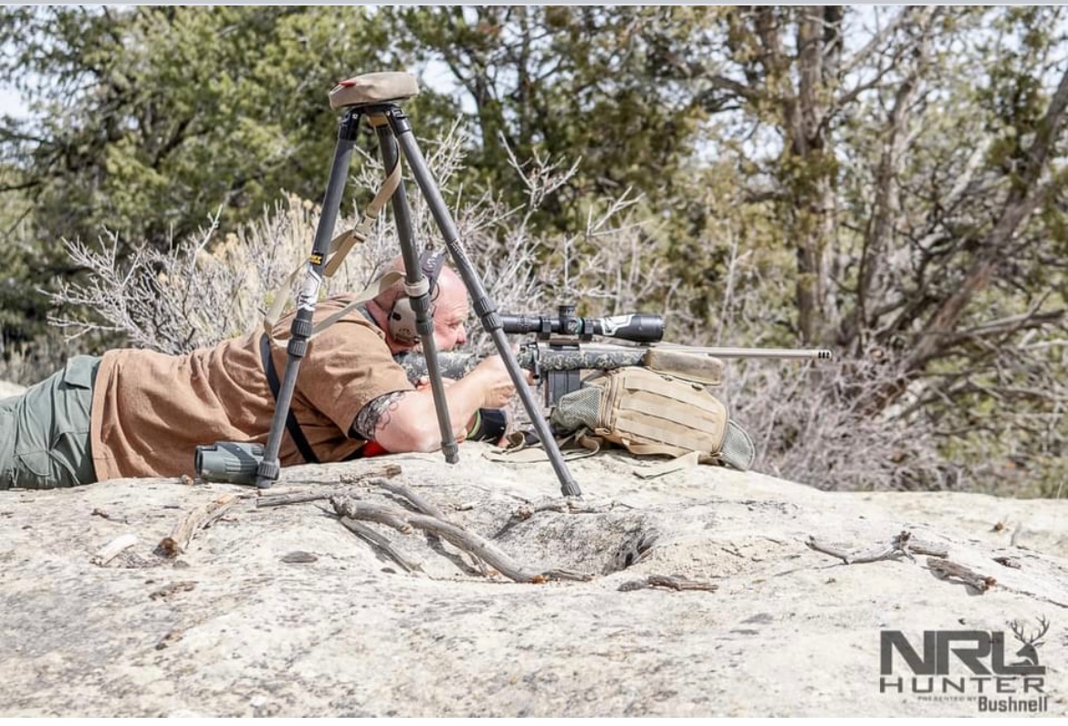

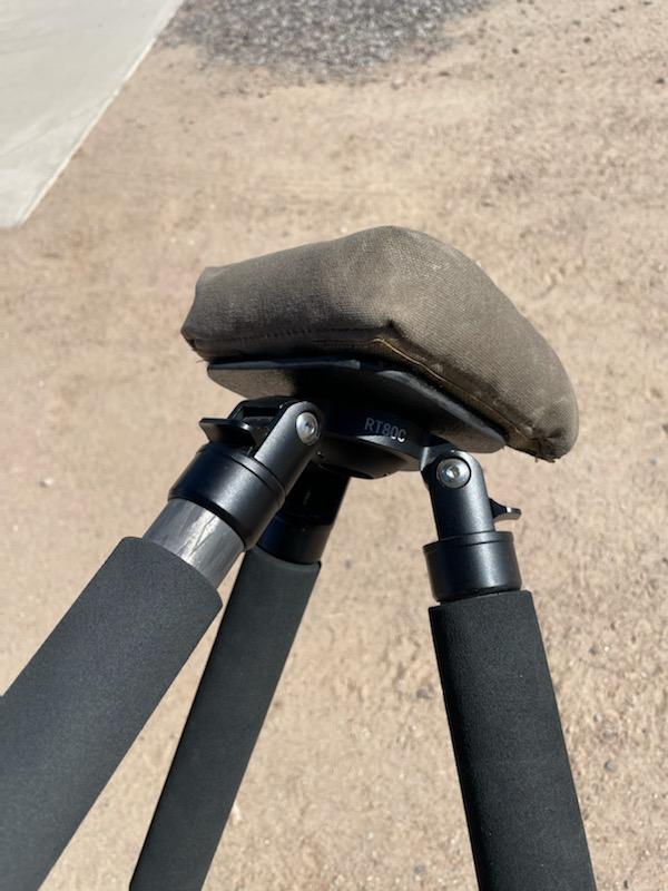

Here is a friend who followed that idea and ran a bag on the tripod for everything at an NRL Hunter match, and now uses it everywhere. He just bolted the plate to his leveling base. The bag velcros on, but never really comes off.
I know Scott Satterlee is a big proponent of shooting off a bag on top of a tripod for hunting. I think that's all he used on a trip to Africa if I remember his social media on it.
The little bag is filled with Git-Lite so weighs about half a pound if memory serves me.

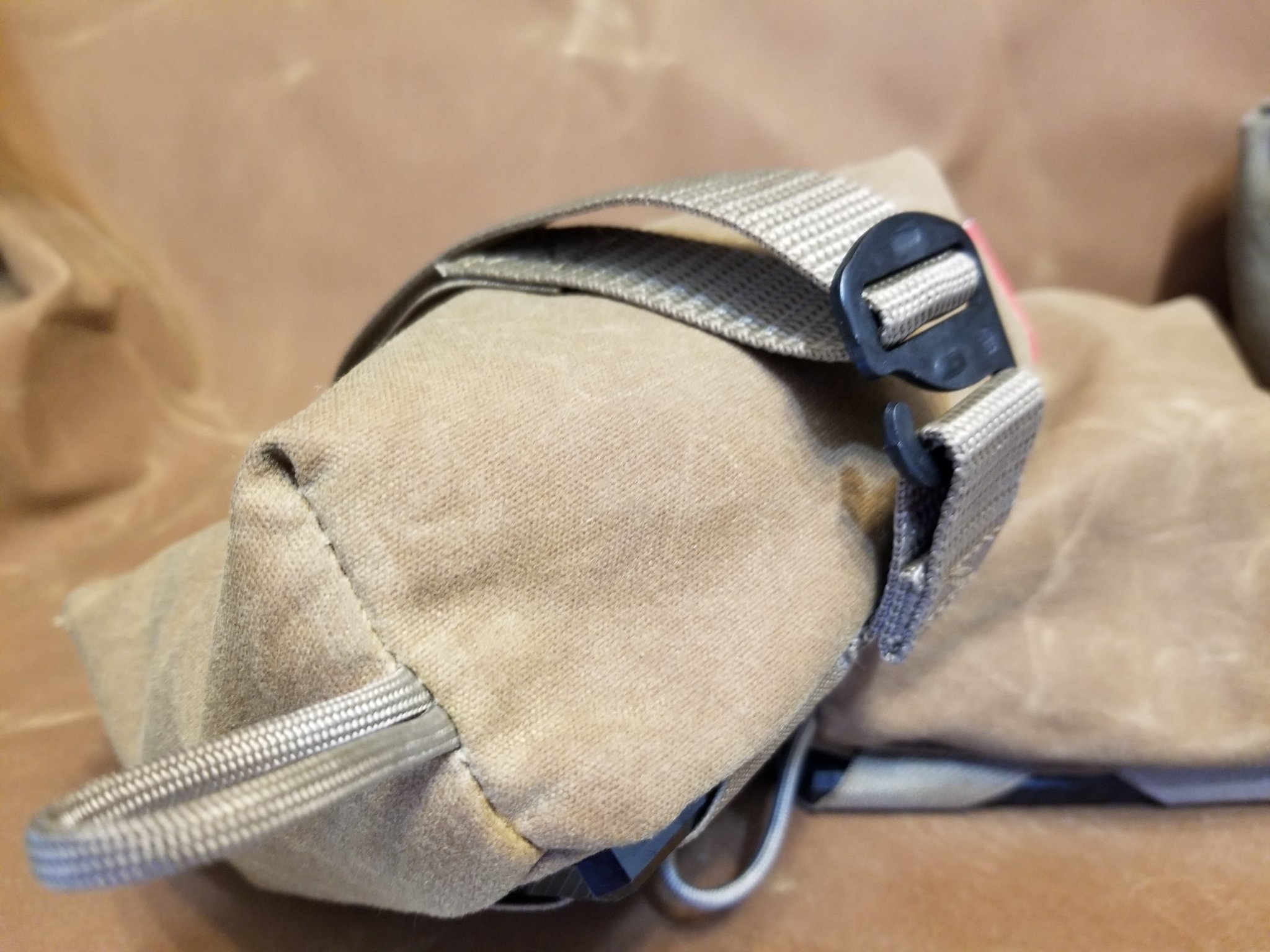

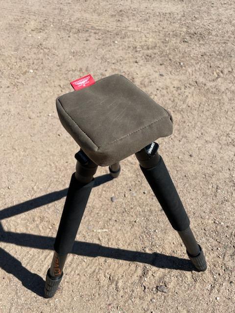

Just finished up a bag and a small table for a few guys, and for myself for NRL hunter.
If you are interested, I will make a bunch more. I don't know whether to put it on my website or not, so lemme know if you are interested.
For guys that want to test them with a promise to give me pictures and feedback, whether good or bad, I will do $89.00 plus $9.00 shipping for a short time as beta testers of a sort. Website pricing will be higher than that.
The plate and bag together comes to 1 pound. The fill inside is Git-Lite. It is 5" square plate and the bag is about 1 3/4" tall.
It's great for glassing and for shooting. I think I am going to offer a bungee strap to lock the binos onto the bag as well. A buddy with the first one I made loves it so much he is planning on taking it hunting to glass and shoot.
Definitely put a strap on it since I found that I like to leave my binos strapped in when I move from stage to stage. I actually used one of your flat bags and the strap goes tight over the breakfast plate posted above. Is your plate made of delrin, uhmw or aluminum? Want to make a bag that fits the breakfast plate? Lolol

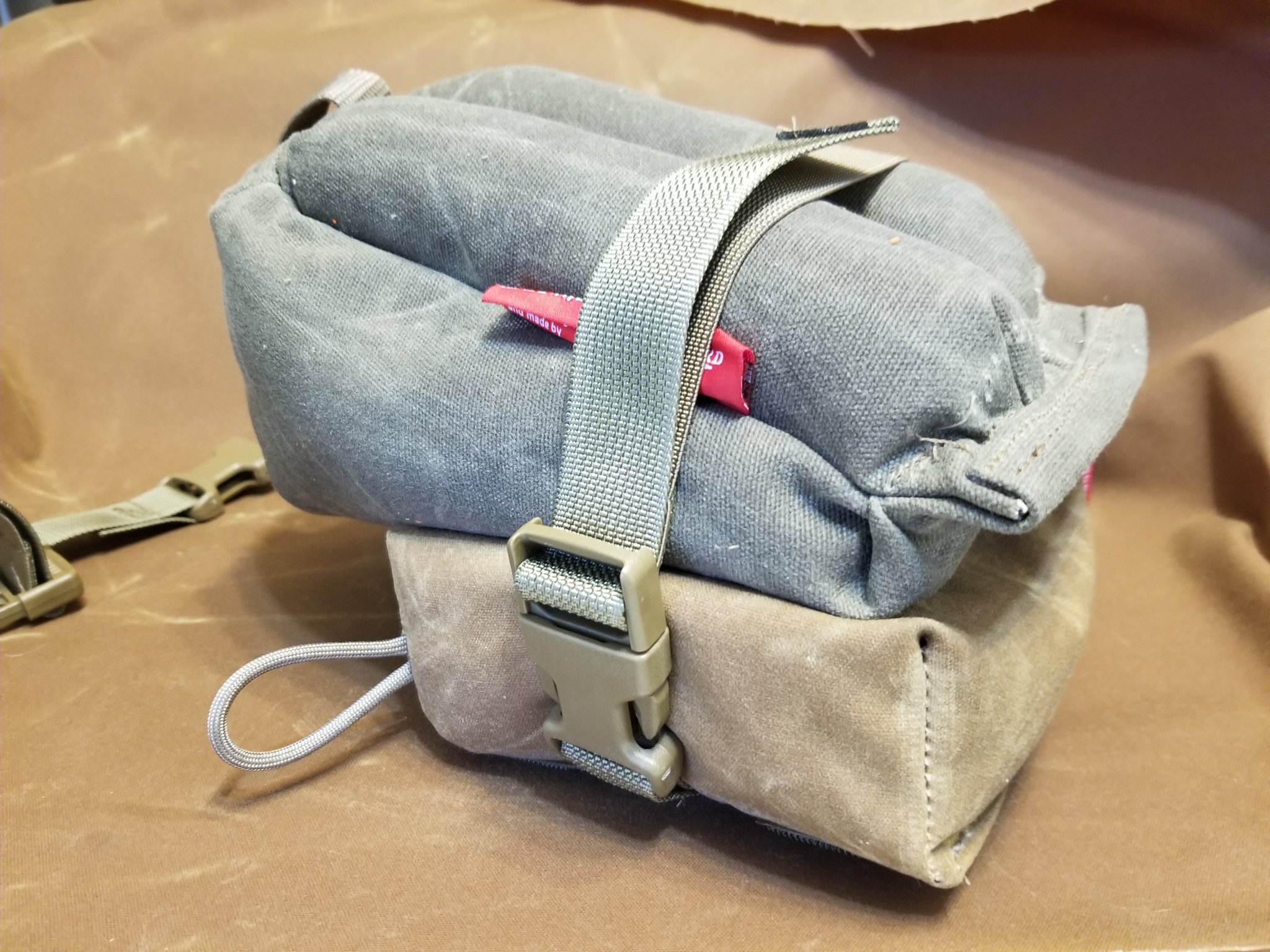

Yeah, as I think about it more, I am gonna make a strap. I will sew rubberized nylon into the strap or use a grippy neoprene to grip the binos and have a simple hook or buckle.
You think a plastic buckle or just a bungee with a hook?
For yours, I can sew the strap into the bag. And, I can make a bag to fit, no problem. What's the size for it?
The plate is some HDPE I had. Works great. I am gonna work out a production model.

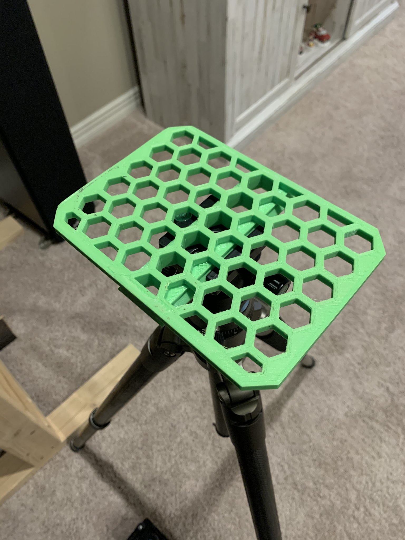

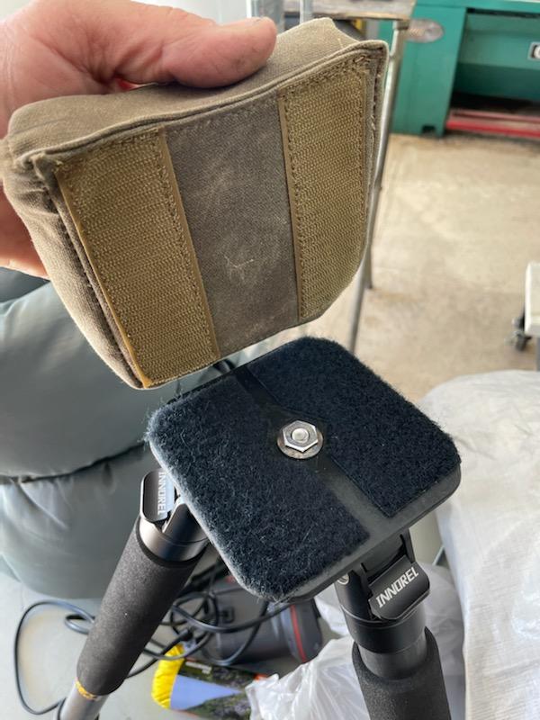

I made my test plate out of plywood and a cheap 2” arca plate, then added a Velcro strap to hold the bino’s on. Ugly, but light & works.
Reactions: hereinaz
That DIY plate looks good.
I have a kit worked out that could use a couple more beta testers. PM is interested. Discount on this and get the new one at cost if you want.

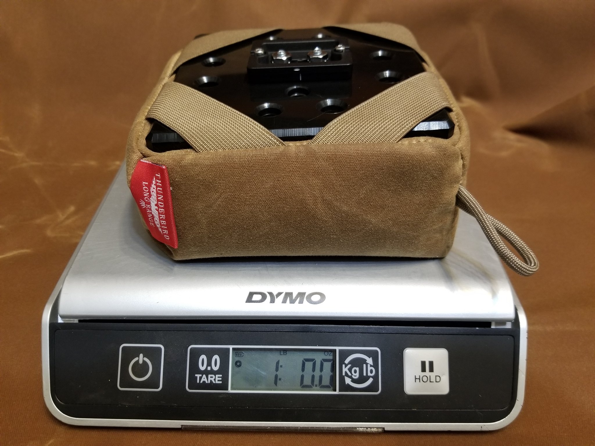

Weighs 1 pound total or less. Plate is 5x5 and bag is waxed canvas with Git-Lite, and a strap with elastic for binos.
Pics are a work in progress, may change a bit by the time it ships next week.

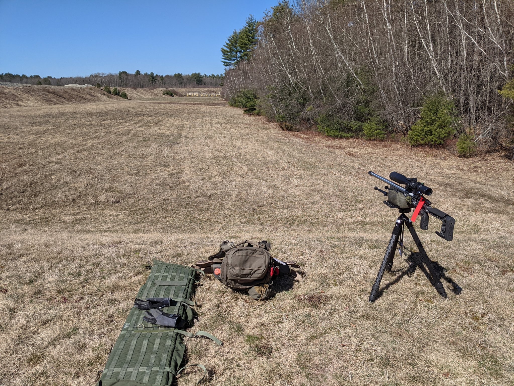

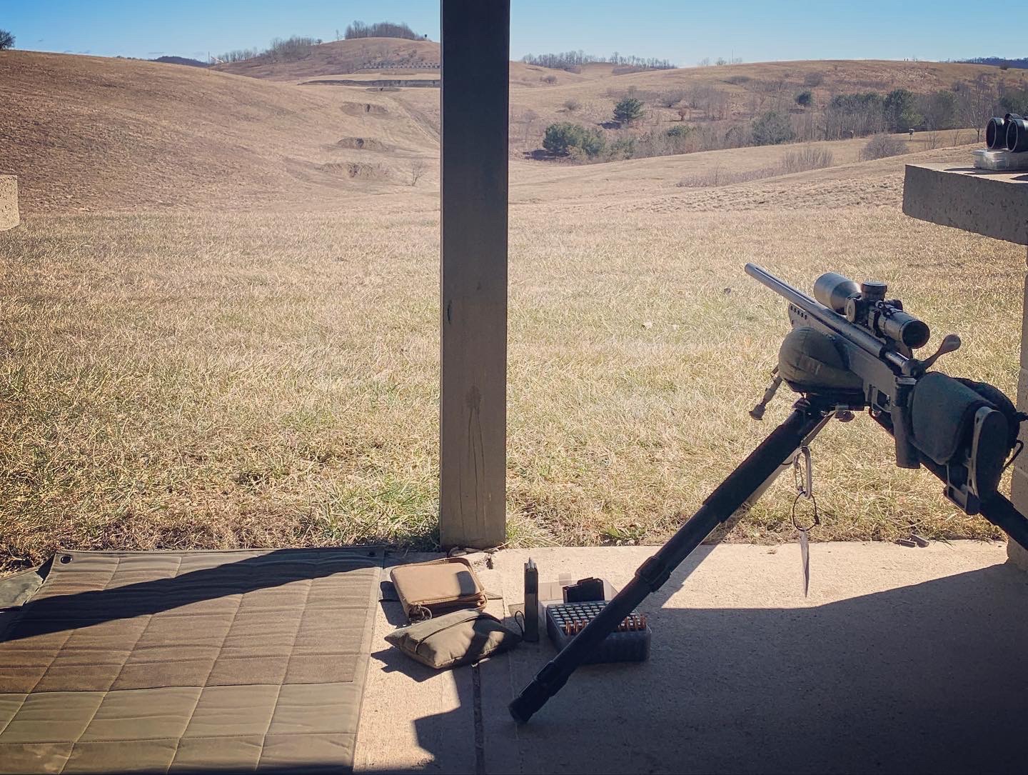

Playing around getting ready for NRLH...
Think I can start at kneeling every time and only extend the tripod if needed.
PSGC on Abel table is solid. 14lb .308 in pic.

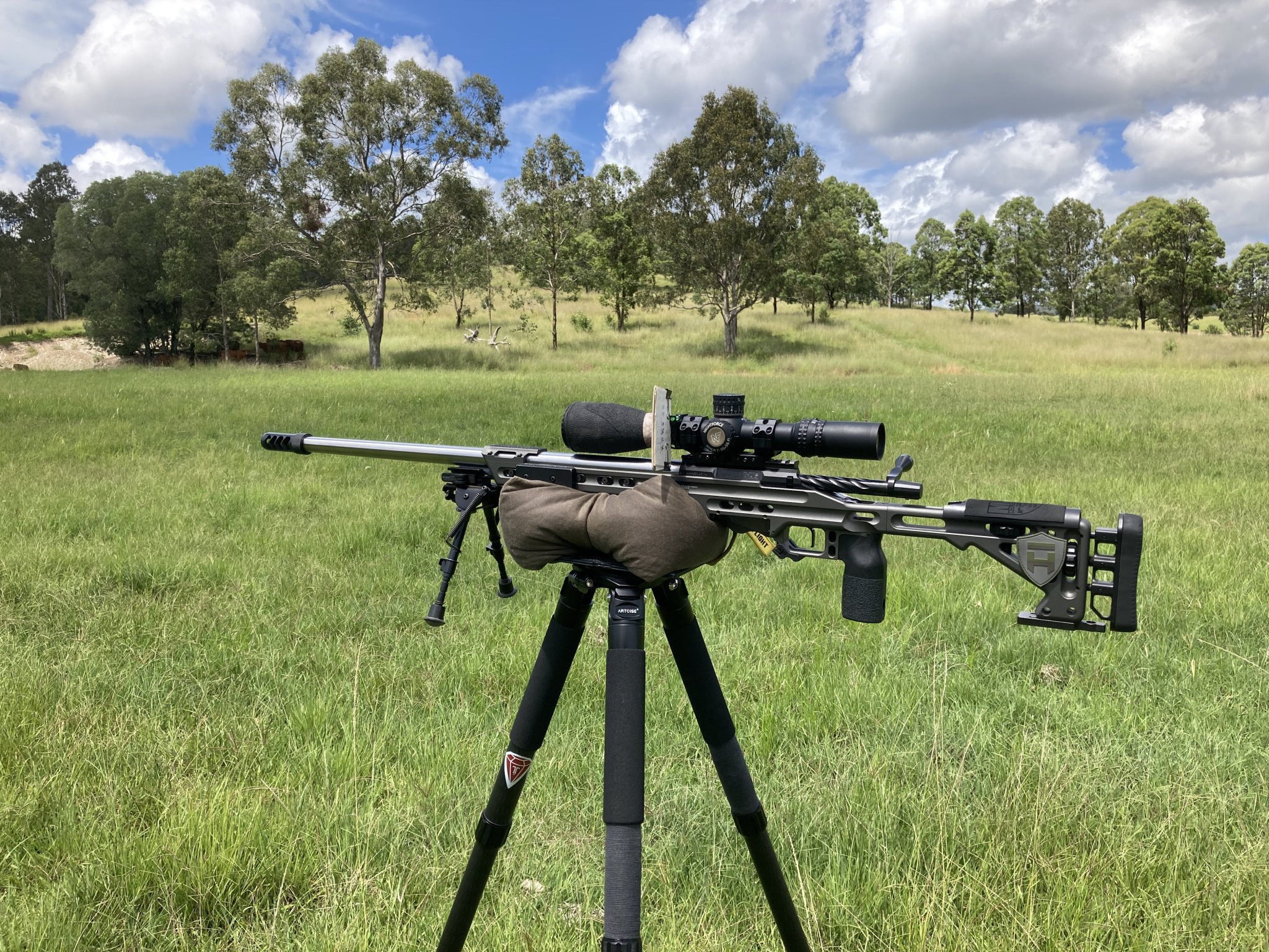

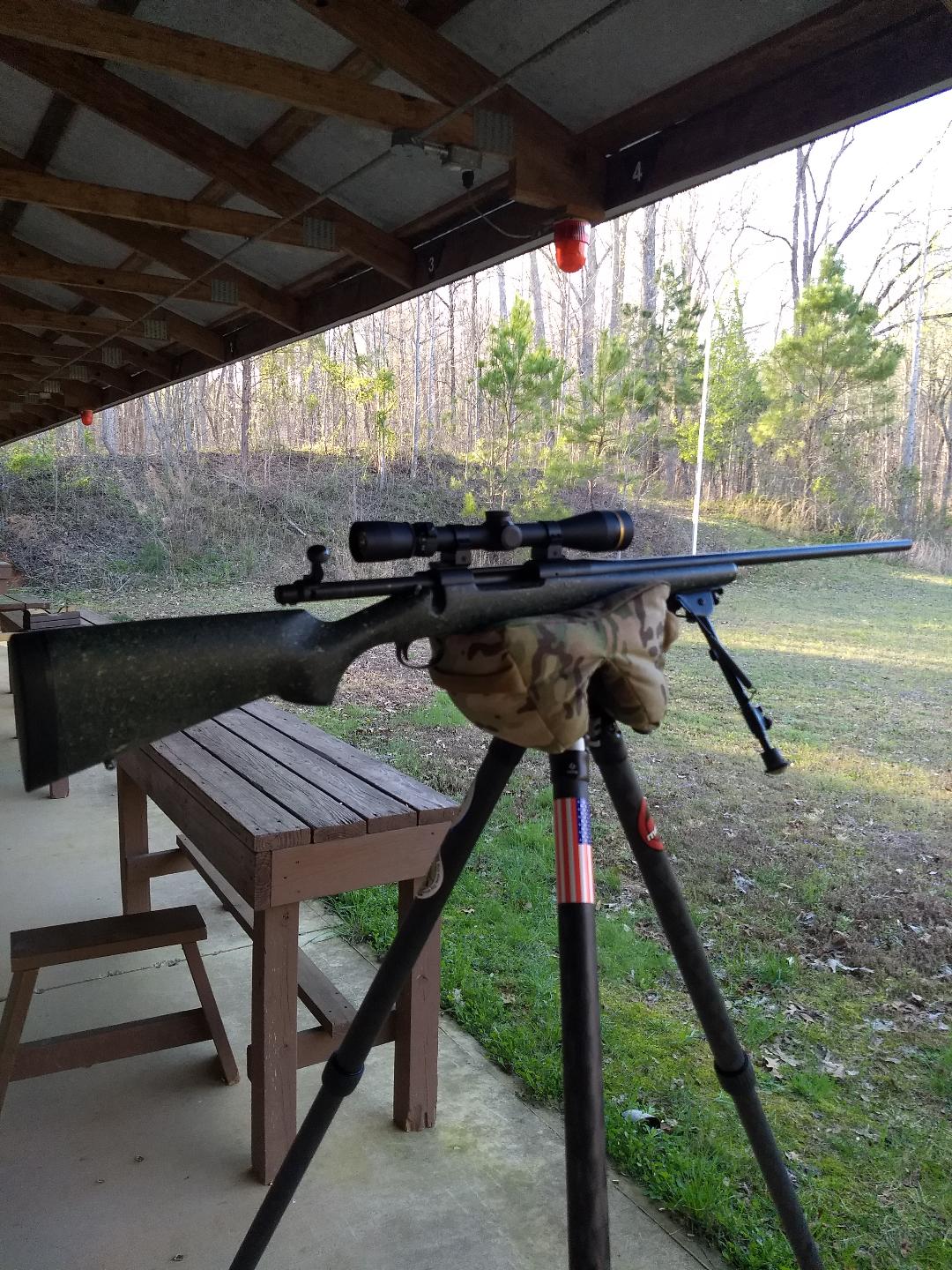

Full size gamechanger on top of my Anvil 30 works well for me too. I found it really stable this way and was engaging targets out to 500 yds. This is the setup I'll be experimenting with at the upcoming NRL Hunter match.

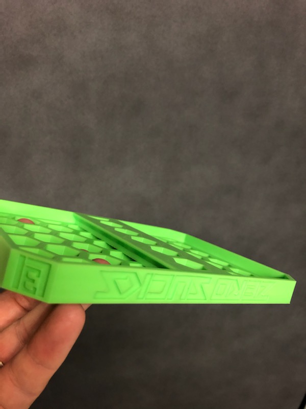

I missed the responses and have been away for a few weeks. I ordered the L3I Break Fast plate. Not completely satisfied with it. It is light and feels sturdy enough but the arca rail is too narrow for my Anvil-30. I’m not sure if I just got a bad one or they are all the same. If I were using a ball head without the QD where you tighten down using a knob then it would be great, but I don’t want to give up my Anvil 30 just to be able to run this plate.
Contact them on this. We actually found that the tolerance between each manufacture us pretty big and the design was enlarged. It was tested using multiple arca clamps but the testers were all using field optics like mine, RRS or 2 vets.

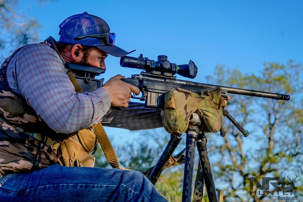

also seem to be the minority. Last week at the NRL Hunter match I shot off the tripod almost every stage. I just *gasp* clamp into the tripod with my binos, then when done finding targets, I clamp in my rifle. works pretty good lol.
It can be argued that bag on top is faster and that would be correct...I just do what I shoot better doing and that is clamped in. Slow hits are worth 100% more than fast misses.

I also ordered a L3I Break Fast plate and the Arca is too narrow for my RRS Anvil. I currently have it shimmed with masking tape it’s close but no cigar. I’ve sent an email just waiting on a reply.
I had the same experience with L3I. I reached out on Instagram (couldn’t find email) and they responded offering to replace. They mentioned they were tweaking the specs.
View attachment 7597077View attachment 7597081View attachment 7597082View attachment 7597083View attachment 7597085
