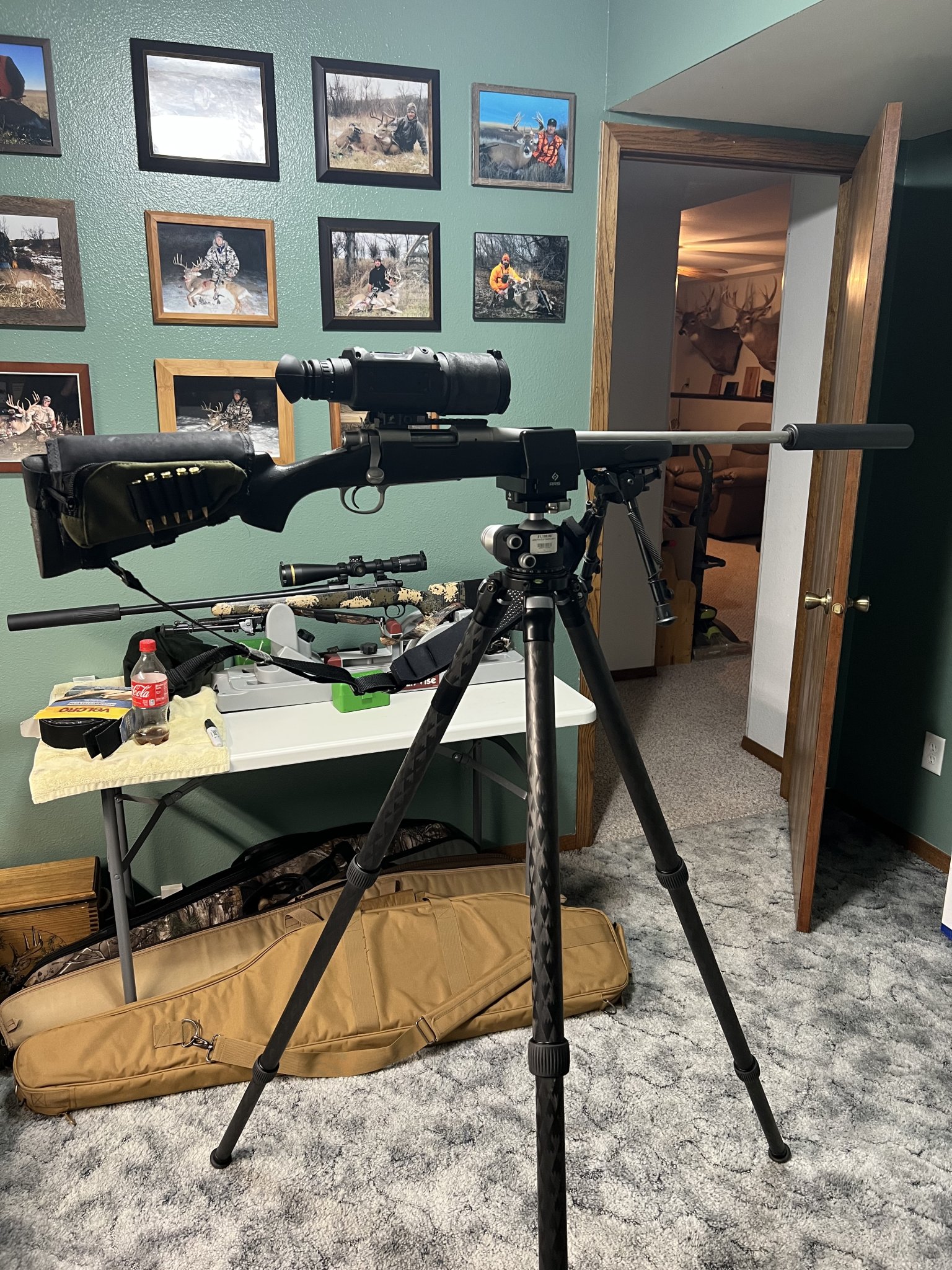

Just an update, I ended buying a used TVC33 that came with a ball head, I also bought an anvil 30. The tripod I had been using was a sirui n-2204sk and my va5 head off my spotting scope, it works fine for coyotes up close but any distance and it’s a little shaky. First impressions is it’s huge, and very stable and kinda heavy with everything on it. I also think I may stick with a ball head. I will try out the anvil in the field and see how I like it. but The ability to pan left and right on a fixed plane is really nice with a thermal in my opinion, I just don’t get the same fluid motion with the anvil. I can see where the anvil is much quicker and locks down firm though. Thanks guys

Just an update, I ended buying a used TVC33 that came with a ball head, I also bought an anvil 30. I will try out the anvil in the field and see how I like it. but The ability to pan left and right on a fixed plane is really nice with a thermal in my opinion, I just don’t get the same fluid motion with the anvil. I can see where the anvil is much quicker and locks down firm though. Thanks guys

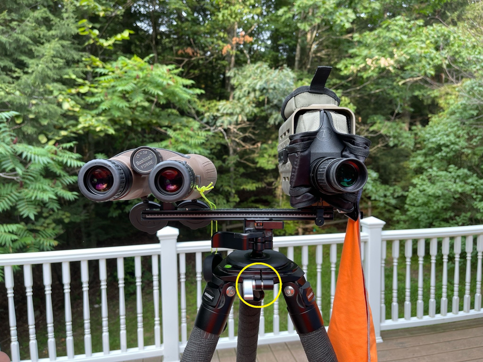

My tallest tripod, a Sirui R-5214XL, is 79 inches at its maximum. I have the optional center column which gives me another 25 inches. The center column sees use pretty much only indoors, for situations where I might want to fine-tune the height in small increments.
