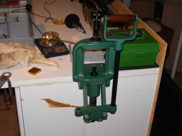

I used an RCBS Big Max (shown below) for more than 20 years just to load full length cartridges based on the 375 H&H case. If you going to load long rounds routinely, your going to need a bigger press......
