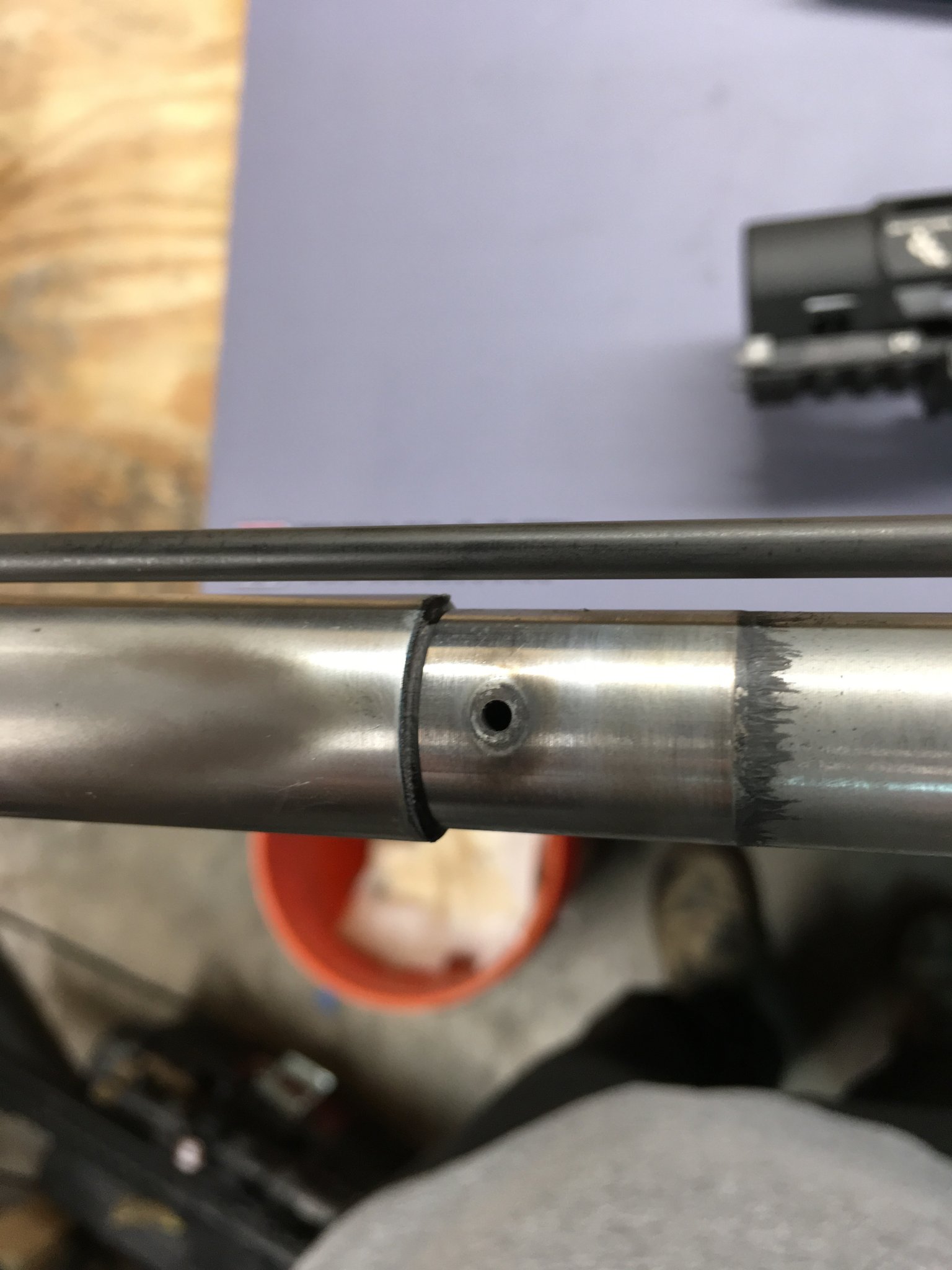

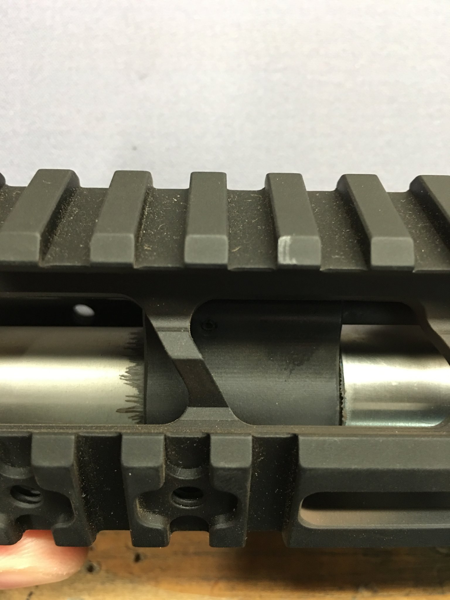

- I also checked the gas block and tube, there is no obstruction or malalignment of the gas tube to gas port as seen below, and an unremarkable amount of gas leakage around the block.

If you have a leak at the gas block/barrel or gas tube/gas block seal the leaks with blue Loctite. The pressure is apx 12000psi, a little leak can cause problems.

I also think your GB is leaking more then I would want.
How many rounds through it ?
It is leaking front and rear.. the barrel shoulder has gunk on it.
And if you got the GB off without scratching some of the gunk off... I would wonder about diameters.

Yea I was wondering if it was an acceptable amount or not. Ill loctite it and see.

Not silicone. Permatex 1 or 2 gasket maker or blue Loctite is what we have been using since the late 80s.

That looks like a shit ton of gas blow by on your barrel. I've got a 6.5 Grendel with about 500 rounds through it. If I can remember to, I'll pull the hand guard off and take a pic of the gas block- it's never been cleaned. My uninformed opinion is that your gun is woefully undergassed because your gas block doesn't fit and is allowing way too much gas out of the system...
Yeah, looking closer at the gas journal area, that's A LOT of carbon build-up. The gas block will leak a little during the first 50-100 rounds, but it should still function fine and dandy.

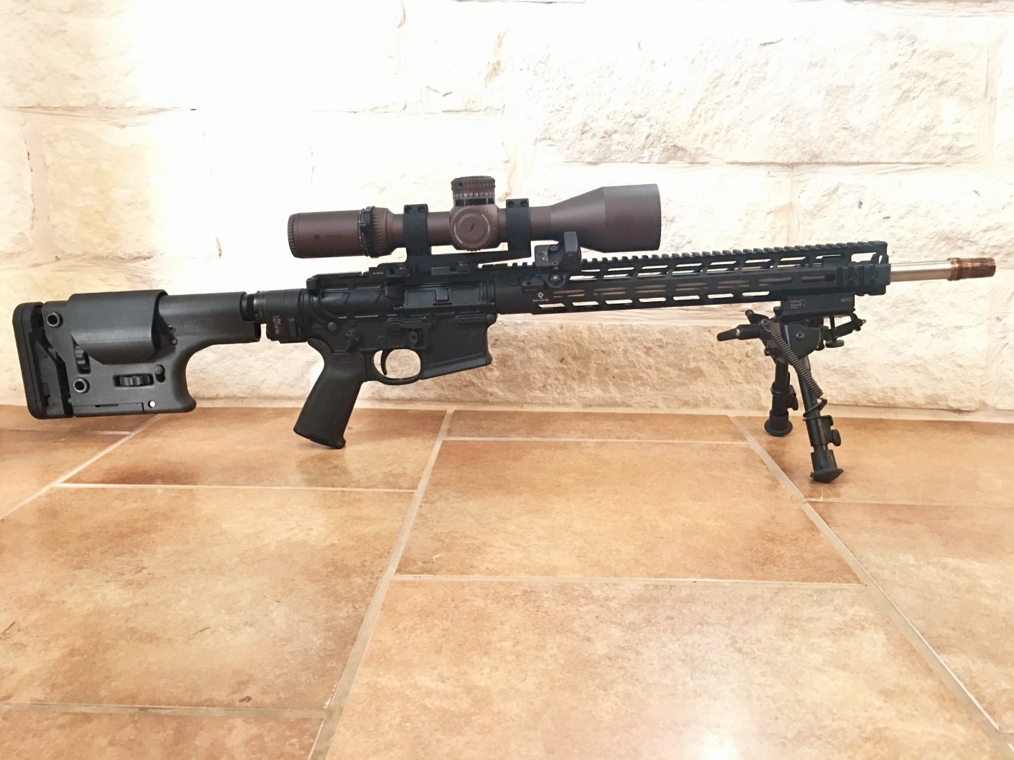

7054492

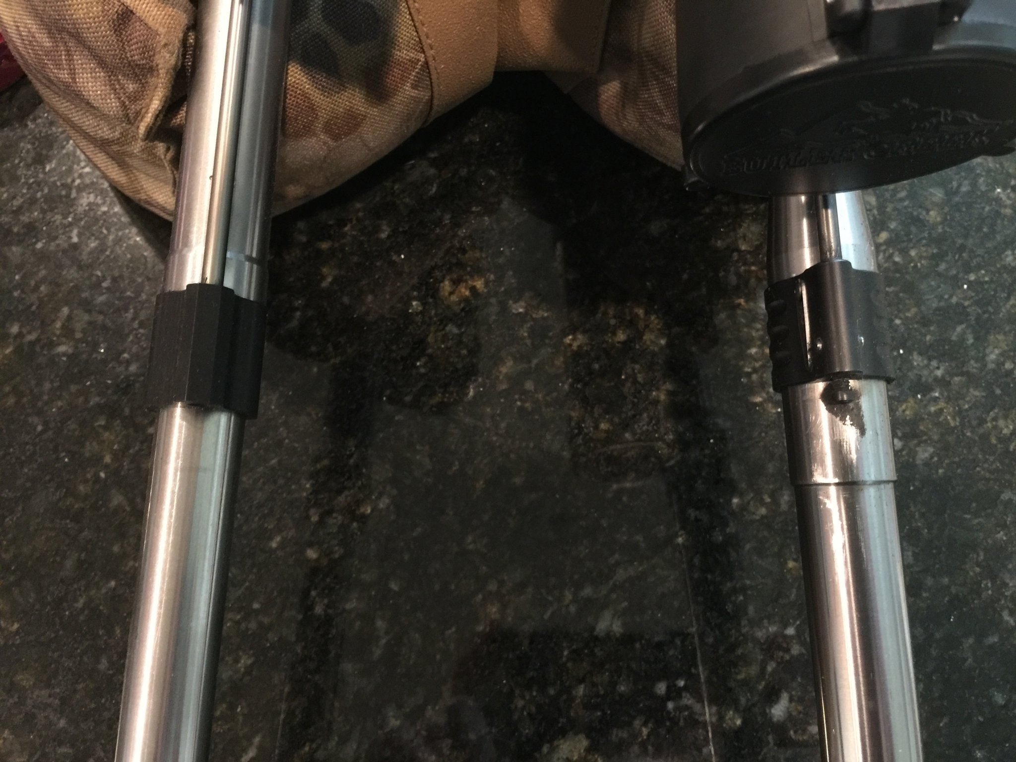

Here are 2 different rifles, both in 6.5 Grendel. The left is an Odin works 18" mid length gas barrel with a no name non adjustable gas block. I haven't kept track of the round count, but it has more than 100 through it. This is the first time since I put it together that the hand guard has been off. No observable gas leakage.
The rifle on the right is a 22" JP barrel with a SLR adjustable gas block. It is obvious that I'm getting some leakage from the djustment screw, but there is no leakage around the block-barrel junction. This rifle has around 500 rounds through it...
I haven't sealed up the gas block yet, I'm just wondering if it will seal itself up if it already has this much carbon after 200 rounds?
