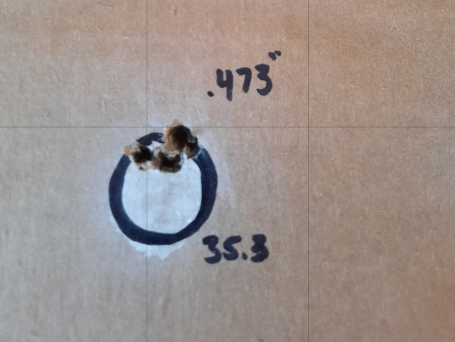

    Yep...the .7 MOA group was a different FN SPR of mine...same load as the one that throws random fliers.
    That second FN is a laser. First ever hunting handload produced a .419" group for five shots @ 100. Fastest load development ever.

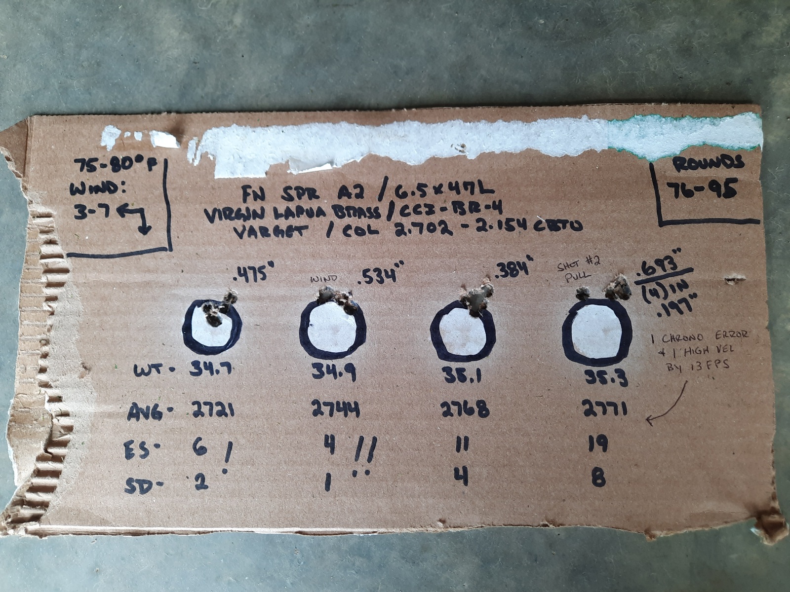

    This one just frustrated me man. I've got (or had as I've rebarreled one already) four .308 bolt guns - three SPRs and an M24R. The other three have never demonstrated this type of issue. Heck, I've got another three .308 semi-autos in the safes too. Call me a caveman who lives in the past, but I love the cartridge.
    I put a lot of 168/175gr stuff downrange. I have grown quite fond of the .308s recoil impulse. To me, it's the equivalent of what the .45, 1911 guys talk about.

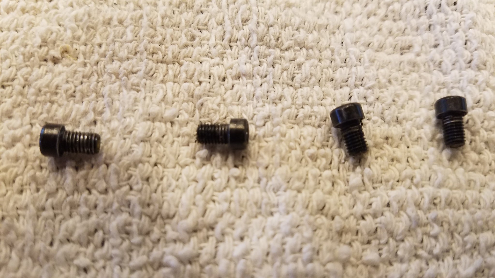

    You mentioned checking the scope ring screws.
    Did you check the base/rail also?
    I'd pull it off and remount it just to eliminate it as a possibility.
    I had one come loose a couple years ago and it drove me mad for three range trips.

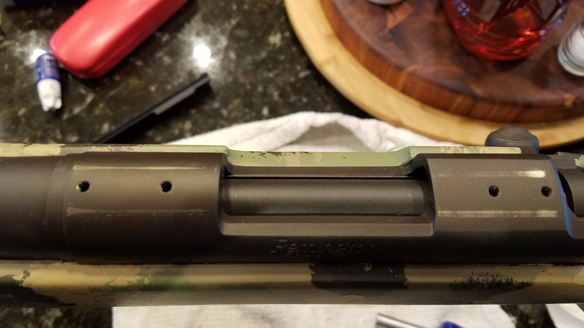

    The top of the receiver looked like this.
    Check out the screw on the left.
    The was the loosest one and it was actually damaged due to the movement.
    I replaced the entire thing with an EGW and haven't had any further issues.
    Yessir, I sure did check the base too. I confirmed it a second time when I pulled everything apart as I have the barreled action ready to take to the 'Smith for the new barrel.

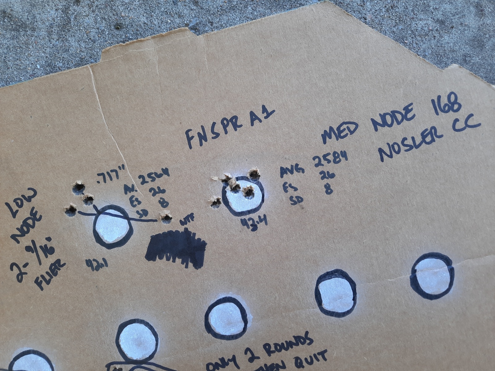

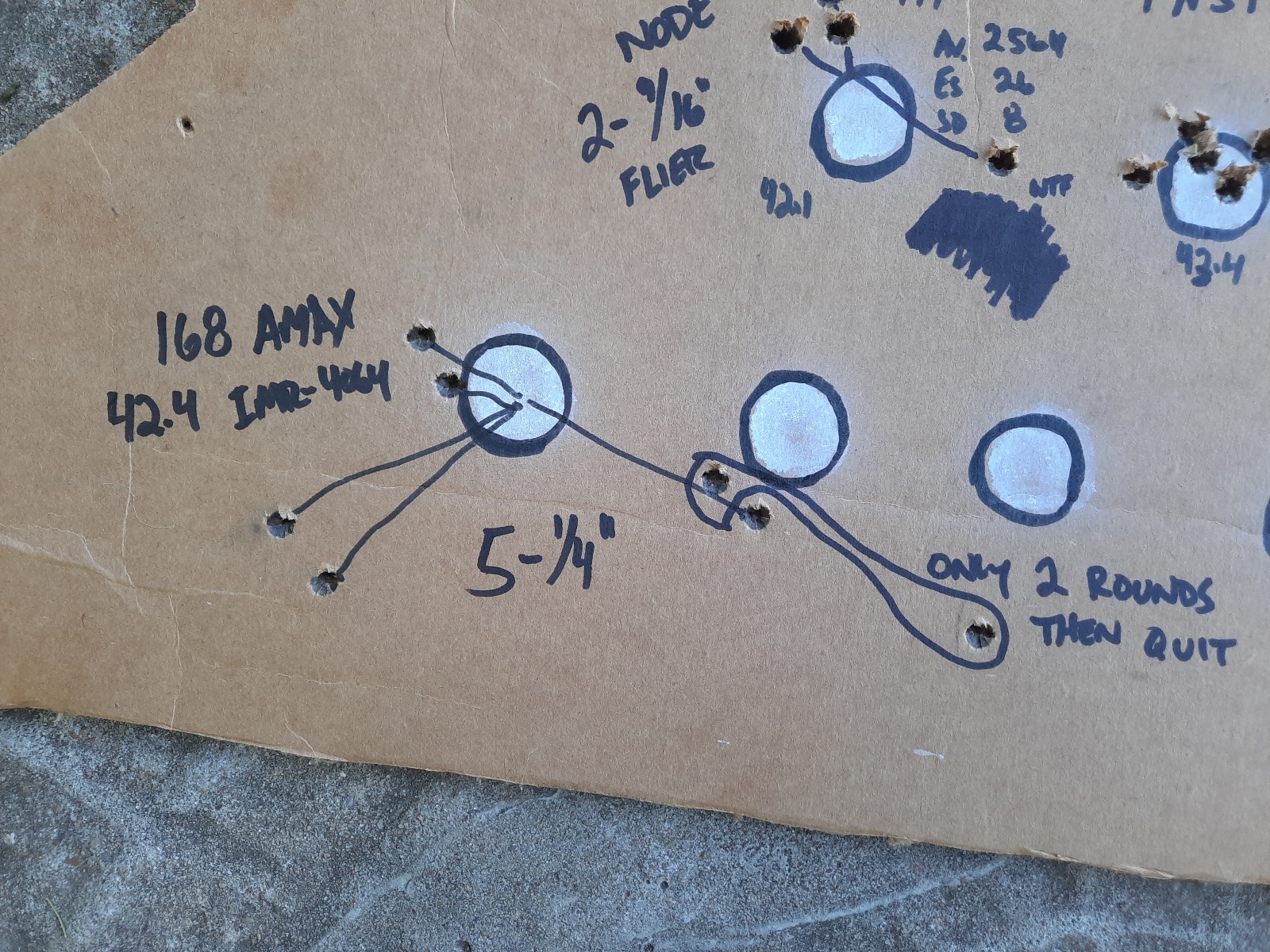

    Here's my last and final target before I said "screw it" and ordered a new barrel. It's a mess, so I'll explain:
    Group on upper left was me testing out the bottom of the flier node to see if I could get get that one shot back in by dropping charge weight even more...nope, flier 2-1/2" or so to the 4 o'clock. When I get into the 42.4-42.7gr range, it'll put 4 shots into the .4s...but there's always that damn wild one.
    Group on upper right was in the node where the groups sucked, but hadn't gone full shotgun pattern yet (were 3" with this combo another grain higher). At least the flier is gone, but 1-1.5 MOA is all it will ever do here. *I've never had the flier in this node...only the lower nodes.
    Group on bottom left is my one experiment with a light charge and the 168gr Hornady AMAX. Ho-Lee-Fuk...I've never had a factory rifle produce a group like that at 100 yards. Mr. Mosin would be proud. I tried two more rounds next to it before calling it a day. Yes, that is a 5-1/4" group...I tested another load of that in my good SPR, and it shot MOA...so it isn't the load.

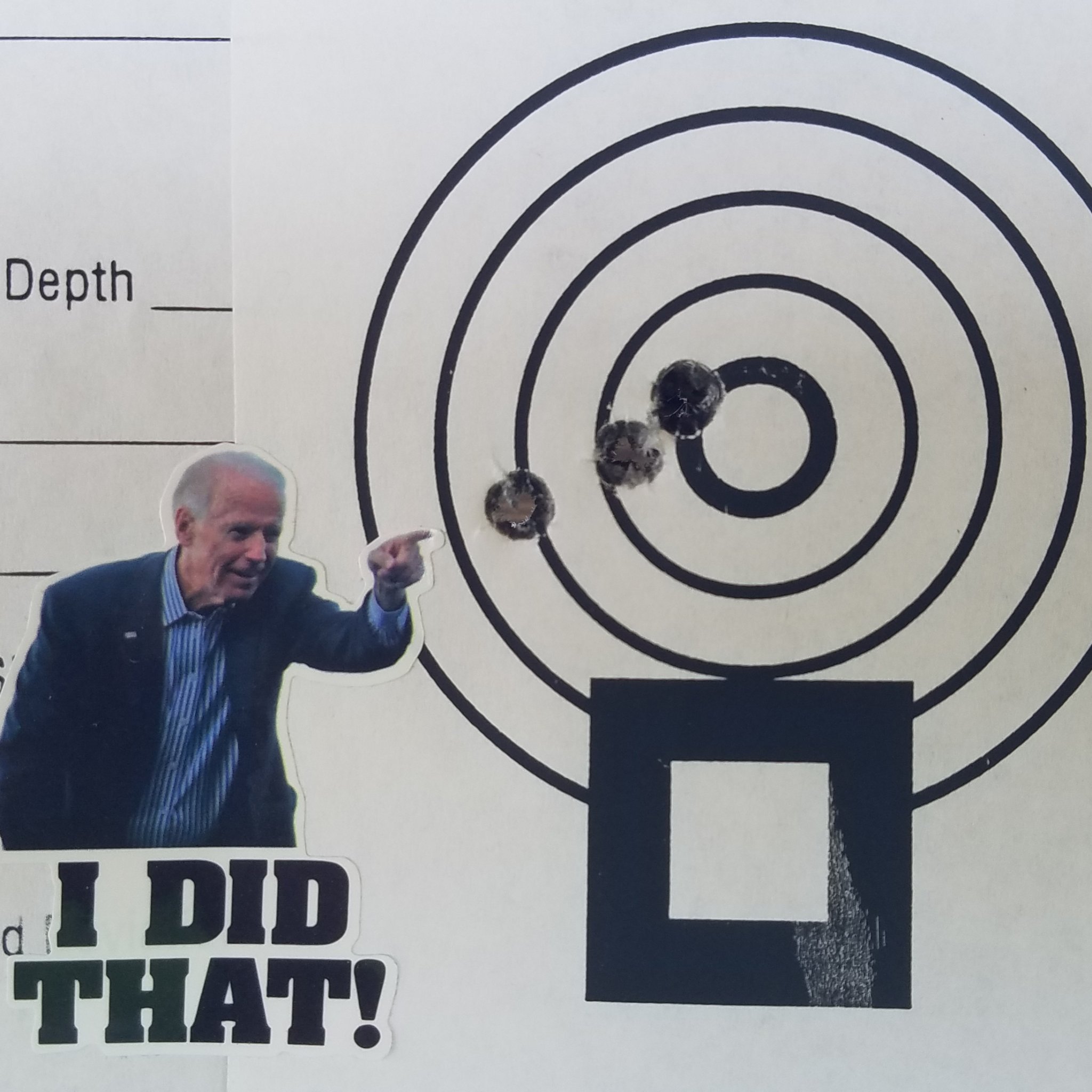

    So against my better judgment since I'm 12 days post shoulder surgery (non-firing at least, but had rotator cuff, labrum, and clavicle done), I loaded 10 rounds of a confirmed handload node (albeit in virgin Lapua brass), and put my XTR II back on my FN SPR A2 that is now a 6.5x47. This rifle is still in the beginning stages of load development, but is showing some promise with ~145 rounds through it. I still haven't formed all the brass yet, but everything is basically on hold for a while now (obviously).
    The load I used, is the one on the far right of the test target where I threw a called flier (below). *** This is perfect, because I frigging chunked a shot that day...as I can and do pull shots from time to time (usually about 1:40 or so...I'm not perfect). At least I can redeem myself (potentially).
    I had intended to zero in 2 shots, and then shoot 5 more. Glad I loaded a couple extra because it too me 3 shots to zero close enough for government work. Guess I can put my bad-ass card away. Not going to lie, even the little 6.5x47 hurts to shoot right now. Here is today's 5 shot group:
    I don't think I'd call it redemption. I was tensing at every shot, but at least no fliers. I know that a 5 shot group is not an ultimate test, but I never got 5 shots to group well when this scope was on the other rifle.
    Fortunately, I had a spare set of 34mm rings...unfortunately, none of my .223s wear a 34mm mount as that would have been much better on me at the moment (shit...I just realized that my back door rifle does...oh well).
    The worst part is that my wife heard the shots from across the ranch, and now I'm in trouble:D. For those who don't know, she's a Veterinarian, and I am on a strict recovery regimen.
