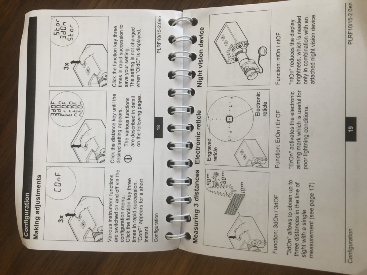

Another thing to check is your NV setting. If it's on your brightness is reduced...
Check to see you have not got it in night vision mode
I checked that one too- made sure it’s turned to NtOF and then stor. Thank you for the picture and advice.
