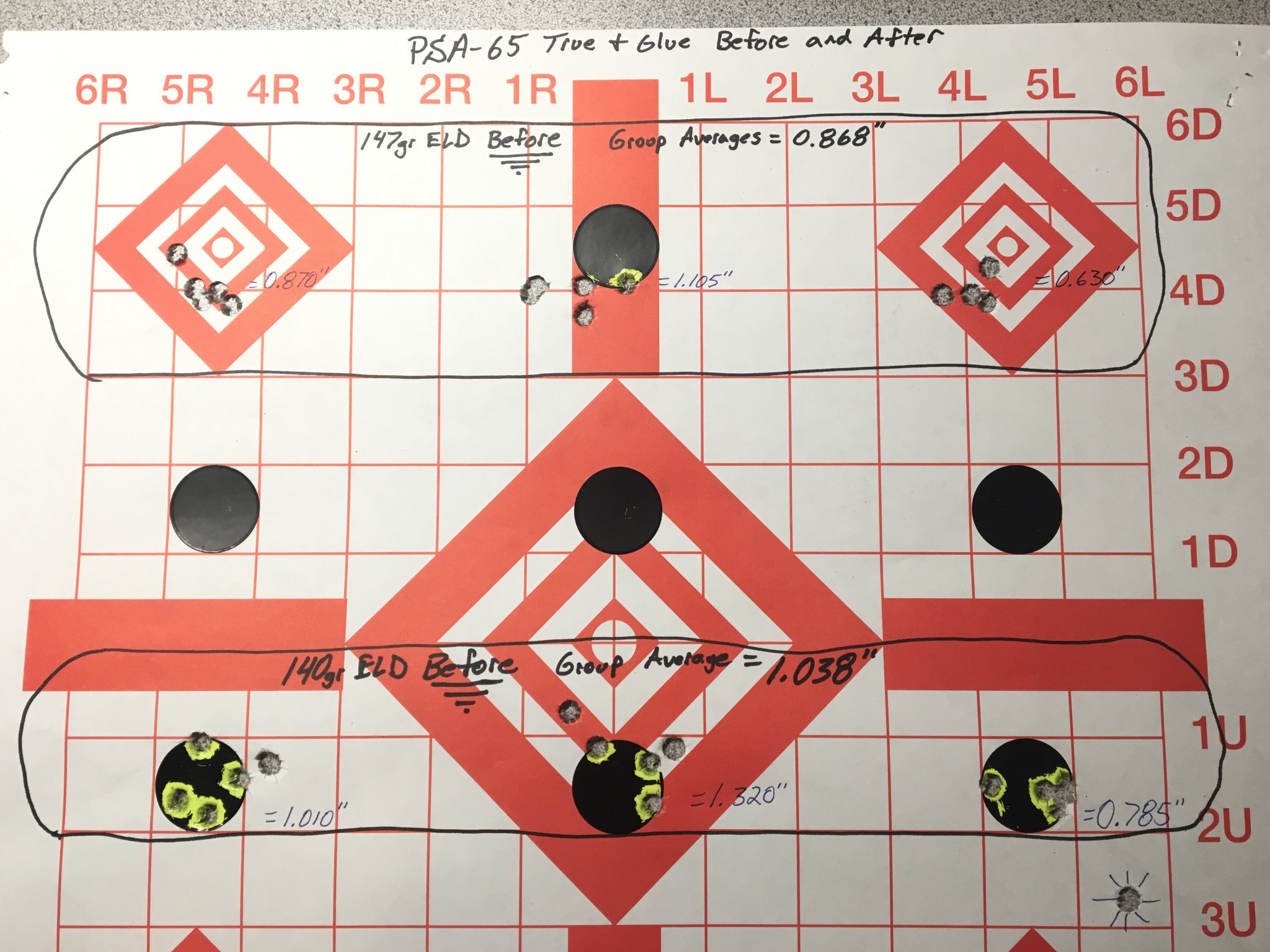

As of posting this thread I only have data for the before. I hope to be done truing and gluing and firing three more 5 shot groups for both the 147ELD and 140ELD in the next couple of weeks. Not sure if it will make it shoot better, the same or even worse. The cheap gas gun seems to like 147ELD and shoots it fairly well. Both are hand loads and they will be shot from the same batch. I did measure about 0.0005” height difference on one side of the receiver face.

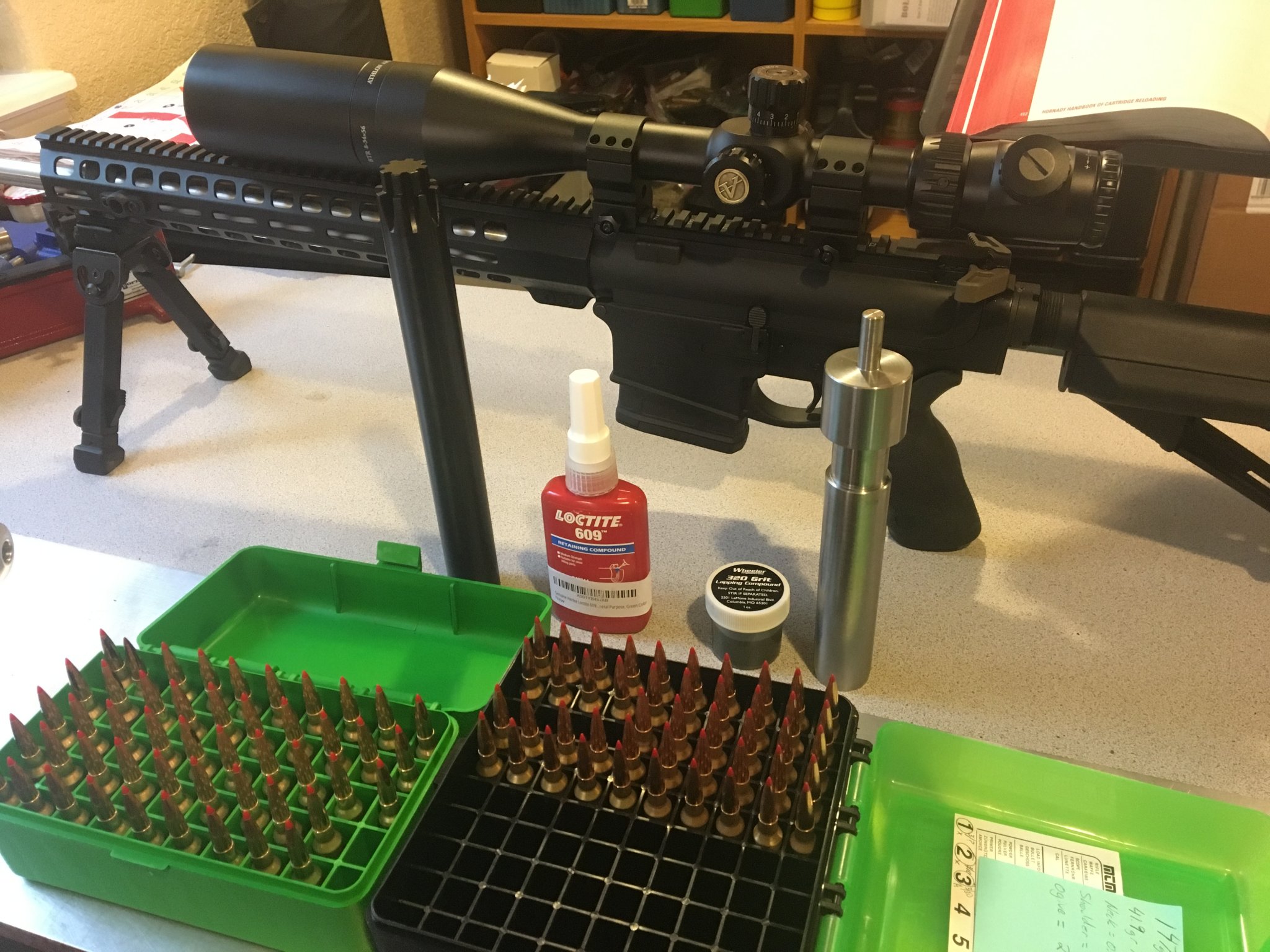

Just curious why you chose Loctite 609?
609 will work, but I've recommended 680 for this job on the forum a bunch of times for a couple reasons - it's higher strength, tolerates minor oil contamination, and cures in a larger air gap (less important, the air gap is small enough for both products, but it's more versatile for other uses like scope bases).
See differences here:
609: https://www.henkel-adhesives.com/us/en/product/retaining-compounds/loctite_609.html
680: https://www.henkel-adhesives.com/us/en/product/retaining-compounds/loctite_680.html
Thank you for the suggestion Sir! I will pick some of the 680 up instead. Have you even done a comparison before and after and if so did it ever make groups, consistency or POA worse?

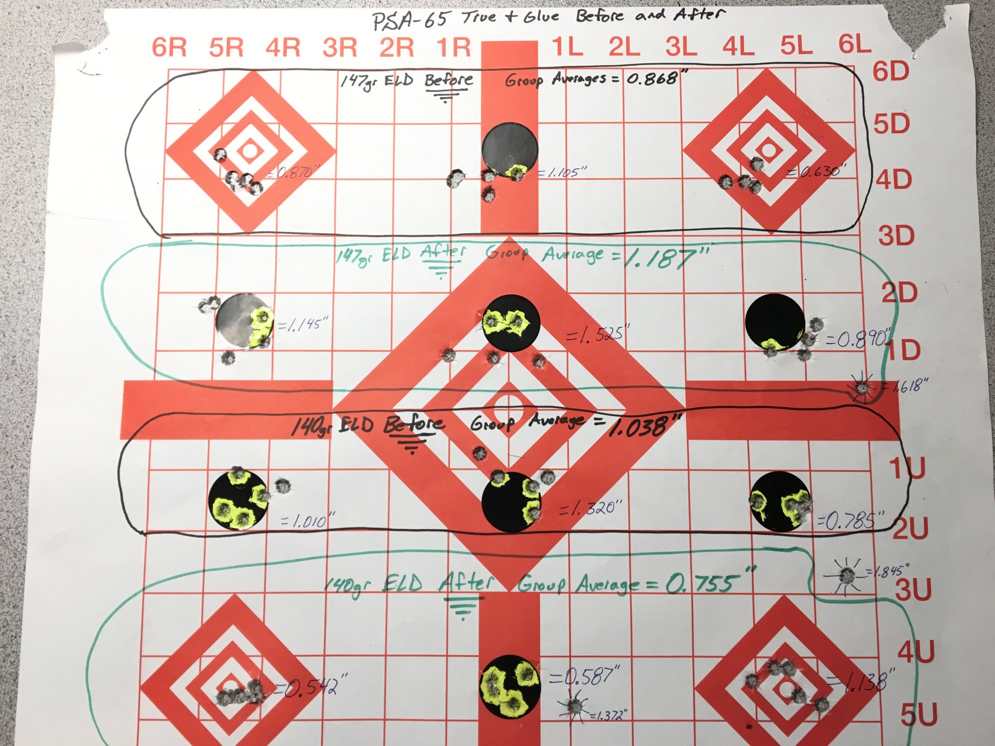

My "test" showed my PSA barrel responded well to the TnG.
Firing more Factory rounds into much better group sizes.
Big difference in the before and after on those rounds.

Please note... while some groups appear "worse" ... that could be just having a "bad" day shooting tight groups... Lol.. to many cigs or to much coffee.
I completely understand a bad day where groups just don’t group for some reason. Feel free to clutter this thread I seriously have zero issue with it. If it’s good info I believe it’s important to share data. Don’t forget; your the whole reason I’m jumping head first down this true and glue Rabbit Hole!!!!!!!!

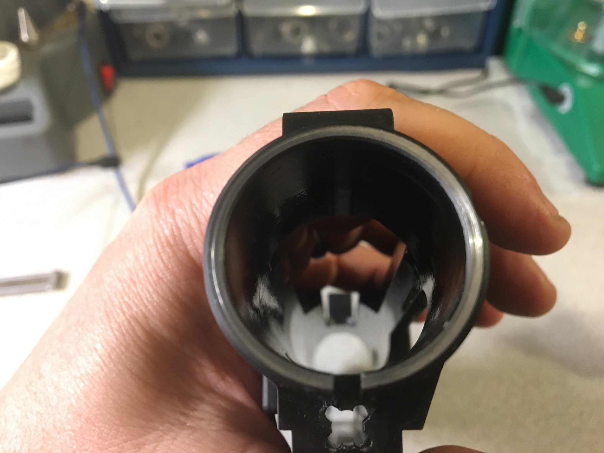

In for results. My BCM upper was so tight I couldn’t even get my lapping tool into the upper, let alone be able to turn it if I couldn’t get it seated. I had to heat the upper quite a bit to get the barrel in.
I was surprised at how tight a fit the PSA upper and barrel acually were. I almost had to heat it up to remove the barrel.
My lapping tool would also not fit in the business end of the upper. I had to take it into work, chuck it up in the lathe and polish it down until it would fit in the upper.

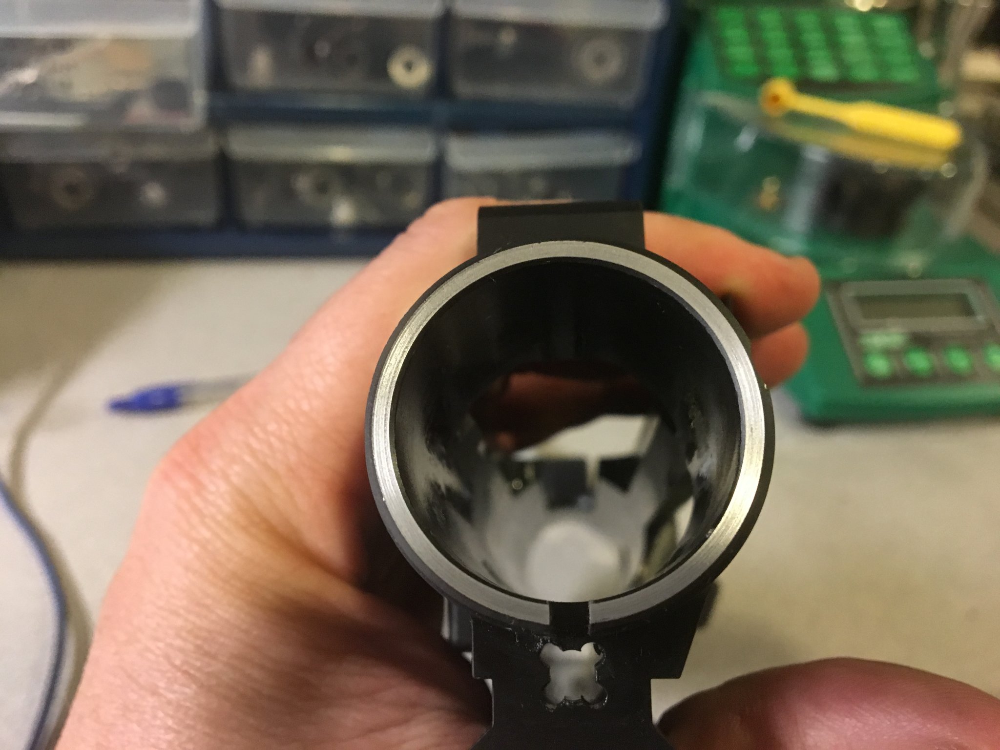

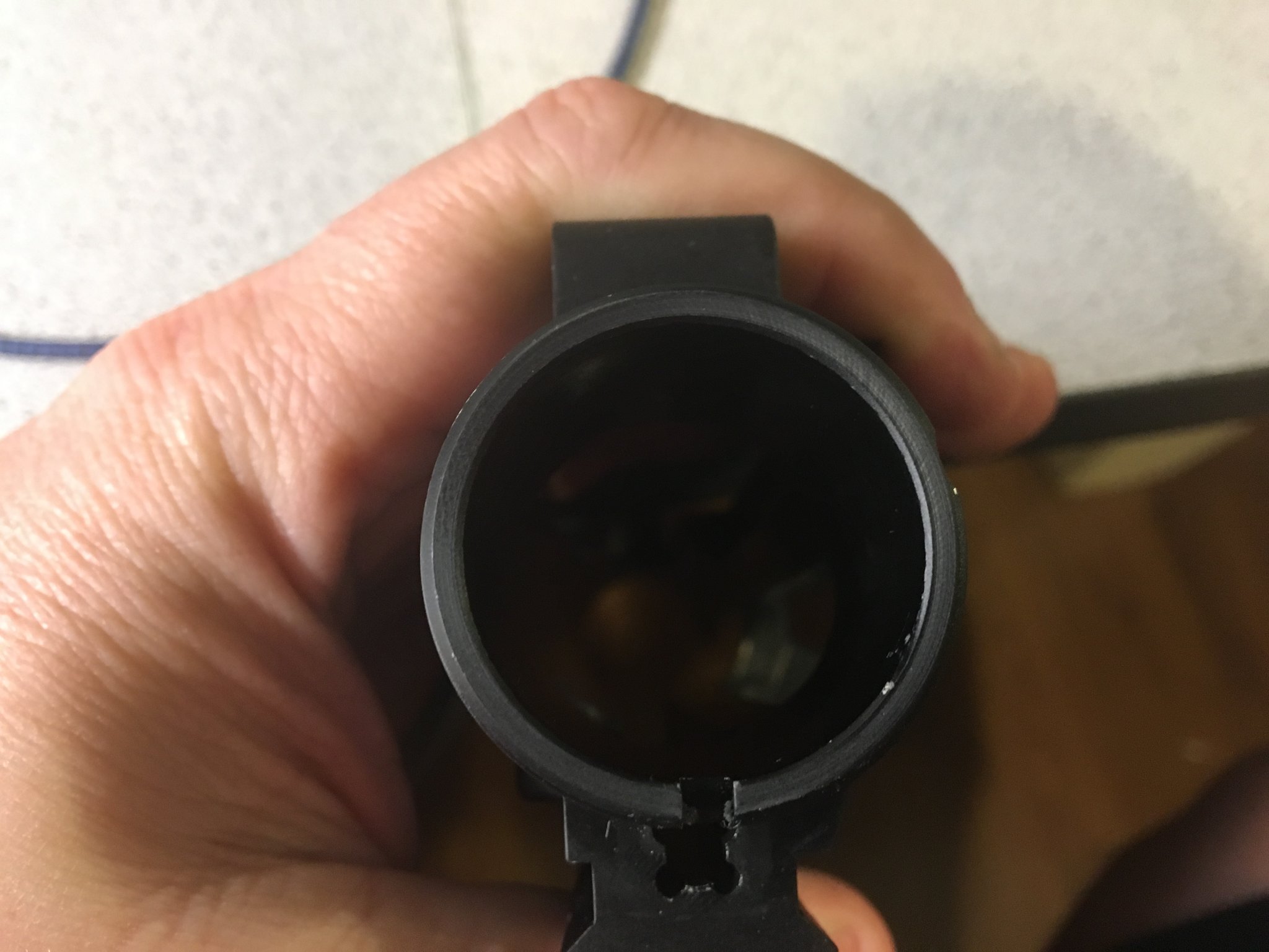

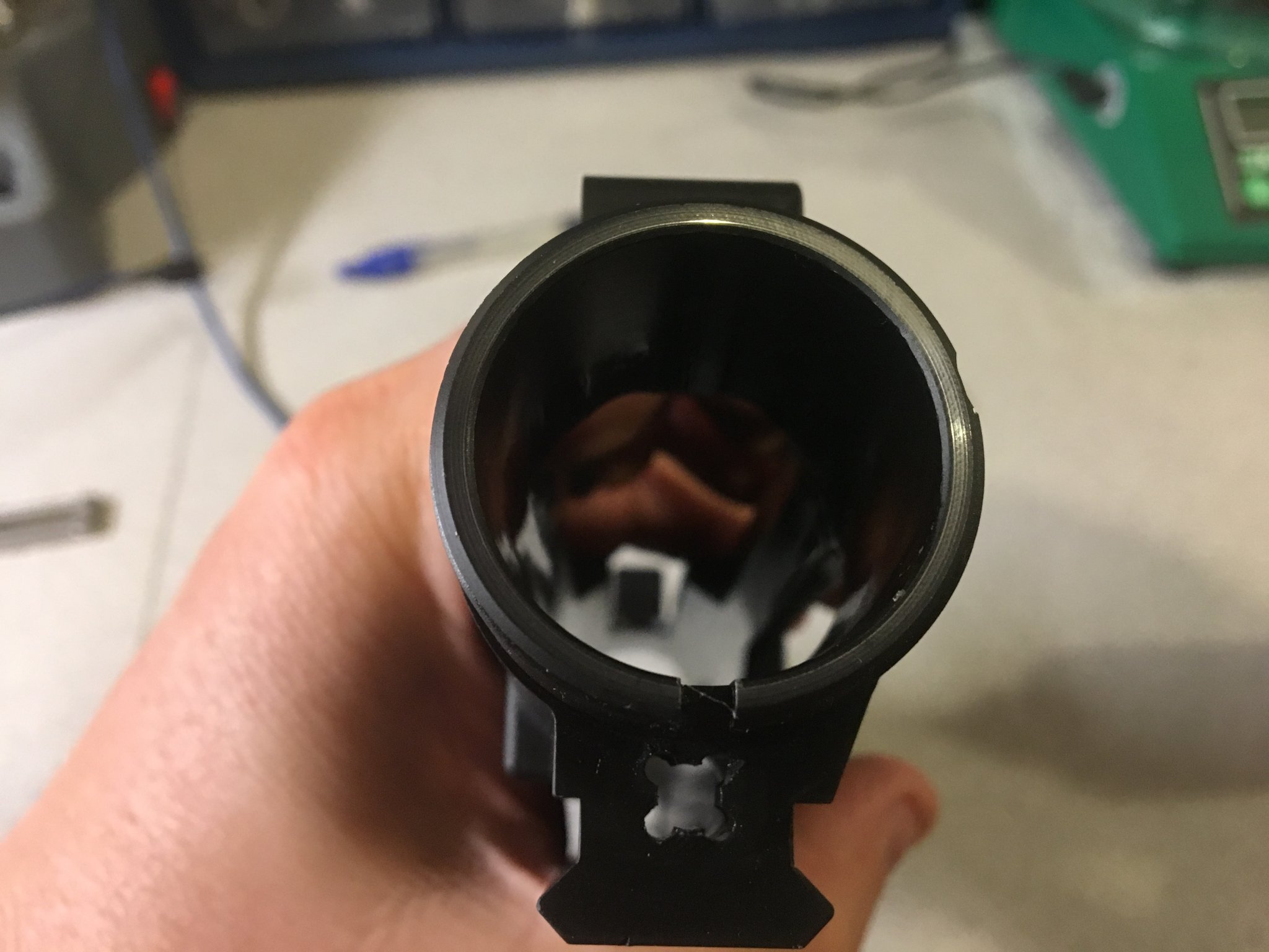

Here are some pictures of the surface a few steps along the way through lapping.

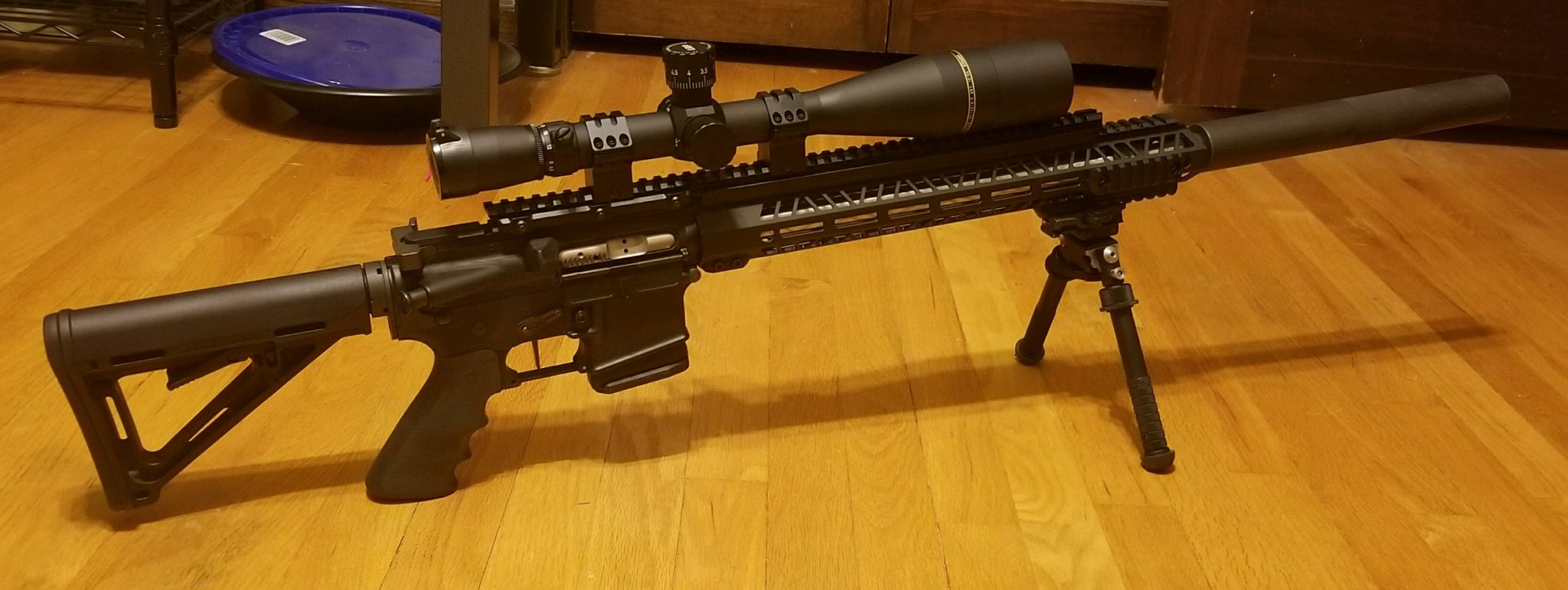

I trued my PSA 6.5C upper and shimmed the barrel in tight with stainless shim stock. Still have not shot it, my business is crazy busy since March but as soon as possible I will get it zeroed. Ordered an Ares BTR 4.5-27 on sale to switch places with the Argos and haven’t even fired it LOL.
@bfoosh006 is a wealth of information on these.
You don't need to lap a BCM upper with a tight fit like that; the tight shrink-fit bore aligns the barrel extension to the receiver. In looser receiver fits, lapping is more helpful because the receiver face aligns the barrel extension.
Looks like that definitely needed some lapping! Take a look at your bolt lug contact (easiest to see if you haven't cleaned the bolt, or use a small mirror and look inside the barrel extension at the front side of the lugs). You'll probably see partial contact on some lugs, and should expect full contact on all of them after that lapping job.

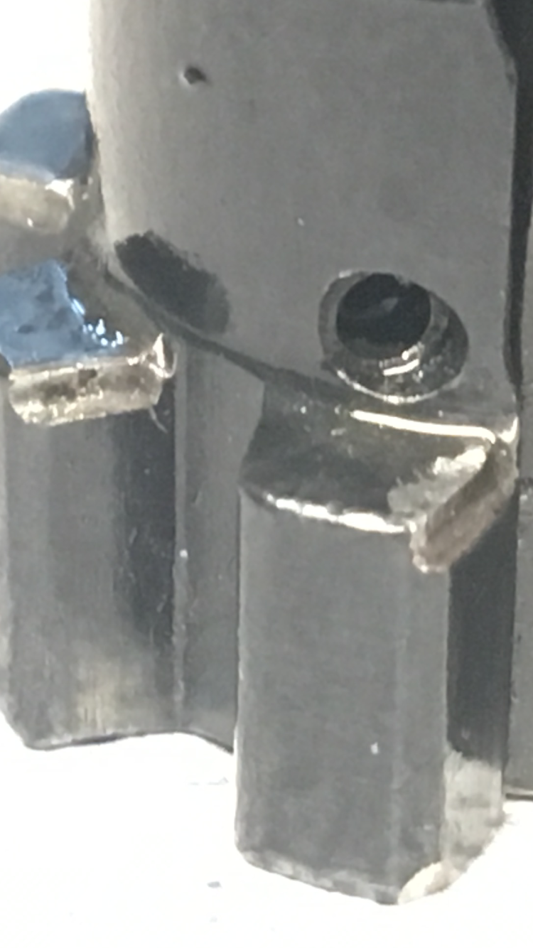

Is this the type of damage one might see if there wasn’t full bolt engagement; in your opinion? That is actually my photo from this same rifle.
I had also formulated in my head that lapping the face would remove any high points that could also cause the barrel to rock, tilt or move when the upper and barrel heated up?
Yeah, I've compared before and after on a few different AR rifles, but haven't documented the results. It's important to understand that this "true and glue" thing as you guys are calling it now is really two different things, with two different results.
Lapping the receiver is done to achieve full bolt lug engagement, and is really for bolt durability, not accuracy. I've seen a couple ARs go from only bearing on some of the lugs to full contact with lapping. That's a good thing for bolt life, but may never show up on target unless things were really bad or you're comparing the difference in benchrest-quality groups. This is the AR version of blueprinting a bolt action, or at least lapping the bolt lugs.
"Gluing" the barrel in the upper is really bedding, and it can definitely improve groups and make the rifle more consistent with a wider range of loads in my experience. The only thing better than bedding the barrel to the upper is using a thermo-fit (or press fit) upper like BCM with a quality barrel; with a shrink fit like that you don't need adhesive.

I received the 680 loctite today and found the time to glue the extension into the upper. I applied the loctite to both the extension and the upper for good measure and cleaned off the excess. This whole process has been super easy so even if it doesn’t make a difference I am only out the money used in tools and loctite. I just hope it doesn’t make things worse.
I hope to find time this weekend between birthday parties and graduations to test and see the results.
Loctite 680 is a good "version" as well... it is for larger gaps... 0.015 in. And has a higher sheer strength 4000psi
609 is for tighter gaps...0.006 in. ... 2300psi

Hit the range today after trueing and glueing. Not really sure what to think about the results other than I don’t believe this made a big difference either way for me and my rifle.
The 147gr groups actually got slightly larger as in +0.319”.
The 140gr groups got smaller by -0.283”.
The 147gr and 140gr group size average before was 0.953”
The 147gr and 140gr group size average after was 0.971”
To me this is just spitting hairs and I can’t explain why the 147gr groups got worse and the 140gr groups got better.
I know there is an argument weather lapping the upper changes the distance to the lands but that had crossed my mind? Maybe it was just one of those days? I have noticed that some loads shoot better some days then others but besides humidity the temperature was about the same?
Anyway; interpret my results as you wish and I am open to any and all ideas or conclusions.

Regardless of your turnout I still applied you for your shooting, you are well and truly doing better than most people I see on here. Shooting a large frame AR proficiently is no easy task and maybe this range trip hasn't proven anything concrete to the argument but judging by your groups and if you decide to stick with this platform I believe you are capable of being a 1/2 MOA Shooter.
This is just my opinion but by reading your groups it looks like the reason behind your point of impact shift would be due from changing your grip or canting your rifle.
Reactions: Juggerxxx
Anyway; interpret my results as you wish and I am open to any and all ideas or conclusions. View attachment 7084987
Realistically speaking you don't have much of a sample size. There's nothing wrong with your groups, looks like the 140s tightened up a hair today with a couple that might be on you.
As far as the 147s go, did you start with those cold? A cold shooter shoots differently. I would be very happy with those results.

Nope, not a thing.
And I forgot to touch on that, upper receiver truing, can't affect that because headspacing is controlled by the bolt and the barrel extension. The upper receiver is merely a guiding system holding these two objects in line with one another.
