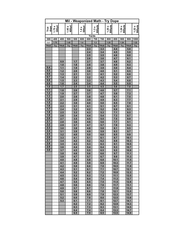

This is an entire ballistic calculator for anything you zero at 100 yards. It's a simple flow chart, Use 1.0 at 300 try 1.7 at 400, needed 1.8 for a centerline hit, try 2.6 for 500, and so on, if you are more than .2 off any yard line, the ranges are wrong or you are not shooting correctly
I essentially have plotted my drop data with this rifle in a similar way as the weaponized math, except it was at random distances. I adjusted my kestrel to match my data points out to 750.

If your stuff is off a constant angular value at all ranges (0.3 mils high at all ranges), it's a zero issue. If the errors get bigger with distance (more MOA or more Mils as distance increases), it's either a MV or drag/BC issue. The inherent limitations of BC calculators usually means that the solver won't generate a perfect output, even with perfect MV inputs. If real-world correct verified MV doesn't work, you have found the limitations of your solver's ability to handle drag or environmental conditions. (assuming no other inputs are wonky). This corners you in a place where you basically have to fudge MV to make the trajectory line up. IF that is the case, and you're concerned with down-range retained velocity, you need to understand that there's some error in what the calculator is spitting out. You're forcing the path/trajectory to line up, not the velocity/time based stuff if you fuck with MV. Cd based solvers (4DoF, 6DoF) typically handle the drag side of things much better and you're more liable to get correct outputs with correct MV inputs. It's not always exactly perfect but the "tune up" on drag offered by features like 4DoF's form factor are very small shifts in the Cd vs. Mach curves that the program uses.
I've used 4DoF as a chronograph a few times, successfully. Basically note the POI at 100yd, set zero angle, then see how much it takes to hit waterline at 500-700yd and adjust MV accordingly. This works if all other inputs are very solid/accurate... So yes, fudge MV to get you on at 500-600yd is a decent technique, HOWEVER... if you're off more than 30-40fps from what your chronograph is saying, I still maintain that something is likely fucked somewhere else. If nothing else, it's a good eyebrow raiser to go back and verify zero, sight over bore, and environmentals.
If things aren't making sense, IMO the best thing you can do is to shoot at 100, 400-600, and 800-1000yd. Note exactly the conditions, and exactly the dope that it took you to waterline at those distances. 10 rounds MINIMUM on clean steel at each distance. Write it down and this will allow you to go back later and verify if the changes you make to your solver/profile reflect reality. Do not omit wind inputs and horizontal POI.
